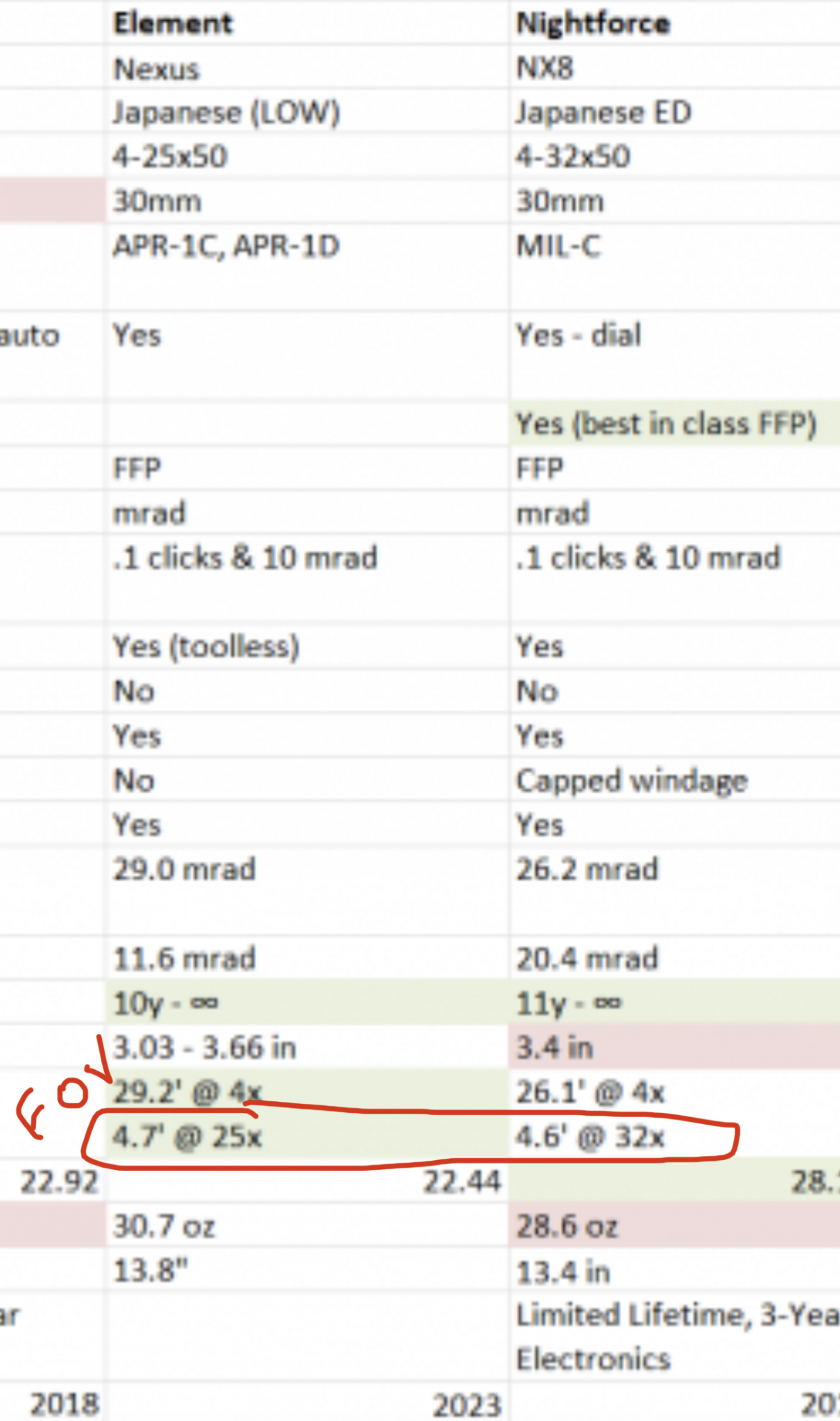

I was also looking at the FOV numbers since a lot of guys were ragging on the 'narrow' FOV. The Mk4HD actually has about the same FOV as the Mk5HD series and the LHT 4.5-22. It's not a wide field of view, but it's pretty much right at the standard of ~100-105ft @ 100yds @ 1x, not narrow at all. That number is grabbed by taking the FOV from the specs and multiplying it by the base mag of the scope (2.5x, 4.5x, etc.).

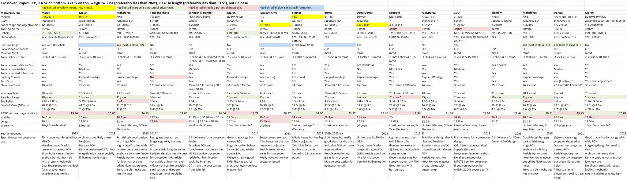

Spreadsheet of scopes that meet the following criteria:
  • FFP Hash Reticle
  • 4.5x or less at bottom magnification
  • 15x or more at top magnification
  • Weigh 30 ounces or less (preferably under 28oz)
  • Length less than 14 inches (preferably under 13.5")
  • Not manufactured in China (if you need to ask you haven't been paying attention)
I have ordered these by bottom magnification at far left and increasing up to 4.5x on far right
All my crossovers are around 3-15. 3 provides enough FOV but 4 does not. 15 is sometimes low for longer shots on small targets so 3-20 would be perfect as long as optical quality is high. So far of the scopes I have tried that have more than 5x mag don’t have the optical quality and eye box forgiveness so I’ve stayed with 3-15.
  • FFP Hash Reticle
I appreciate you doing this. This chart is very helpful. I’m in the middle of a search for a 20” precision large frame gas gun optic that could pull double duty on hunting rifle. I know your criteria in the above chart is 30oz or less, but wondering if you’d have time to add the ZCO 420 to the list as a comparison benchmark as many consider this the best do all optic. I can’t get behind many of these optics so reading reviews and info like this is really helpful. Thanks again.
I added the ZCO 4-20 as well as the Schmidt 3-20 and the Mavin 2.5-15
One thing with your chart:
Why is the Element’s FOV cell colored green (i.e. “good”) when it only has roughly 1.2” inches more FOV than the NF 4-32? (4.7ft = 56.4in, 4.6ft = 55.2in).
And worse, the Element’s FOV is calc at 25x while the NF4-32’s is calc at 32x? At 25x the NF 4-32’s FOV will likely be massively more than the Element’s.
I know the NF 4-32 does some trickery with their FOV vs some other scopes.
Because I'm not perfect and make mistakes man 😁 It was a copy error, often when I put in a new column for a new scope I copy data from another column and forget to change values and highlighting. Take a look at the AFOV value right now and you'll see the big difference. Thanks for pointing this out, I will correct that.
With lots of help, I did eventually figure out an excel-based (ok, Numbers for Mac) solution to estimate FOV throughout a scope’s range. But there’s something sneaky going on with the NF4-32:
Me too, I think it was Kiba who taught me algebra and I was able to plug in the calculations into Excel and come up with proper AFOV numbers. I only run my numbers at the top magnification as bottom can often be different and affected by various things least of which would be tunneling. NF ATACR tends to have pretty horrible bottom mag AFOV, but quickly picks up and increases as you increase mag.
NX8 is an interesting animal, they have some of the widest FOV's on the market but I think they are pretty valid unlike ZCO who's FOV numbers are not correct even though the image looks super wide.
