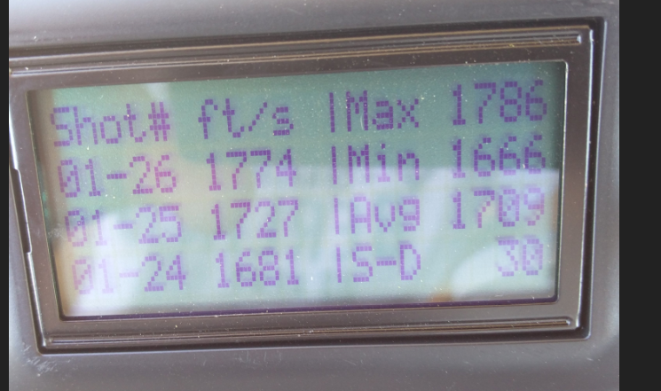

Did you chrono these keyholing loads? As D and I stated, and increased muzzle velocity should increase stability. Something doesn't add up...
Yes I did chrono. Here are the results of 26 of the 30 rounds fired:
So I had not noticed any stability issue prior to going to a lead alloy. Pure lead seemed to work fine. Its also possible I'm crimping too hard and distorting the heel or its not gas checking consistently due to the hardness. The current alloy version also has a shorter heel. Got to go back to square one and analyze the changes to determine what the hell is going on here.

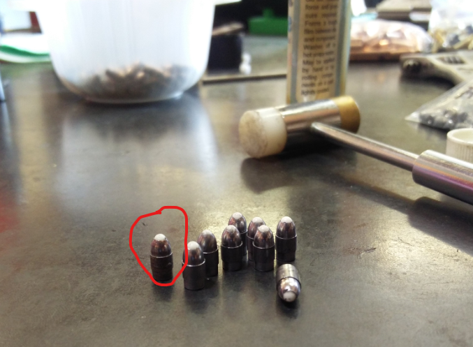

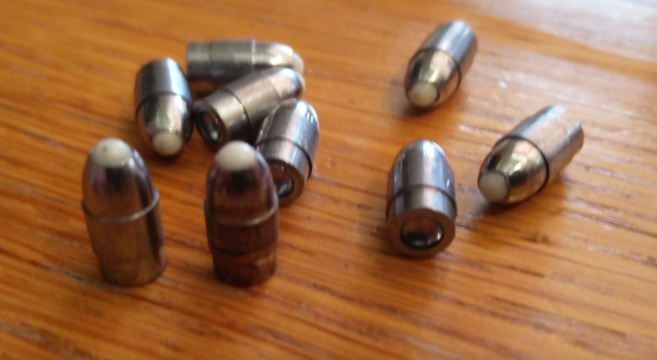

Finally had some time to get back to this development. I increased the bullet bearing surface by adding about 4.5 grains and reducing the heel length by almost half. The center mass three shot group was at 54 yards with the sabot included. Still not happy with a few things on the prototype and need to shoot a 10 shot group to be sure this problem is behind me but happy with these results. I'll be doing that pork shoulder test on Friday!
Reactions: Skunkworx
Next update.
The bottom projo is the latest that incorporates the stabilization changes mentioned above and a deeper sabot insertion.
This next iteration's weight is coming in at 36.6 grains. Still a bit heaver than I want but with the nose being light, had no choice. I'm hoping overall accuracy improves given a more accurate sabot insertion process is now in place. Last test above produced about .75 MOA at 54 yards. If I can get that down to .50 MOA then perhaps I can reach my 1 MOA goal at 100 yards.

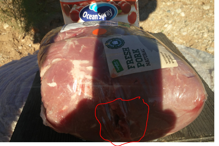

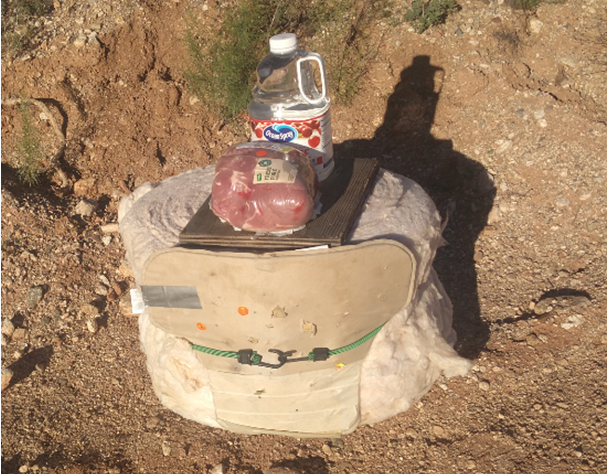

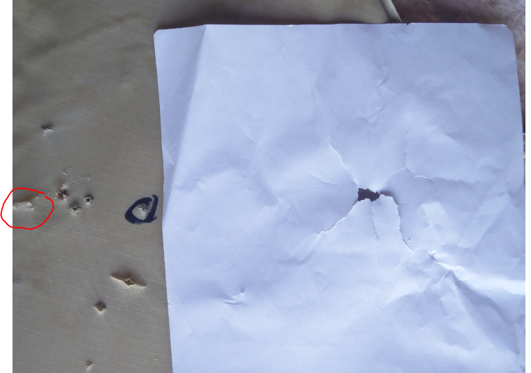

Ok so had some fun for a change with this f'n project. Pork roast shot at 54 yards. Direct hit. Hit right under a bone and rode its way in to a depth of a full finger:
And the final warm up for a night on the town! That's an easy 4" depth:
Took a shot to see if I could penetrate a level 3A vest at that distance. Almost but not quite. Keyhold. That will be fixed in next version.
I also did the next four-shot accuracy test. Same .75 MOA group. No pics as I'm off the clock for the rest of the weekend!
Reactions: BigTex

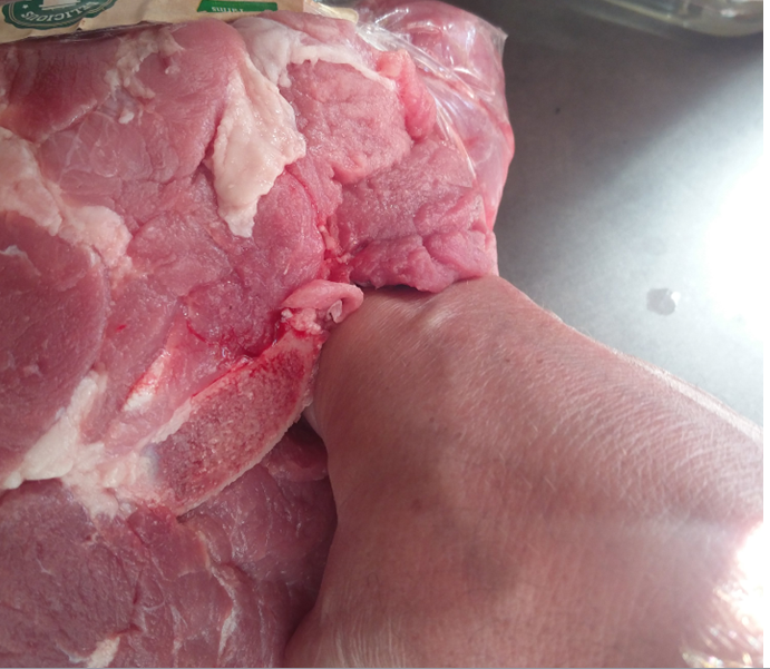

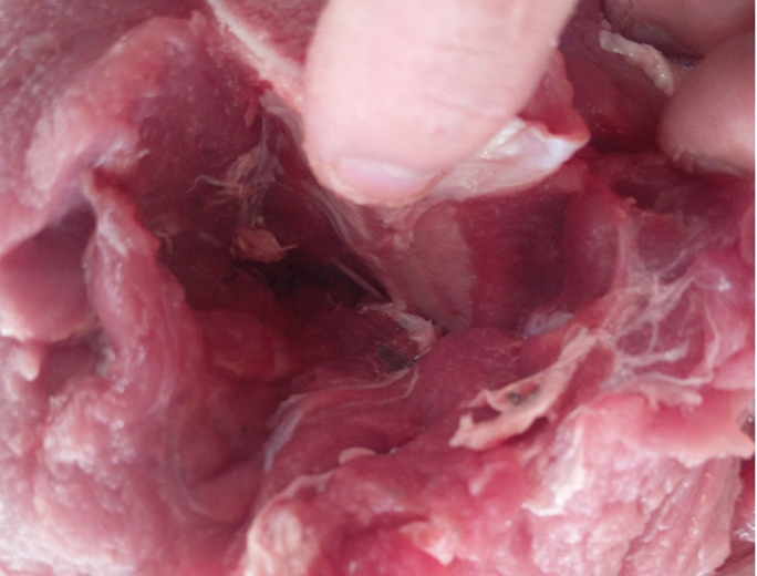

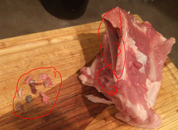

As part of preparing my dinner for this evening, I found that we did more damage than previously thought. I did hit the main bone, but at the worst possible angle! Still ended up with the bone fragmentation as indicated in circle 1. Circle 2 is the bone entry point. Circle three is where the energy appears to have separated tissue from the shoulder blade. I found bone fragments behind it.
The largest mushroomed piece of lead weighed in at 16.8 grains. Quick guess, that's a tad over 50% weight retention. I found the remaining lead and the sabot (not shown) about a half inch past my finger insertion. The true test of success is really how this looks coming out of the oven in 40 minutes!

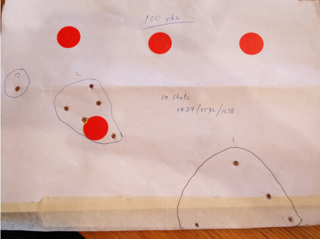

Took 10 shots at 100 yards just for the hell of it. After realizing the drop was more that I expected, held upper left corner and shot the second 5-shot group:
7053098
Not an epic fail, but failure non the less....

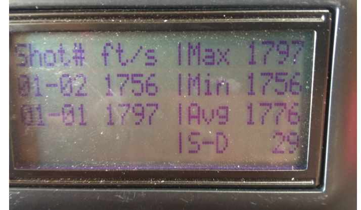

You know today is a new day. Regrouping. I did some quick max velocity testing. Best i can do at the moment is this:
7053468
Group is .8725 at 53 yards:
7053469

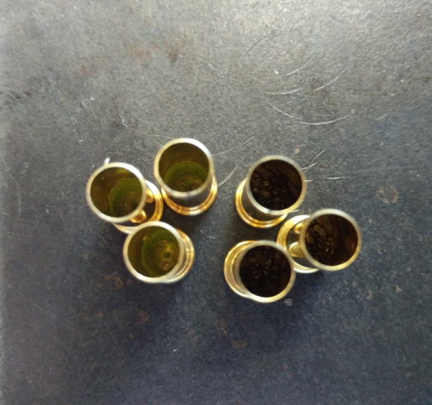

Brass cycles fine but you can see the rims swelling at this max load. A factory round on the left for comparisons:
7053478
Our test velocity baseline going forward will be slightly lower but still over 1700 fps. Trying to put a positive spin here for my own sanity. For a 35 grain bullet, I think I can say I have the fastest, most lethal and cleanest burning 22lr round. Next steps include baselining my own rifles accuracy with factory ammo and comparing results to the final velocity load in better conditions. Wind was pretty bad yesterday.

I also found an issue with the heel not forming/flowing flat due to trapped air. I have a manual work around for not to get it very close. While I don't think this is a problem, want to rule it out. If I can, I'll take a first crack at establishing a BC for the fast stuff. Will try and get my buddy's Anschultz 54 and give that a whirl as well.
Thx.

Calculating BC isn't difficult if you have a LabRadar (or 2 chronographs) and a good way to get accurate weather data such as a Kestrel:
The time consuming part is putting all the data into the JBM Ballistic Coefficient (Velocity) online calculator and storing your results. If you have the data from a LabRadar, I wrote some automation to read the values (copied to a text file), submit them online, and store the results. What took me 2 hours manually, the automation did in 15 minutes.
Latest update:
While I was unable to establish baseline testing with multiple rifles, I did get a start on an accuracy baseline for my own test rifle. In addition, I did identify some inconsistencies in my swaging process that have now been addressed. Version 2a is now complete. Two versions have been produced. Got side-tracked making a couple hundred rounds earmarked for GDS customer evaluations, but that is also now complete.
I intend to complete my next round of testing this weekend , assuming the winds die down. Pretty insane this time of year in AZ! I'm excited to finish up what I'll call Version 2b and produce a capabilities video I promised a few weeks ago.
Almost there. Stay tuned!
AZ

I'm taking the day off tomorrow to:
a) Finish up my Savage B22 accuracy baseline.
b) Test rounds without sabot ( both normal and higher velocity).
c) Sight in and test with my buds Anschultz model 54.
Got side tracked with personal shit, taxes and Easter. Had a friend test the normal velocity stuff (1290 fps) out of his suppressed 22lr. No fictional issues whatsoever. I will be making him some subsonic loads to test next opportunity. I did however find a problem with my crimping. It was identified with the Anschultz while just chamber testing. It jams the dam bullets into the rifling! Have to go to a smaller collet crimp die and machine a tweak to it. Should not be a problem going forward.
Looking forward to some relaxation tomorrow. Wind should be manageable I hope.
