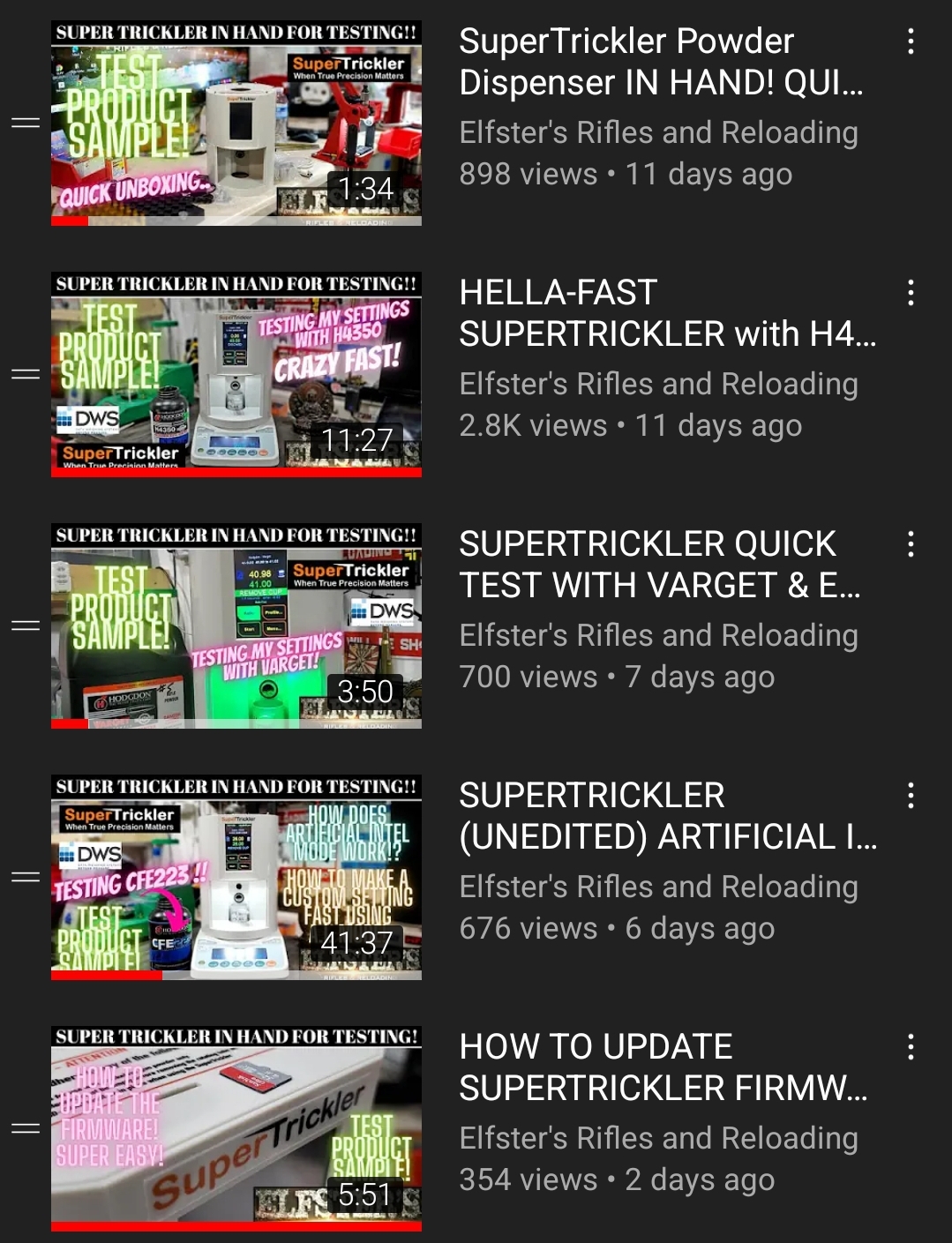

I don't see myself using my v3 anymore. I should have my final review, overview, and how to get quick settings and dropping powder video uploaded in the next week or two. I really like it so far. At first it's kinda overwhelming but once you get an idea how it works, the numerous settings are welcoming.

You don't need to undo the wire. You just pick the unit up slightly tilted back, hold the discharge port over the jug, open port hole, dump, close port hole. Super easy. I'll show how easy it is tonight in the live event
just went live here:
Nice job showing the run of the menus and parameters.
It is obvious you have put time into tuning the parameters and know your way around the software.
I appreciate not editing out the overthrows or glossing over the draining procedure.
