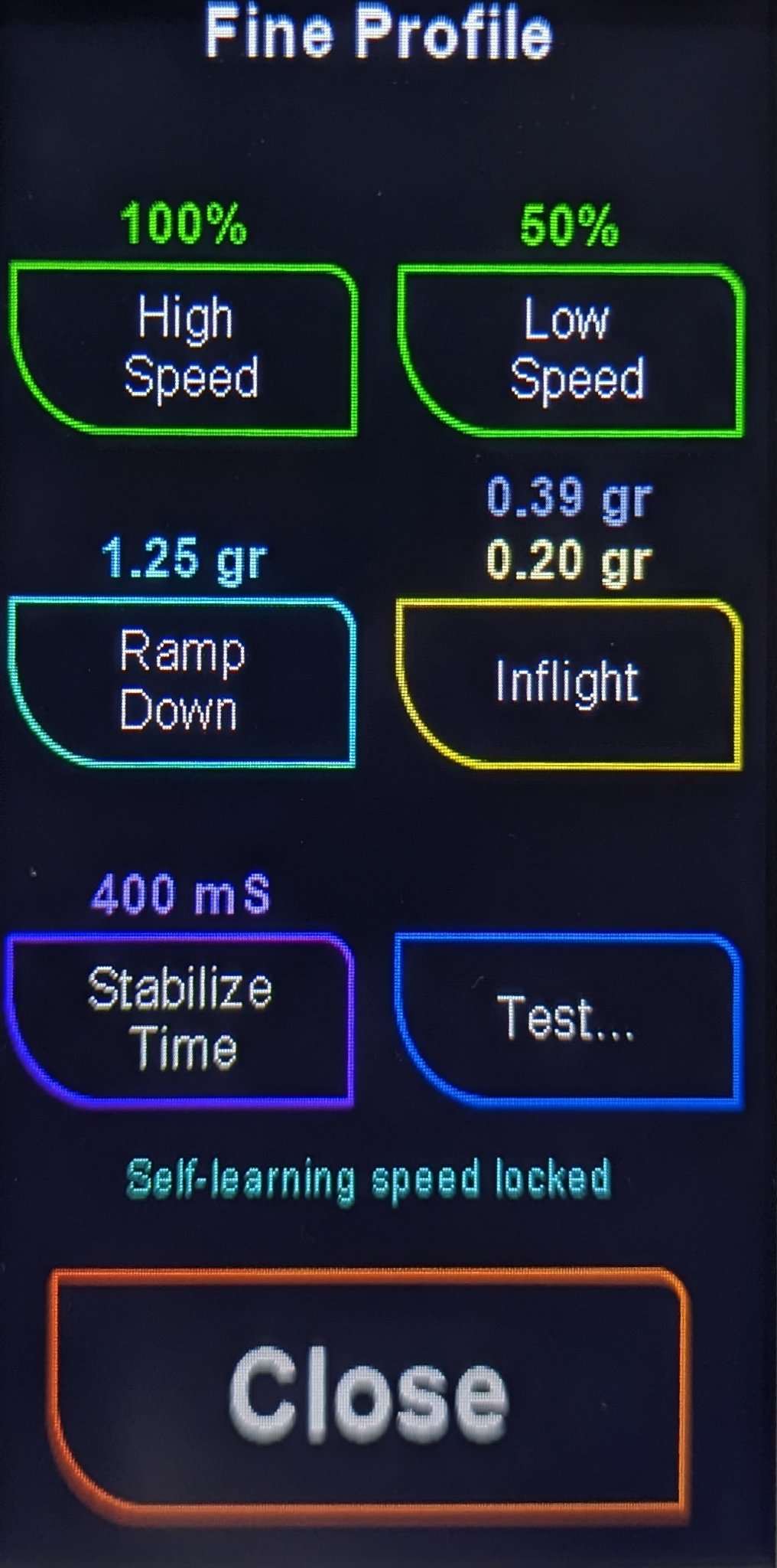

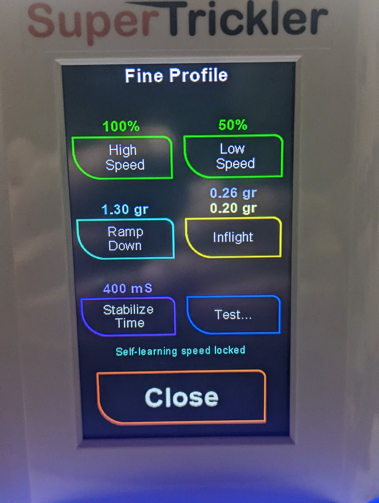

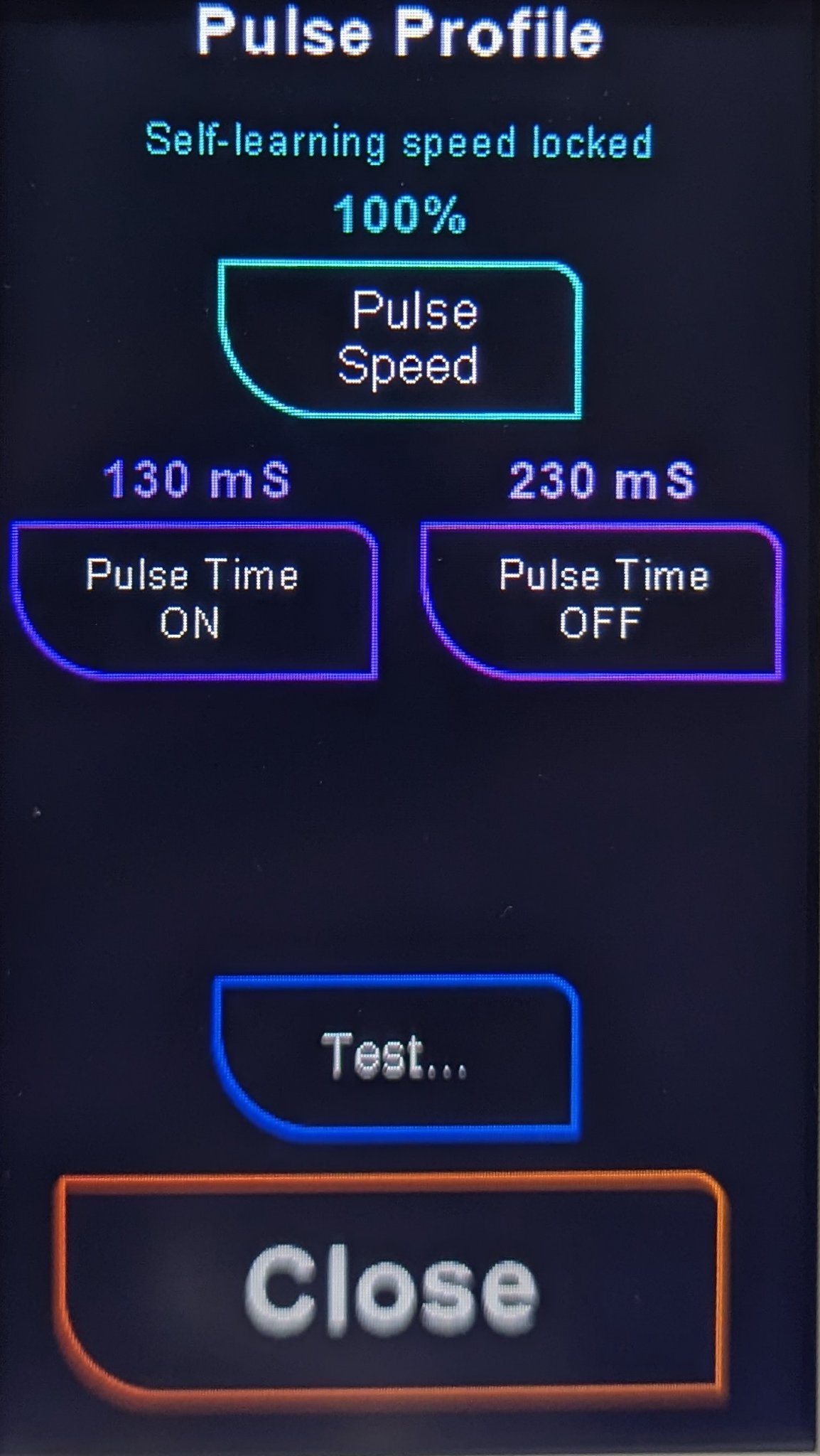

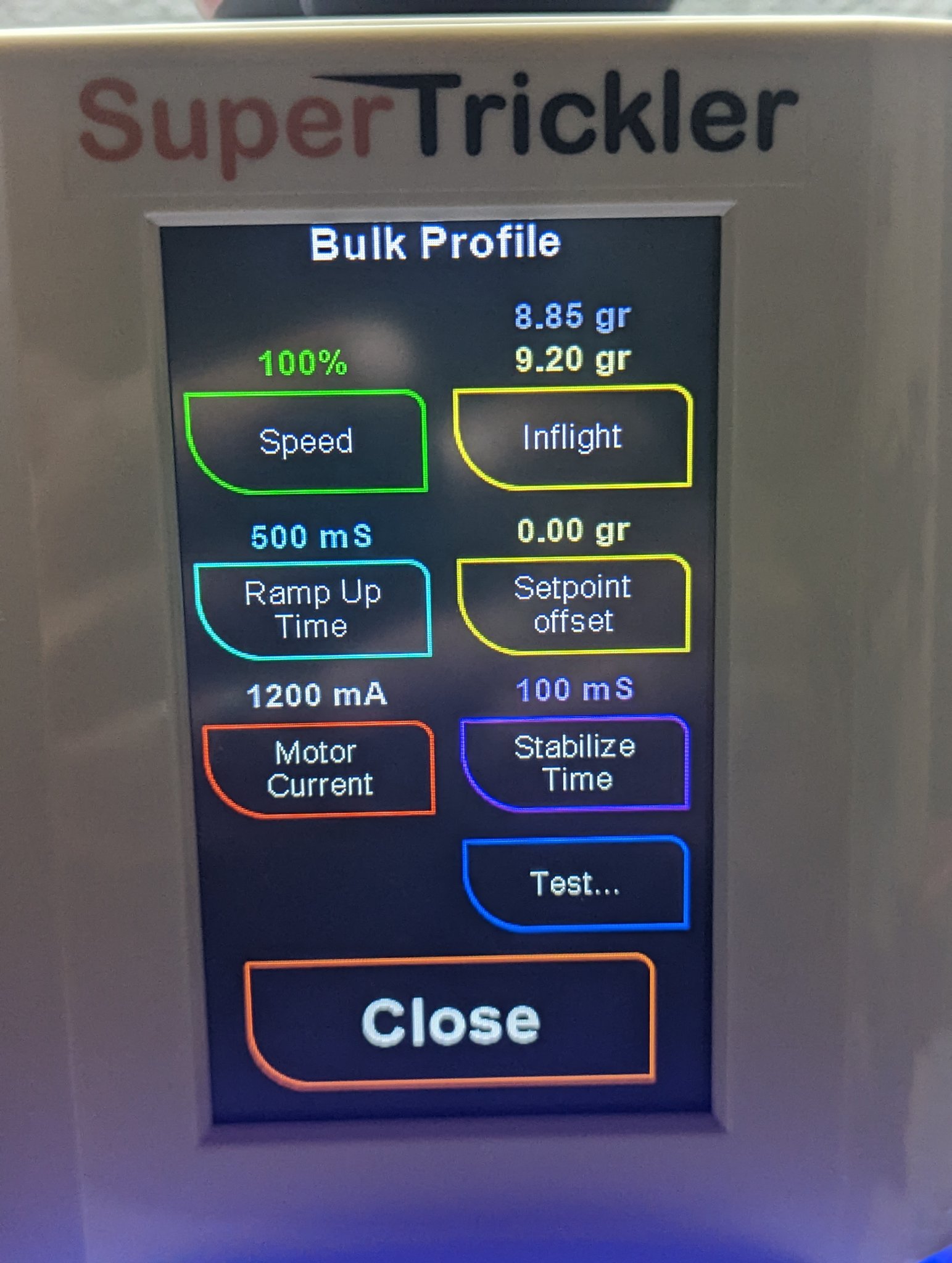

Also played around with manual mode... My settings below. Getting consistent 5-7 second drops with ease. Tweak as needed.

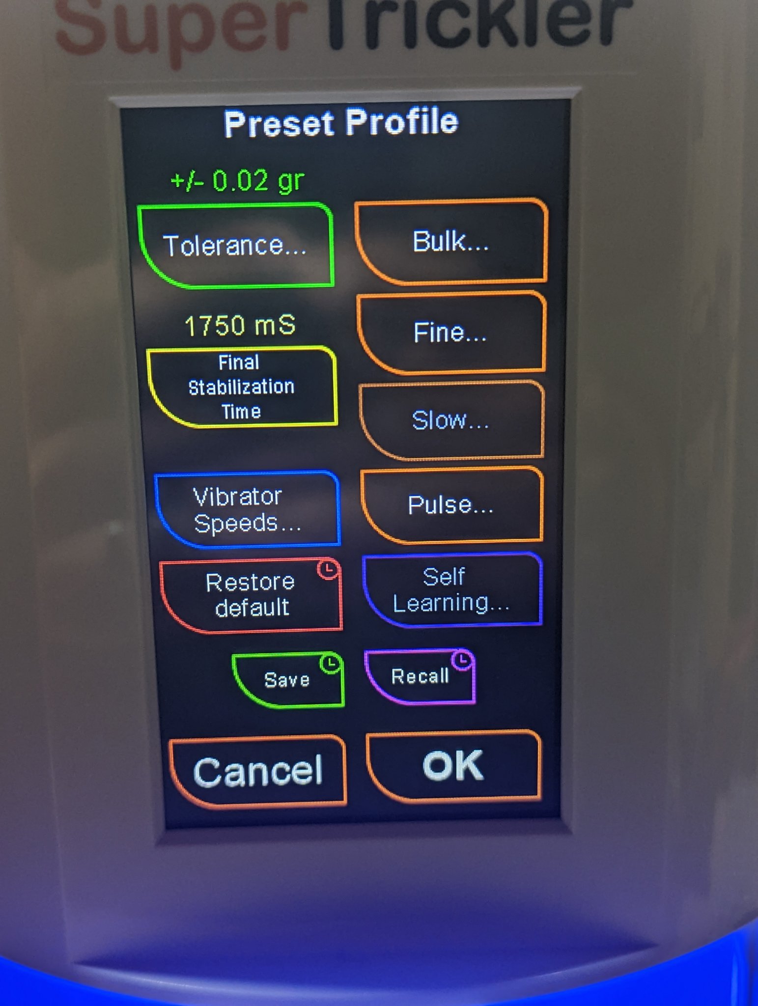

For those with a SuperTrickler .. Use this information as you want. This is just MY experience as a beta tester. 👌⬇️
V2 is good.
Install v2 firmware
Restore that powder profile
BEFORE you do anything, set the min and max trickle speed. Set the Min just so it's damn near trickling out spec after spec but with good speed, and max fast as possible till powder is almost coming out of pan.
Run the powder drops from powder restore WITH AI so it can learn the general setting parameters for you.... after about 40 drops, and if you feel like it's dropping consistently but with good speed, then turn off AI (ai might already have turned itself off by then)
Then, if you want, tweak the BULK, FINE, AND PULSE settings to fine tune consistency vs speed... and compare your settings with what AI was doing previously in regards to performance (consistently dropping powder vs speed = this is up to your preference).
The main goal of the supertrickler is to have AI do everything rather than you tweaking IMO.
If you feel you're not getting the performance you'd like, then repeat the above as AI WILL LEARN differently on the 2nd go around. The ultimate setting are your settings, and your settings only.
Hope this helps
