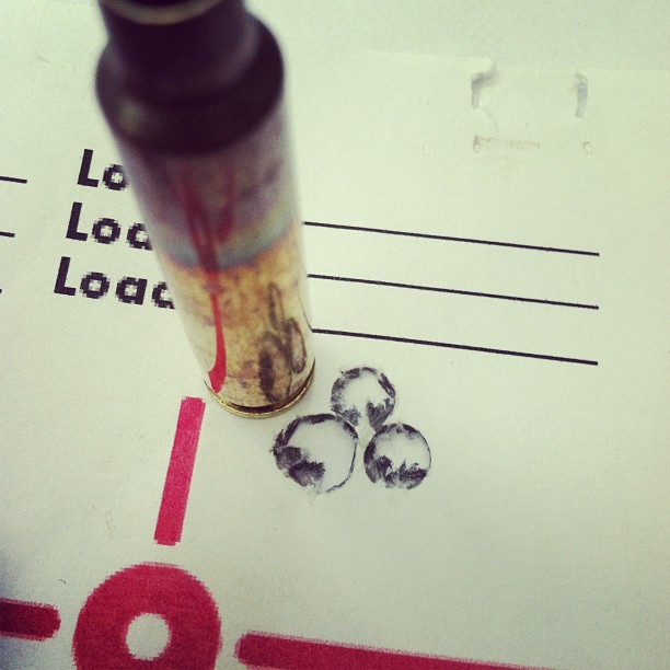

223AI through an SWR Omega(pre 300 model) 5 shots at 100 off a bipod.
I've never had issues with my AR or Ackley through that can.
Barrels were threaded by CLE and APA.
