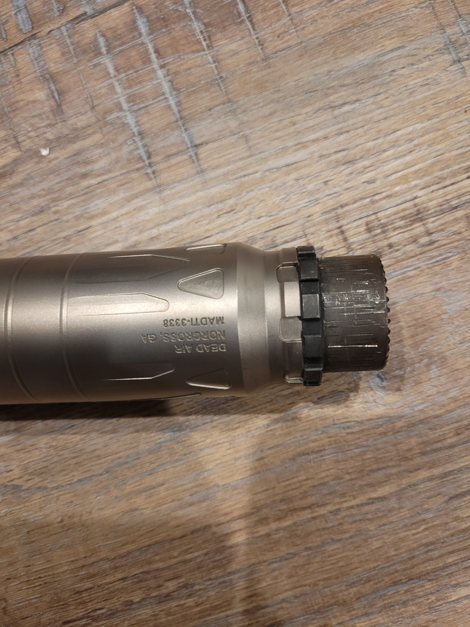

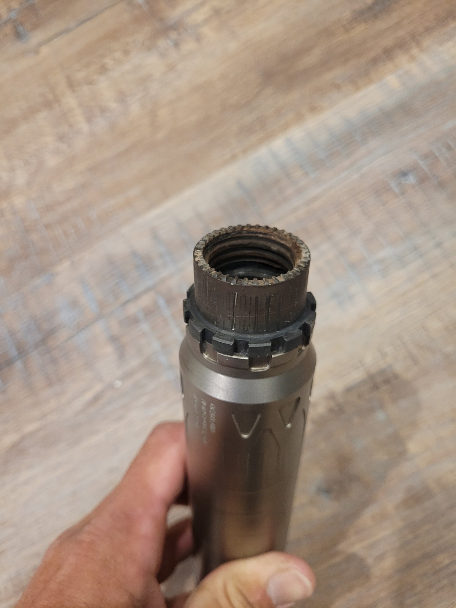

    Well, I have some Titanium brakes and Ti mounts on the way, so I go to remove one of my steel- YHM- phantom mounts from my Nomad Ti, and that thing will not budge. It has nothing accept possibly some copper antisieze on it (though given the situation that's doubtful).
    I tried heat, I tried putting it in the freezer. I don't want to mess my can up but I'd really like to get this thing off. Sending it back to Dead Air is a no go for obvious reasons.
    I guess I need to invest in a good strap wrench? My last one broke and I haven't replaced it so, if that's in your suggestion, what's a good one for this purpose?
    Any help would be much appreciated.

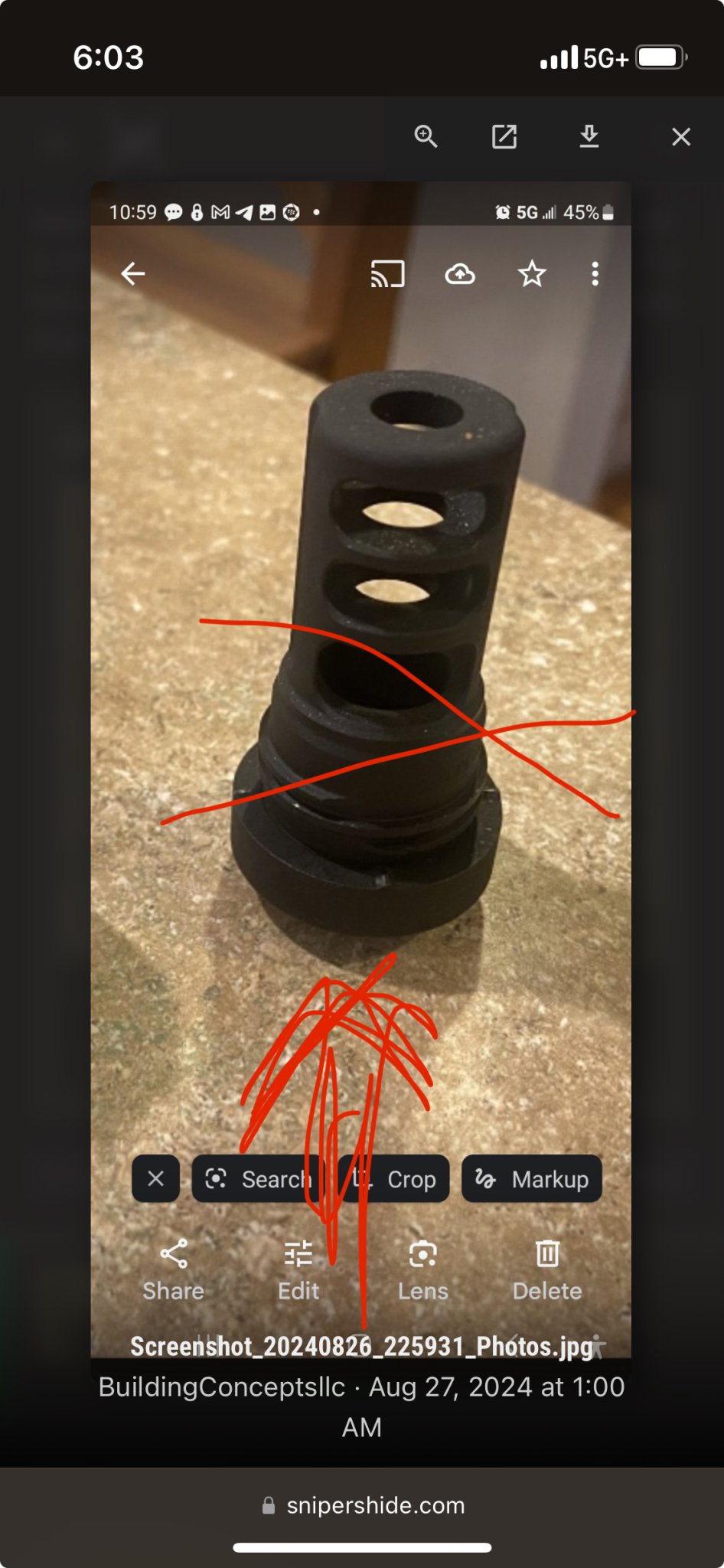

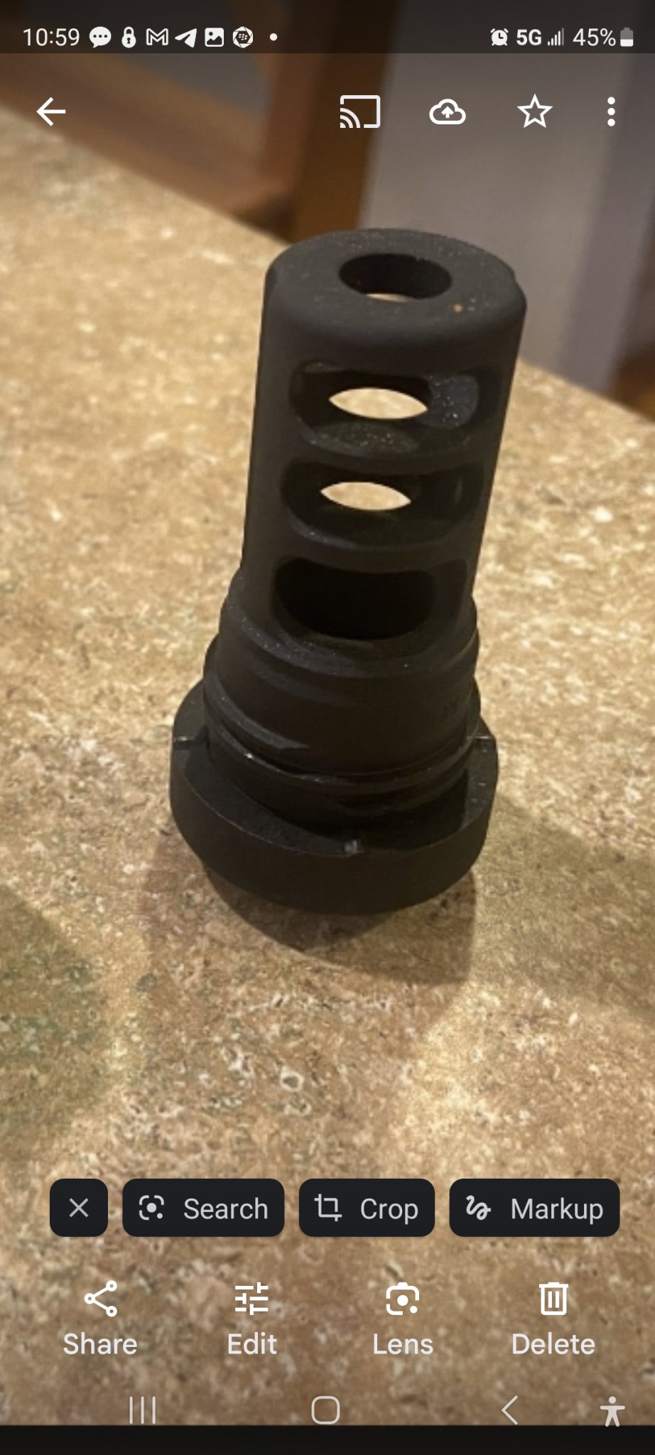

    I don't know if that yhm thread will allow that but I'm hopeful this new vise block thing and better spanner wrench will do it. That yhm brake thread is what I'd have to screw into and I don't think it's fine enough to do that. This is a brake that shows that thread

    If I understand this correctly, you have the QD stuck inside the suppressor? You keep taking about the wide spacing of the YHM mount, but you need to focus on finding a jam nut setup in either 1/2-28 or 5/8-24, NOT the qd pitch.
    No. Thats where the brake goes onto the barrel. That isn't the issue that I have

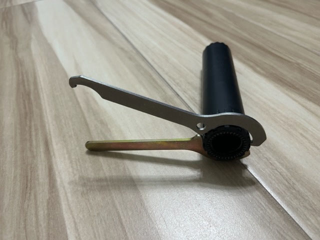

    The YHM can should have come with a set of spanner wrenches, and both the can and the phantom mount have indexes for these wrenches. You can buy a steel spanner wrench from YHM. The brass/bronze wrenches they ship are soft and will eventually bend break (ask me how I know). I usually index the wrenches on the can/mount with everything lying on the floor, such that the floor is applying opening pressure to one wrench. Then I tap on the other wrench with a rubber mallet until it all pops free. Works every time.
    The nomad also uses a spanner wrench. Same trick… I’ll try to create an image if you’re not getting what I’m writing…
    This is the wrong wrench for the mount (I sheared the lug on my other brass spanner), but taps/hits downward on the silver colored wrench will break the mount free…
