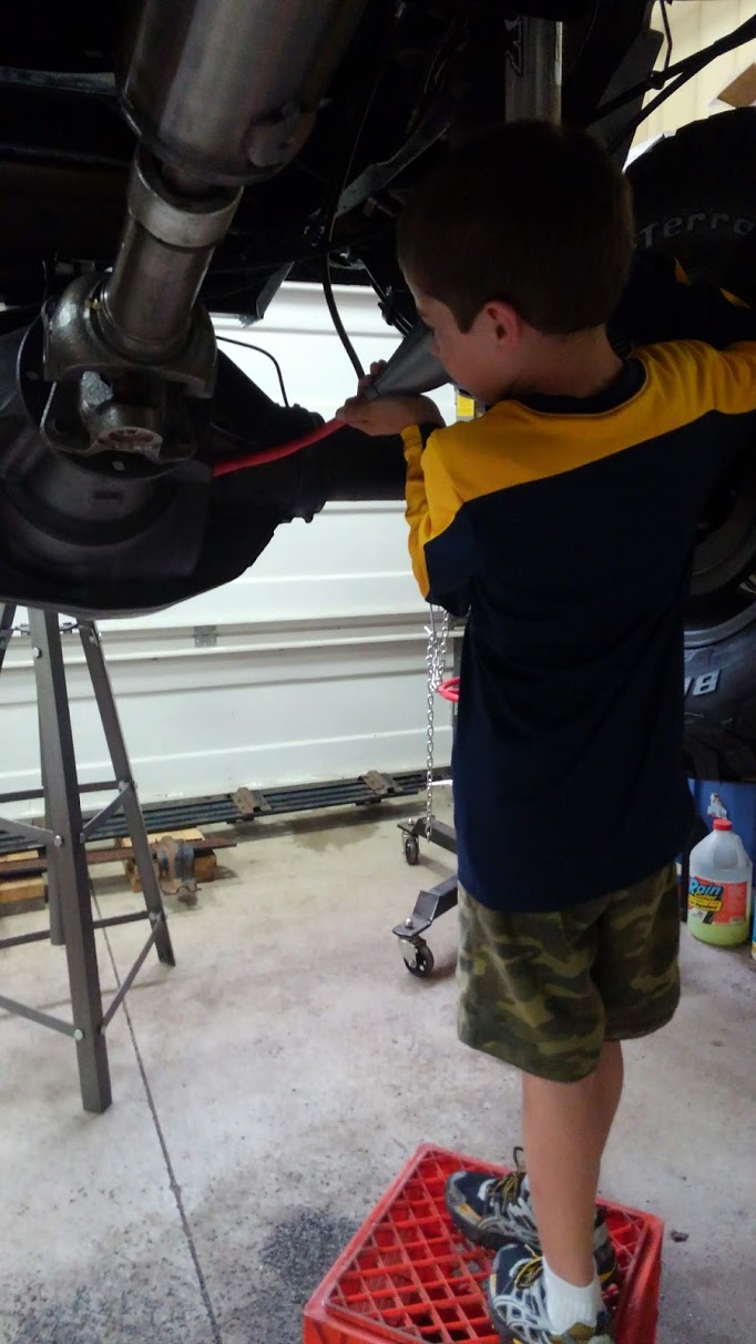

That and many differentials don’t have a convenient drain plug so most people just leave it. My favorite tool for refilling a diff is the cheap hand pump with a long hose that screws into 5 quart jugs of gear oil, makes it really easy to pump fluid from a weird angle under low cars on stands.
