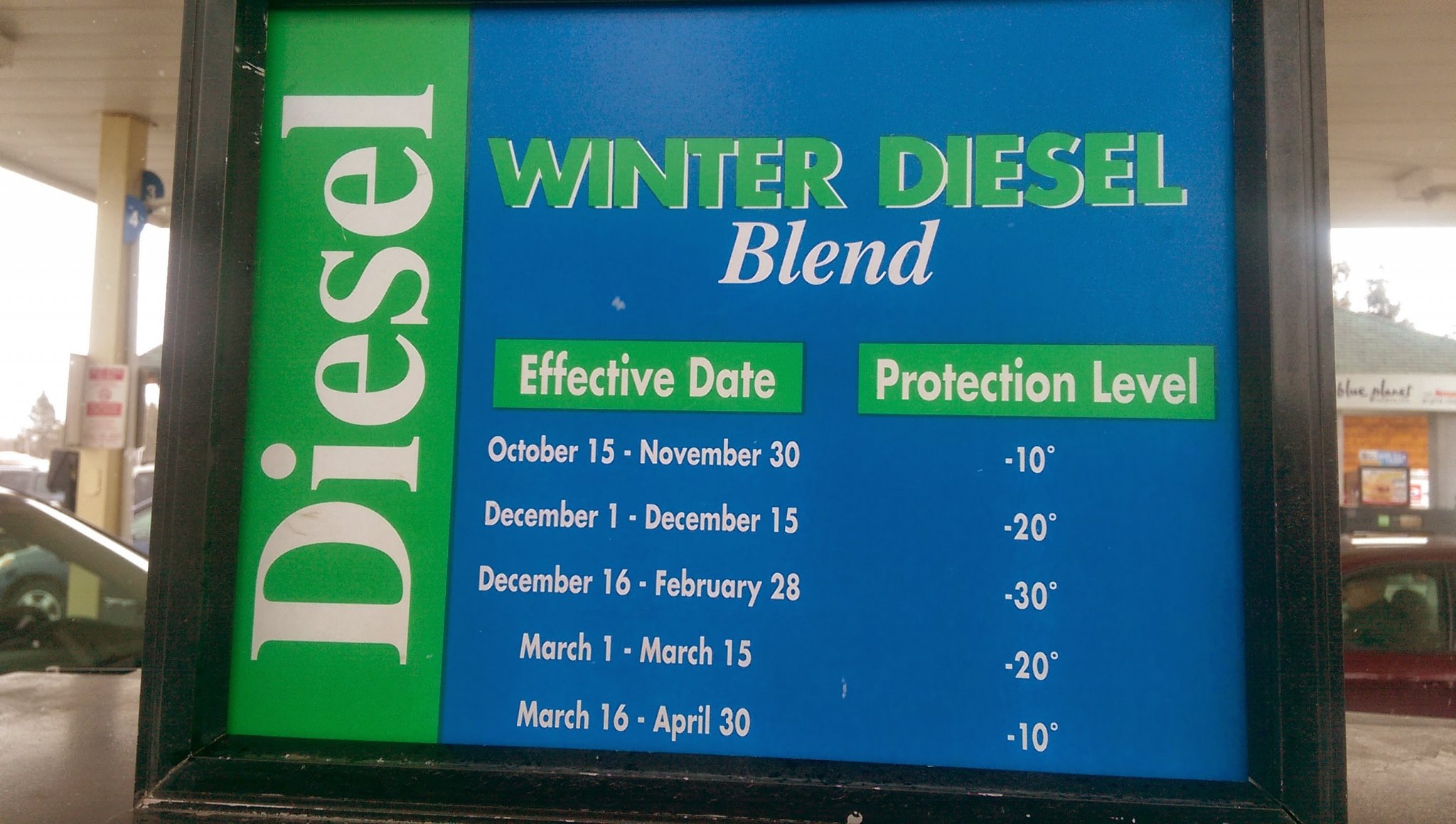

The difference between #1 and #2 is the "gel point" or "cloud point", which is the temperature below which the paraffins and heavier fractions will begin to solidify. Obviously, cold-weather operation requires a lower gel point, but removal of the wax and heavy fractions results in a fuel that lubricates poorly (important to the injection pump), doesn't ignite as easily (heavier fractions break apart more easily) and doesn't contain as much energy.
Older engines burn #1 just fine, and I remember when it was offered at the pump as a motor fuel for cold-weather use. The old-timers here can probably tell stories about mixing #1 and #2 according to the expected weather.
No way in fuck that I would run anything but straight #2 in my modern diesels.
Reactions: Jefe's Dope
As you're based in MI, no way in fuck are you getting anything except a non straight #1 + #2 blend in your "winter diesel".
Agreed:
That's from a fuel station in the UP. I'm thinking our downstate pumps are probably serving up a somewhat higher gel point. But your point remains.
My counterpoint would be that there is a difference between that pump blend, and me dumping in random amounts of kerosene or whatever additives are being pushed inside the gas station convenience store.
