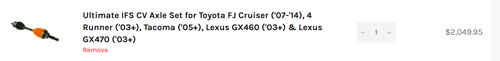

Here's another option, yea, $2k and you'll install them yourself, though these things are supposedly built in crazy fashion... so, buy once cry once?
This is your, "I want to destroy my Dif, driveshaft, transfer case or so on instead of my CV axle" option.

Here's what RCV (Company that makes those $2k CV axles) has to say about that. This is from the description for those very axles.
" Even if you have big tires and big power there are no worries. Ultimate IFS CV Axles are low maintenance, and are backed with a "No Questions Asked" limited lifetime warranty against breakage. Our IFS CV axles meet and exceed the strength of a straight axle swap, while allowing you to maintain the traction, smoothness and control of your IFS."
And $2k, while expensive, would be way less than a solid axles swap, but also, $2k, for the pair, tends to only be about twice as much as the Reman axles from CVJreman.
It's a hit to the wallet, but not exactly horrible.
Though again, them holding up means that the abuse you're exerting on them ends up getting transferred elsewhere, though may not be enough to damage those components... all depends upon what a guy is doing.
I had never seen these axles from RCV performance, but I'm going to look at them more, myself, for my FJ, they do seem like the "buy once, cry once" option. But I want to see who's running them on their Toyotas and how they are actually performing, though there doesn't seem to be any doubt that that company knows how to do CV axles in general.

As for the $2k axles, I’m not sure. I’d replace an axle all damn day before I broke a front diff. Axles are expendable.
