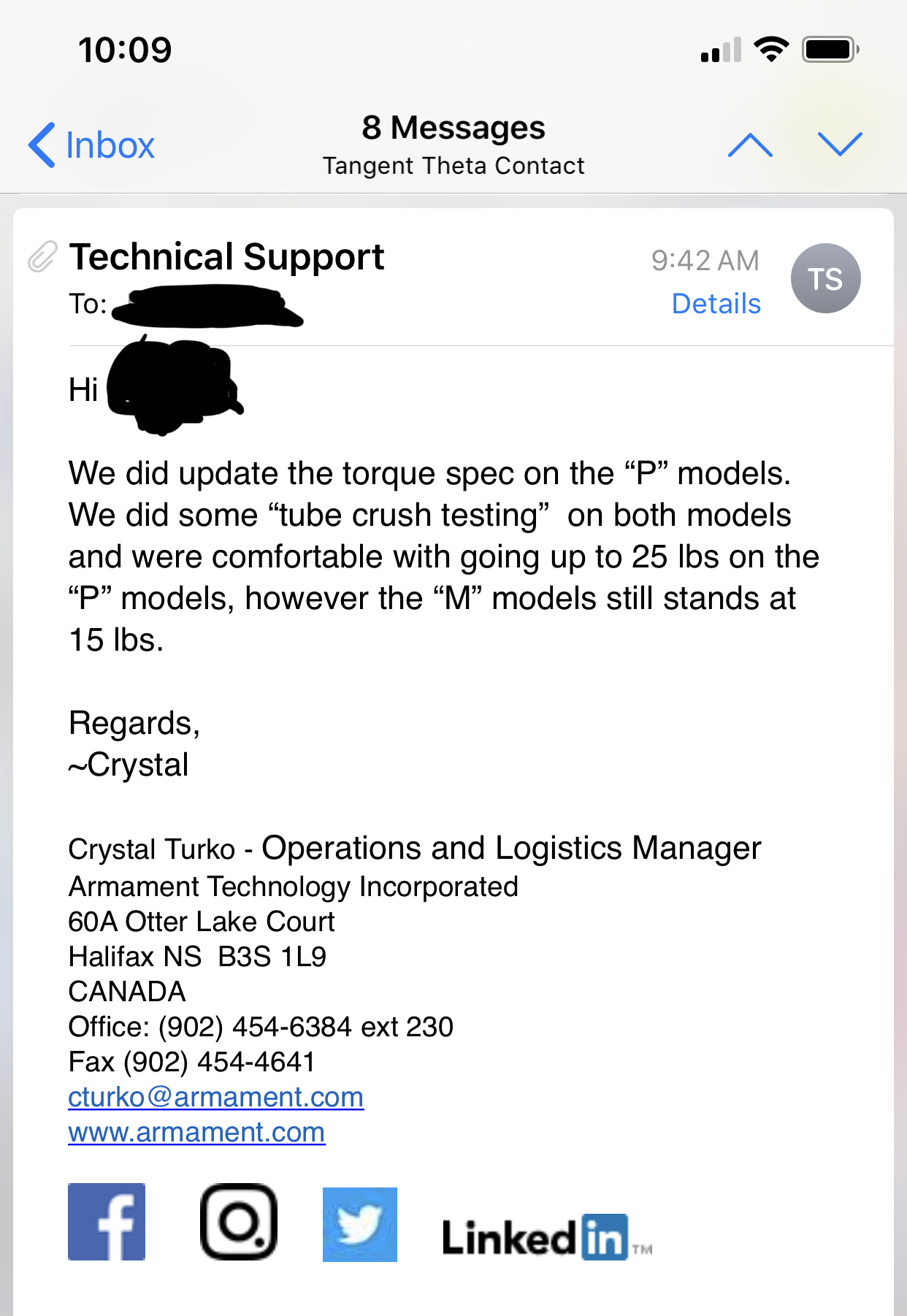

    Looks like Tangent Theta changed the spec from 15in lb to 25in lbs on the new ones. Checked multiple new manuals. Figured I'd bring it up since it was talked about greatly about parallax issues in the past...

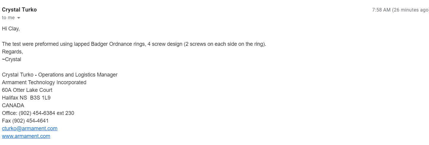

    You can email Crystal Turko at ATI for clarification to be sure...
    Please post TT's or ATI's response to the question. I'd like to know. Both of my TT scopes' literature say 15 in/lb. I wonder if they simply increased the spec on paper or if there was a production change on newer units. I do know TT constantly updates their production process for little things here or there. For example I do know they changed the supplier and type of adhesive they use for internal parts. So it's possible they changed something, allowing for the scopes to deal with more clamping force.
