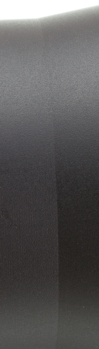

918V, here's the pic you asked for:
The clicks aren't dead perfect with the indicator on this scope. They aren't so bad as it appears in the video though. The camera angles are making it look a lot worse than it is. They are clicking in the same place throughout the entire travel, but they are off by maybe 6-ten thousandths or so. Nothing that would lead to me not knowing which click I'm on. I did like the slip-scale feature on the Premier's for this reason though. You could line them up just in perfect alignment without much effort. I'm going to talk with TT this week about it. I'll let you guys know what the response is.
Thanks for the pic. The transition is nice and square. I had a scope where that transition looked like the main tube pinched inward just before flaring outward. It looked like a POS considering the cost.
Looking at the inside of the turret cap, there are three torx screws. I wonder if there is enough wiggle room to make the cap line up right?
