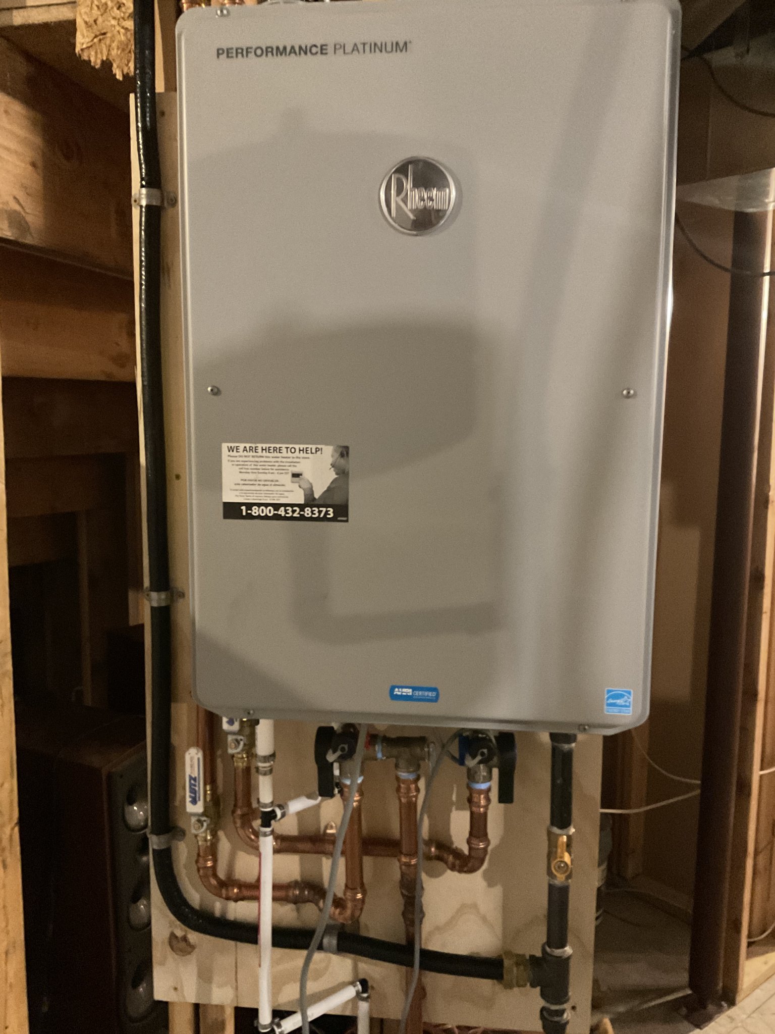

I built a pole barn on my small ranch in central Oregon, complete with two small apartments for family and friends, and maybe someday to generate some income. I installed the tankless water heater below, and it's been amazing, especially for a property that sits empty most of the time when nobody is visiting. The only down-size is that for a water heater that is bulky enough for a residence, it (at least this one) required three 40-Amp circuits ... luckily we were building at the time so it was easy to plan for this. Retrofitting existing space might not be so easy. That said, we are super-happy with this tankless water heater, and for the last half-dozen years, I've been waiting for the water heater in my ranch-house to fail, so that I'd have an excuse to go tankless in the main house.
Also you should have CPVC on hot side PVC for cold water only.
I’m not sure if you’re referring to my picture above your comment or if you were just stating that in general, but the PVC pipe you see in the picture is for the condensate drain. You cannot use metal fittings for condensate water because of the pH of the water.
The exposed red PEX pipe is the T&P safety valve.
The three insulated lines coming down the wall are the hot cold and recirculating pipes, which are also done in PEX pipe.
I wouldn’t run CPVC pipe in my doghouse that shit gets brittle as hell after a few years, especially on the hot side. I would rather have polybutylene pipe with the metal fittings, than CPVC.

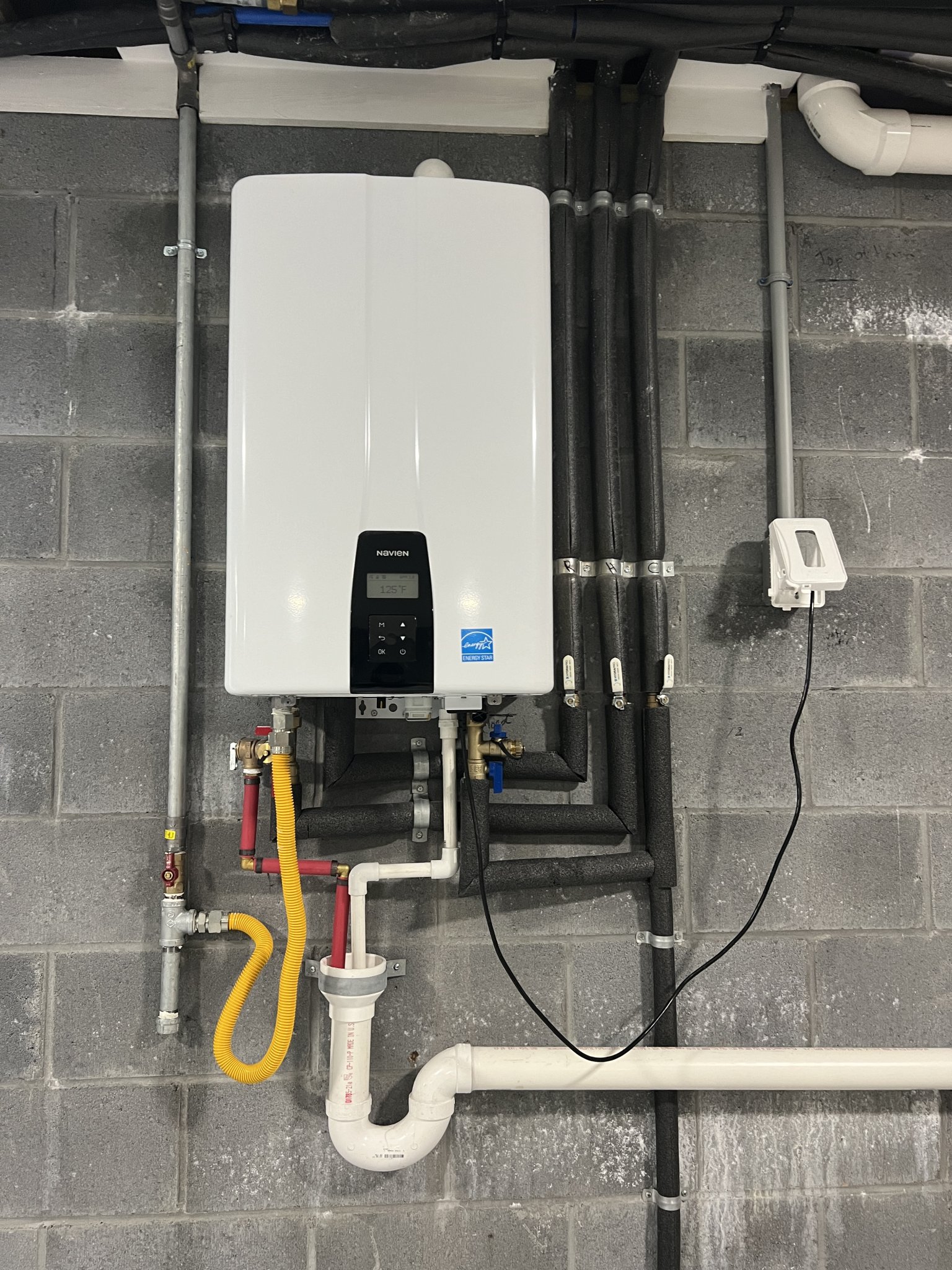

I have two Navien powered by propane, they work great and they are set to circulation. Prior I had a 75gal WH and two 36gal boilers. I did have to install a whole house water filter with a brine tank because of the hard water. Getting rid of the hydronic heating and switching to heat pumps , going to tankless has cut my utility bills in half. I pay .05KW for electric and propane is expensive. I would not do it without natural gas or propane. I also have an all copper water pipe house.

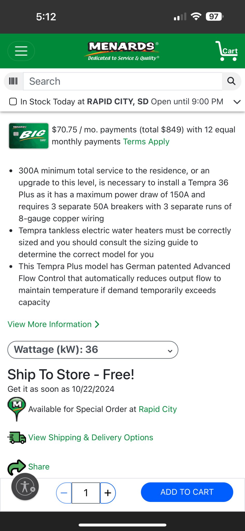

This sir might be a smaller unit
I thought there was no way I was seeing this correctly so I had to take a pic to share it with some folks.
I was in Menards I believe waiting for a worker to get me something. While standing there waiting looked over the specs on those things. Some were over 100 amps.
