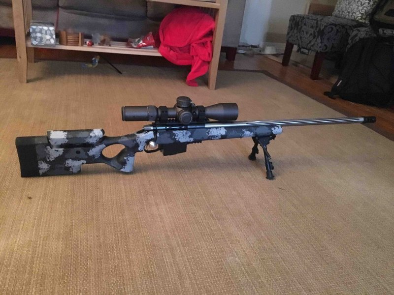

That is a very nice rifle! Can you provide the description of the build and what does it weight scopes?
Sent from my iPhone using Tapatalk
Weight is 16lbs without the can 17lbs with.
6.5x47L
GAP Tempest
Bartlein heavy palma finished at 23" 1:8 with .123FB
Manners T4A Elite tactical fill with DBM Minichassis
Timney 2-stage CE
Atlas Bipod
Bushnell ERS in that picture though it's been sold.
