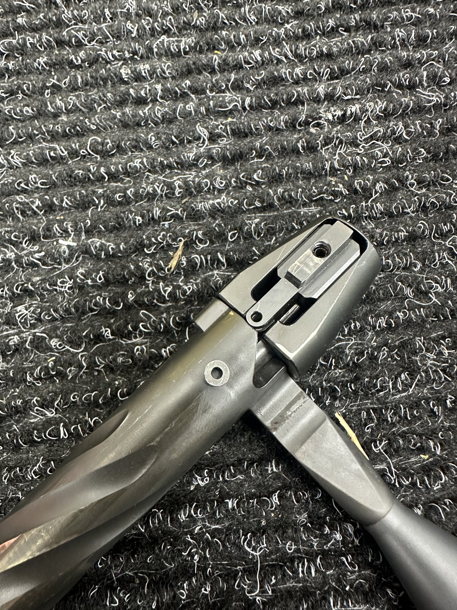

Anyone know of any long-term detriments to frequently swapping barrels on the QC action?
I currently run 4 different caliber barrels on my QC action for various tasks, and I have been concerned that the high frequency of barrel swaps may cause issues in the long run. Anyone know of issues that may arise with the action threads from these changes? I am careful to follow all protocols on proper barrel replacement each time.
Along the same line, is there an issue with routine removal and replacement of the action screws to move the action from a competition chassis back to a fiberglass stock? I am careful to make sure no cross threading occurs and I use proper torque values each time.
I am not an engineer so I don’t know if this is a legitimate concern or if I’m completely off base.
Reactions: Dolomite
As long as you don’t destroy the threads in the process, it should be fine

Well this certainly jammed up my action mid shoot today.
  • Wow
Reactions: Dolomite
Is that the roller on the cocking piece?
Yep, pin is gone, roller jammed between the shroud and cocking ramp (I’m guessing), and wouldn’t let me unlock the bolt. Look. Lot of shaking and wriggling and eventually the roller plopped onto my lap and the bolt was functional action. I guess I should email about a replacement pin.
If he says what caused it or how to prevent it can you post about it please?
