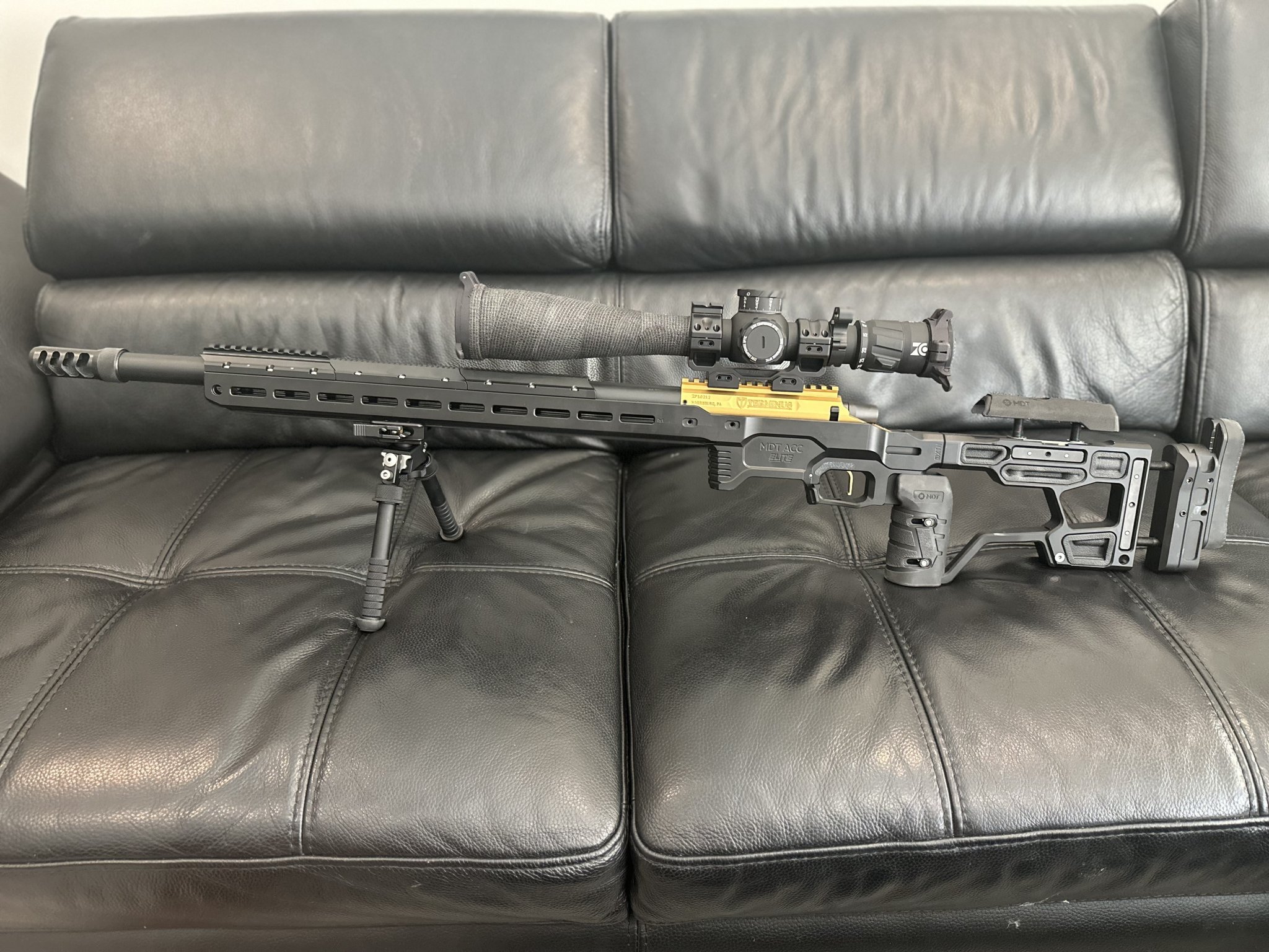

Just a picture of a new build I finally put together.
