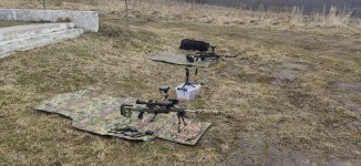

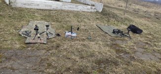

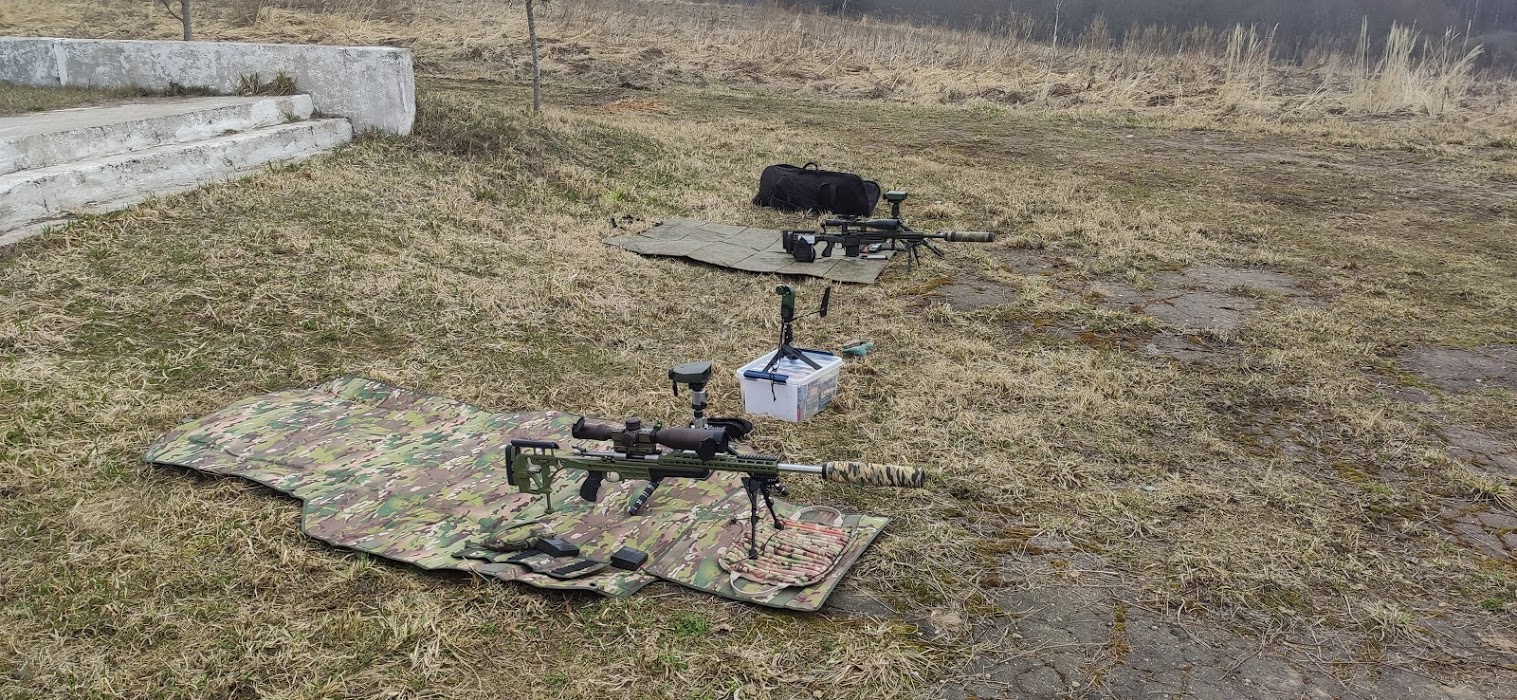

I went to the shooting range and it was my first surprise the Terrapin X digital mark is 2-3 times more than the original Terrapin. From 600 m small targets (10-15 cm) Terrapin X does not measure.

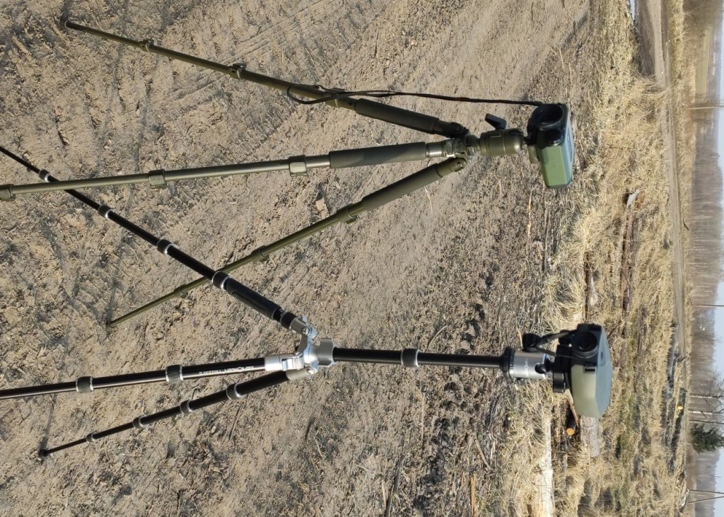

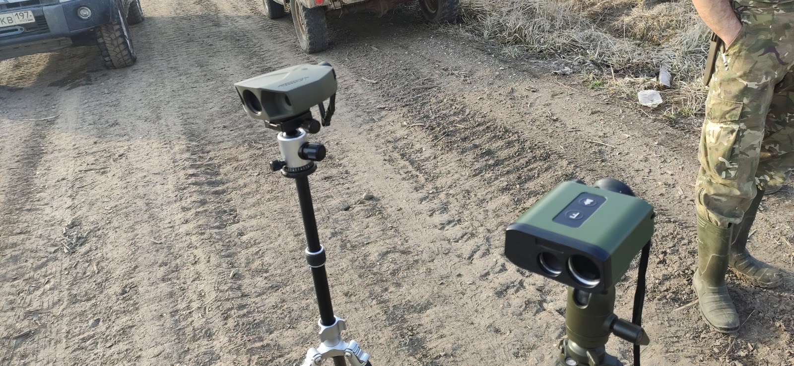

The measurements were taken from tripods, placing 2 rangefinders side by side. According to performance characteristics, the Terrapin X beam divergence is less than that of the old one. It was amazing for me too.
For example: target with a diameter of 20 cm is mounted on a thin reinforcement, a distance of 740 m. A pointer with the number of the target is installed next to it. The pointer is measured by Terrapin X, but the target itself is not. The beam passes through it and rests against the embankment of the shooting range, showing 820 m.
Old Terrapin clings to this target , the number 740m blinks and the next press shows the distance to the embankment 820m.
At a distance of about 600 m, target is installed on a wooden leg. So Terrapin X detects the target, but does not. And the old Terrapin easily measures both the target and the leg .

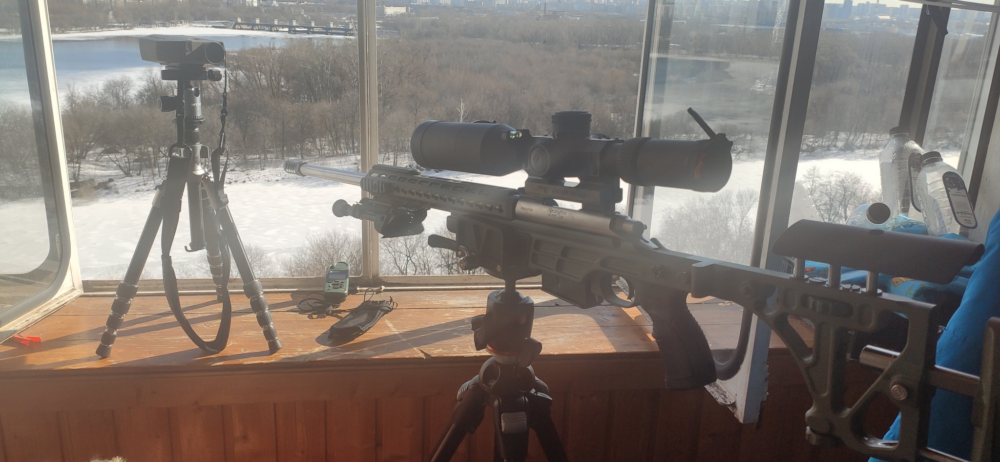

At a distance above 500 m Terrapin X does not see a duck on the water from a height of the 16th floor.
Those measurements are taken from a height.
