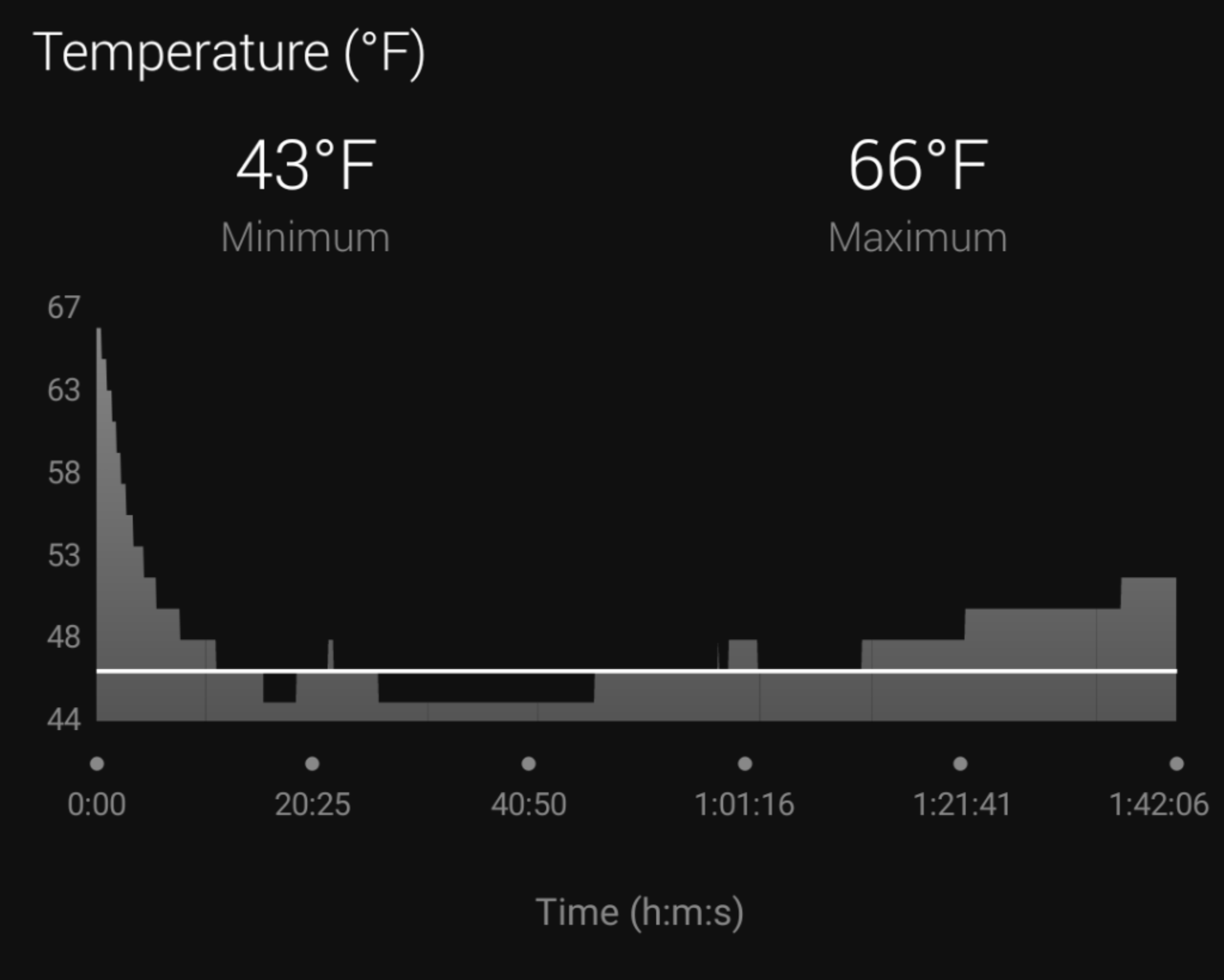

It was 58 degrees at 7 AM here today in SW OH.

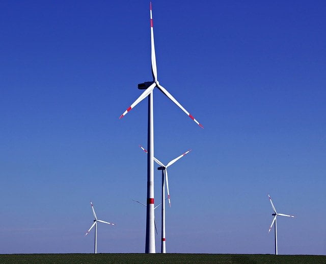

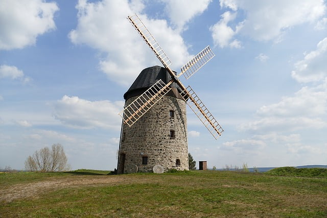

If you think windmills will replace something...
