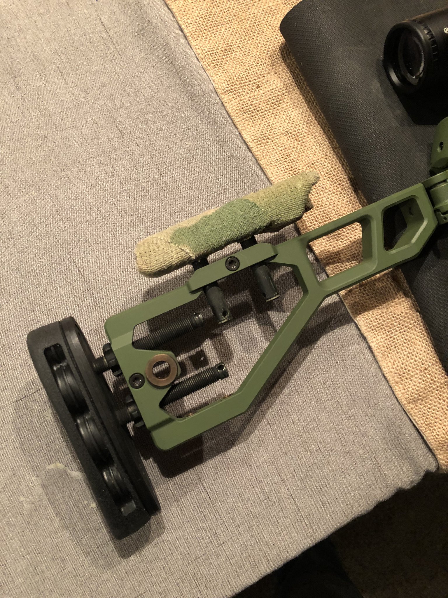

Oh and I modded the buttpad Mod. It’s a half Jurassic Clark half LvMike. Saves 1.25oz. But gives up the up and down adjustment. I don’t see myself needed the adjustment since the limbsaver is so much larger than the stock pad. So I’m gonna try this.

#buttpadmod shout out to @JurrassicClark for this brilliant idea. Works like a champ. Little dremmeling is involved if you insist is be straight which I do haha. But it was easy.
Limbsaver 10806 from Cabela’s
2x 1/2 long 10-24 TPI bolts from Lowe’s
2x 10-24 TPI nuts from Lowe’s
Total cost 39.24 after tax.

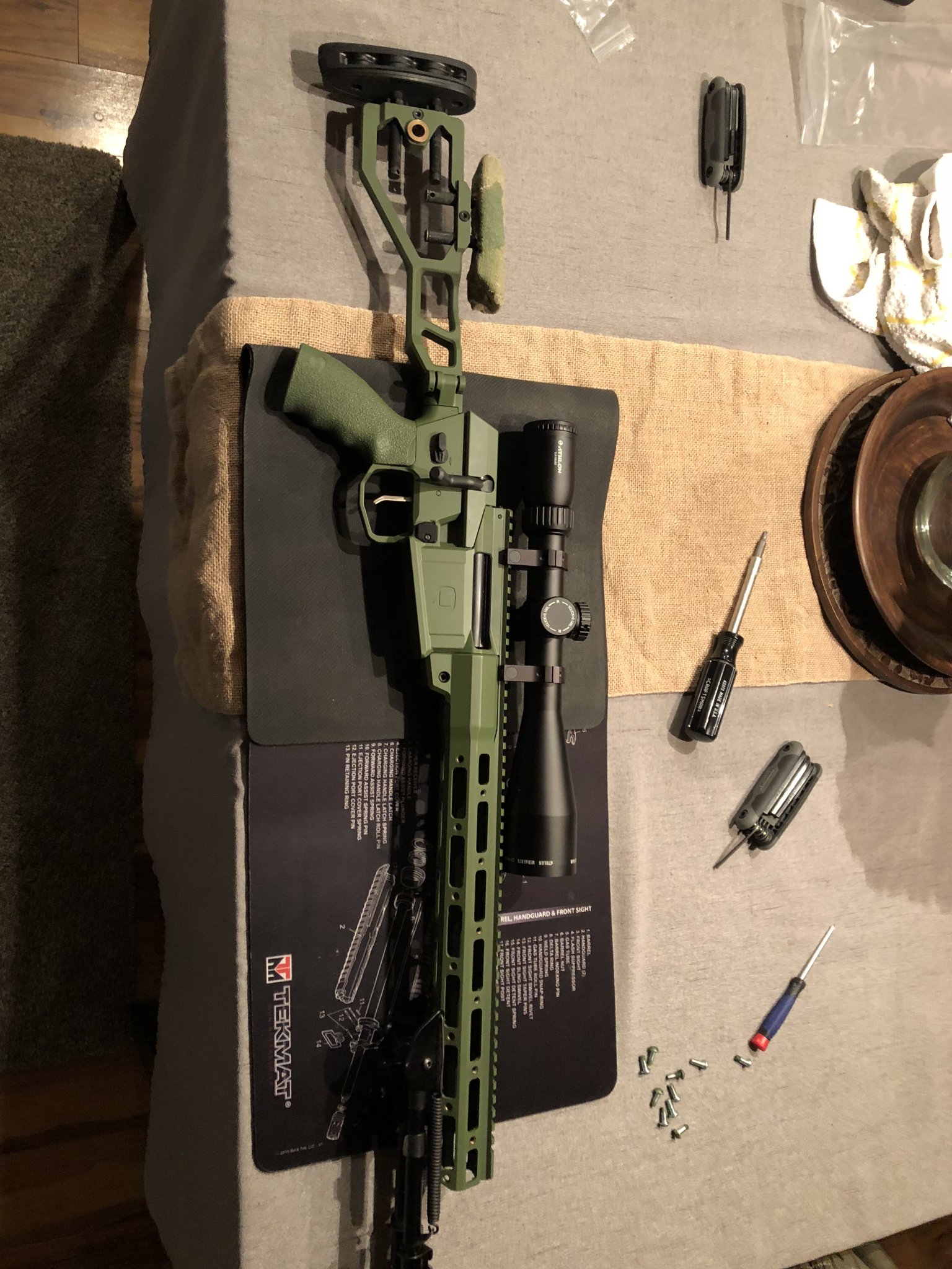

So I painted my Fix green with aervoe. According to my scale it added 3/8oz worth of paint. I would have guessed it would have added more. I weighted it with the screws in place too btw.
The screws did retain the copper looking color of the Q sert inserts while protecting the threads.
Pics to follow. Needs to cure for another day or so.

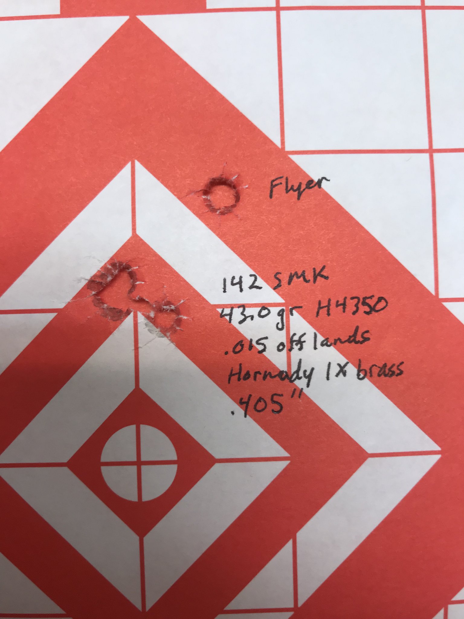

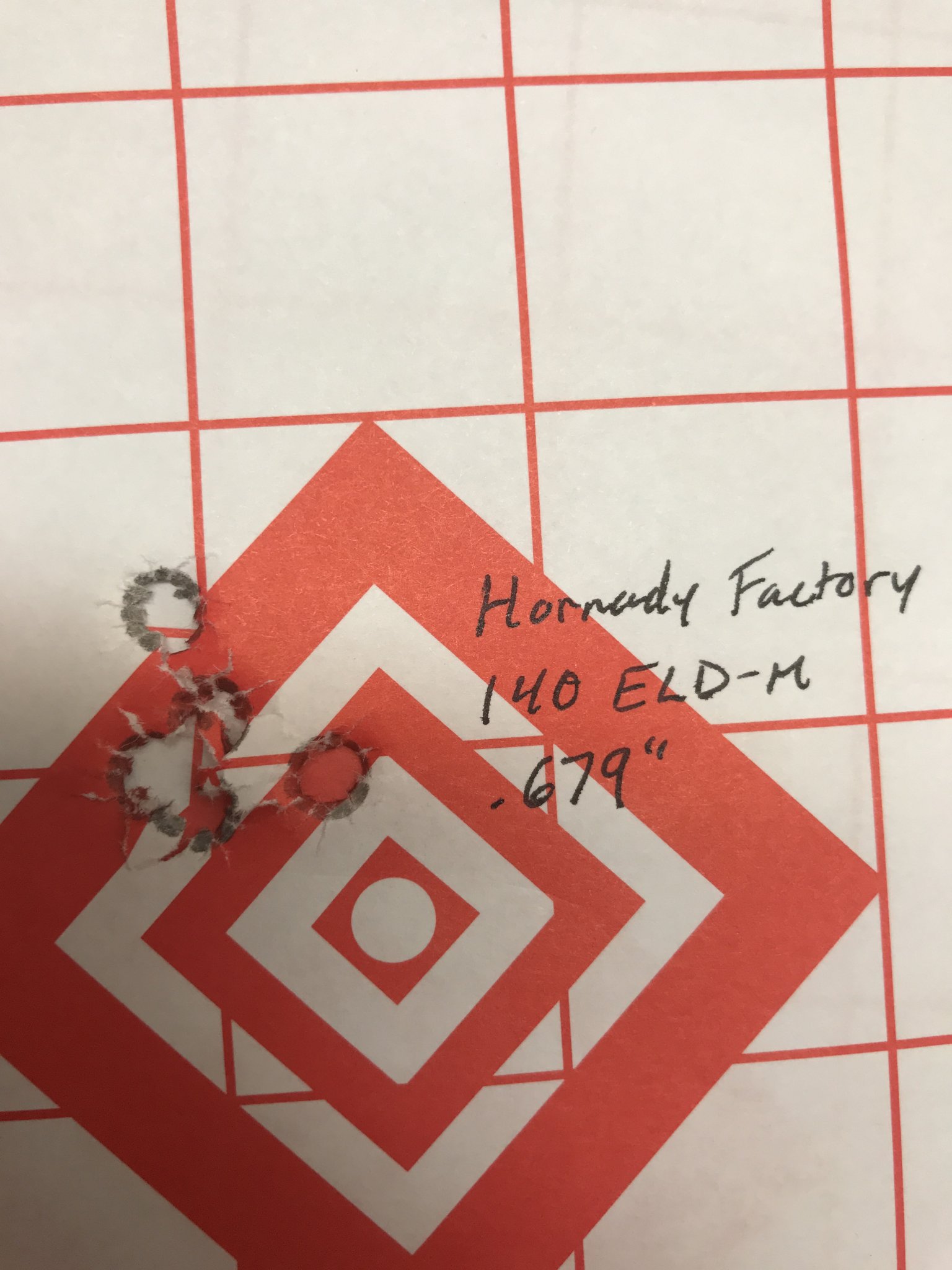

New to the forum and the fix but i thought I’d post some pics of some accuracy results I’ve gotten from my 6.5 Fix serial number 6xx i just got last month. I have about 200 rounds through it playing around with some hand loads and some factory hornady 140 eld-m ammo. So far, in my hand loads I’ve tried 140 eld-m, 142 smk and 140 Berger hybrids but the hybrids wouldn’t feed so i gave up on those. All with H4350.
For some reason i keep getting a flyer in my handloads and I’m very confident it’s not me pulling shots. It seems like it has been tightening up as i shoot it more so i don’t know if it’s me getting used to it or if the barrel is breaking in. I got one group with the hornady ammo that was pretty bad. Not sure what happened there.
372A5E54-FDD9-4FFE-A1CA-D673D0764EF5.jpegDF928DE7-ACBE-4BF2-B26F-7D8ED50A2BA6.jpeg980DBE1F-249C-4628-B539-D2F4F985DCE7.jpeg2B9C21AF-1DFD-4C5E-A670-4146EC0B9832.jpeg9B92939F-8D04-4658-9129-A79239020880.jpeg3238A53E-354A-4E71-9C25-4D488218ABB3.jpeg
View attachment 7004492View attachment 7004494View attachment 7004495View attachment 7004496View attachment 7004497View attachment 7004498
for as light as the gun is, I think you’re shooting it pretty well. I don’t see a gun putting 4 together then tossing one. Maybe Tooley can comment on this but it seems as if a barrel had issues it wouldn’t put 8/10 touching or damn near it.

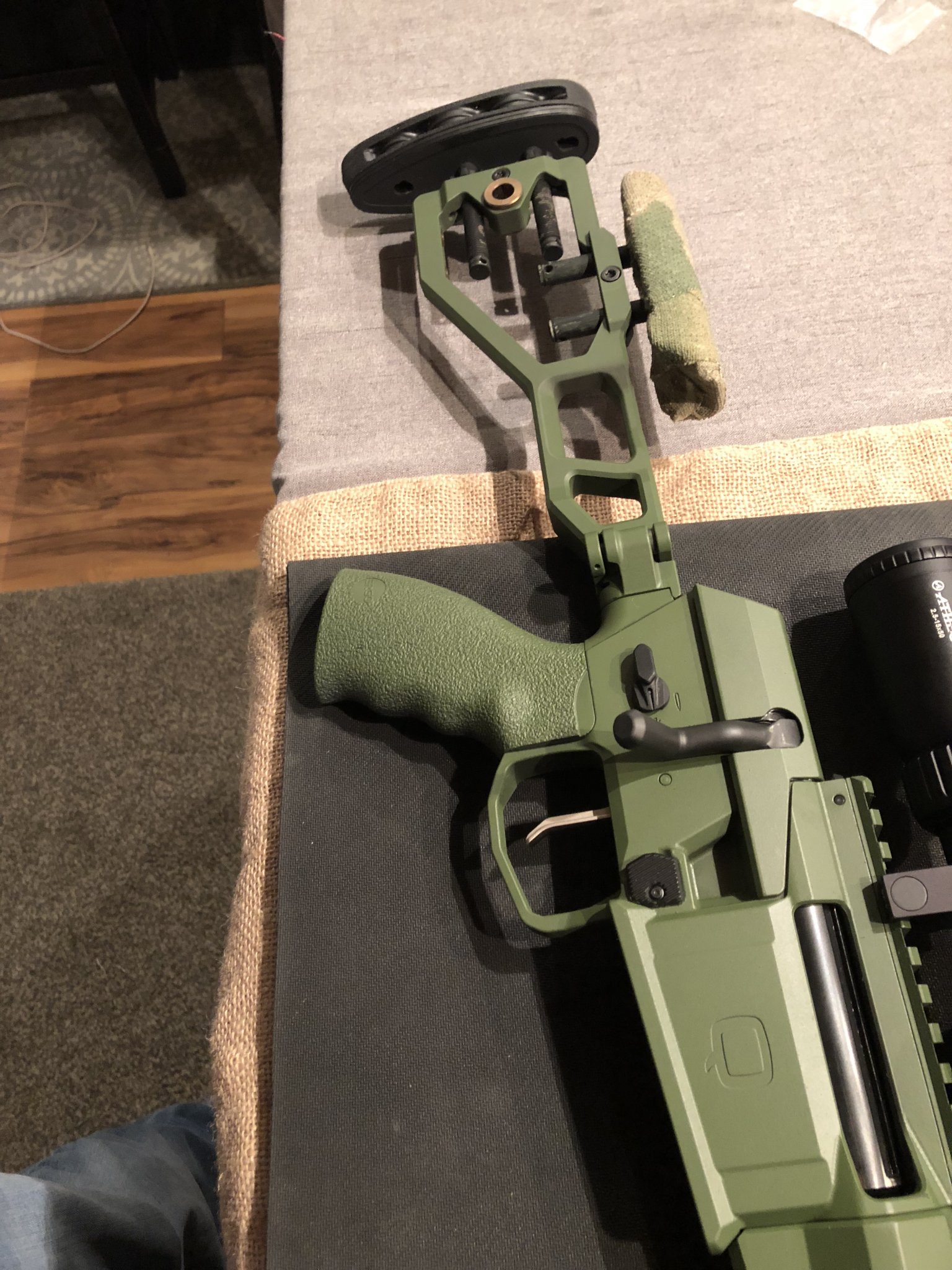

Fix is done curing. Aervoe Dark Green wirh a coat of Krylon matte clear coat (this is what I use to keep the rubber parts from being sticky). Just need the barrel and she’s ready to rock and roll again :love:
Switched to the longer bipod. It’s lighter and while it doesn’t swivel it’s the right length and 3.5 oz lighter. Also finished up the buttstock mod. Loving it so far. Looks clean.
If I had it to do over again I wouldn’t have painted the comb and the buttpad adjustments as they are very tight tolerances and with a tiny bit of paint (and no clear coat) they don’t really want move as easy as they used to. Which is fine. I got them in place and I don’t see myself adjusting them anytime soon.
Paint job turned out sharp! I'll be curious how the limbsaver holds up sans the added support from the stock adjustment mechanism. The plastic is fairly rigid, but flashbacks of rifles falling butt end first left me wanting to err on the side of more cross sectional area. Then again maybe the recoil absorbing properties will mitigate the impact stress!
Yeah me too. I figure it’s worth the try. I’m not an engineer but doing some math and comparing the plastic of Q’s buttpad vs the limbsaver they are about the same thickness. What I also did was use a bolt with a wider head than the Q bolts. Also the hole I drilled in the plastic of the limbsaver is exactly the width of the threaded part of the bolt. It’s pretty snug. It’s a little cleaner looking and it folds with that same authoritative “click” the stock pad had.
