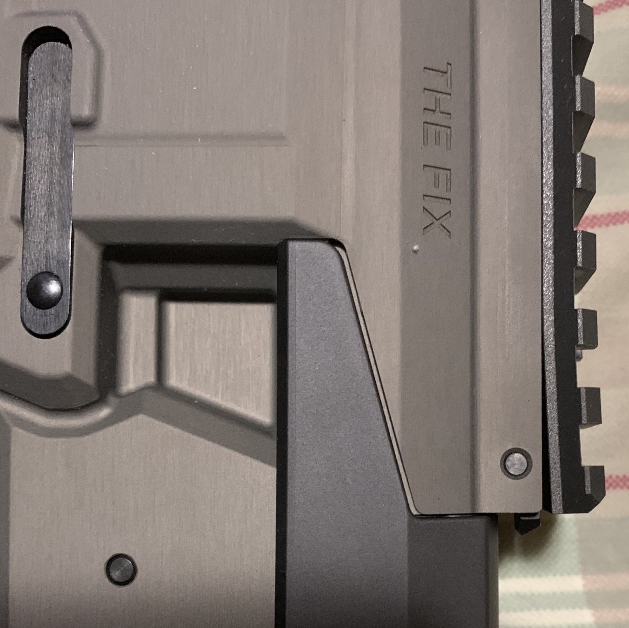

Does the rail on your gun look like this?
when y’all hit the wall on that second stage of the trigger pull, does the bolt shroud lift lift up on the rails a little? Causes like a dull thud
Not a big deal as the trigger is not in direct contact with the bolt/sear so in essence you're just taking up the slack in the system with the first stage.
Reactions: midSCarolina
It doesn’t. But when putting my gun back together after seeing another members post about it I can see how It could get like that. So I carefully seated the bolt release spring and did the most rearward screw first ensuring the spring was seated and compressed straight down. Did you take yours apart?
Awesome... I just wanted to makes sure it wasn't changing the angle of the bolt face or anything weird like that.

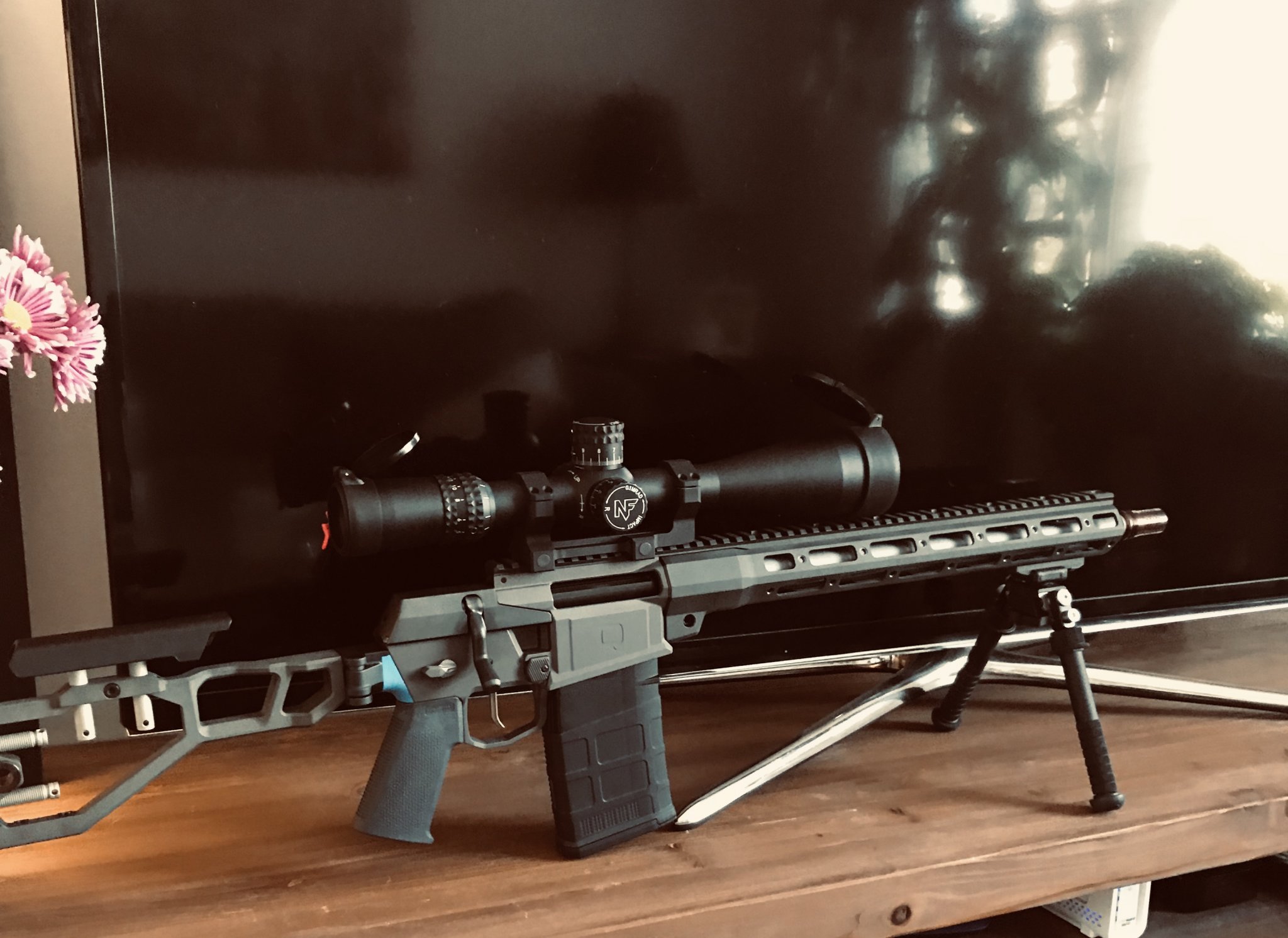

Anyways.... have the rifle all set up and ready to go for tomorrow and the damn thing looks so sweet. Also having the Bartlein/Tooley name on it has given me that warm fuzzy feeling I had when I bought the rifle, before making the mistake of getting on the internetz.

what nightforce did you end up going with? I don't like USO B-10 and am contemplating what to swap it out for.
Its the NSX 3.5-15x50 with the MIL-R reticle. I was wanting to go with the ATACR, but I got a really good deal on this one right before christmas and couldn't justify the extra $1500 I would have had to pay. It has worked really well for me in the short time I have had it, and I think it is a good size for the fix. Did you go with the Horus or some other reticle on your USO?

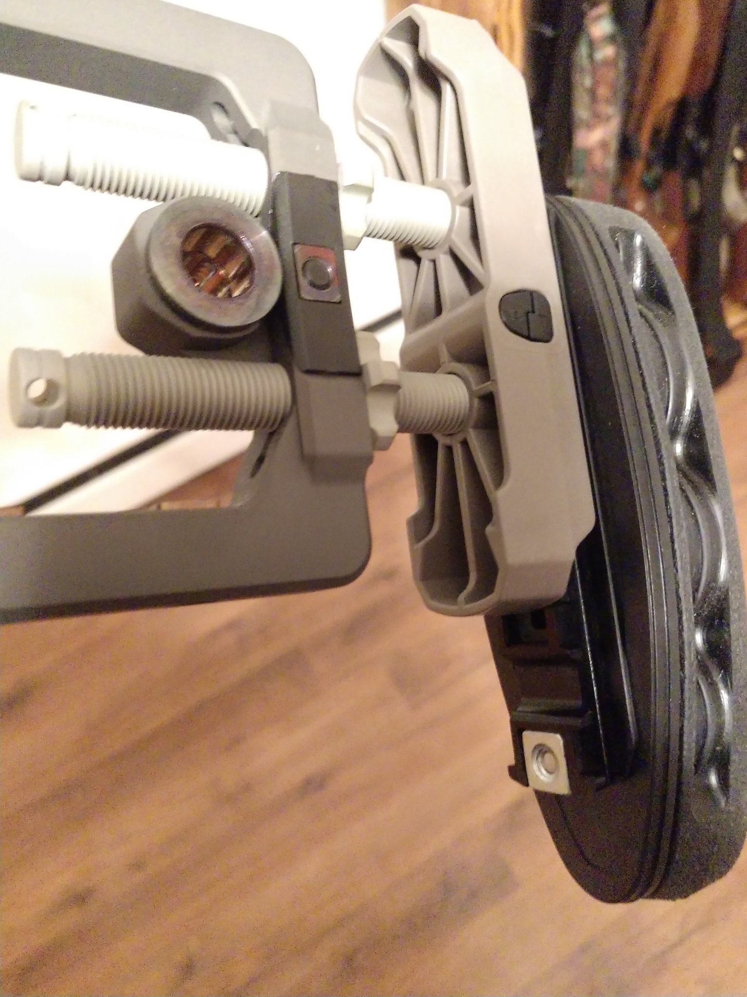

I’m going to take it out “as is” tomorrow. The less I have to change, the happier I am. I have a Lantac brake laying around and will eventually try for comparison sake but I don’t see the myself wanting to deal with the recoil pad. My main concern is if that polymer piece can take a hard hit without cracking? Anyone have any insight on that? I would honestly like to see if I can find someone who can machine one out of aluminum. It looks like the bolts are just threaded into the plastic on the factory one but I could be wrong
If you're concerned about strength, the way I did it replaces a thin piece of rubber with hard plastic supported along most of it's length by the stock mechanism. If there is enough interest I will take mine back apart and make a step by step with better pictures. I should have done that in the first place. I do appreciate retaining the adjustment function going from the bench to the prone to a tree stand. For me recoil mitigation was only a concern after shooting a hundred rounds in that F class match with no can, no brake, and all shot from the prone. The biggest gain in my opinion comes from the ease of building your shooting position with something that has been sized and shaped for over 100 years to fit the pocket of your shoulder vs. the narrow band of flat plastic. YMMV, the gun went from a consistent 3/4 to 1/4 MOA, which could be indicative of poor fundamentals on my part.
Reactions: Akdodge88

Plastic threads? Where?
No plastic threads anywhere on the stock gun or on the limbsaver mod. Maybe I should have taken pictures when I did it. So the threaded gold colored aluminum bars that connect the buttpad to the stock are threaded in the back. They have a 10-32 screw in the back of them. That’s how Q connects them to the buttpad. If you move your stock all the way up or down I believe I may be visible.
So for my version of the mod I drilled a hole the limbsaver that is the exact width of the 10-32 screw body. Not the head. So then I used a screw from the hardware store wirh a wider head than the stock one had. Less likely to bus through the very hard polymer back of the limbsaver. So I’ve used essentially the same attachment method that Q used. I will say that the plastic Q used seems 10 times more likely to crack/break etc
Just be advised to anyone who takes the stock apart. They used some heavy duty thread locker on the 10-32 screws that attach the butt pad o the bars with the wheels on them. Go slow and take your time so you don’t strip it. It’ll come out but was some work to turn it because of the locker they used.

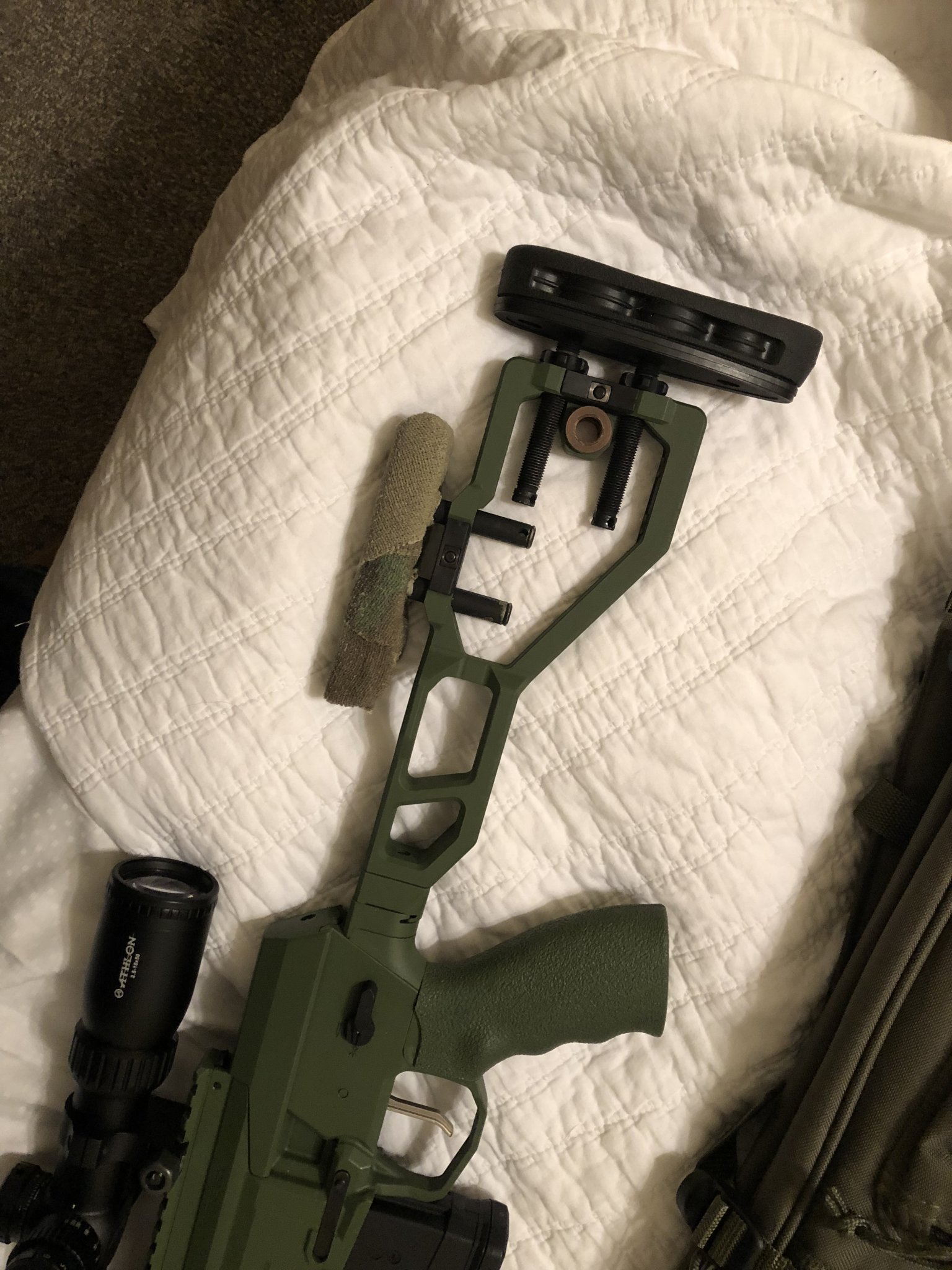

@lvmike did a metal version
Yo @midSCarolina when you gonna shoot that thing already?

No plastic threads, I used square nuts on the stainless bolts through the stock mechanism.
