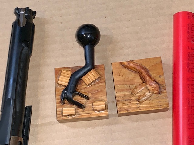

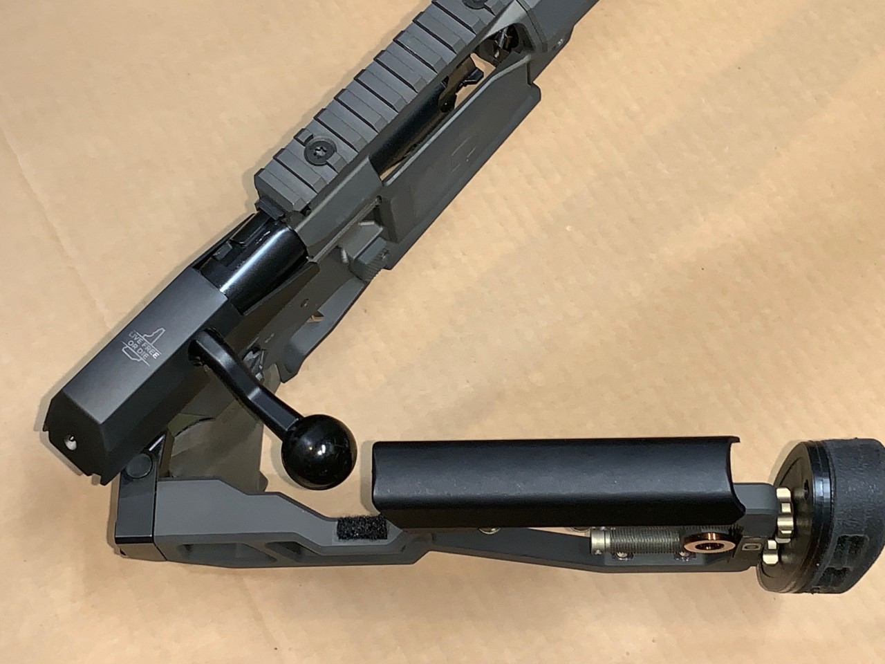

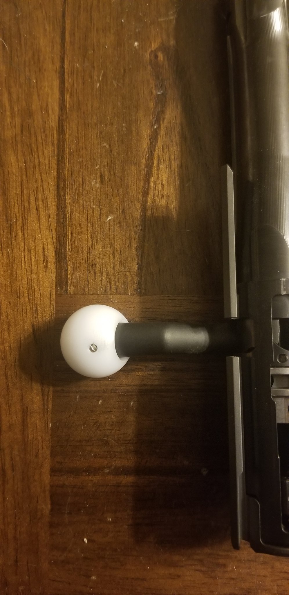

I got bored and impatient waiting on q to deliver a ball knob bolt handle. 7/8" is the perfect size. It's just a delrin ball that I drilled a 15/32 hole about halfway through. It actually fits very snug just as a press fit. Cycling and dry firing with snap caps it feels pretty nice. I may epoxy it and dye it if it works out.

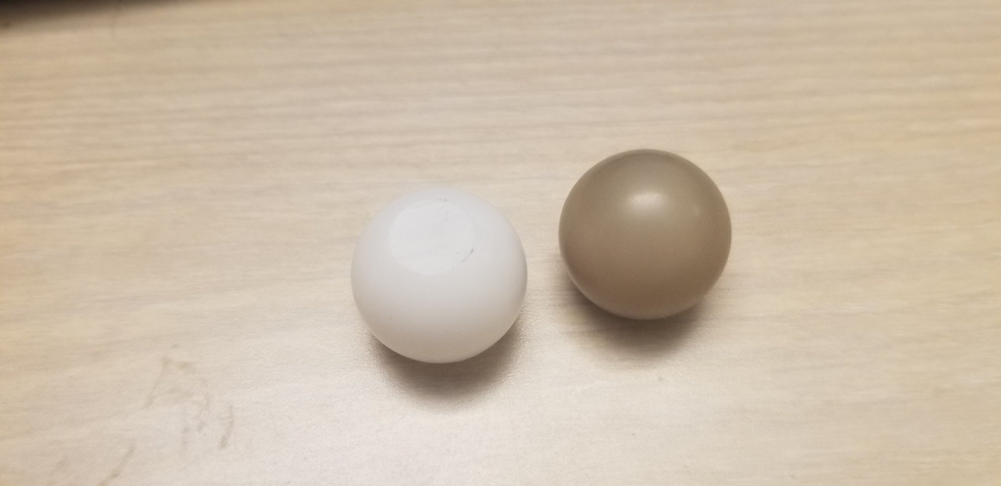

I just got my delrin ball tonight and tried to replicate this. It's a good thing I ordered two. First one spun in the vice and then exploded. Second took some careful padding and pressure from vice and still cracked but otherwise works. I could repair the crack inside with superglue (it'll bond/weld this plastic) but I'm thinking of order a few more and trying again.
How did you go about drilling yours?
I think I used a DeWalt(?) pilot point bit to drill a pilot, 1/4 or 5/16 and then stepped up to final size. Run the drill fairly fast so it doesn't take a big bite and grab so hard.
I ended up pulling it back off to try to drill it a bit deeper but it never fit as well again. I need to order a few more.
Ahh thats probably my problem! My press is set somewhere around 320rpm i believe. I'll speed it up and keep the pressure low and I bet it'll go much easier.
As for this one, I found some instructions on using rit dye to blacken it. I'll give it a try and report back.
For attachment I was thinking hot glue. It should be high enough temp to hold on a hot sunny day but not so much I couldnt warm it up with a lighter later and remove it.
edit: thank you again for posting the info-- it got me motivated to do it!

I ordered a bag with several sizes. I may try a 3/4". With the 7/8 my index finger hits it slightly if I'm going to the mag release. Haven't had time to fool with it since.

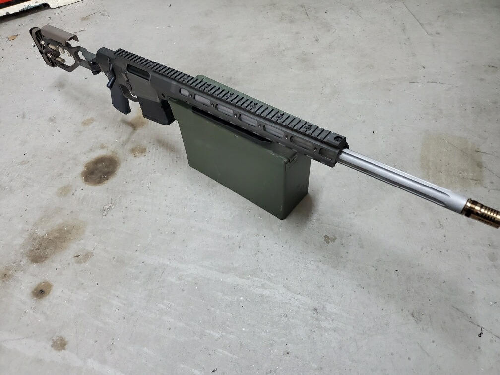

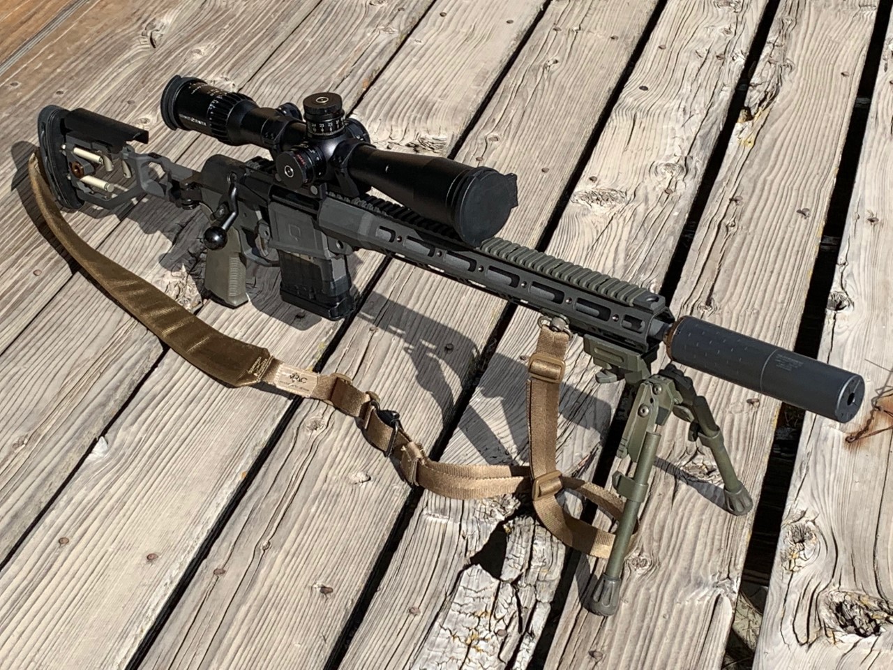

Well, I've been jonesing for a Fix for a while and was able to get one through a buddy a month or so ago. Maybe even better, Q has agreed to supply him with barrel extensions!
Not only did he cut my 22" 6.5 CM barrel down to 17", but he spun up a 243AI barrel for me as well! He has a great relationship with Gary Schneider so I went with a Sendero contour Schneider barrel with poly rifling, 1-10 twist, deep 1/4" ball fluting, finished at 22", 5/8x24 muzzle and he recut the Q/Sig taper on both barrels.
I should have it in my hands by early next week. The rifle with the 243AI barrel weighed in at 7.1lbs.
I do a lot of predator hunting at night with thermals and I'm excited to switch to this rifle with my NVision Halo-LR from my previous 243AI which weighed in at ~18lbs pre scope!
Kind of hoping the supposed velocity increase from the poly rifling will counter going to 22" from my previous rifles 26" barrel.
The pic in the case is with the 17" 6.5CM barrel.
The one on the ammo can is the 243AI.

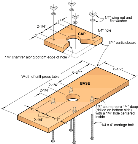

I made one of these to make drilling it perfectly center possible. You use the bit you made the large hole with as an alignment tool and then clamp the bottom of the fixture. Then change ti the bit you want to drill with and put the ball in.

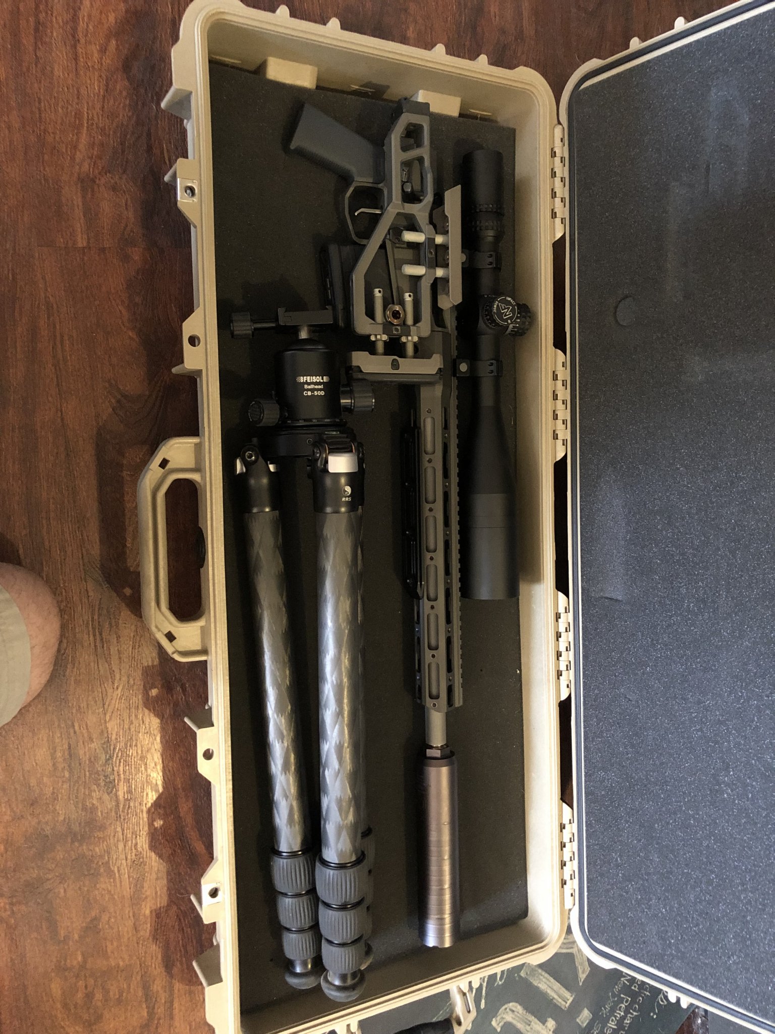

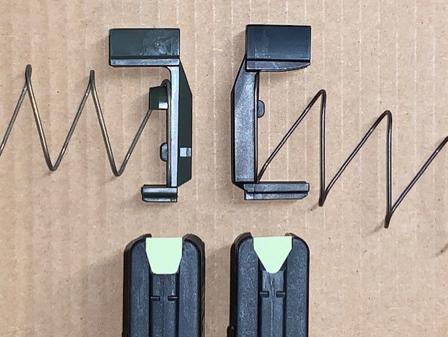

Hey Guys, I was trying to use the older Gen M2 20LR Pmags in the Fix and found they will not work without a small modification on the back near the top of magazine. The M2 has more of a V shape and it has to be changed to the square shape found in the newer Gen M3 20LR Pmags. The M2 also seem to fit a little more snug in the mag well because they don't rock back and forth as much like the 10 round Pmags, and they still fall free when you eject them. You can use a dremel tool or a hand file, go slow and remove just enough material until they will lock in. M3 on the left with the green follower and M2 on the right with the black follower.

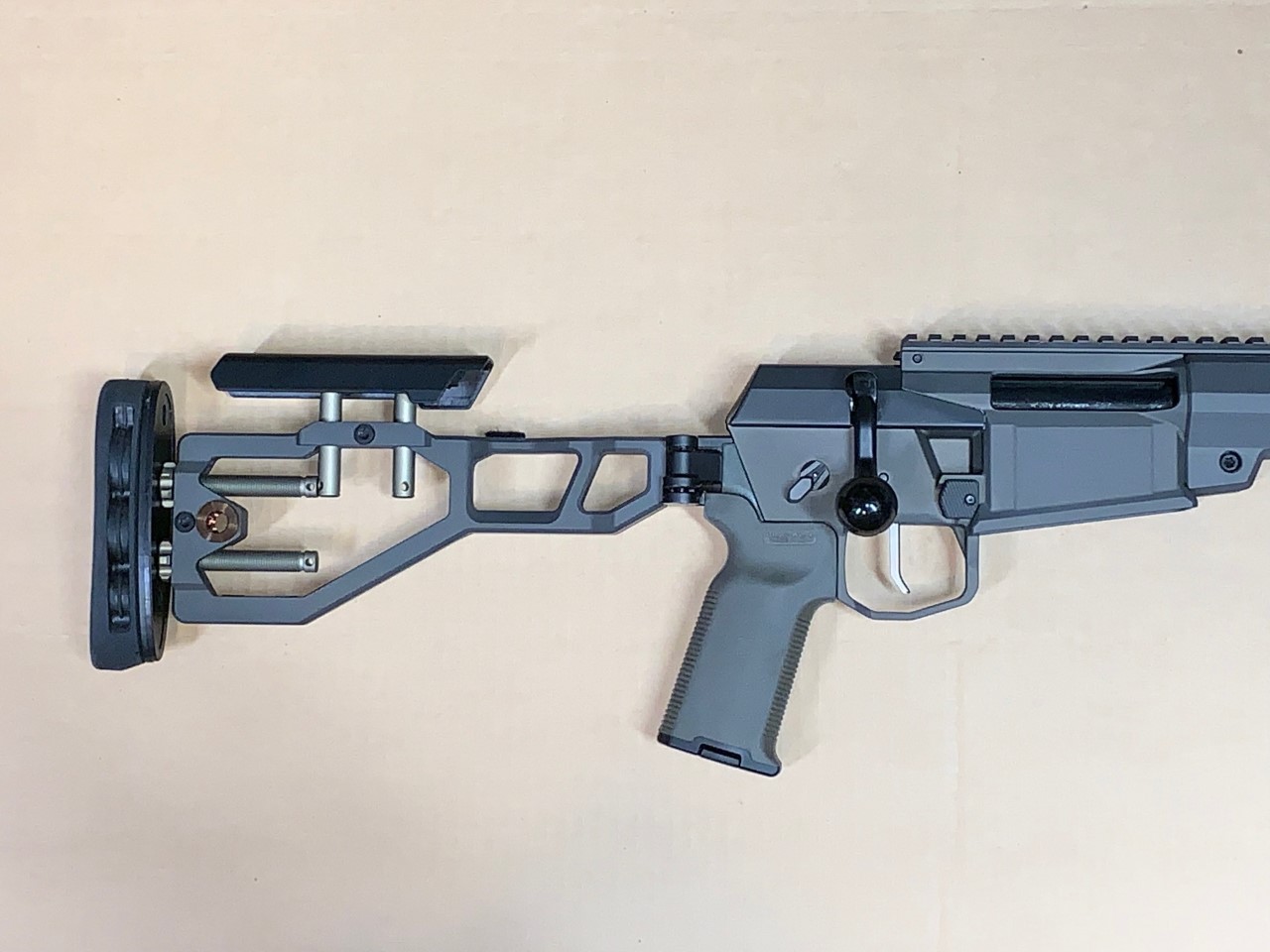

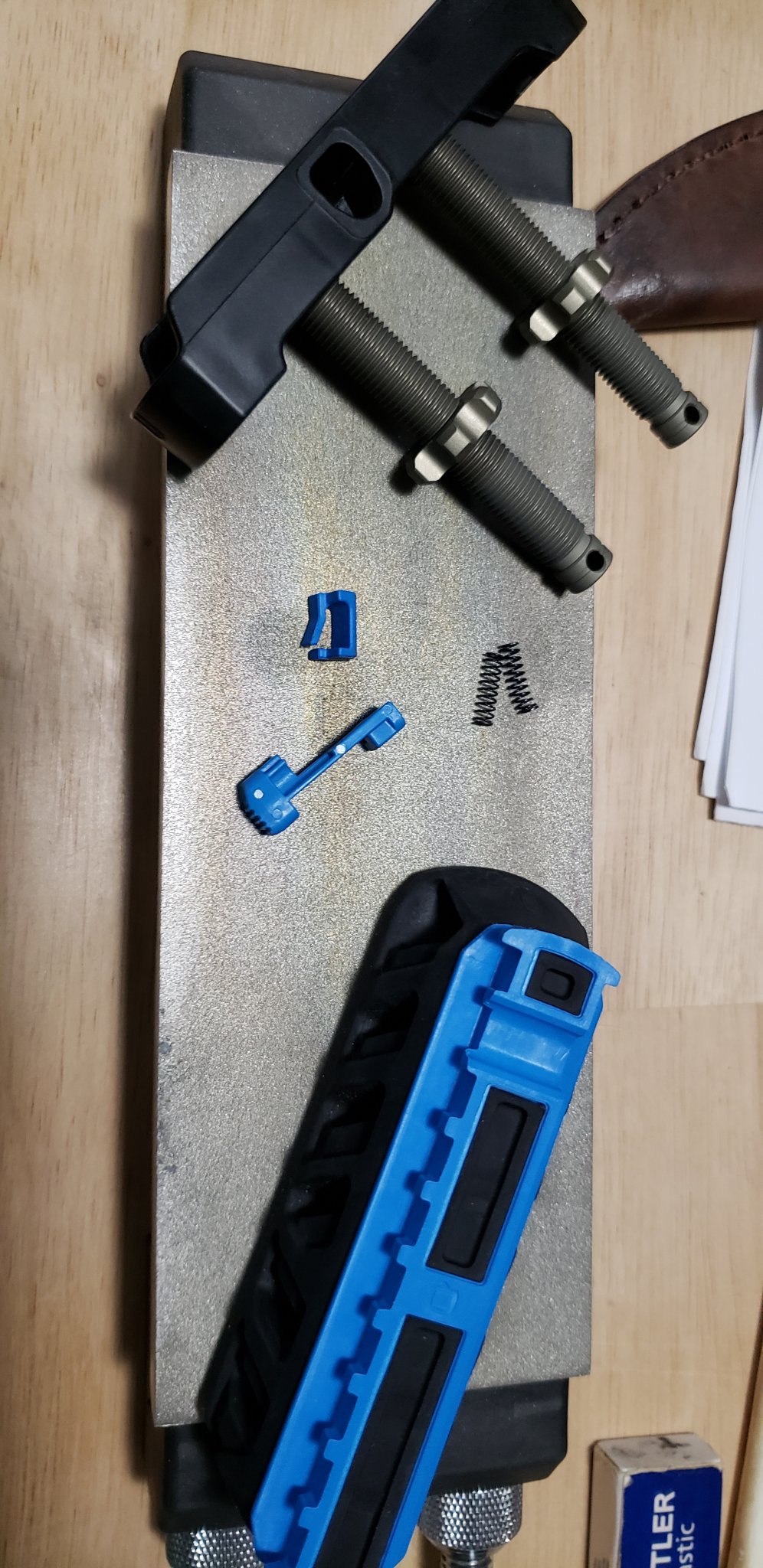

So I figured how to take the butt pad apart and its a pretty simple design. This might make it easier for the guys that want to do the limbsaver. Just align the lock in the gap between the rubber on the backside and push the lock in as far as it will go and use a small pick to push down on the tab that holds the small plastic piece and it all slides apart. Don't drop the springs.

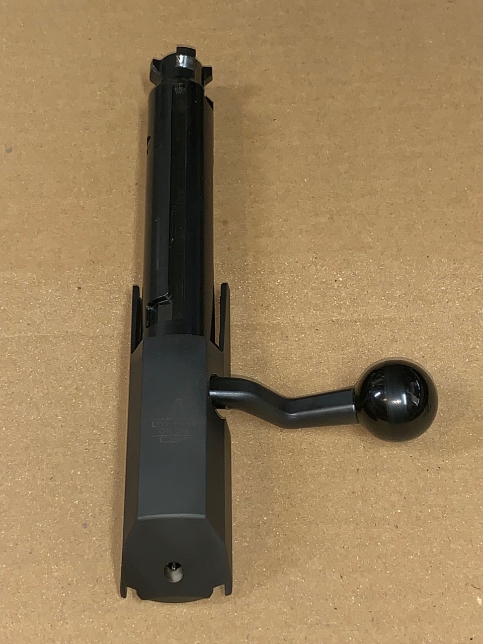

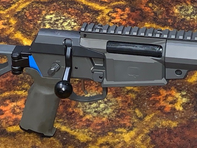

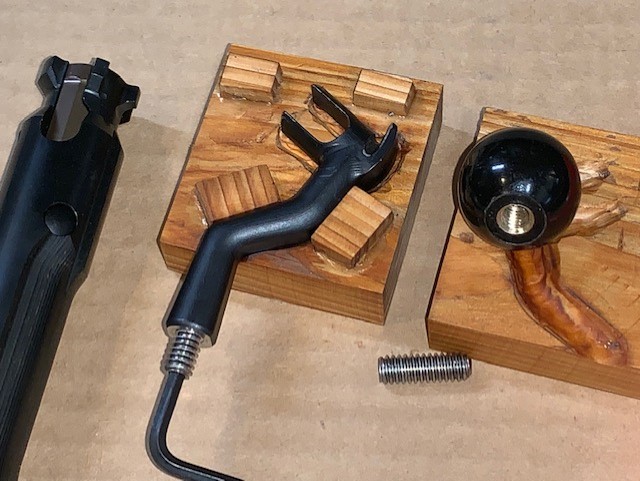

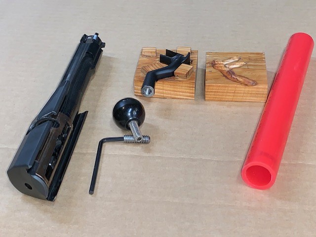

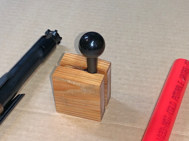

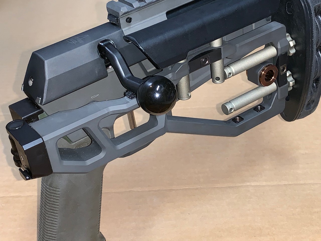

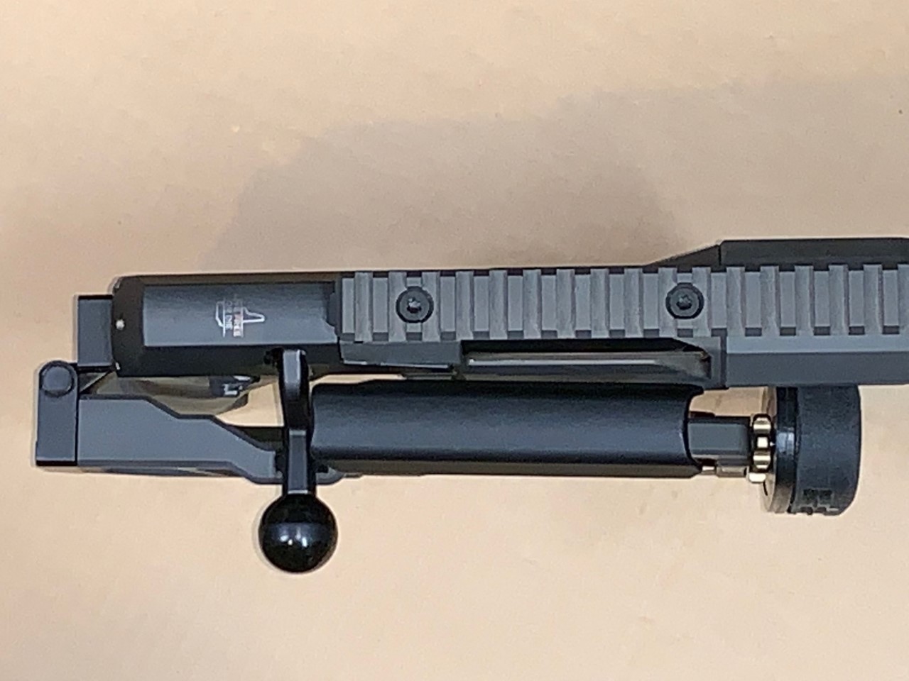

Decided I couldn't wait a year for the 6.5 Fix so I purchase one in 308. Now I can't wait for a ball bolt handle, and since I have a friend with a milling machine decided to make one. It is so much better. The only downside I can find is you have to remove the bolt to fold the stock. I can live with that. The red PEX in the photo is to give some extra leverage when you disassemble the bolt
This is how.
Purchased an M6*25 metric threaded ball from ebay The ball is just under an inch with a metric thread that is the correct size to tap 1/4 20. I couldn't find a 1" ball with a brass insert threaded 1/4 20 so had to make one.
Made a wood jig to support the bolt handle in a vertical position. Draw an outline of the bolt on a scrap piece of cedar fence and hand cut the outline with a dremel tool. Cedar is soft enough once you have the basic shape cut out you can clamp in a vise for the final fitting. Then square the edges of the jig so the bolt handle will sit vertical in a milling vise.
Center the bolt handle in the milling machine and cut the hole. The bolt was a little hard so a carbide cutter is best.
Tap the hole 1/4 20. I think that's the best size to fit the size of the bolt handle. 5/16 24 is too big.
Degrease the parts, put it together with blue loctite and your set to go.
To switch it back to stock all you need is a 1/4 20 black hex button head screw and a little trimming. Have Fun

@newguy2k3v2
I found a decent attachment method I wanted to share. I drilled and tapped a hole for a small 4-40 set screw and used these little nylon tipped set screws from mcmastercarr to prevent it marring the handle. The pic of it on the handle is woth a small set screw I made to test it. The perfect length seemed to be these 3/16th long screws. They sit a little below the surface of the 7/8 know so I bet they will work with a 3/4"
@newguy2k3v2

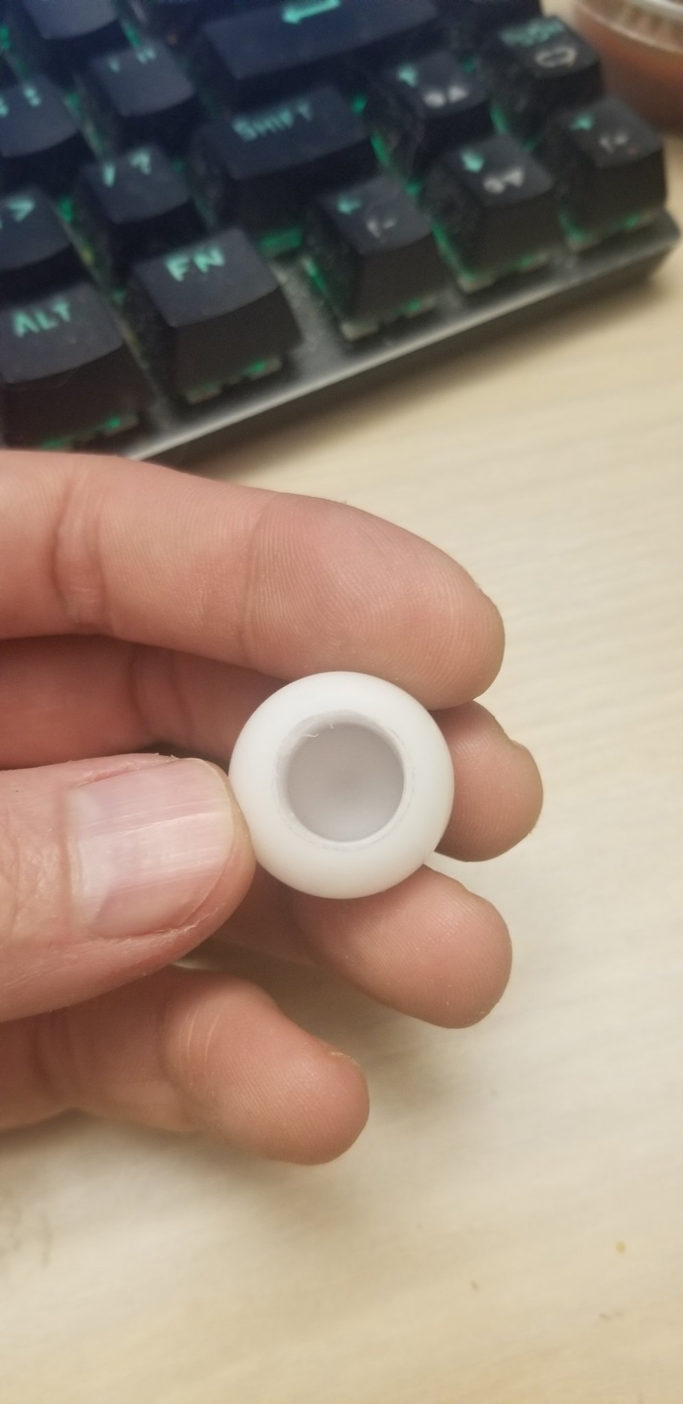

Looks simple. Excellent. Did you figure out why dying didn't take? What color did you use?
I tried both liquid rit black dye and dylon powder black. The rit actually got some color to take and the dylon didnt at all. I think it could be the plastic is a similar type of acetal to Delrin but not actually delrin. Delrin is a POM E type which can be dyed and there are several others that are POM C which cannot.
I am tempted to try rit again but with a higher concentration and more salt+vinegar (helps it somehow)

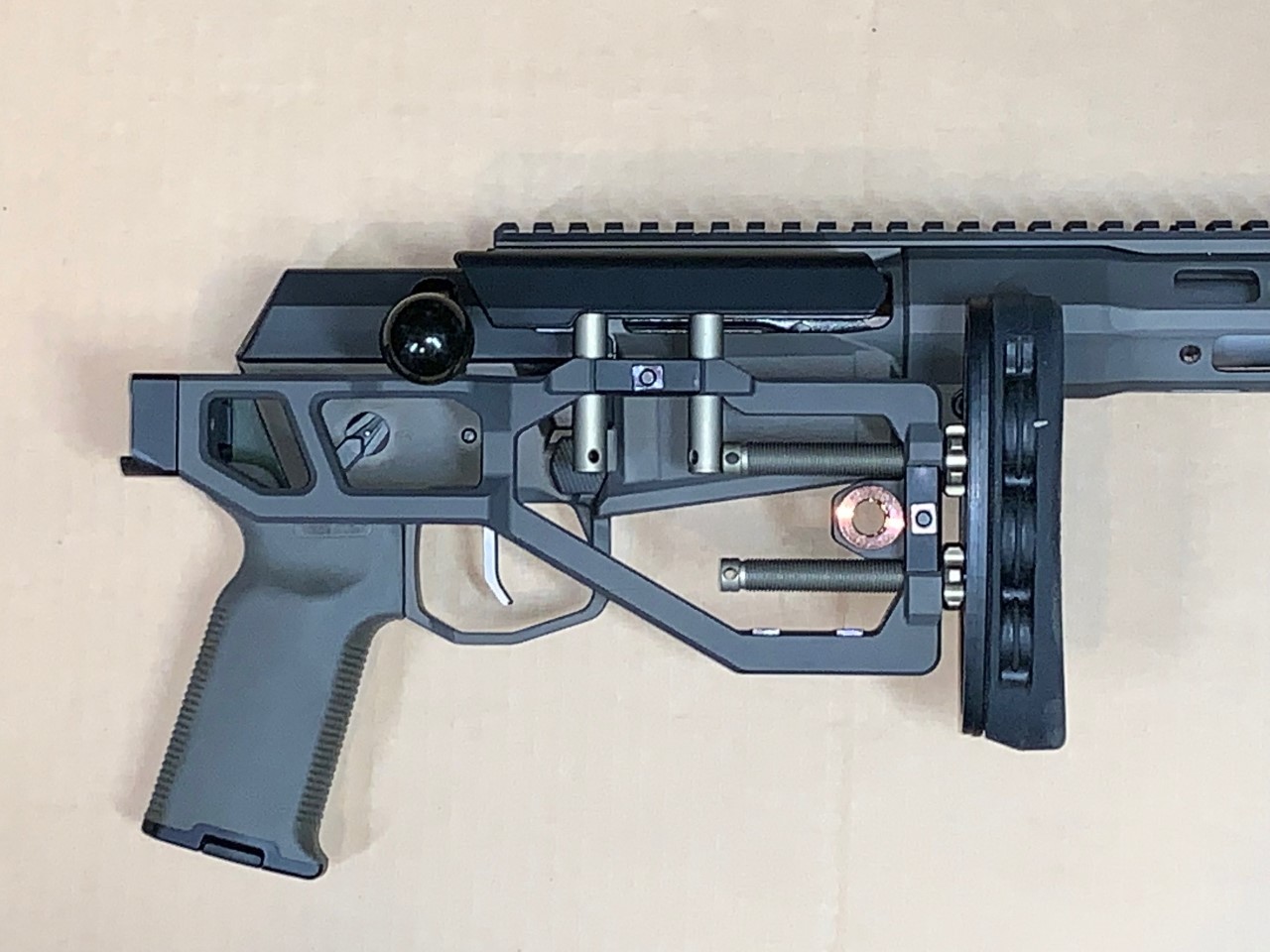

I found that using an extended bolt handle does not require removing the bolt in order to fold the stock. You just have to move the cheek rest one step back which makes enough room for the bolt to start to close above the stock, that way the bolt doesn't rattle around in your rifle case.
I had LRI chop a Q 6.5 GM barrel down to 17” and it has been great. Kid just took his first antelope at 430 yards with it last weekend. I have a 16” Proof barrel that I shoot and it works well too. I used the Q barrel for the kid to add a bit more weight to help with the recoil. He’s only just
10 so these lighter guns test his fundamentals a bit more.
