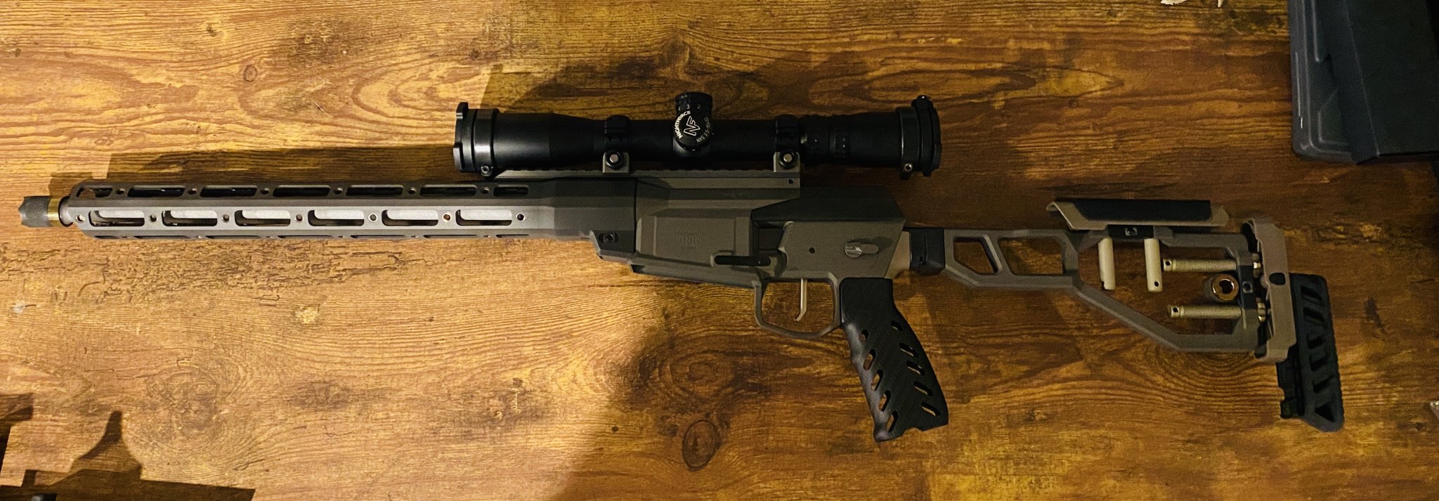

At home in quarantine is giving me time to work on some projects. I added the Smoke Composites carbon fiber grip. It is expensive but so was this rifle. The fit, feel, and finish of the grip Is perfect. I highly recommend it!!! I also switched to the Nightforce ultra light rings, and Q 8.5” rail. Rifle weighed in before at 8.22lbs and now weighs 7.47lbs

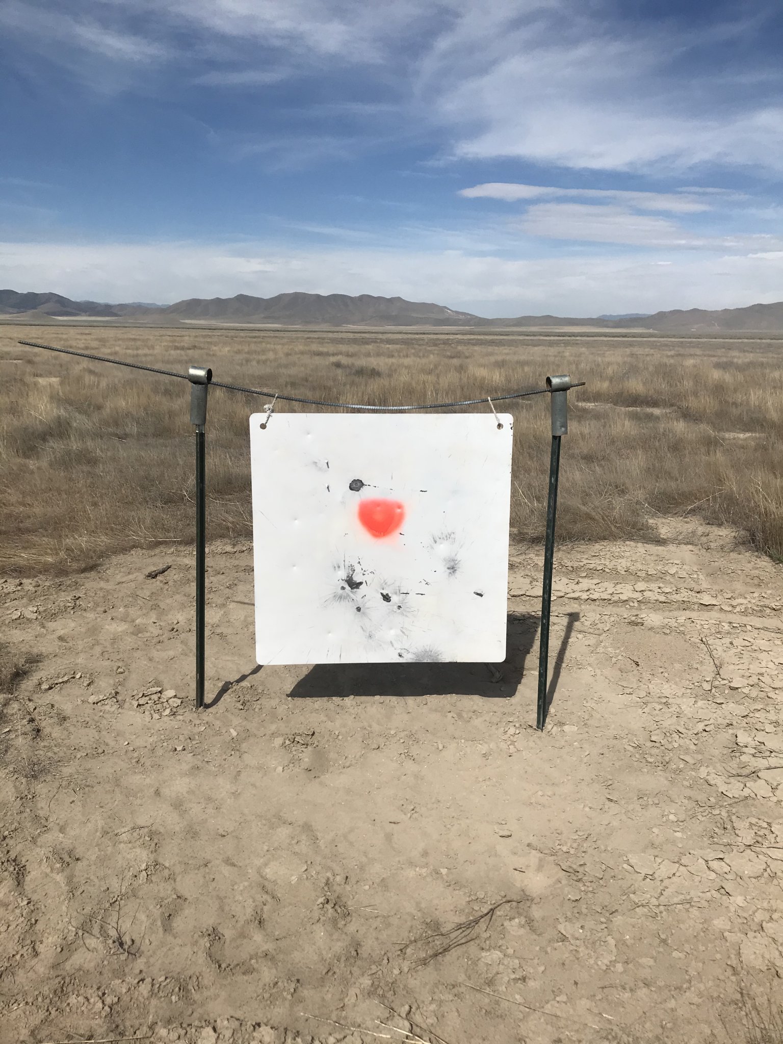

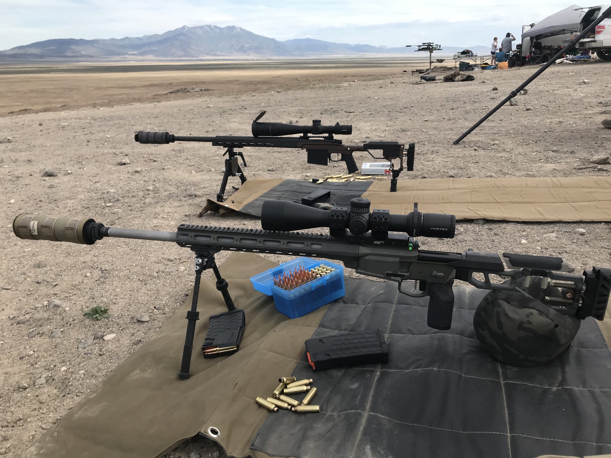

Hit the desert yesterday with my 22” 6.5CR Fix, I was able to get a hit at 1900 yds on my 2nd shot of the day (semi cold bore I guess), using 147 Gr Hornady ELD Match handloads, then practiced at 1760 yds and 1000 yds (18” gong). The wind at my back really helped today
