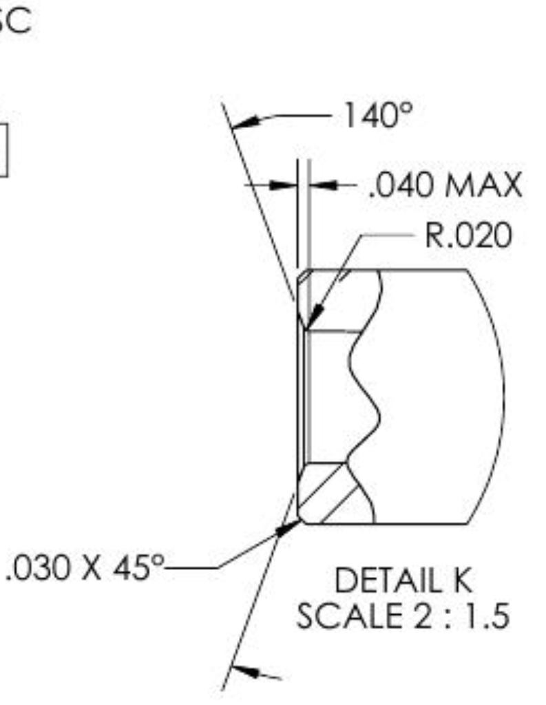

For the folks asking about the spec of the chamfer here you go.

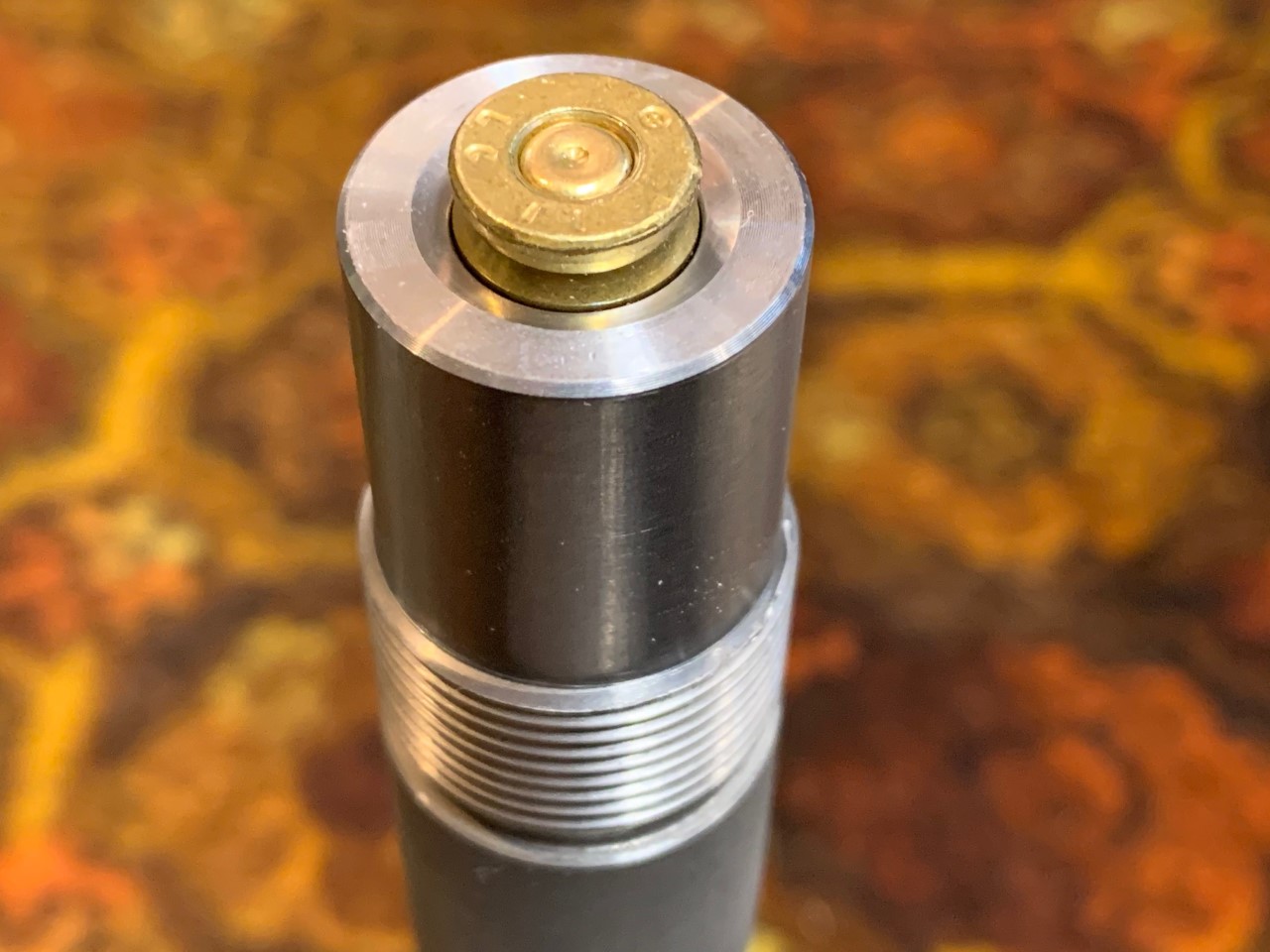

I've diagnosed this ad-nauseum including sending the rifle back to Q only to have the same issues. Asking people to run the bolt with authority works, but just covers up for a design / manufacturing flaw. Extract the rounds you slam in and inspect the tips of the bullets. The real issue is that when a 6.5mm bullet rides up the barrel extension, the centerline of the bullet barely misses the chamfer into the chamber and hits the perpendicular end of the barrel. The chamfer needs the be altered. I plated with the Lancer mag including bending feed lips - no luck.

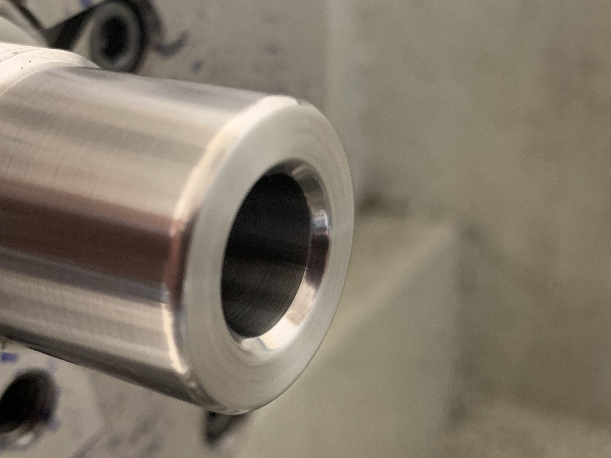

When I chambered my barrel I found this out. Had to put it back into the lathe and make the chamfer much larger. Absolute butter now.

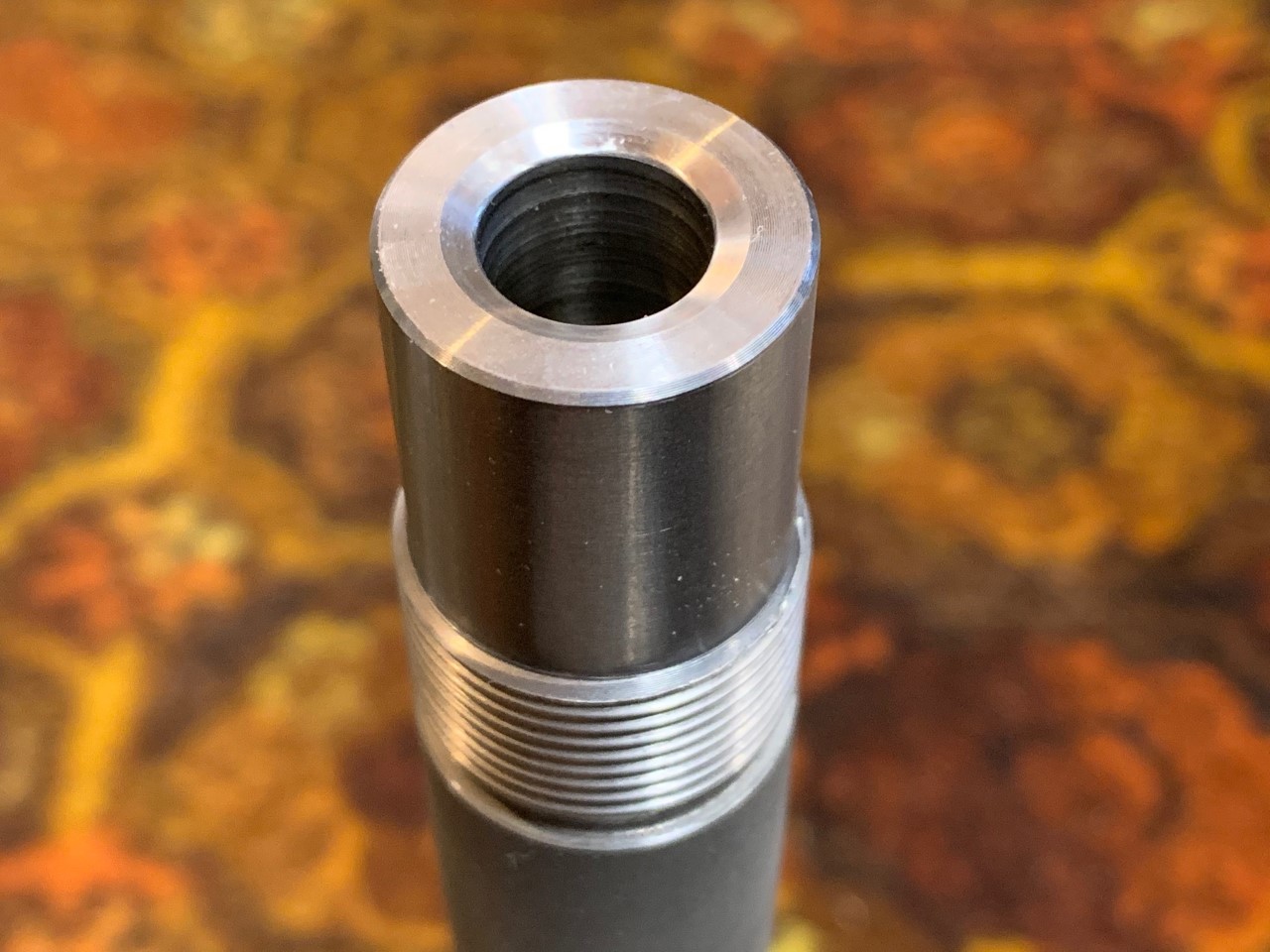

Wow! That is interesting. This photo is my Q 308 barrel that Dave Tooley used for the barrel extension on my new Tooley 6.5 barrel. You can see the chamfer on this barrel is minor. Do you have any pictures of your barrel after you made the chamfer larger, before you put the extension back on? I would like to see
how much larger you made the chamfer.
Wow! That is interesting. This photo is my Q 308 barrel that Dave Tooley used for the barrel extension on my new Tooley 6.5 barrel. You can see the chamfer on this barrel is minor. Do you have any pictures of your barrel after you made the chamfer larger, before you put the extension back on? I would like to seeView attachment 7462041 how much larger you made the chamfer.
I would call that a large chamfer, and larger than mine was initially. How does yours work? I think I have some before pics, but no after pics.
Before, long bullets would reach over the extension and touch the vertical portion of the breech face, just below the chamfer. If I seated the bullets deeper, the shoulder of the case would contact the extension and lift the tip of the bullet, and it would feed fine. The alteration was pretty easy, and I just cut two wider angles on the existing chamfer(going no deeper), and blended them. My gun never had issues with the factory creed barrel. This barrel is a 6.5x47, and showed the issue immediately. I’ll see if I can take an after pic.

I didn't have any issues with feeding as soon as I switched to the Lancer magazines and run the bolt with authority. I wouldn't call it butter smooth but it does work. The 6.5 Tooley barrel looks about the same so maybe yours was not cut properly. I was thinking maybe I could improve mine with a larger chamfer but probably not. Your chamfer looks deeper than my 308 barrel but it's hard to say. Your pictures are great!
This is my Tooley 6.5 barrel. Sorry about the shadows. You can see where the bullets are hitting the chamfer. I'm shooting Hornady ELD bullets but they still leave a mark. My only complaint with the Fix is I wish cycling the bolt was smoother like a Tikka or AI.
