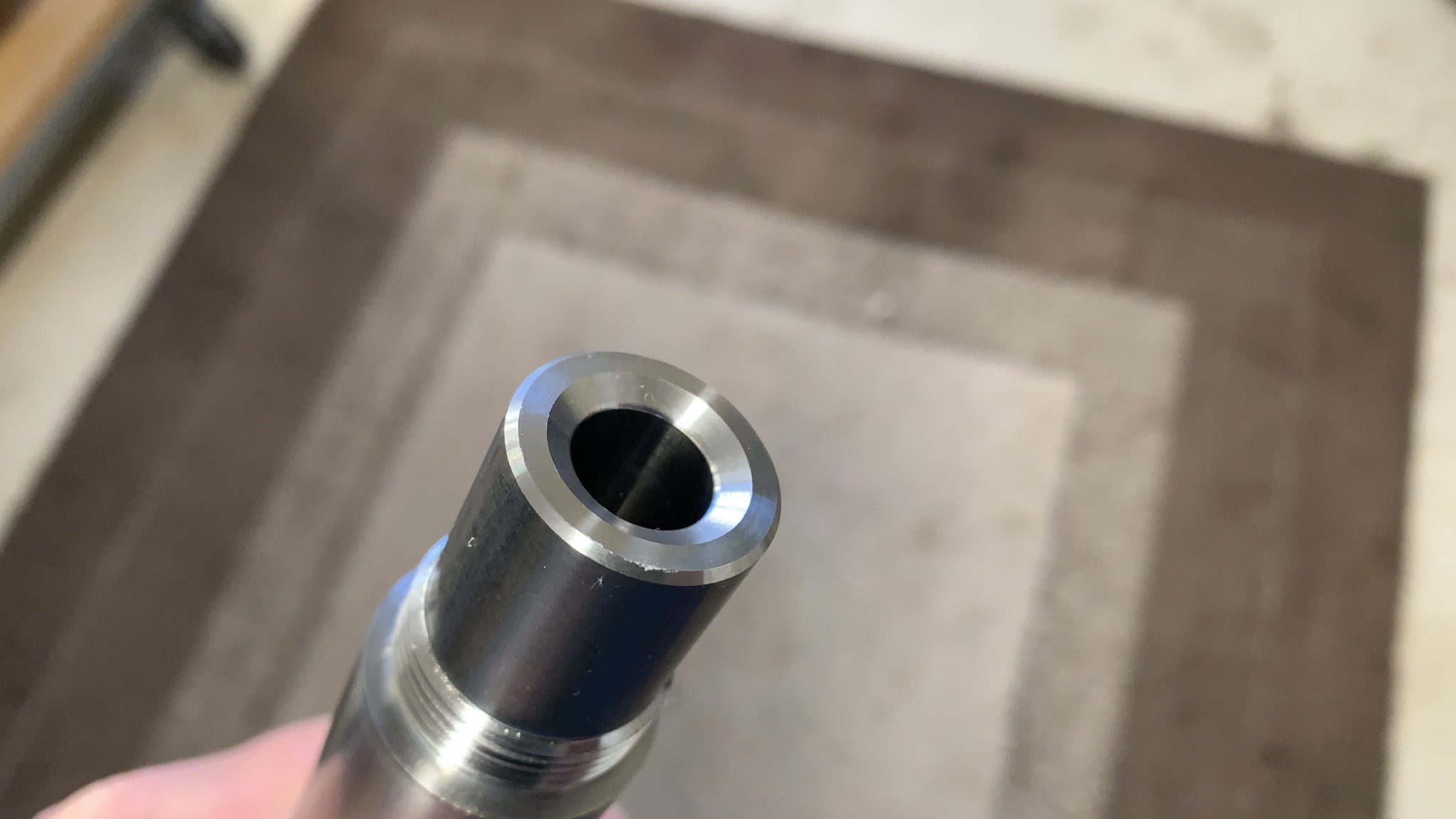

Spent a few hours yesterday working on a process to convert brass to 8.6 blk
Here is some 6 Creedmoor brass necked up and formed, just needs trimmed.
1. 6 creed 2. Formed brass 3. Factory 8.6 brass

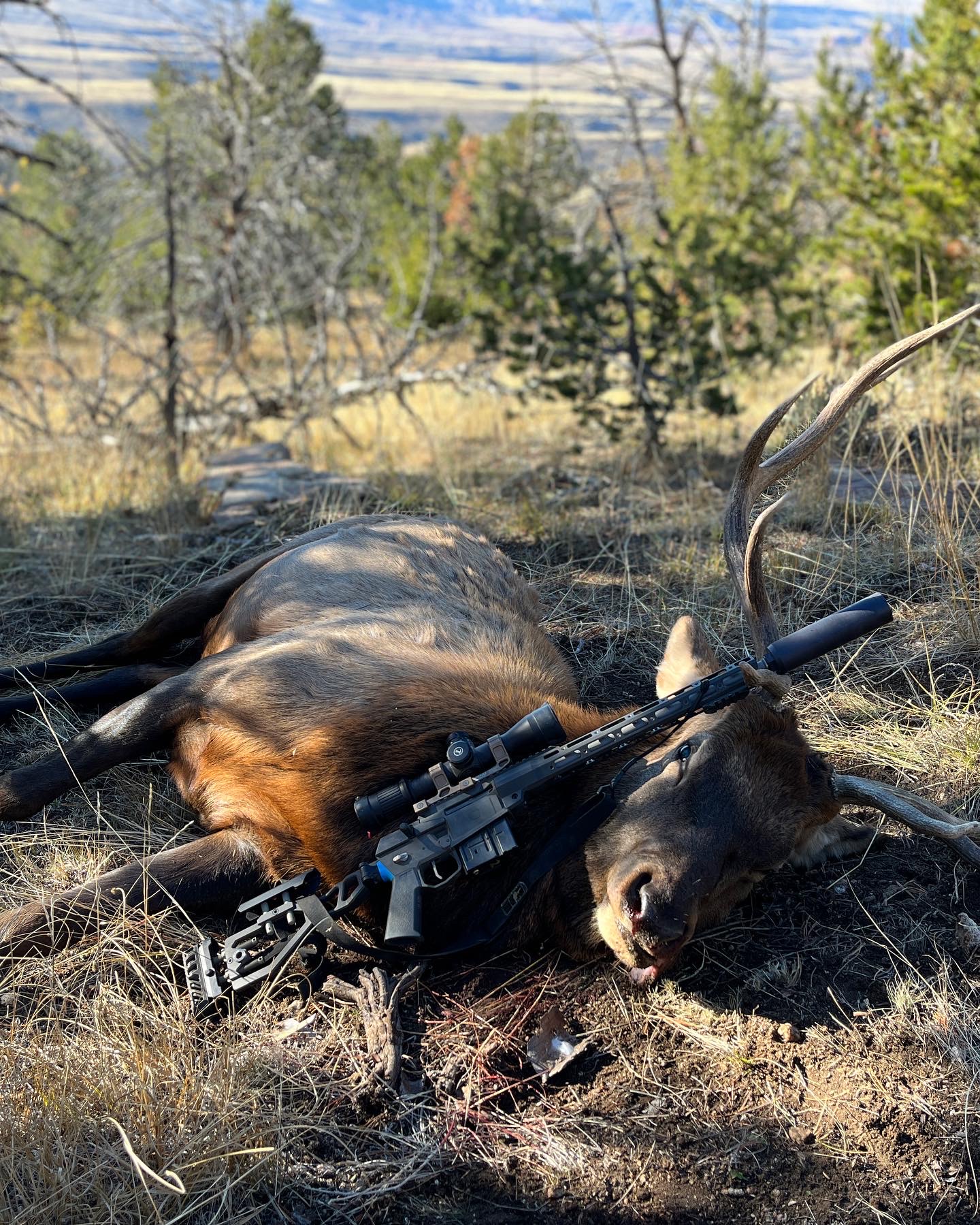

I shot a cow elk with the 8.6 last month at a bit over 300 yards, so it did the job and it is a fairly mildly recoiling round which I like.
The lethality seems to be there. It is the most accurate subsonic round I have tried to date and accurate enough in its supersonic guise.
Until ATF figures out all the pistol brace bullshit, I am using it with a 16" barrel, which is where another advantage of the 8.6 comes in: it plays really well with short barrels and, on balance, 12" barrel would be ideal.
