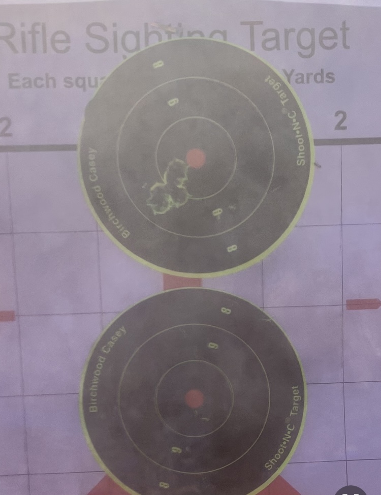

This is literally shots 2-6 in a 6 dasher with virgin dasher alpha ocd brass, Berger 109 lrht, 31.8 grain target, seated .002” off touch point
Zero load development

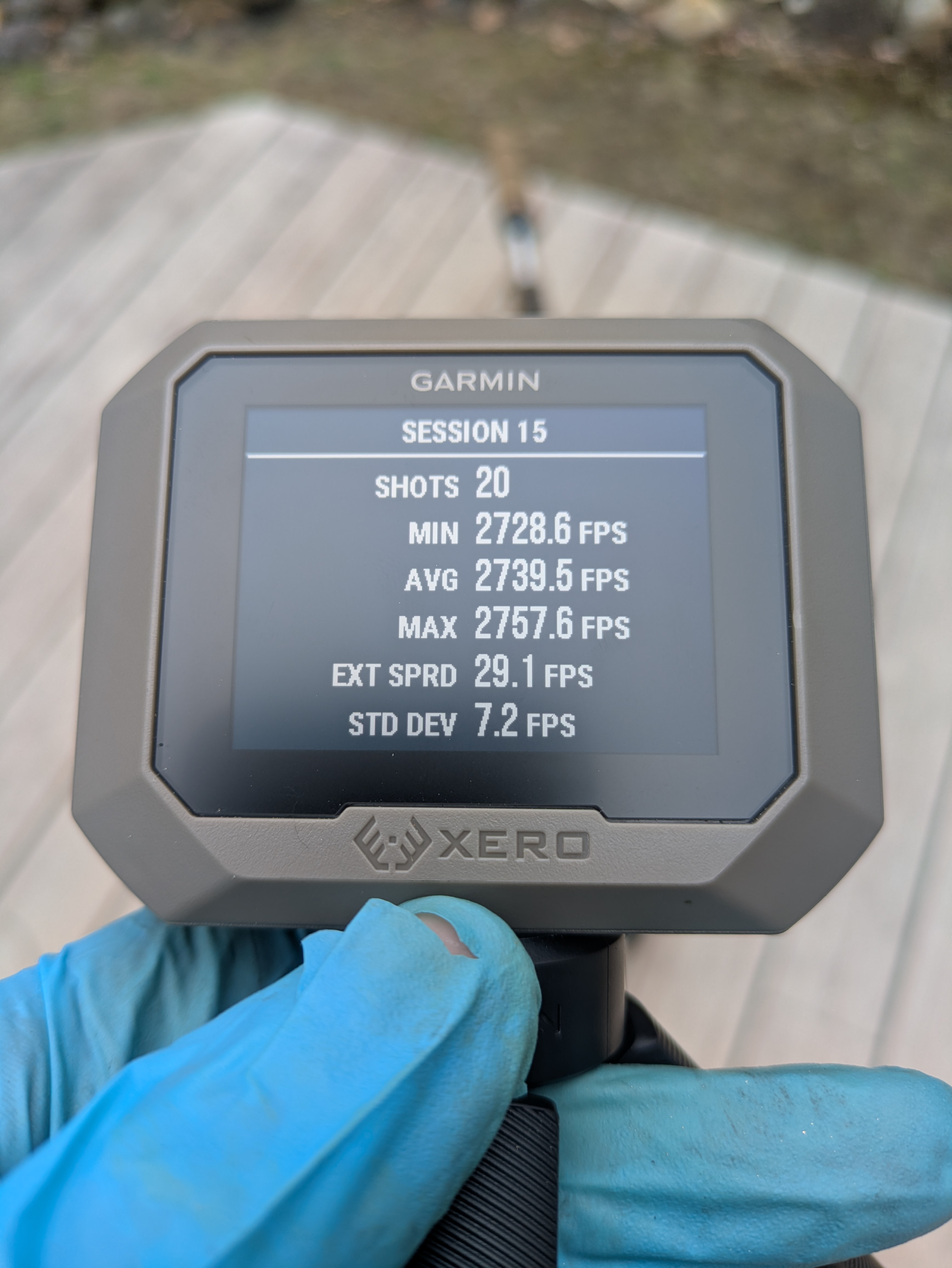

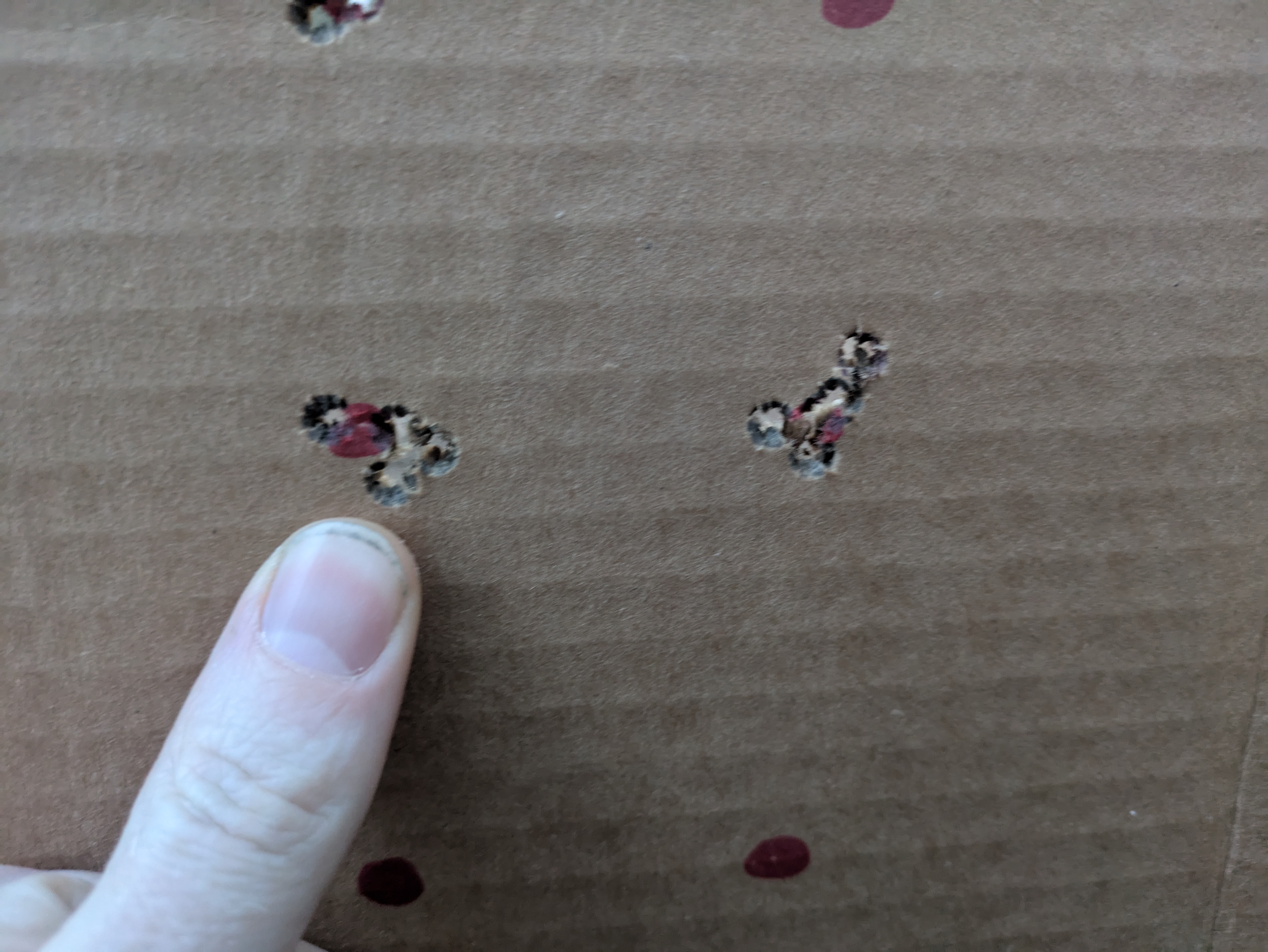

I just bought my first 6gt. Solus Action with an 18-in Keystone spun Barrel. It was stupid easy to do load development. This was my 20 round string today with 105 hybrids and 32.9 grains of varget.
I'm a huge fan, coming from 6 creedmoor. I wanted something that punched harder than 223ai and was easier to load for.

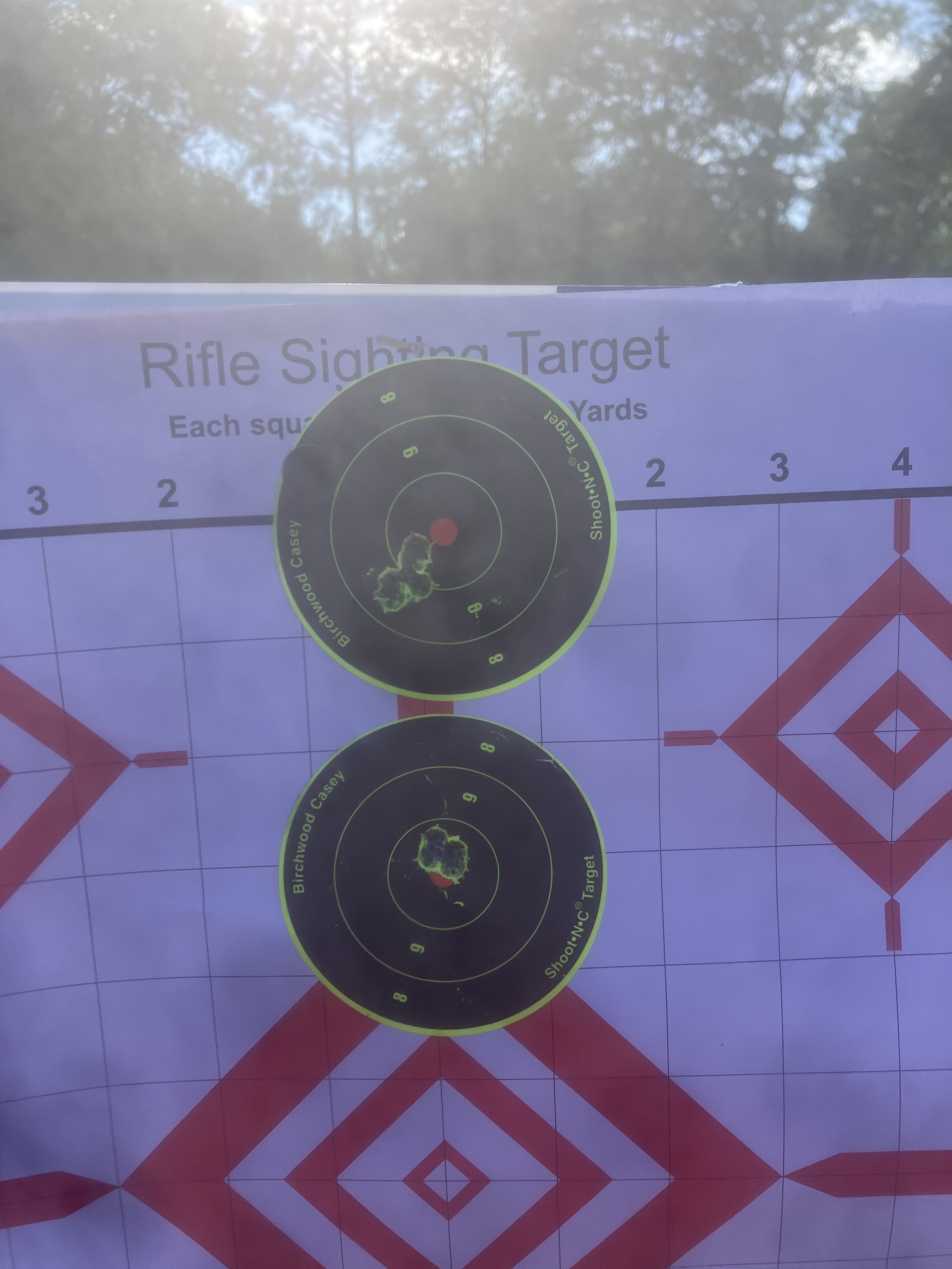

Those are the last two 5x groups I shot after messing with seating depth a little bit.

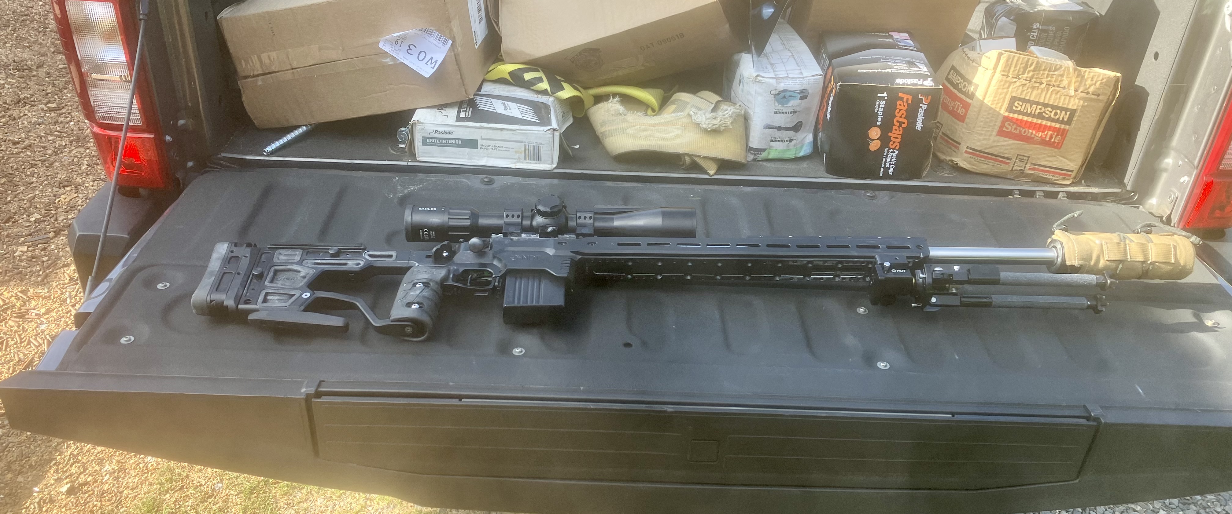

It's running out of an ATX chassis with standard 308 aics magazines. I need to tweak some AW mags to see if I can get them to run.

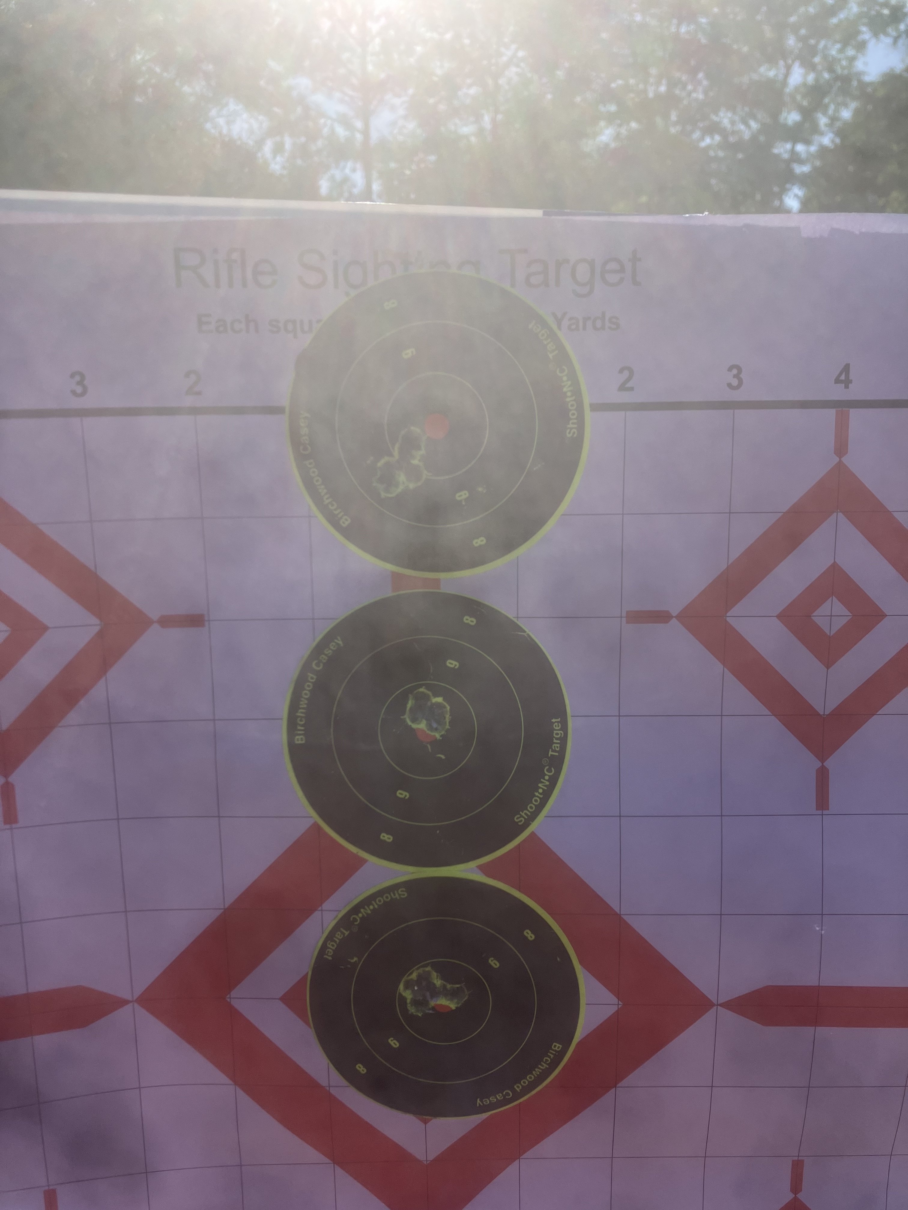

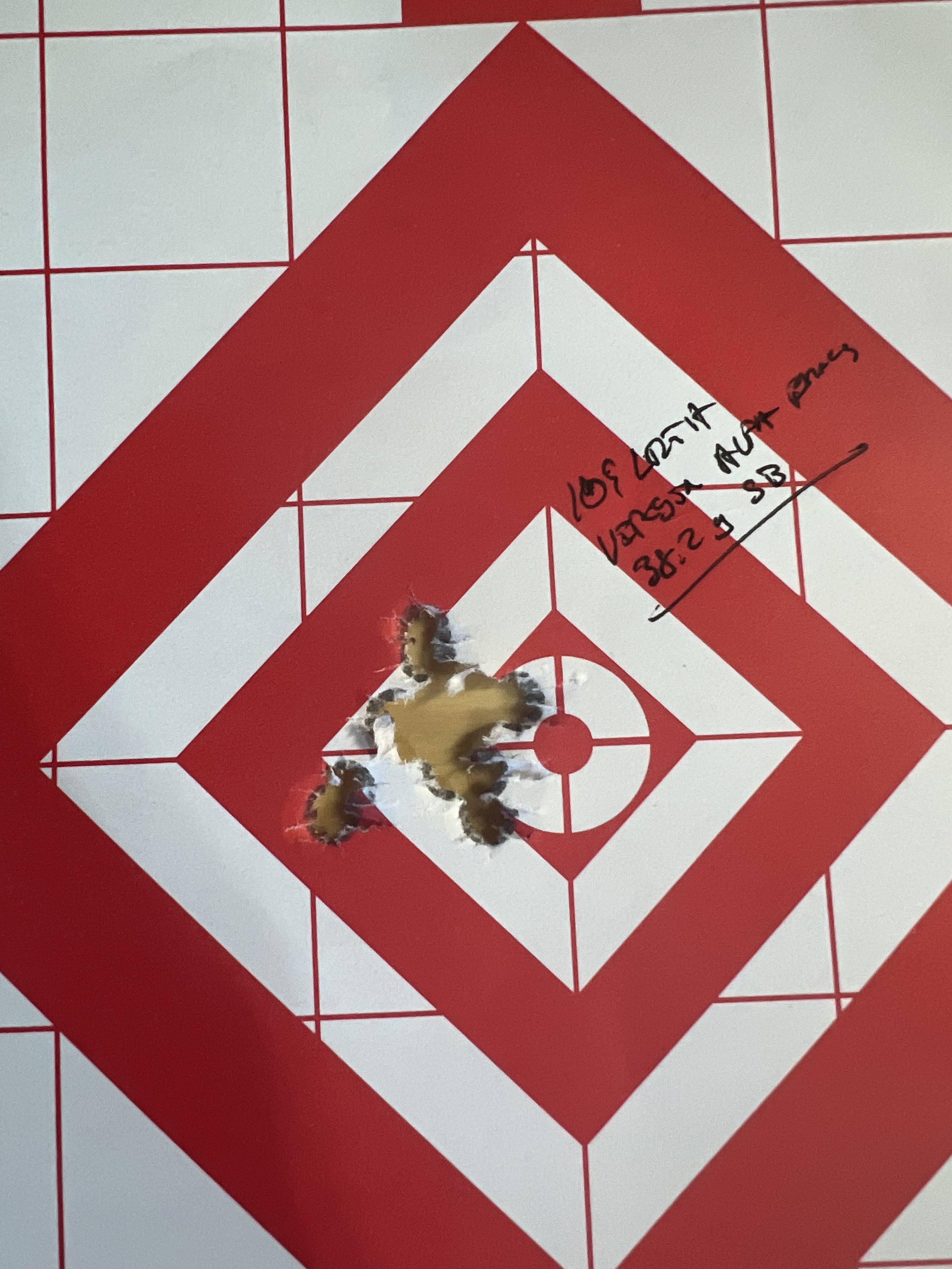

I really like the GT.. I’ve developed some fantastic rounds using my 550 Dillon and using volumetric powder throw with 6.5 Staball… no trickling for me!!! So if a round can use Staball I’m in… photo is a 20 rounds group out of a Faxon barrel on a day with 15 mph wind… minimal load development. I’m taking a hard look at the 25GT as well now… alpha makes brass and seems you can get the 135s up to 2700 fps out of a 26” barrel with Staball… or going 25 Creed. But that’s a problem for future me. ATM I’m loving 6GT. 6BR will be great as well, but I hate tricklers….
