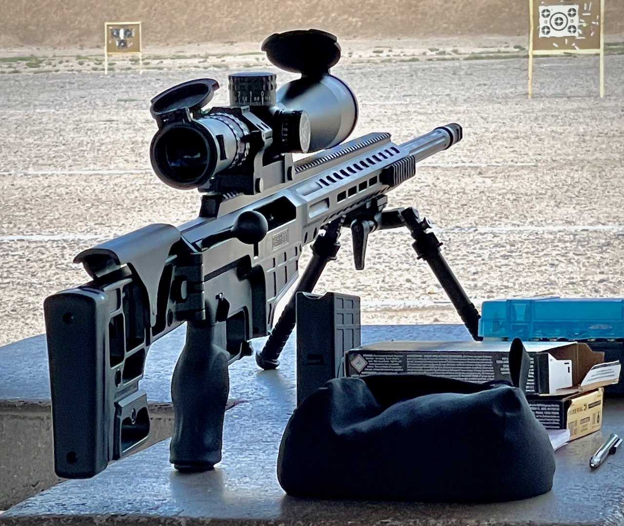

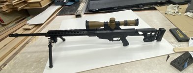

I've got both an ai ax and the new mrad. If prs style shooting or occasional hunting is your game the ax is the way to go. Elr shooting the mrad is awesome. Very linear recoil, no twisting and unbelievable light recoil. The weight plus the center of gravity of the rifle does a great job mitigating forces. Me and my shooting buddies shot this morning and I had a chance to go long i.e. 2055y. I was able to self spot as the thing is a pussycat to shoot. 338lm, thunderbeast 338 ultra sr. Hit 5 times, last 4 were all in a row. Very impressed.

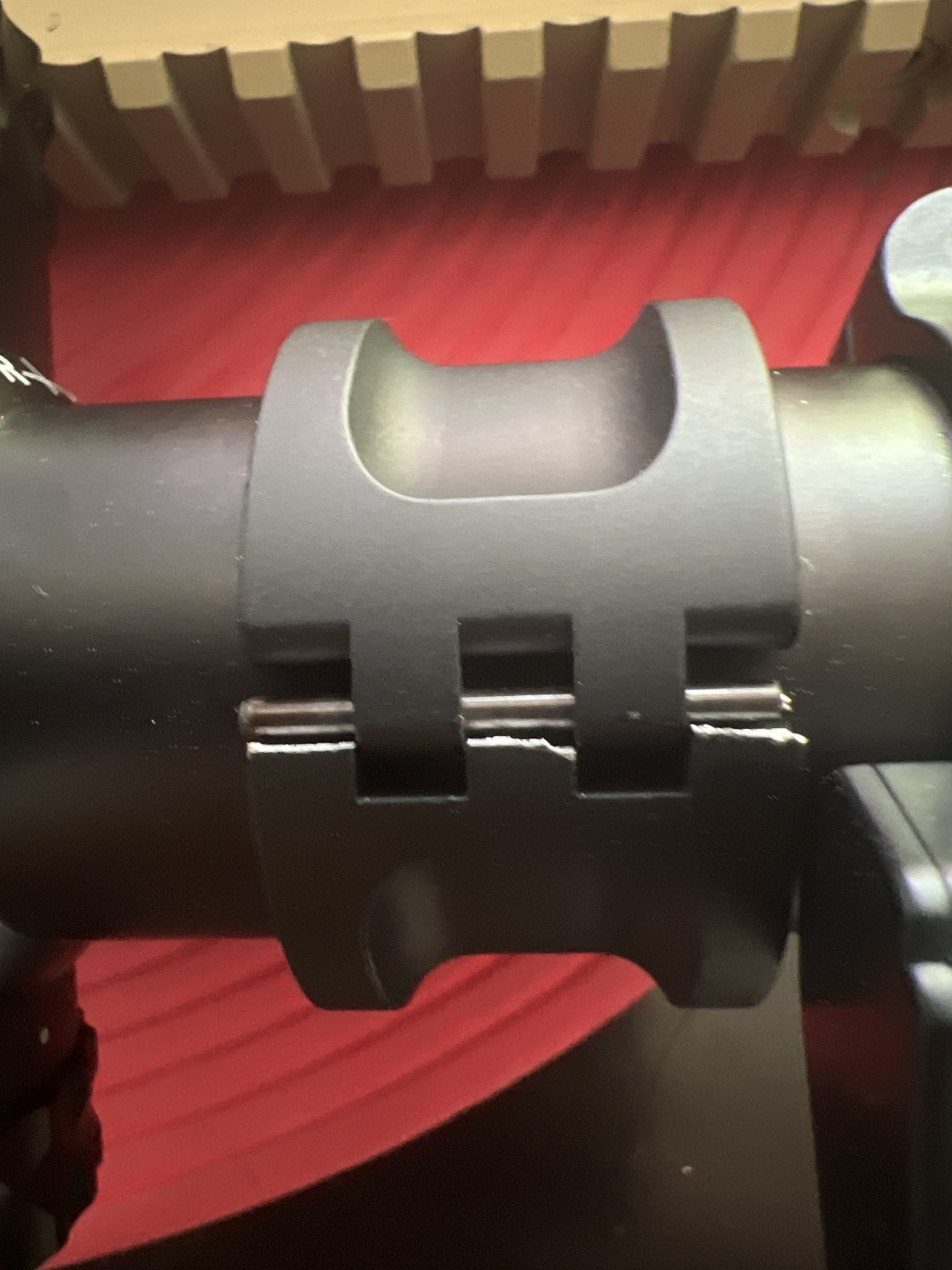

Hey, I’m very new to this community. Trying to get some expertise om my MRAD(338NM). I have it setup with a Nightforce ATACR 5-25 in a scalar works leap mount. I’ve had issues sighting the gun in effectively.
To start, I leveled the scope in the base on the gun as per the instructions. Went to shoot the gun for the first time. After about 5 shots with making some adjustments, the rounds starting going off the paper. I went back and found I had under tightened the rings on the base. I then retightened the base to a torque that was too high breaking the base of the mount.
I got a new base and releveled the scope in the mount(to the correct torque amount). Took the gun out to sight it in again with a suppressor on it with my buddy who is a former marine scout sniper. He and I struggled to even get the gun on paper. We put 18mils of wind adjustment on the scope and it didn’t move an inch at 12yds. I then called nightforce to have the scope sent in. They sent it back saying it was fine.
I remounted everything and boresighted the scope. It was 3 ft high and left. Got it moved to about 6inches high and then the rounds walked off paper after about 30shots. I’m at a loss for words on what to do besides maybe try the scope mounted on a different gun to rule that out? Really want this gun to be as good as I’ve heard from a lot of people.
Could it be a blown barrel from a hot load? No pun intended! Any help will be greatly appreciated!
Lots of things could be wrong. Do you have a 10 mil rail on your mrad? How many moa/mils is your mount? Did you push the mount forward then tighten to the rail? What ammo you using? Are your screws on the mrad(gripping the barrel) torqued correctly 140in-lbs. Is the muzzle brake tight or loose? When you installed the barrel did you close the bolt then tighten your screws?

Check for cracks at the hinges of each ring. That mount has been known to crack around the axles.

Also, shoot it without the suppressor attached.
Bingo! Found a problem from
bingo, rear ring at the hinge was broke. Makes total sense now! Thanks for the help. Hopefully this fixes everything!
That sucks, sorry to hear it. My understanding is that they've been pretty good about replacing them. They actually came out with a revised design that has several more "mini hinge" parts that you can see on the product page: https://scalarworks.com/shop/quick-detach-mounts/leap-09/

I was surprised to see a crack on my Spuhr. Use Fix-it sticks to exact torque specs so was a little shocked. They replaced it straight away but sounds like this may be a known problem. Hope the replacement they sent is good to go for life.
