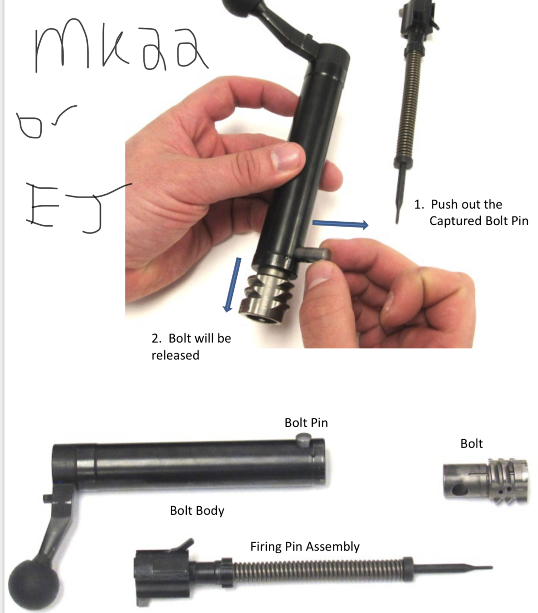

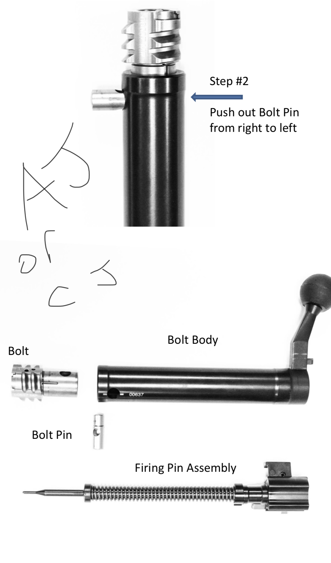

Just joined the forum today. Reading back a while and I hope this helps some of you guys. I’ve had a lot of interaction with the Barrett crew, learned a lot, and I have 3 MRADs and a few other of their products. So hopefully what I’ve learned will help. I have a CJ MRAD and two EJs. I run all the barrels in any of them due to the following knowledge.
AJ000250 (I believe) or less will require screw slots to be cut into the barrel (Barrett does this free of charge and sends labels if you buy used or what not) These MRADs will require the screws to be completely removed. This is essentially a super early MRAD. They are “slick” side uppers and do not have lightening cuts at all.
After the AJ000250 essentially all the way up to the high AJs. There is no exact number range FYI. Anything past AJ002000 could possibly be a small breech. Anything before that I would obviously confirm. I do not have photos showing this but primarily they were .338 LM rifles and the bolt bodies, bolts, and front and rear guides were much larger. This is where your LARGE TO SMALL BREECH CONVERSION comes into play. You will need this to use/purchase any MRAD barrel kit from now On. As everything is small breech now for uniformity.
CJ prefix rifles are the lightening cut rifles (still not MLOK). Barrett doesn’t do “Generations” on these but think “GEN 2” if it helps. IF you have a small breech AJ or a CJ across the board you can use ANY Barrett MRAD kit. I have attached two photos to show why. The bolt pins and bolts are the cause of this. So to reiterate…. CJ and AJ (only those who have done the conversion) can use ANY new Barrett kit or even used kit they find. Also, if you just want a new upgraded EJ/MK22 firing pin that has the fancy flip lever? 18818 is the part number and Barrett sells it stand alone. It is handy and you can keep yours as a spare. You’ll have to call and order it and it will be built to order (2-3 weeks usually).
Now here we go. The EJ / MK22 rifles. You guys can get by super easy too. IF You came across any used barrel kits or discounted Barrett kits. Guess what? You actually don’t need the large to small breech conversion kit to run those barrels. You need 3 pieces. Yes 3 parts only. Bolt tube, bolt knob, and bolt pin. It is about 187 dollars retail for those 3 parts. Plus shipping or tax of course. You’ll have to call and ask for a “CJ bolt tube, bolt knob, and bolt pin” and they can help you out. They are in stock and can ship within the week. Their shipping department is still meh but it’ll get out
Within 2-3 days.
As for the MRADELR questions I just saw. There are zero plans for the .50 BMG. The .416 and the 375 Enabler seem to be the only thing on the table for now. I asked about Cheytac and they hinted maybe in the future but not for a while. Edit: while the bolt face of the .416 May handle .50 BMG I’m unsure even if you wanted to single feed if it would work. Maybe M33? But long loaded AMAX or similar probably wouldn’t fit. Or it would be extremely impractical.
If you guys are confused, emailing into Barrett always helps me as I get better responses via email than phone usually for just product / inquiry knowledge.

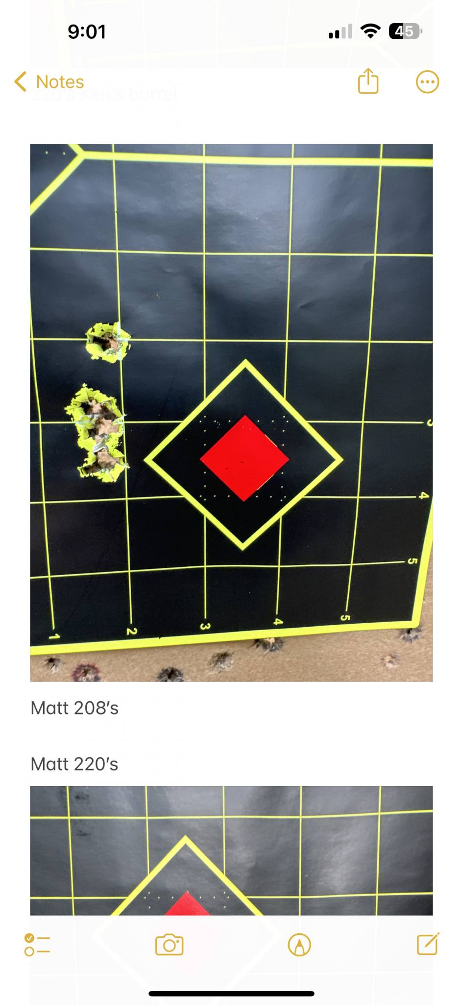

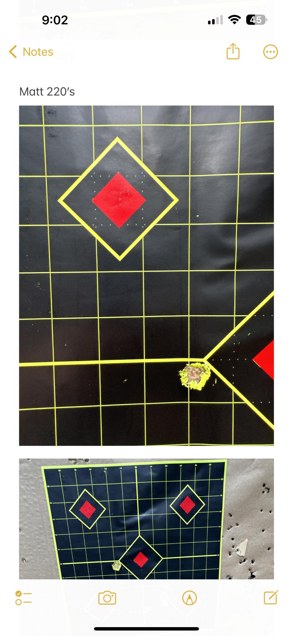

I have done a bartlein modbb 300 norma at 28inches with a heavy modified palma. Was running 82grn of re26 with a 220 berger at 2970fps or 3040. Cant remember. I'm working up some loads for 245's. The barrel is a left hand gain twist starts at 1/9, exits at 1/8. Shoots great so far only 160 rounds into it. This was chambered by lri. Swatdude1 has used bugholes and has been happy with his stuff. I've had mrad barrels done by a number of smiths and they're all shooters. GAP, Spartan, LRI, PVA.
Reactions: taliv and mike10
What made you go with the gain twist? Got any pictures of groups?
Nice man. What sort of velocities you getting?
I’m averaging around 2860-2880. I also don’t reload unfortunately so that’s with factory hornady 180 grain. A ten shot grouped .58 inch.
-Bartlein barrel blank, 7MM bore, 8 twist, #9 heavy varmint contour (5" long breech end at 1.250" for MRAD extension)
-Cut muzzle threads 5/8X24 at 22" finished length

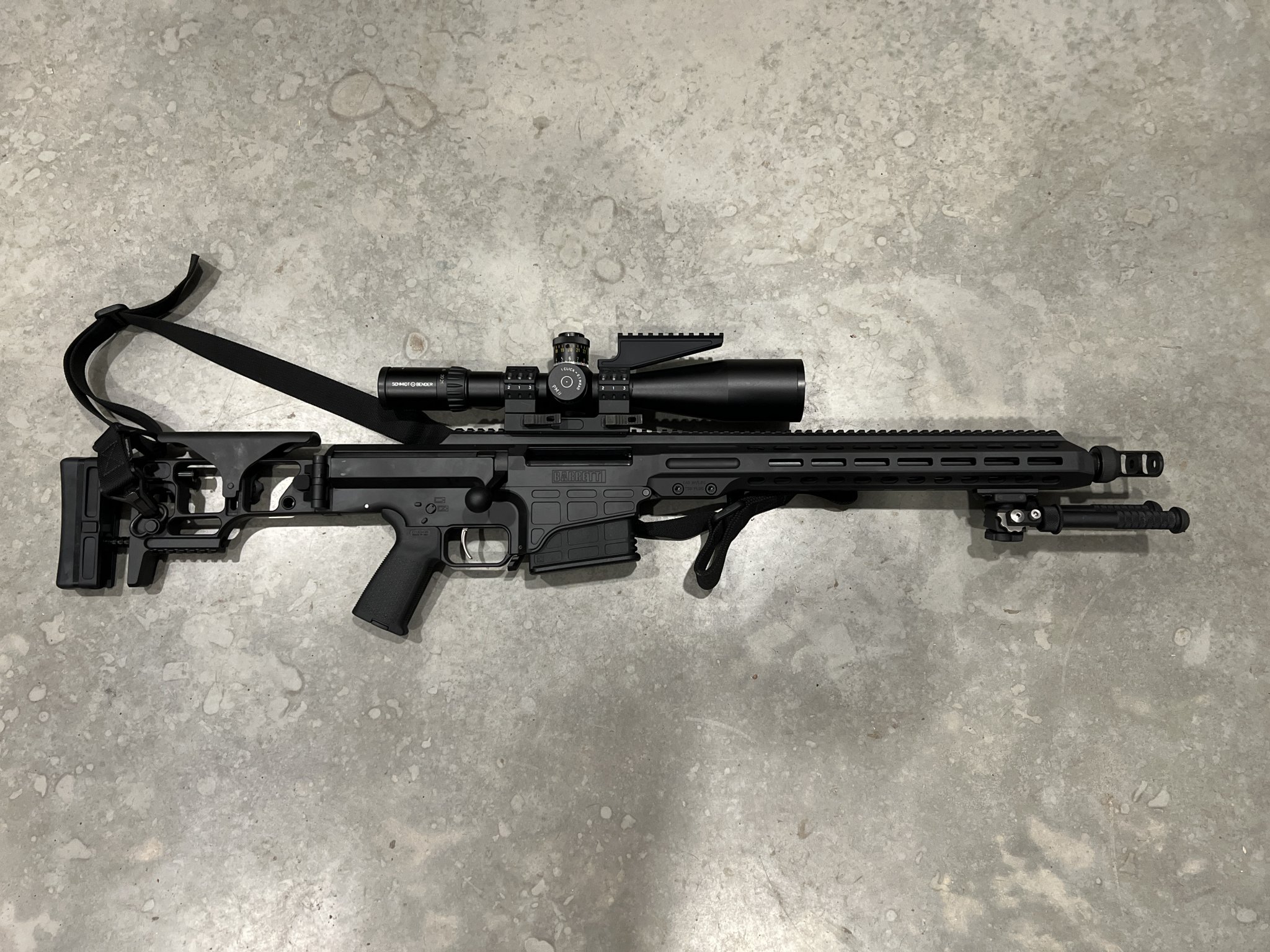

Got My 308 Shorty. Probably going to rattle can it. Overall I'm very impressed! 300 PRC barrel is on order, apparently its going to take 12-18 months :confused:
I want a 308 shorty as well. My problem is I have too many damn rifles and barrels to keep justifying more barrels 😭
How much does your rifle weigh as configured in the picture?
Reactions: Mareshow
Just weight in at 16.5 lbs as configured, it’s basically a bull barrel under there so she’s got some heft

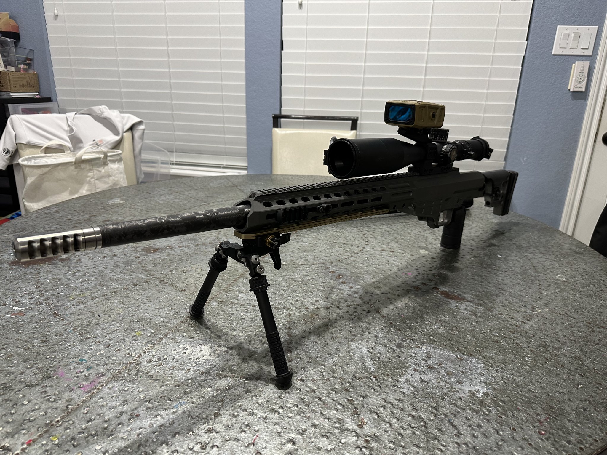

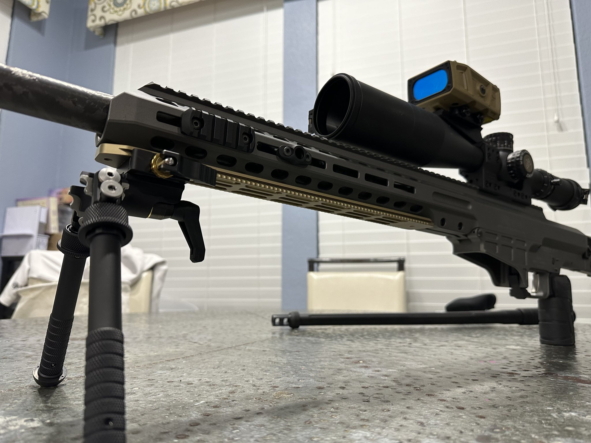

I've been reading on the forum for quite a while now and have gained so much information from everyone on here. It really is one of the best resources out there for anything long range related. I finally figured I would reply with my MRAD and how it's set up. It's been a great gun so far and I've been able to shoot several hundred rounds out of each of my barrels.
Here is my current setup... Eager to hear some feedback on any changes y'all would make.
Currently have my Proof Research 7PRC barrel installed with an Unknown Munitions Ti Pro 5 brake. (I also have the Barrett .338 & 6.5 creedmoor barrels)
Recently picked up an Area 419 ARKALOCK rail to mount a bipod, Garmin Xero C1, and a Tri-Pod

Great setup! The Tremor3 is the sh#%! I just got the Vortex on sale at Europtic. My MRAD was pre-Mlok but I was still able to mount the Area 419 ARCA rail on it. Thinking of moving it forward as far as I can to get the bipod closer towards the muzzle for extra stability.
Yeah, this is my first optic with the Tremor3 reticle and I'm loving it. The ARCA rail is great! I'm looking forward to being able to use it with the Area 419 Garmin Xero mount. I'm curious if moving the ARCA rail out further would provide a benefit. I can see how it would provide a bit more stability but am curious if it would flex at all negating any stability benefit you would get from pushing it out further.

How do you like the sled feet on the ACCU? They only seem to bear on two points due to the angle that they use.
I agree fully with your instructor. Pull bipod back. Proper shoulder weld, breathing, trigger control, not wrapping fingers around the grip, and follow thru. For years, I was doing it wrong. Those 6 points and the discipline to use them, result in better groups for long range for me.
Reactions: Swatdude1
I think the sled feet work great. They do rotate so they stay flat.

ETA - Still need to snap some better pics but I finished shooting session #2 with the A419 Mk22 Arcalok rail. I'm a fan overall but the Arcalok adapter has been reassigned to Garmin Xero duty. Went to the ADM adapter and I'm much happier with it. @Swatdude1 I was just working through the skis thing myself! My Atlas CAL soft, super sticky rubber feet are already noticeably worn after only 122 rounds. My range doesn't have anything to really load the bipod into so recoil control really comes down to me. Just moving the rifle around the table has it jumping and bouncing on the soft sticky rubber feet... Skis rolled in earlier this week and I finally installed them today. I'll be curious if allowing the rifle slide smoothly back has any noticeable effect, besides more felt recoil.
