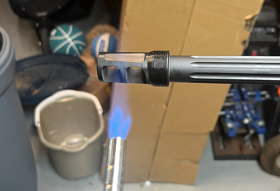

What is that standard muzzle diameter of a the larger 30 cal magnum calibers like 300 norma on the standard, factory steel Barrett barrel?
My 26" 300WM and 26" 300NM are showing 0.9" OD at the shoulder. Threads should be 5/8-24.

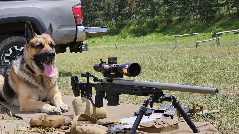

ETA - Still need to snap some better pics but I finished shooting session #2 with the A419 Mk22 Arcalok rail. I'm a fan overall but the Arcalok adapter has been reassigned to Garmin Xero duty. Went to the ADM adapter and I'm much happier with it. @Swatdude1 I was just working through the skis thing myself! My Atlas CAL soft, super sticky rubber feet are already noticeably worn after only 122 rounds. My range doesn't have anything to really load the bipod into so recoil control really comes down to me. Just moving the rifle around the table has it jumping and bouncing on the soft sticky rubber feet... Skis rolled in earlier this week and I finally installed them today. I'll be curious if allowing the rifle slide smoothly back has any noticeable effect, besides more felt recoil.
Noticeable affect is better accuracy due to consistent rearward motion. It is easier to duplicate a light touch to the shoulder than pulling the gun in hard with your bicep. You will never be able to duplicate the amount of force you apply each time with a strong pull. Also, front loading a bipod with one that has ANY give at all will also introduce effects that keep the barrel from recoiling directly back in a straight line. Think about it... with the bipod legs pushed back hard, the height of the barrel is reduced. When fired, as the rife moves rearward, the barrel will actually increase in height as the bipod legs hit their full height through recoil. There is also the benefit of getting your sight picture back quickly to witness impacts.

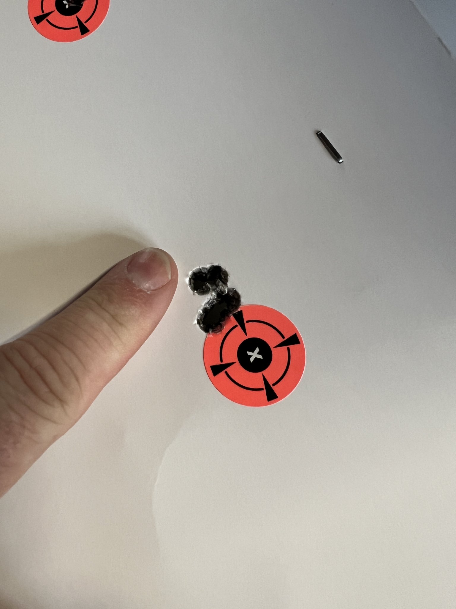

The proof was in the pudding when this extreme newb to even bolt guns in general hit two consecutive shots at 2 miles in 13-20mph winds. And at that time I was using a crappy bipod without skis (not loading it though). Note: the weight of your rifle will have a big effect on how free recoiling feels to you. My MRAD all decked out with ATACR and AccuTac bipod weighs 27 lbs with the 33XC barrel and after shooting almost a hundred 33XC rounds that day with Chase, I had minimal shoulder discomfort.

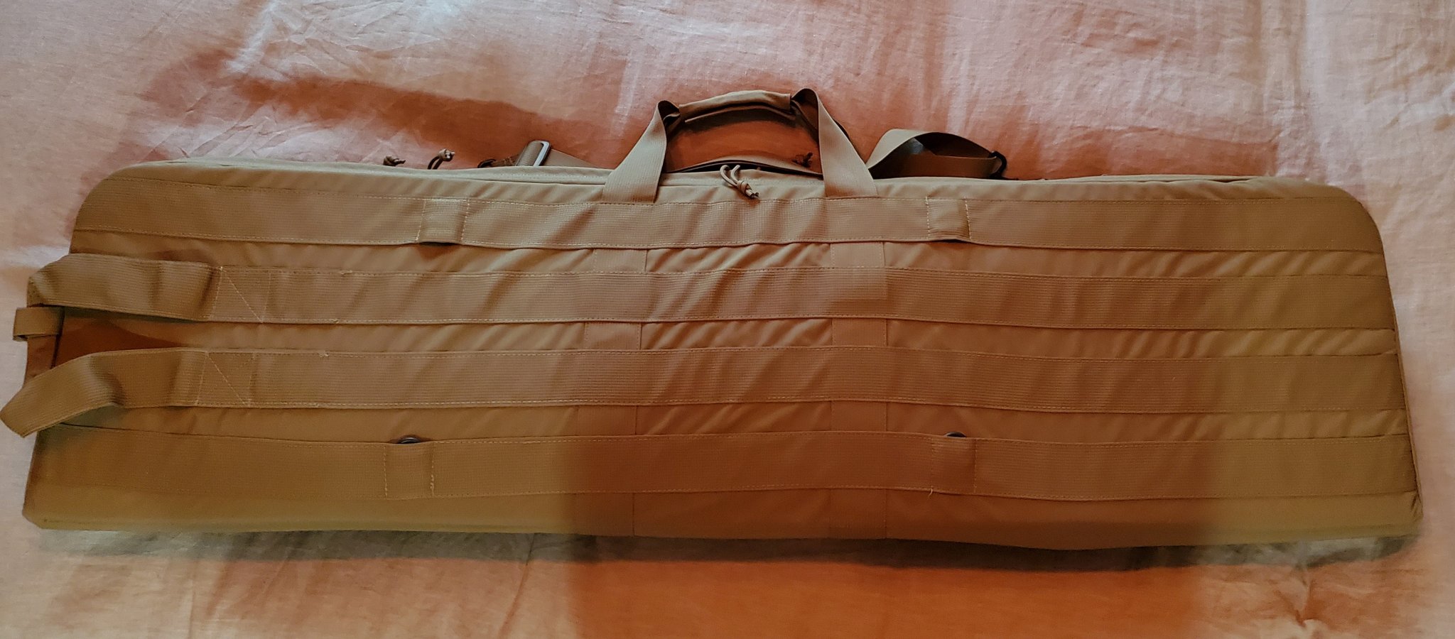

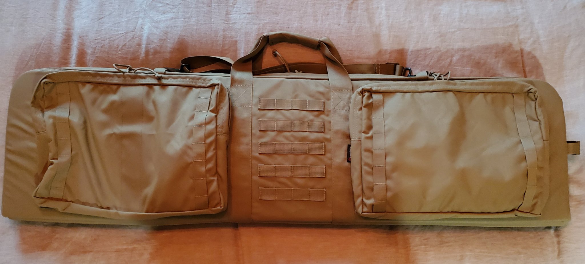

I just received my new MRAD soft case/drag bag. I contacted Armageddon Gear and requested the soft case that they are making for the military's new Mk22 ASR (MRAD). A great design that will fit in a hard case and also can be used as a drag bag. It also comes with removable shoulder straps on the back which makes it even more versatile. A great bag made in the USA.
Thank you! This is a four year old post but it solved my dilemma. I'm ordering from barrett the MK22 case and foam for my MRAD and barrels and it does not come with the soft case. I couldn't find it for sale on barrett store. Searched snipers hide and DONE. back ordered but found it. Now $449.95 . I will confirm with barrett tomorrow if the case they offer is in fact the one that will accept the soft case.

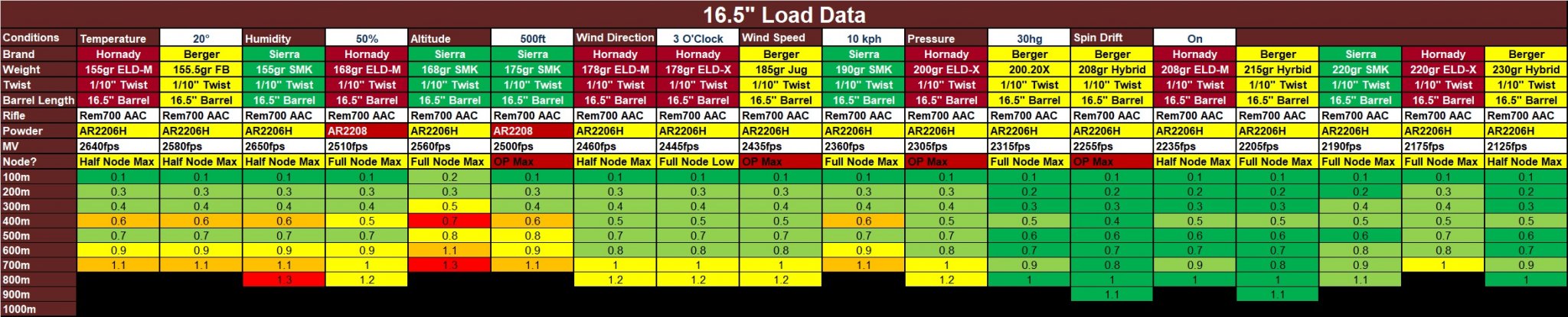

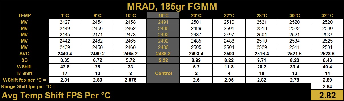

We've been pushing them out to 1000y in the 17" with the Factory GMM ammo loaded with the 185s.
The kestrel has us trans at 800m and sub at 1000m in standard atmospherics.
The heavy bullets will fit your magazine, but it'll depend on just how long you want to go. Having said that. We compared the 185s to 200, 208 and a bunch of other heavies and the design of the 185s is so good that they typically performed better than the BA predicted and made the 208s etc very very similar to the 185s. So much so we just gave up on trying to get the heavies to fit typical mag length and just went with the 185s.
We haven't done the Ammo test in the 17" barrel yet due to the primer shortage but the 16.5" will be close enough for comparison's sake.
