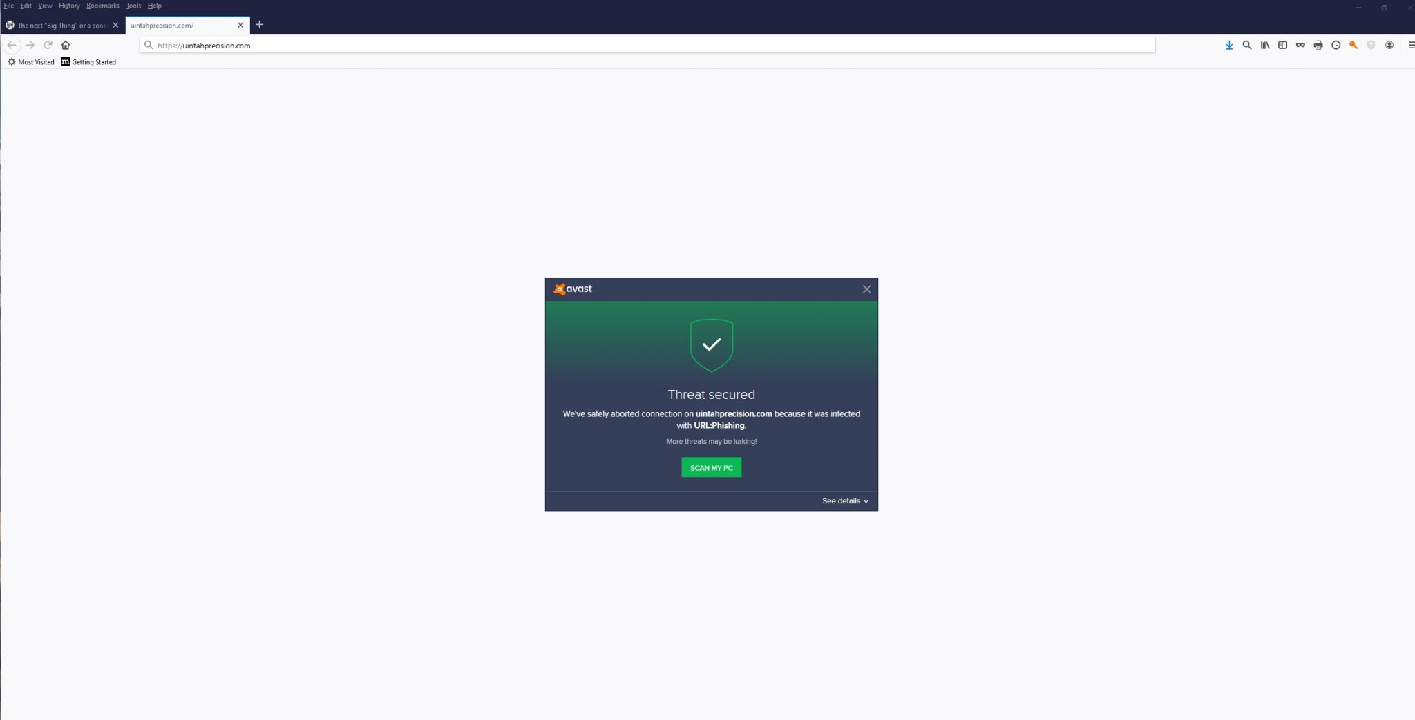

Tried to use your link, got a virus warning right away. Heads up if you used it and you don't have an anti-virus program that scans sites before it displays them you might want to run a virus check.

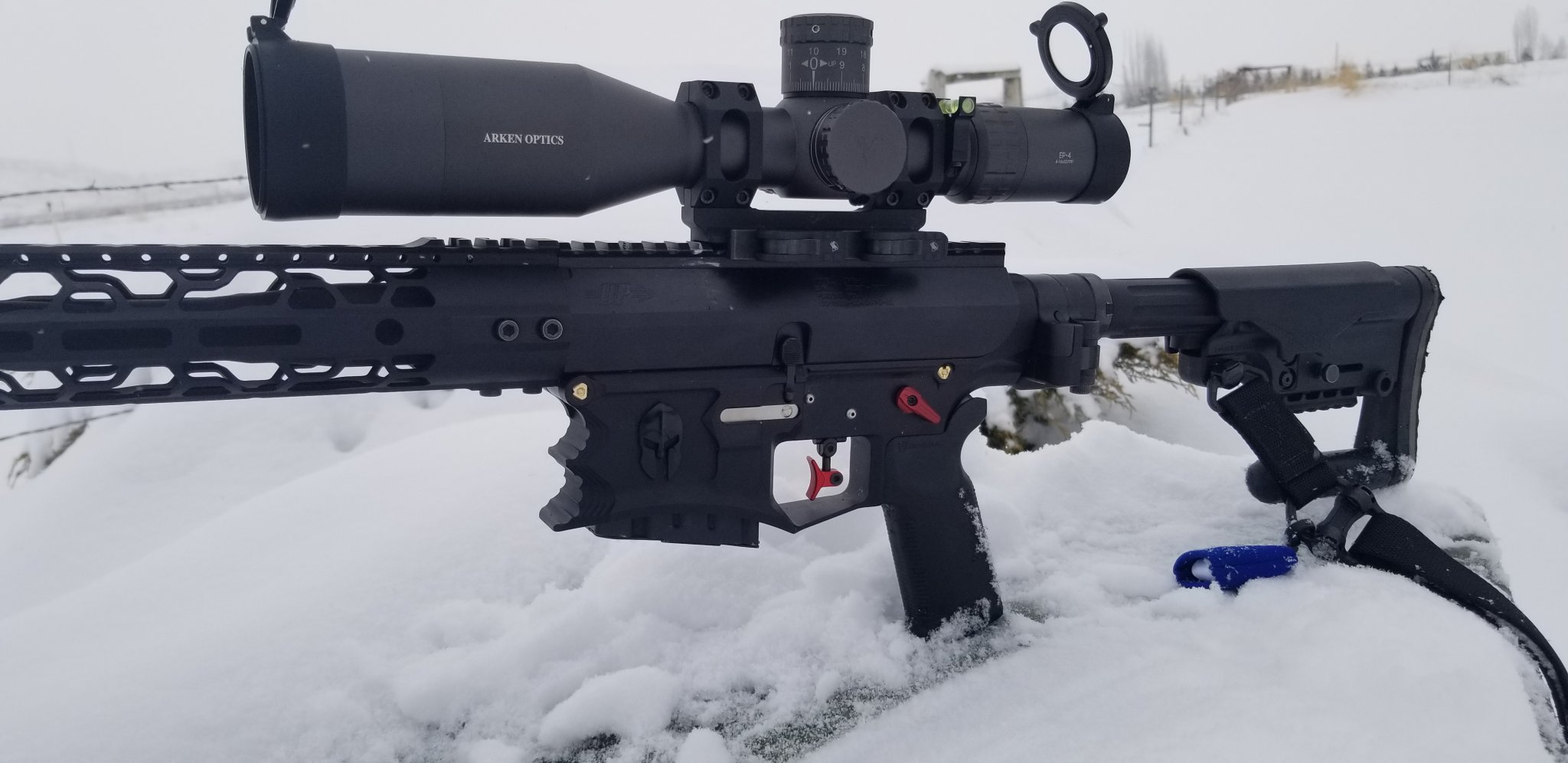

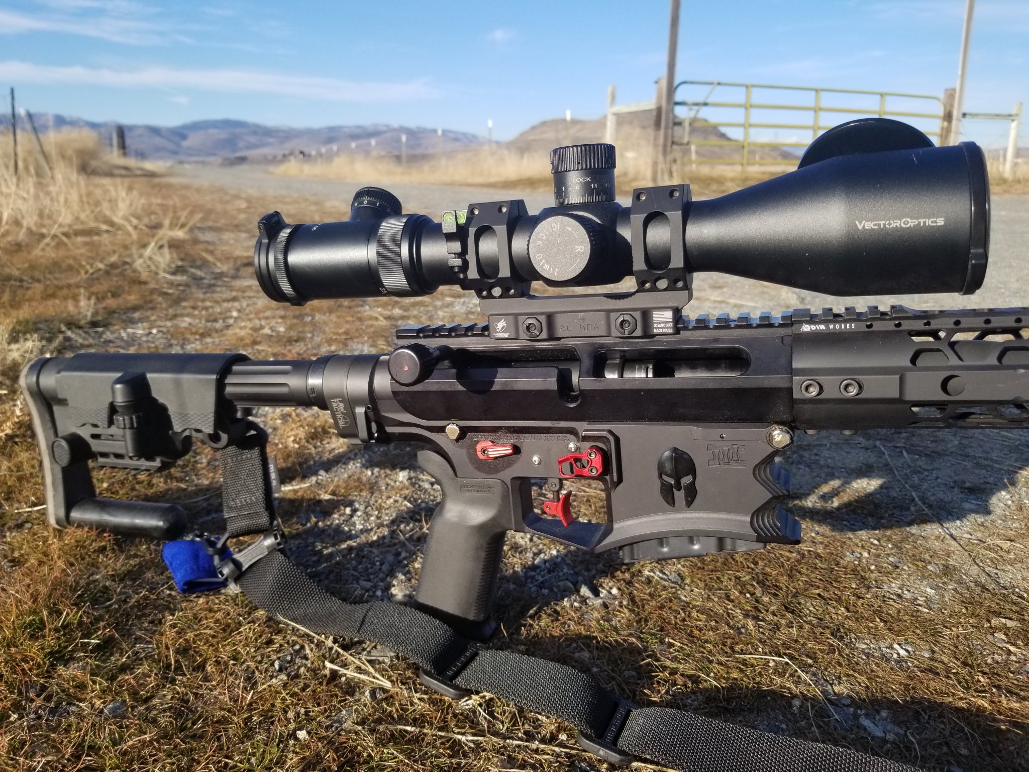

I own one, and I have to say I love it.
I prefer the action much over a desert tech I shoot regularly, but for sure there is going to be smoother actions out there. I think a lot of people write it off because it seems so gimmicky. However it’s worked for me, I shoot quarter moa 5 shot groups with it, I put 4000 rounds through it (6.5cm) and at the end of its life it still shot less than half inch groups. On top of that I can get two shots in the air at the same time at 1000 yards and get impacts, I shoot out to 2000 yards with back to back hits on a regular basis. For the first time I tried taking it out to 2800 yards, I took five shots and we couldn’t see any splash, I went back and watched the film and all the shots were landing within 1 foot of each other. So for those of you wanting some feedback that is it, I’m not trying to toot my own horn, just letting you know my experience with it. I’m not associated to them, but i rep their product hard because I think it’s a hell of a product. You can see some posts and videos on my IG Boltactionbrotherhood.
I will tell you one flaw I have found in it that drivers me nuts. The Upr-10’s use an Ar-10 firing pin that has a diameter of .078 which makes primers crater like a mofo. You can’t even get near max pressure without the primers flowing into the boltface.
that being said with the 153 atips I can still get them moving to 2800 FPS with RL 26 and about 2750 with Rl-16.
That being said I’ve worked with them on a new bolt using a small firing pin, which I believe their next version of the bolt will include that.
The other downside is you are restricted to the Ar-10 magazine. Longest you can fit in there is 2.870 coal (ASC mag) . But for me personally I single feed 90% of the time with the type of shooting I tend to enjoy.
I have never noticed an issue with lock time, but never thought to much about it either. let me know if you guys have any questions!
End of the day I think it can perform with the best of them, and honestly have never been outshot by another 6.5, and it typically out performs any caliber rifle I have shot along side at long range. (Not saying it’s superior, just saying it can perform great if you do your job)

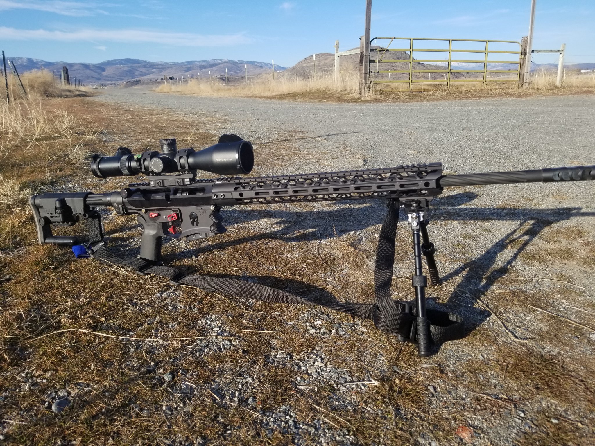

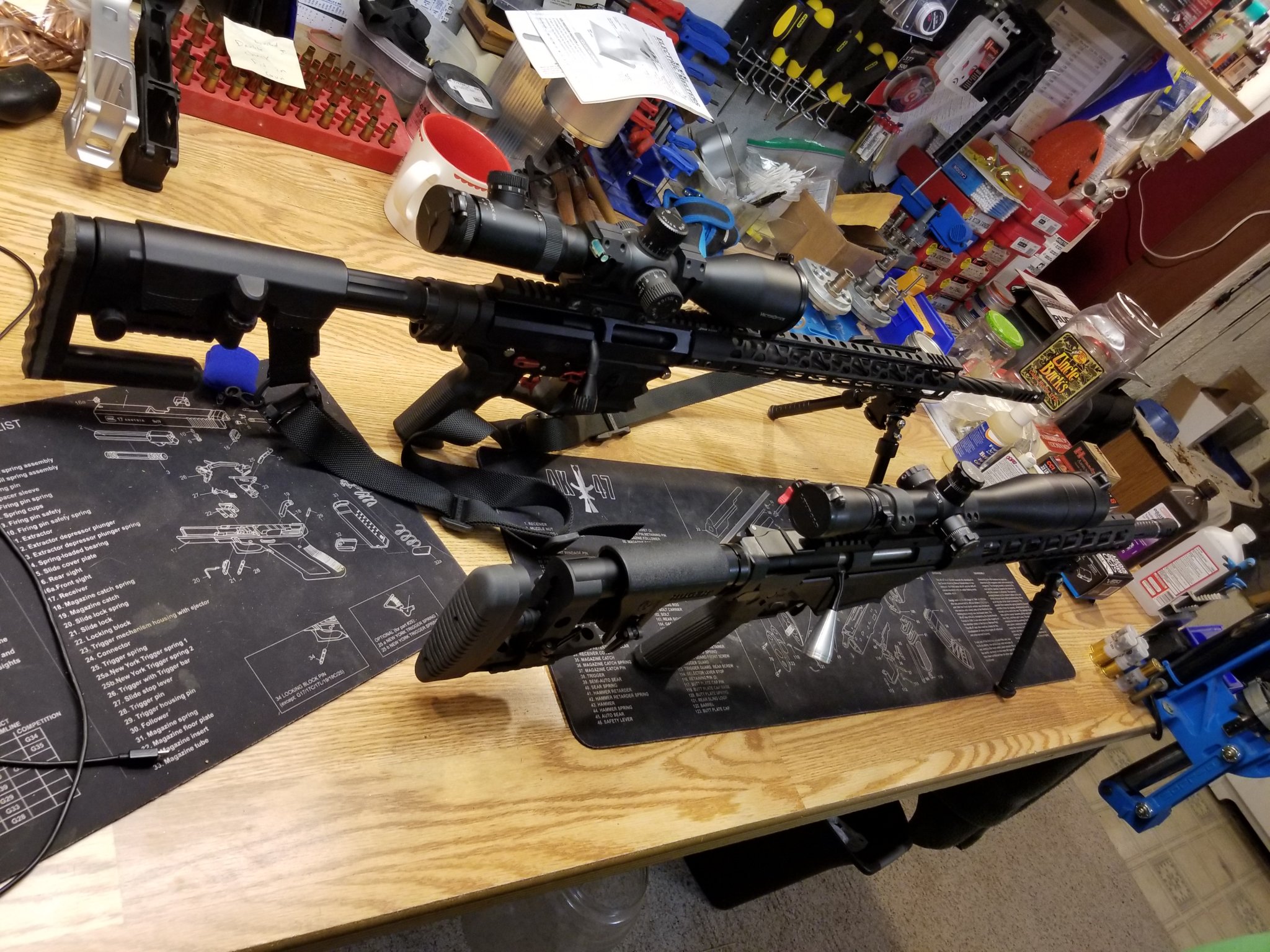

This is extremely encouraging to hear! I just purchased (yet to receive) my UPR15 from them in 6.5 Grendel and I am excited yet nervous for it. A few of my buddies said it was a stupid purchase and you can just buy a precision rifle for that price, but a few factors that played into my decision to proceed with purchasing one are:
1. I already had an AR-15 lower sitting around to build something on, yet I already have 2 5.56 AR's built for different purposes, so I wanted something different
2. I live in NY so we have an "assault" weapons ban, so I have to build AR's either unsafely with a locked mag or featureless which tends to be less ergonomic.
3. I wanted a round (6.5 grendel) that can reach out further than my 5.56 but still AR-15 platform, yet also something I could hunt with
4. No one I knows owns one, so I can be different and unique which is cool
5. I wanted to post a photo for all my snowflake friends to see what they say like "Why does anyone need a weapon of war like that" and I can turn around and say, Its a bolt action so :p haha
Good man, when did you order it? They usually ship out pretty fast! I have a upr-15 as well in 224 valkyrie, and was shocked how well it did out at one mile.
You will be very happy with it, make sure to find a mag that works well for you etc.
Let me know if you have any questions.
I ordered it like a week and a half ago. It arrives tomorrow. They were backed up because of shot show. I was between the .224 and 6.5 and decided 6.5 for its knock down power for deer hunting and the fact that I live in NY so we really dont have many options to shoot beyond 300 yards really lol. I probably could have gone with 300bo, but I want to get a pistol in that caliber so I voted against it. I cant wait! I know a few guys who said it was a stupid purchase are still looking forward to seeing/shooting it lol
And as far as the mag, I just purchased my mag from them as well. I paid like $10 more than if i bought somewhere else, but I would assume they sell mags that are known to work with their uppers, so it was a safer bet.
The upper that is now being mated to there own lower has went on Diet! Why till now! Should have had the fat trimmed from the start! Damn it!
