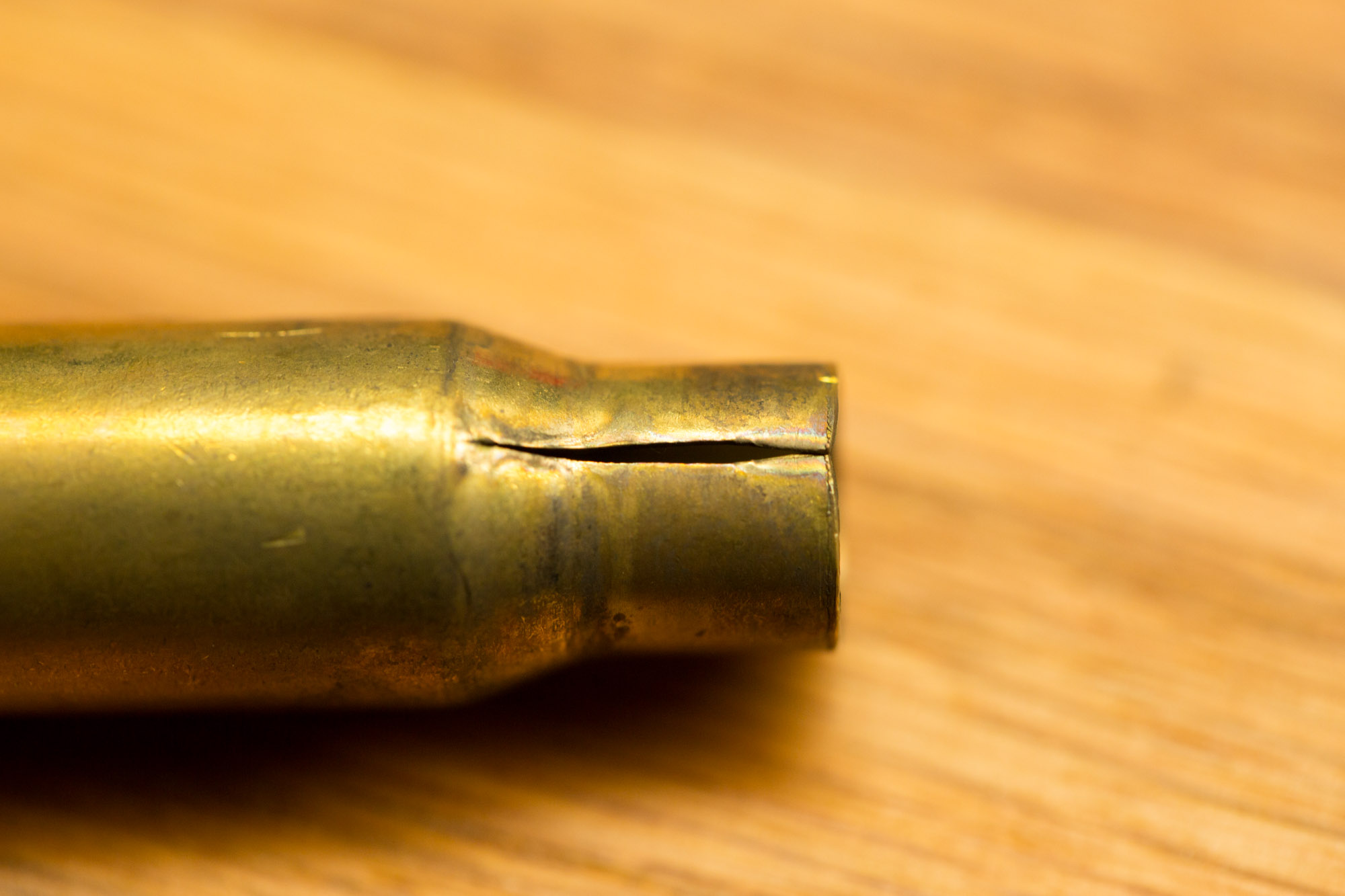

How do I check neck tension? This may or may not be related, but I got one split neck on the Winchester brass. That round didn't sound any different and the rifle continue to function. I guess I lucked out?

here is a good article covering neck tension. Superficially, it’s the difference between OD of the case neck before after seating but neck thickness also factors...
Edit: split neck is ugly - I never use Winchester brass in any of my semis...it’s too thin for my tastes... I like Federal and Lake City for my SR25.

lapua brass looks like it’s expanding .003ish which is fine for a few firings. Lapua brass is a Ferrari compared to Winchester...keep with the lapua and forget the Winchester brass exists.
You other question speaks to why I would never outsource brass prep (or any part of the load production process, other than maybe annealing).
When you give up control of the process, you give up directly controlling the applicable risks. Here the risk in this case is that the brass could potentially be under or oversized relative to your requirement...the requirement being your desired headspace clearance/max case expansion...that risk was realized with the Winchester brass.
Sounds like the brass company just ran your stuff through the die not bothering to ensure they were all headspaced the same between the two brands of brass.
did they ever ask you for a headspace spec?
Reactions: skyfire1201
.008 is way too much for my tastes...esp on thin walled previously fired brass in a semi.
No, they did not ask for a headspace spec. Lesson learned.
Lapua is a bit expensive for my budget, my application (<1MOA for training with a semi) mostly likely doesn't require Ferrari level brass. What are some good, less expensive alternatives?
Thank you very much for the good info and advice! I learned a lot.
You’re quite welcome. Good discussion all around.
