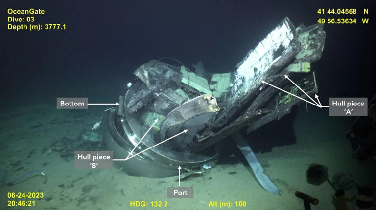

The Navy did actually build an autonomous underwater vehicle with a carbon fiber cylinder with titanium end caps. There is a publicly available paper on it that runs to a bit over 100 pages. Not sure what the depth rating was, but it certainly wasn't Titanic depths.
They talked a lot about the need to ensure that the titanium rings are carefully designed such that the rings and the CF hull deform equally under pressure to avoid failure initiation at the ring/hull boundary. Which is where Titan failed.
I would bet that Oceangate neither read that paper, nor would they have done the work to ensure that the ring deformation matched the hull. Making that work, with 2 materials of very different Young's Modulus while maintaining the required strength is not easy. Lots and lots of interacting variables at play.
For one, a bit of a difference between unmanned and manned vessels.
If you're thinking of the Orca XLUUV specifically then I think that hull is not designed to be water tight, completely different concept.
At best they (Titan) started with someone else's concept and then made several deadly cost saving changes.
The concept of submarines and even underwater vessels both manned and unmanned is well established with numerous resources and programs to help insure their safe construction and operation.
These guys have been working with the Navy for years on carbon fiber vessels.
There is no "concept" to test here. It's been "concepted" and tested and safe engineering is well established.

The only thing they proved was to never use carbon fiber in manned subs at depth

I'm not a composites engineer but I can tell you this thing has so many flaws in the construction that it was doomed from the start. And then to ignore the acoustic and strain sensor data that was collected for this exact reason :oops:
