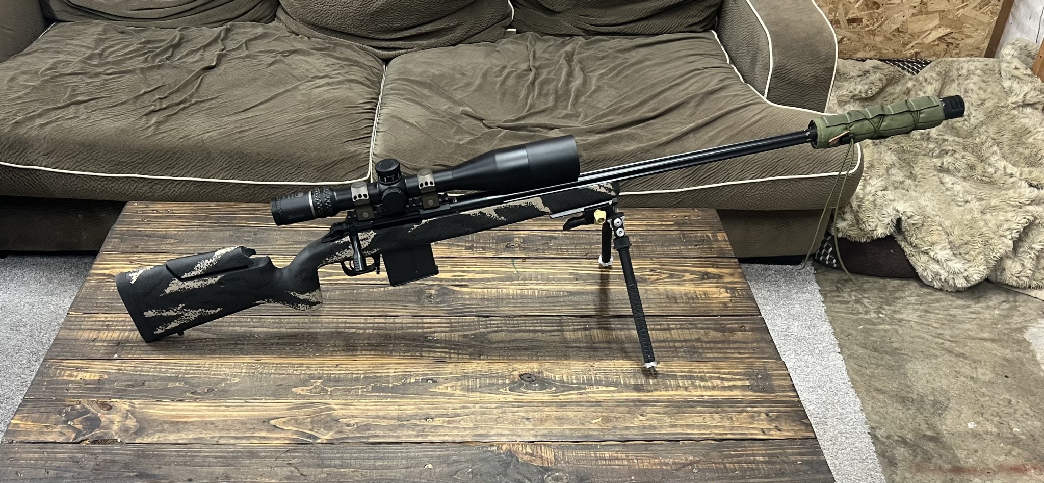

Weight came out to 13.2 pounds

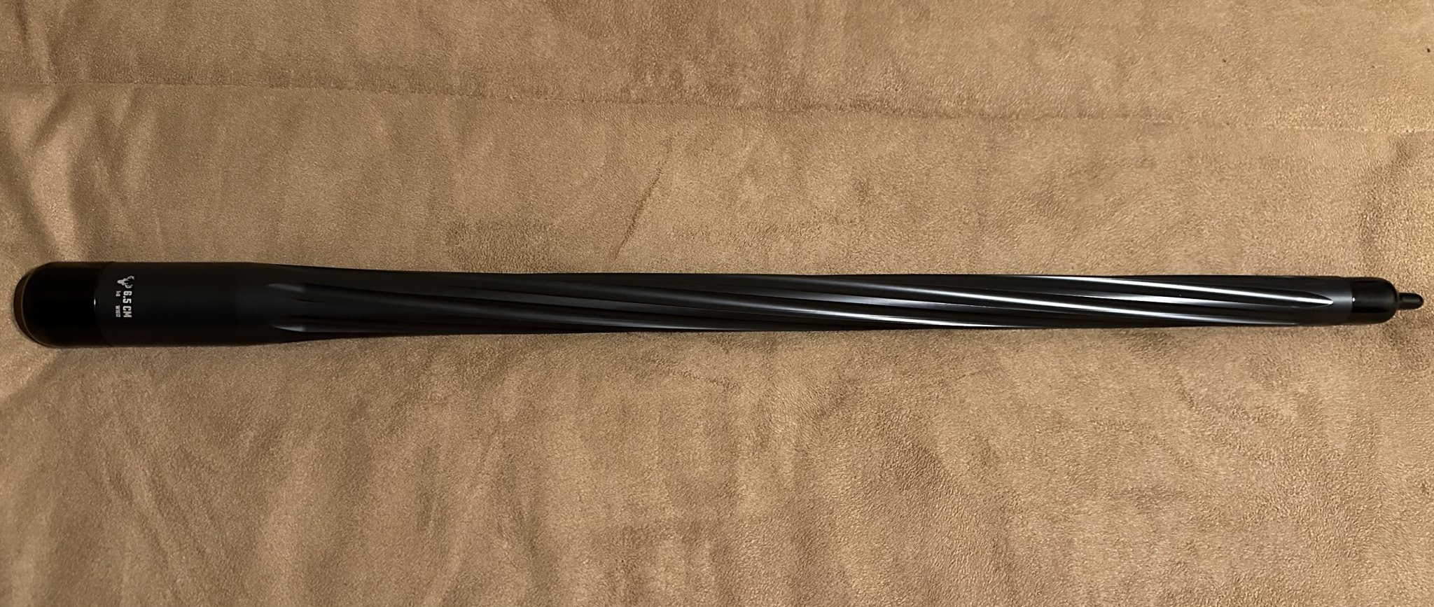

Well, came home from work, and my $200 Aero Solus barrel was here… Yes, to those asking, they were obviously contracts for a Stag Arms bolt action, they have the Stag logo (very small) on them, and it says STAG on the packing slip.
What I was NOT expecting was a very pleasant surprise… It’s already cerakoted to match the Solus actions! It looks GOOD!!! I’d venture to say it’s leaning into the “sexy” territory… Aero need to put spiral fluting on their Solus barrels, too! I might have to order another action when they go on sale to build a lightweight hunting rig with this!

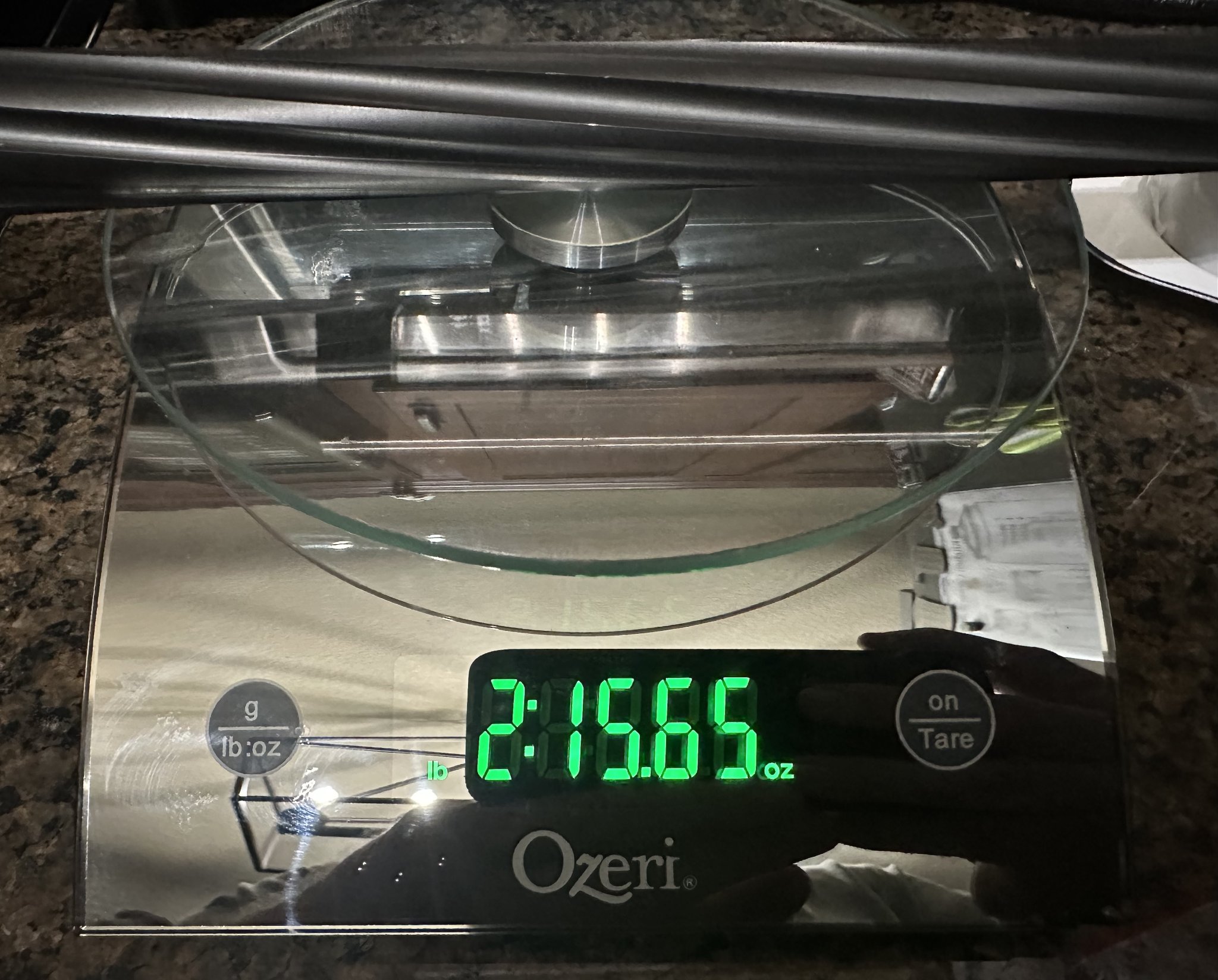

Was that the Sporter weight fluted 22” barrel? If so, what does it weigh?

That’s a nice looking barrel for $200.

Looks good. What model was that?
20" 6.5CM

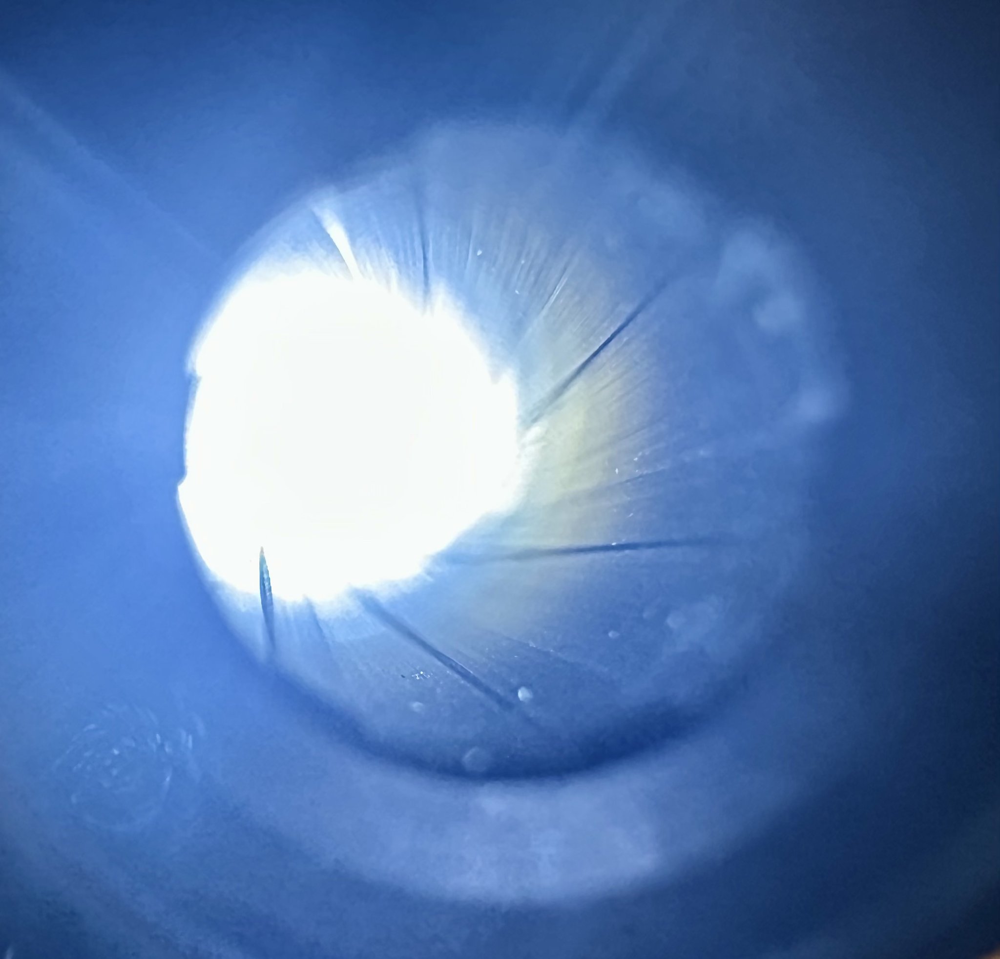

If you get a chance run a bore scope through it and snap some pics if you can.

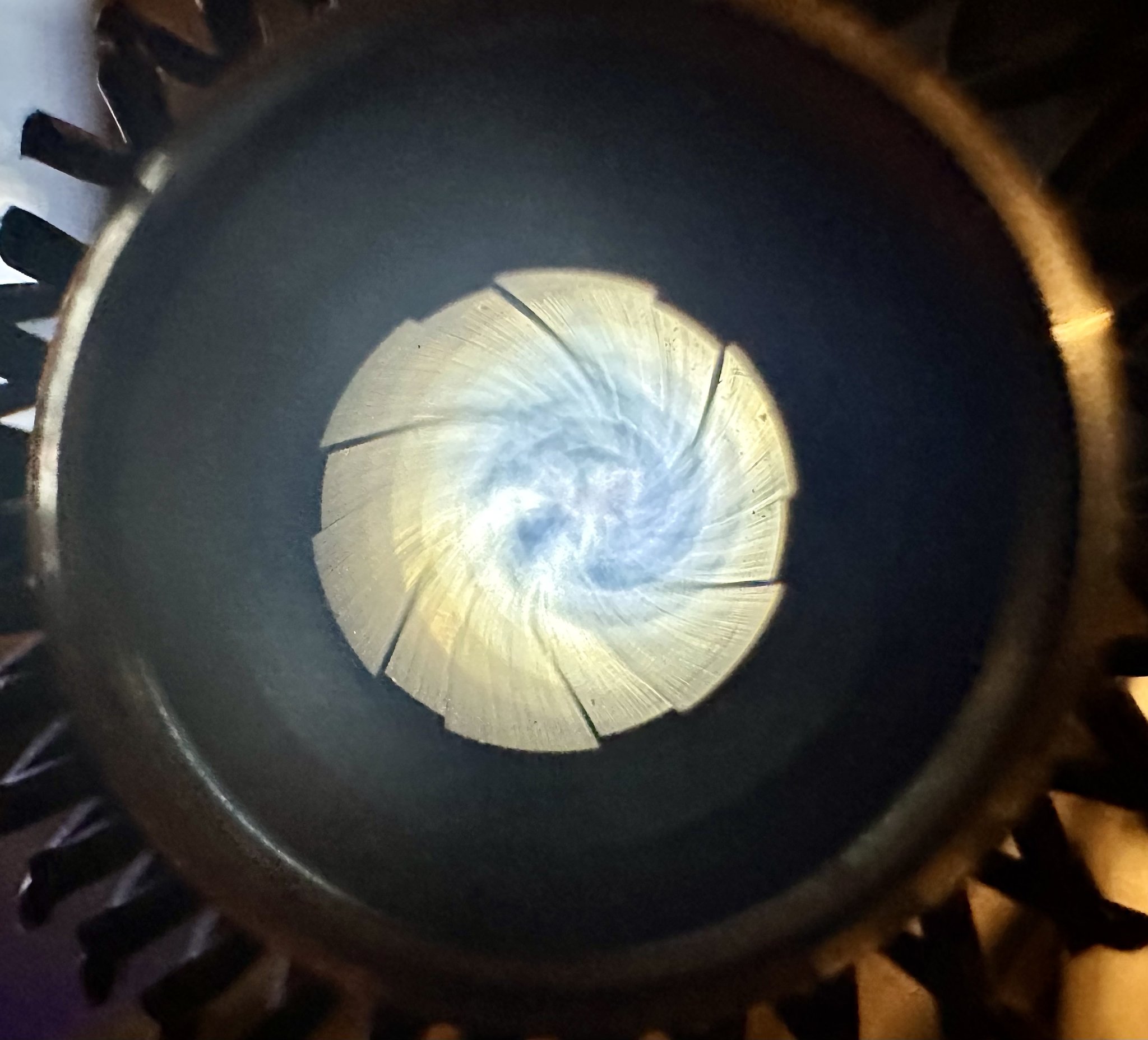

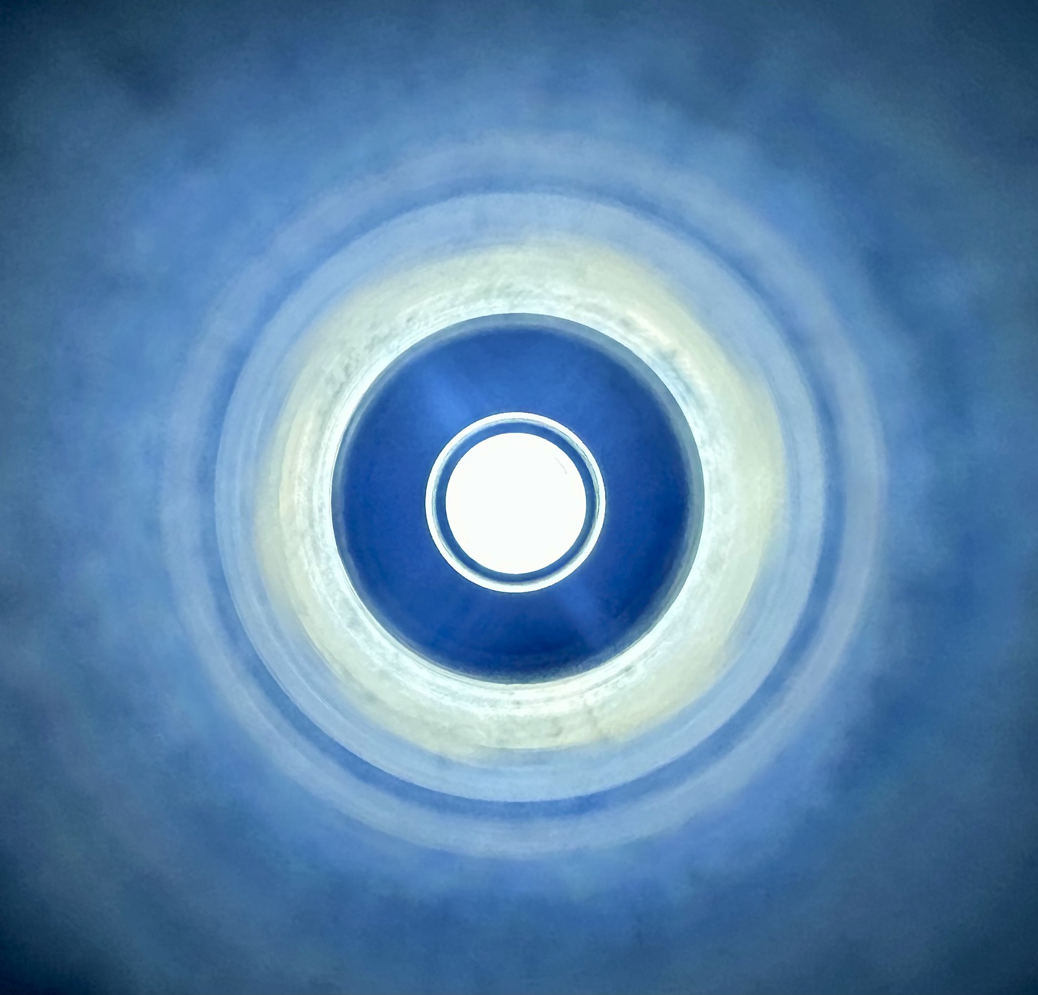

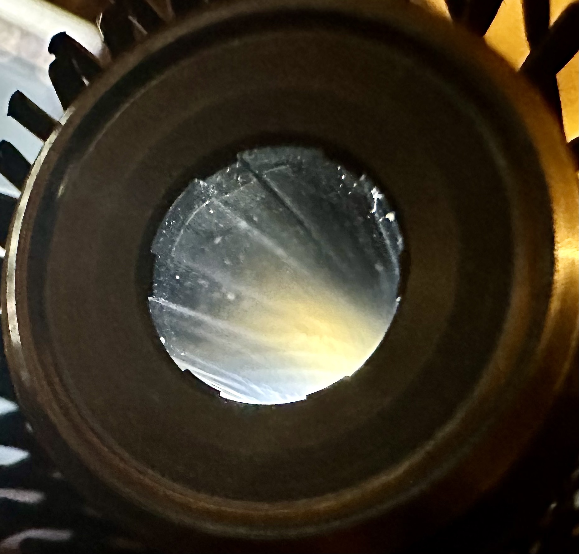

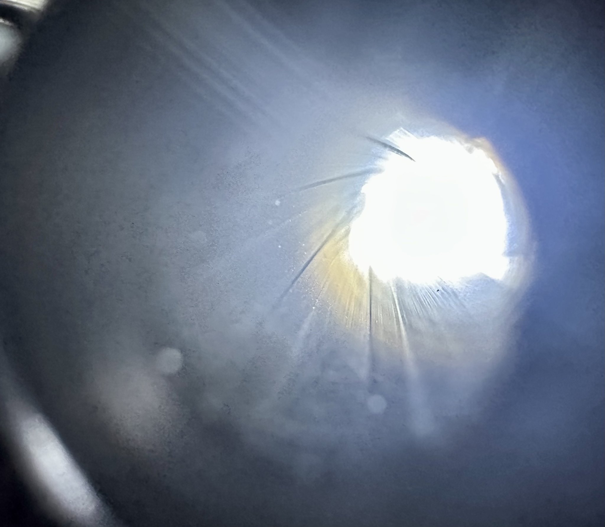

I don't have a borescope, but looked down it with an LED light, and that barrel is gorgeous! Clean, unfired, no tooling residue, no metal chips or chunks, absolutely flawless. The chamber is beautiful, too.

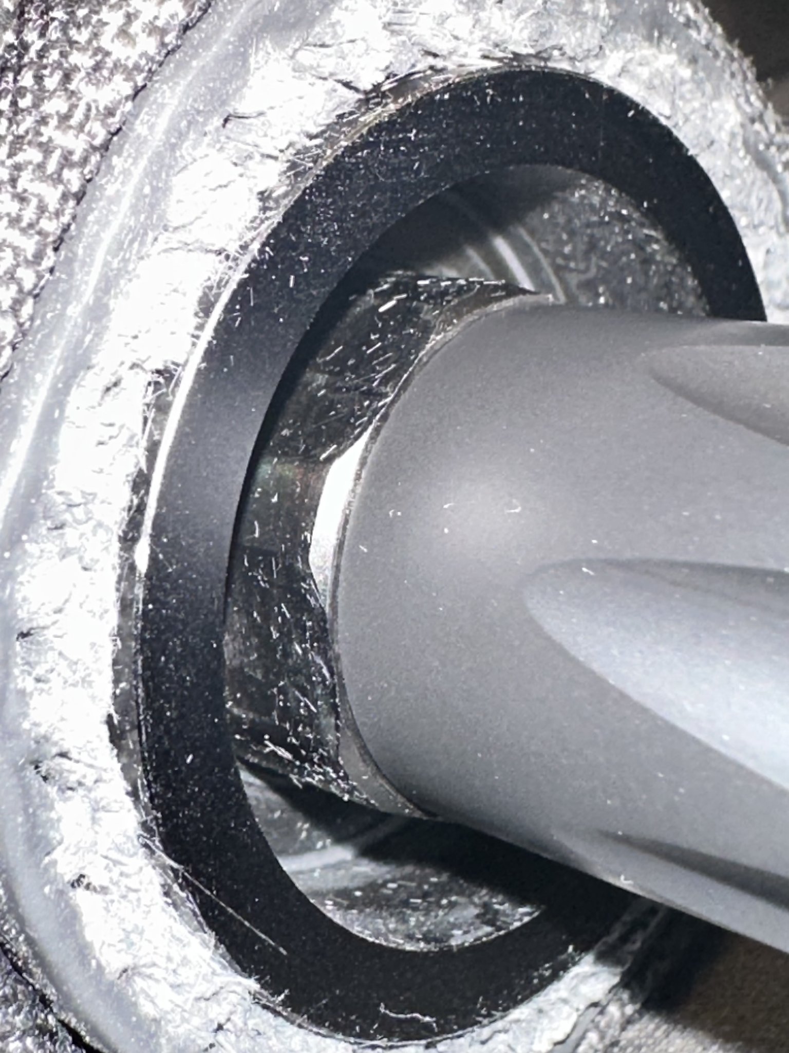

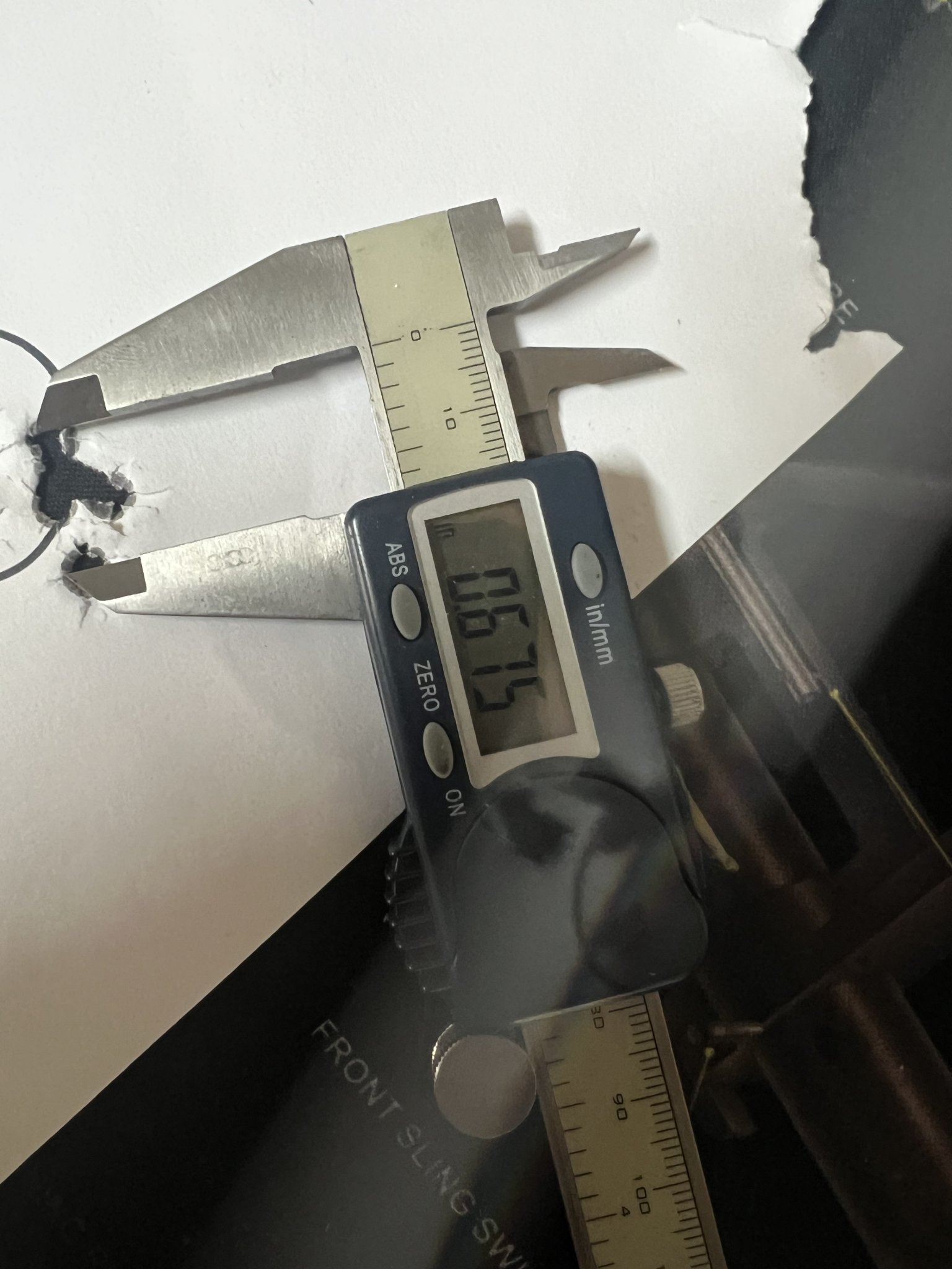

Interesting side-note... I wanted to see how concentric their chambers are cut... So I used my same Hornady OAL tool, same caliper, and the same Alpha modified 6.5CM case gauge, and same Nosler 140 RDF bullet as I measured my other "Aero" brand 22" sendero 6.5CM barrel. Out of 10 different gauging runs, the chambers are within 0.001". This chamber is 1/1000" longer than my other barrel, so that means I can share loads and brass between them. My once-fired neck-sized brass will also fit in the chamber without issue. Crazy stuff! But that's good to know that I can share brass, loads and dies between 2 barrels and should be getting remotely similar results with the same components, provided both barrels are good.
I couldn't get any inside shots worth a damn, but here's a few of the chamber and muzzle end. The rifling is VERY precise and clean and consistent from what I can tell by eye with a bright LED light. The chamber is also nice and shiny, and the throat is VERY concentric. There is a tiny bit of dust particles making the barrel look dirty, but it's spotless. A simple wet patching and then a dry patch will solve that.

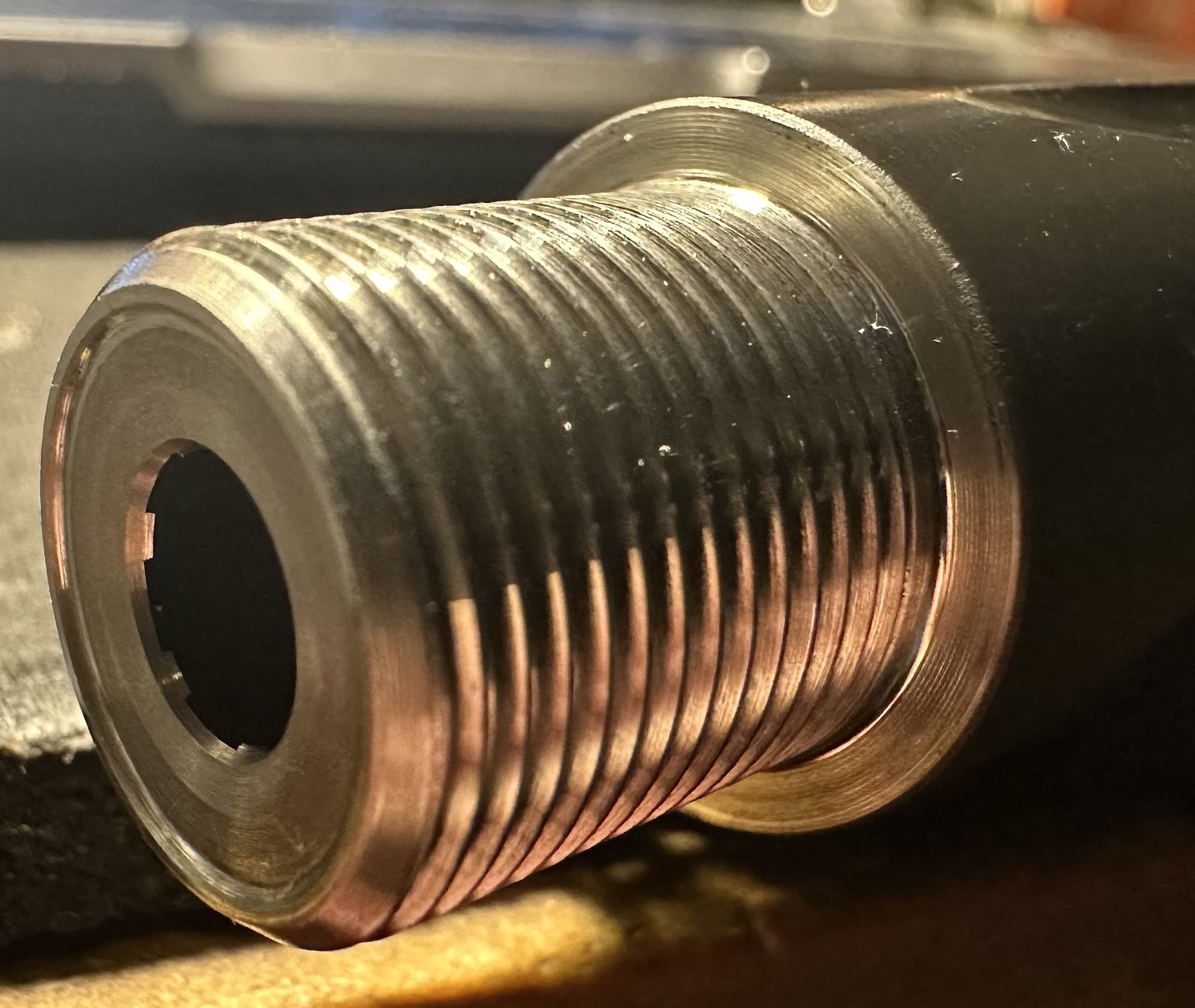

I measured with my calipers and it's 0.800" on the nose at the edge of the shoulder where the threads start, so it's really close to a Bartlein #4 "Bull Sporter" countour (0.750" @ 26") barrel. It really looks to me like they took a #4 Bull Sporter blank, and then just chopped it down at 20" so it's still 0.800" at the muzzle. It's a very stiff contour with plenty of meat on the shoulder for your can/muzzle device to sit against. I don't foresee any real POI shift issues.
Weight is JUST under 3 lbs. for the 20" barrel, which is fairly light. It was actually 2 lbs. 15.65 oz on my kitchen scale.
Muzzle threads are straight as an arrow on this one, too. This is my OCL Hydrogen-S 6.5mm can, and it's dead-nuts center.

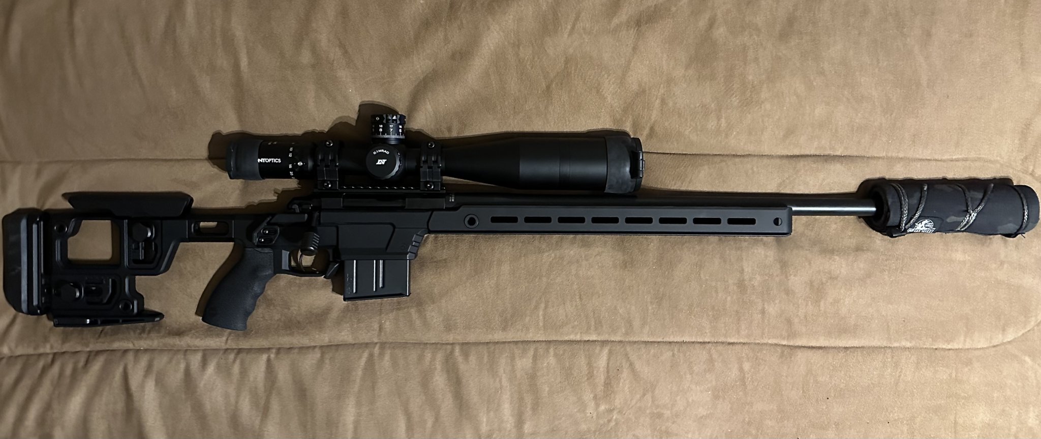

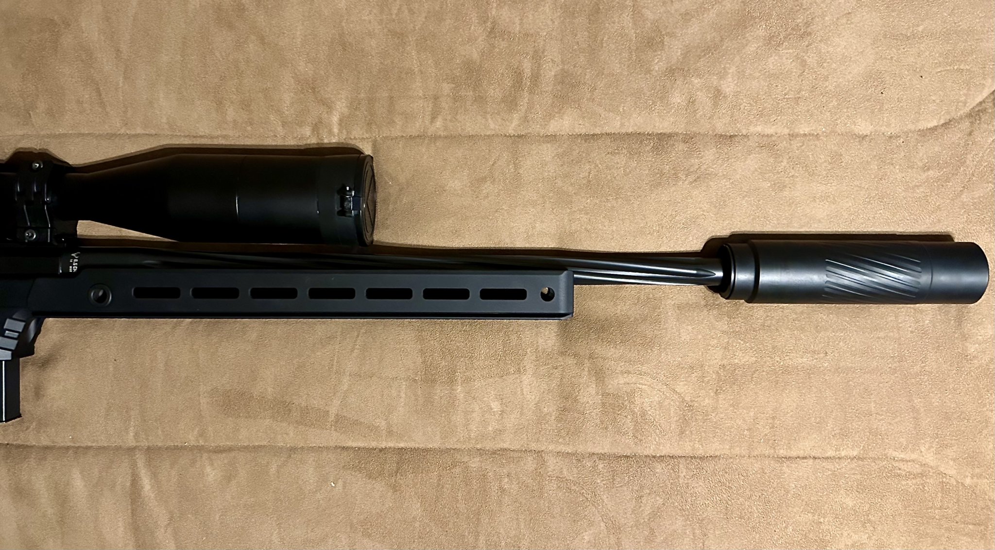

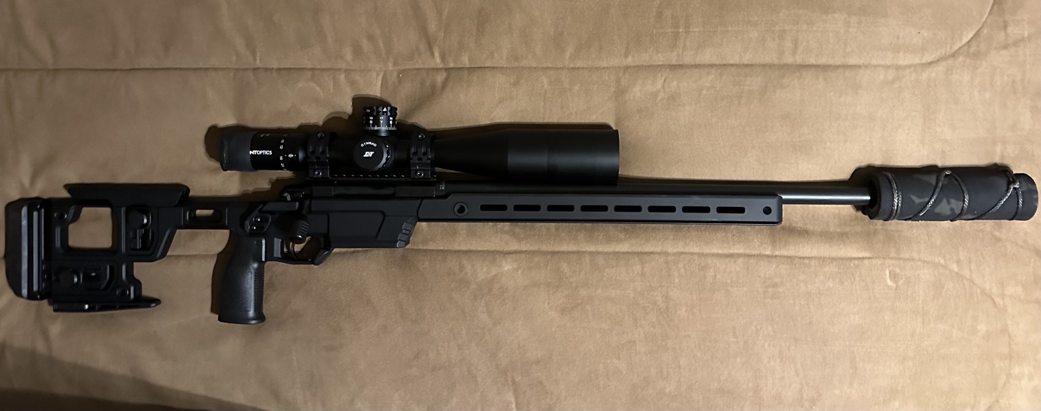

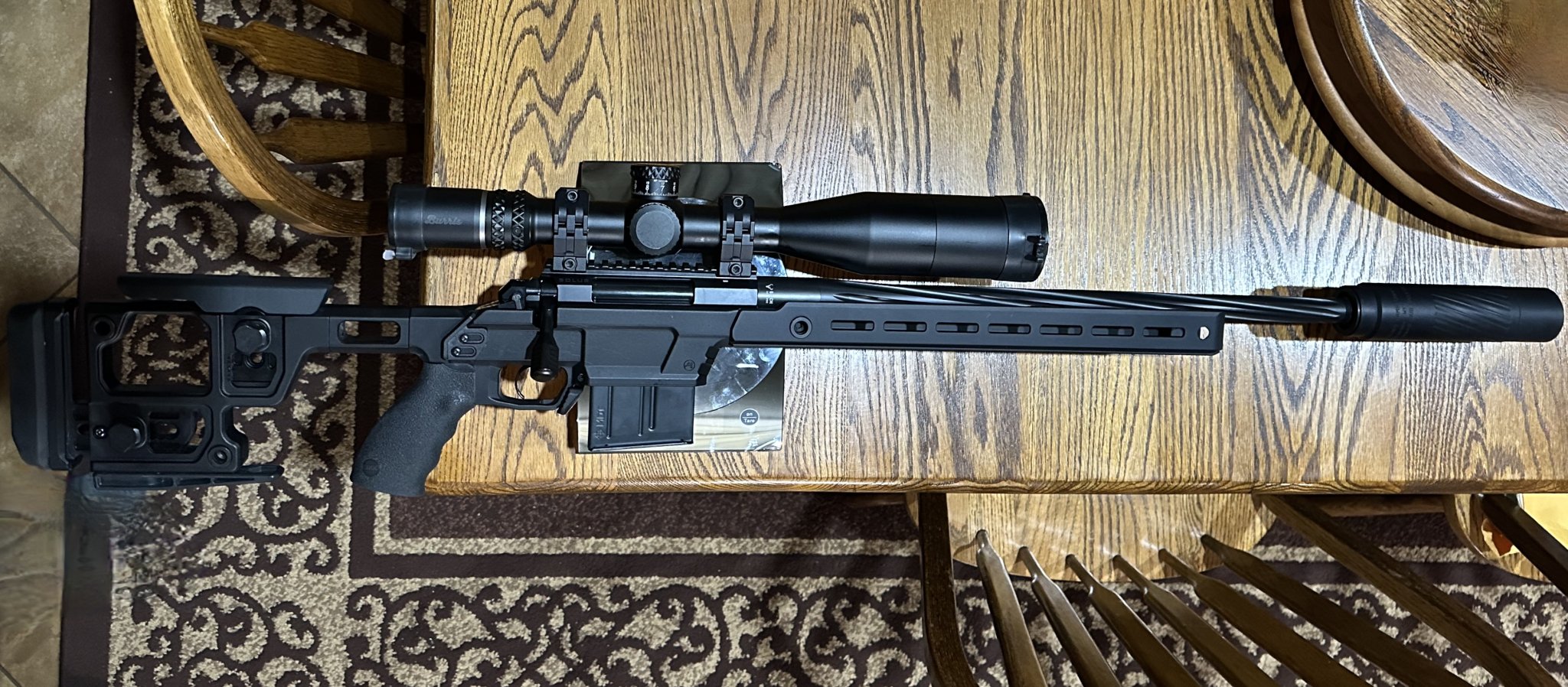

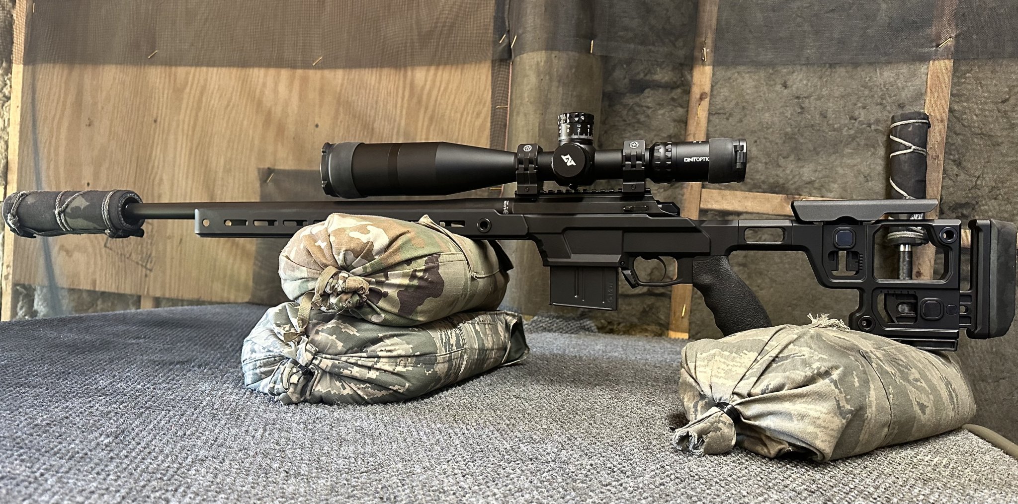

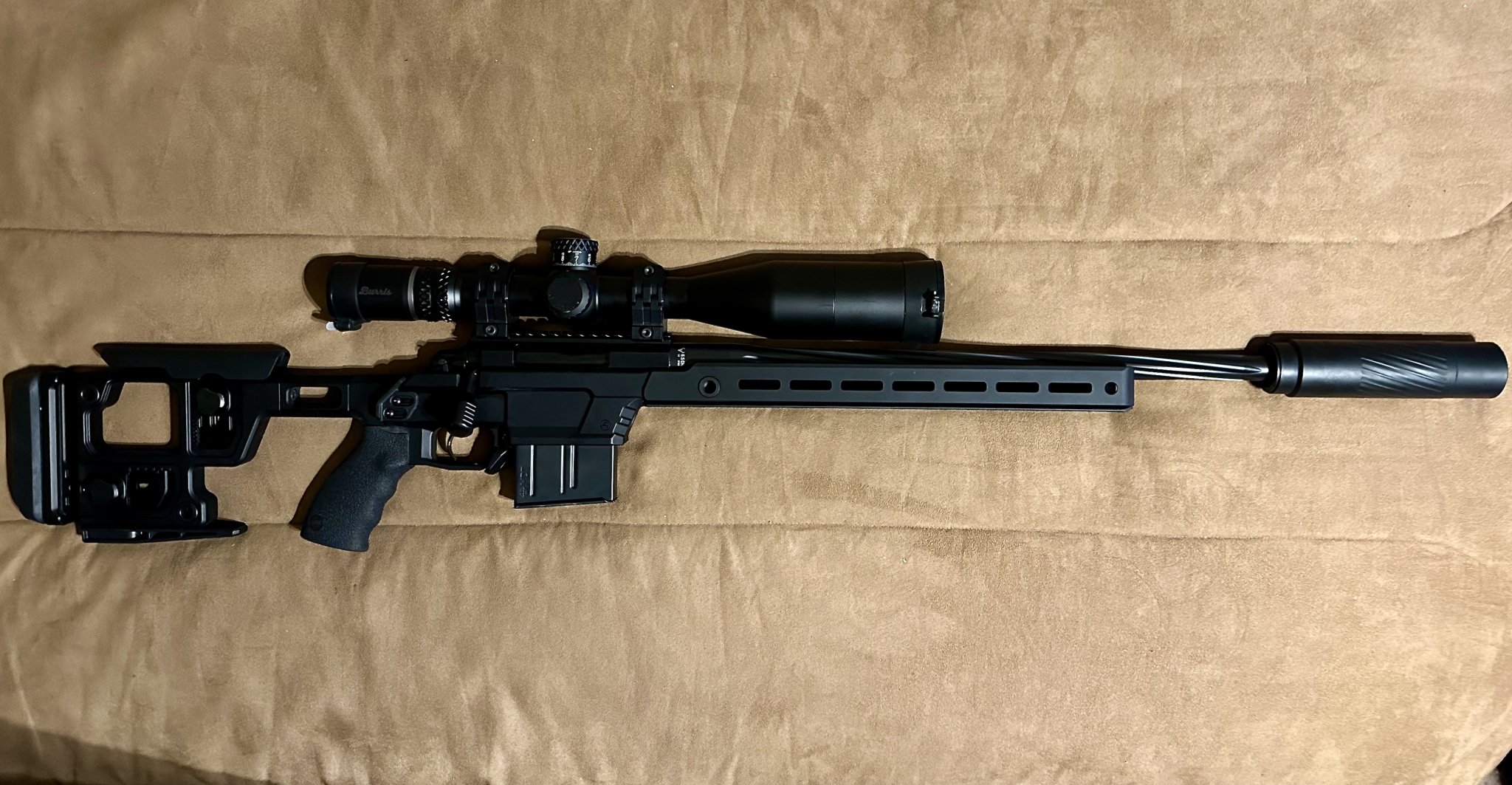

Alright... My taller rings and grip and MDT mag came in today... MUCH better!
It got the scope up high enough to leave plenty of clearance and use the new/old set of Arken 56mm flip-caps (which are actually really nice) from one of my old EP5's that I never used them on. They're working fine on the DNT. I figured since it was identical to an Arken, the caps should fit fine, and they fit really nicely. Very tight, too.

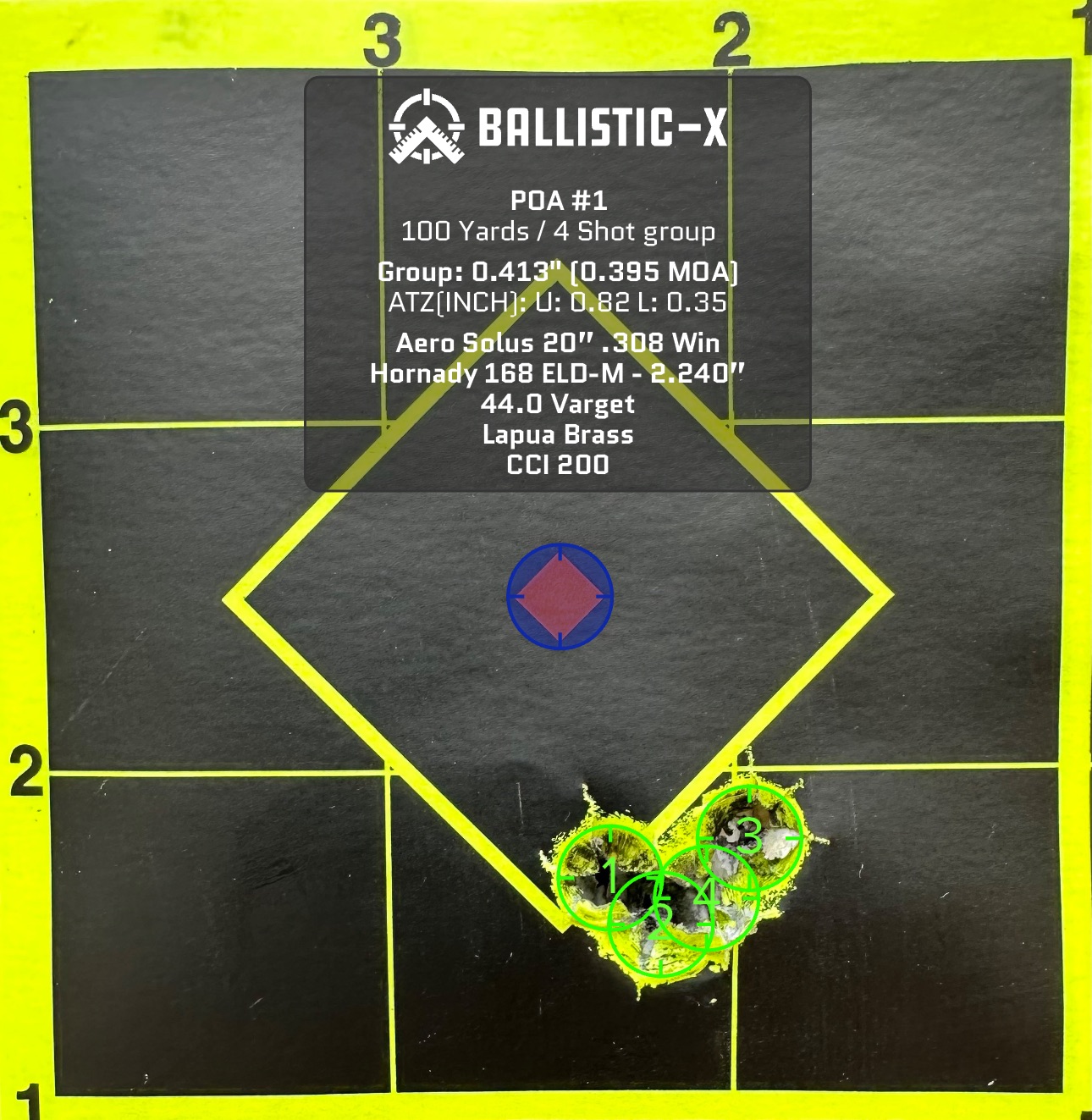

Didn't you change bullets and shrink groups?
Definitely a junk .5 MOA barrel.
Well... It seemed to like the Hornady 168 ELD-M's better... Plus, I'm only jumping them 0.010" from the lands, and they're still well inside of mag length, and cycle perfectly.
Here's the best group of the day (it's only 4 shots, because it was the starting load, and I shot the first round to confirm my POI on another target)...
Yeah, and if you had paid any type of attention instead of attempting to discredit me or be right, you would know that I said it was still hit-or-miss with that load, too, which is why I snatched the barrel. That last time I shot that load it wouldn't even hold 1 MOA, and was missing the 4" 300 yard gongs nearly every shot, whereas, prior to, it was pinwheeling it with the same load, from the same batch, loaded at the same time. So, yeah, it's a shit barrel. Very unstable and inconsistent from day to day.

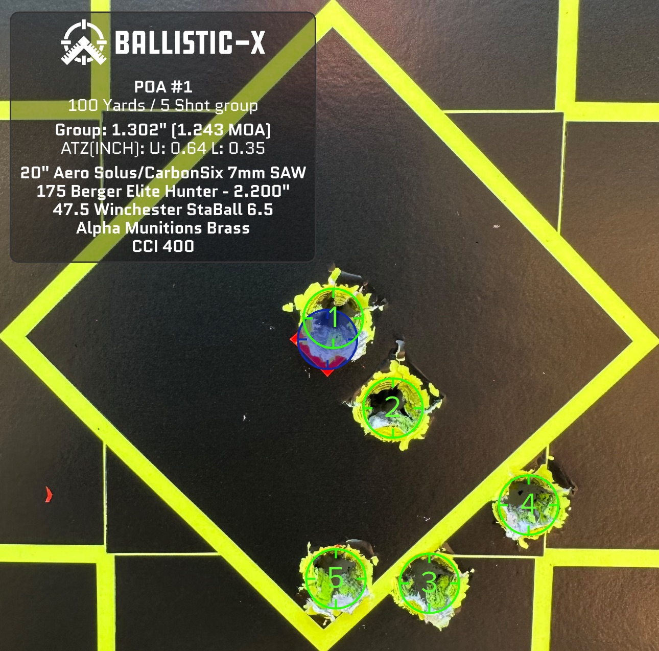

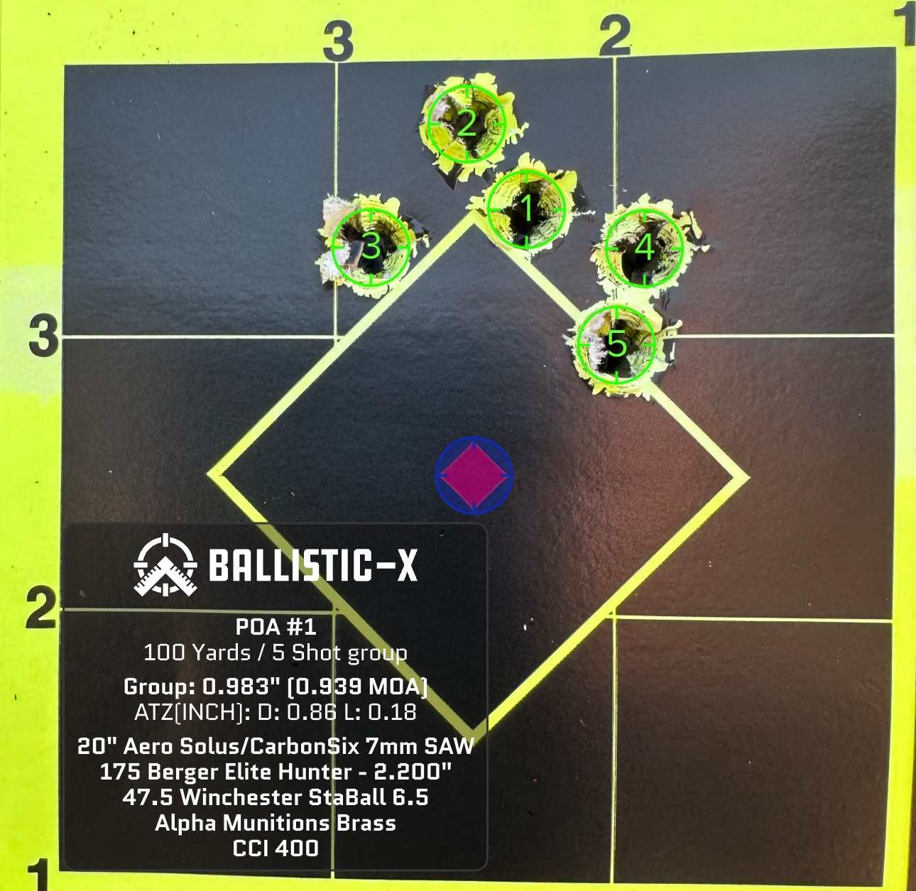

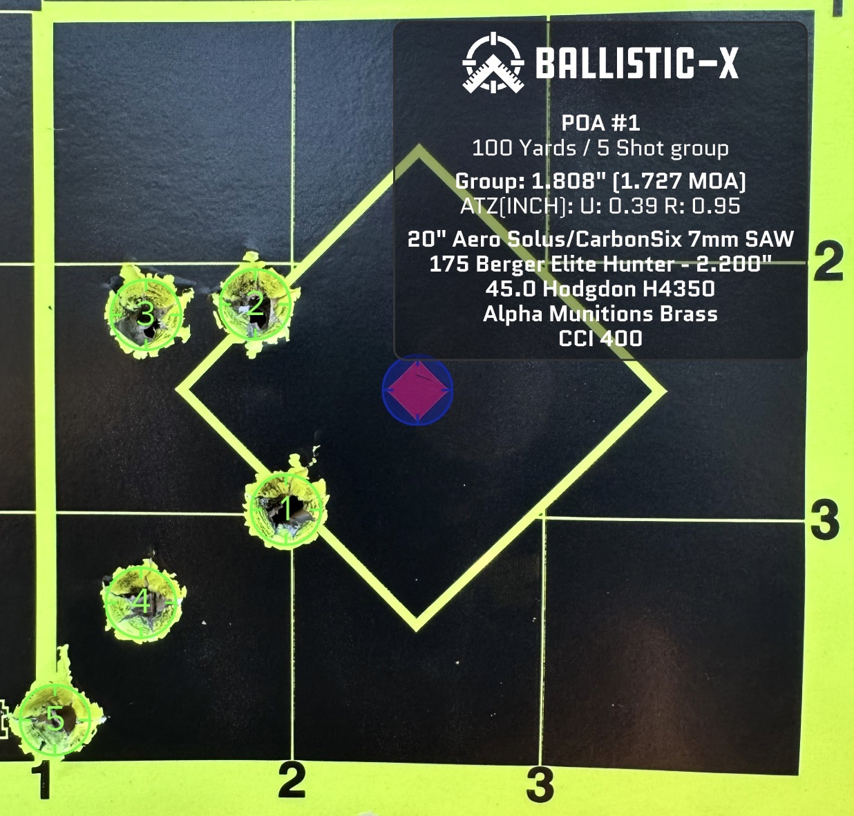

Did a little more load development today on the factory 6.5CM, and the @CarbonSix 7 SAW... The 6.5CM continued to impress, while the @CarbonSix 7 SAW continued to disappoint...Profusely... I'm going to try one more set of load development tomorrow (holiday) and see if I can get it to shoot any better with H4350 again, but I'm damn-sure not holding my breath... 🙄
Factory Solus 6.5 CM...
IMG_2896.jpegimage_cropper_E63E8D2E-E491-48B7-95AE-32A770A9E241-9319-00000841E4E46FEA.jpegimage_cropper_A6CED177-0686-49D6-A413-D0666AE7A4B7-9319-00000842E8D9FB06.jpegimage_cropper_CEF2CC21-7313-4FFF-9DAD-07ABFE8F7722-9319-000008442B708E88.jpegimage_cropper_A41811B1-BC45-4AA4-AC25-75897FFB39EA-9319-00000845227E743B.jpegimage_cropper_1161E4DE-0874-4CE5-8B0C-1DFF4BB95D26-9319-0000084607102E13.jpeg
@CarbonSix barreled 7 SAW... 👎🏼
IMG_2902.jpegimage_cropper_CBAA1556-DD02-4301-886A-73003063E95A-9319-000008477065F98D.jpegimage_cropper_D3FC9CEC-4532-4E3C-9A97-65EE9B01AFCA-9319-000008480AC5E2D0.jpegimage_cropper_A55EA601-26BA-4E11-932A-27765DC2F42A-9319-0000084901BB461B.jpegimage_cropper_1157B410-98FE-411C-B605-0D50EEC4B6DE-9319-00000849C9F5D748.jpegimage_cropper_D2A82EDF-0C49-4DF1-9AF3-F762A15CB126-9319-0000084A840C167C.jpeg

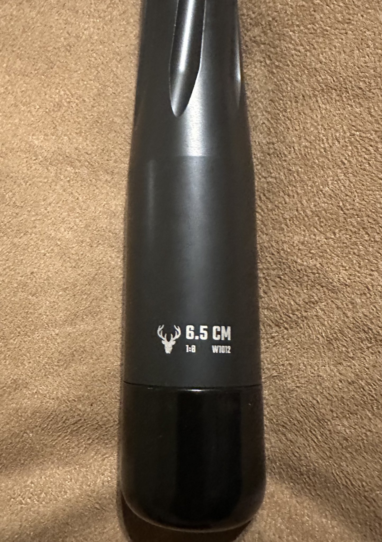

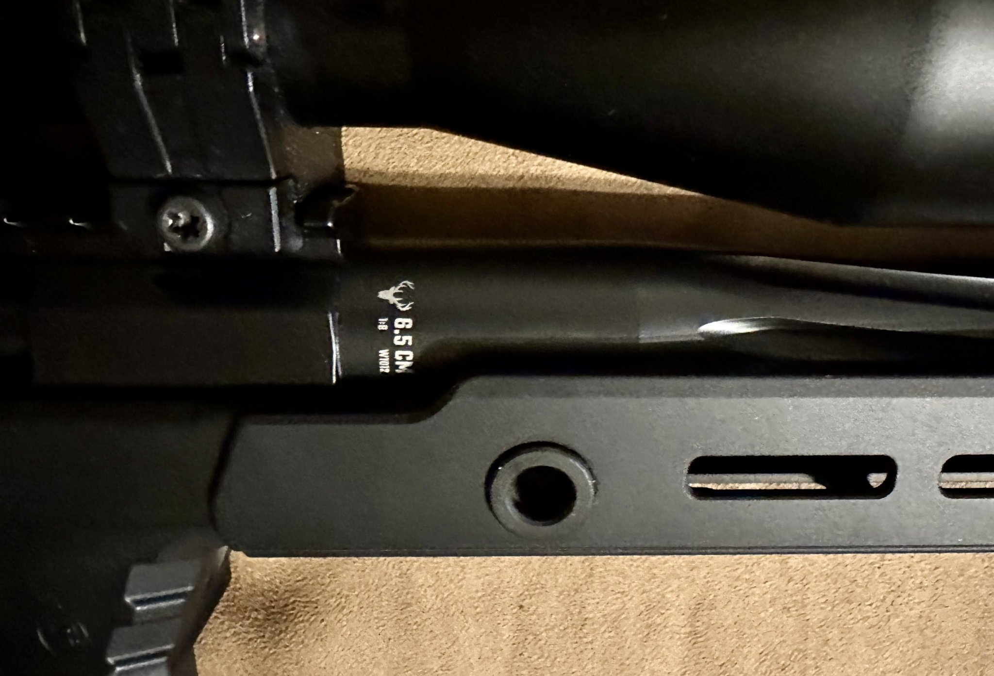

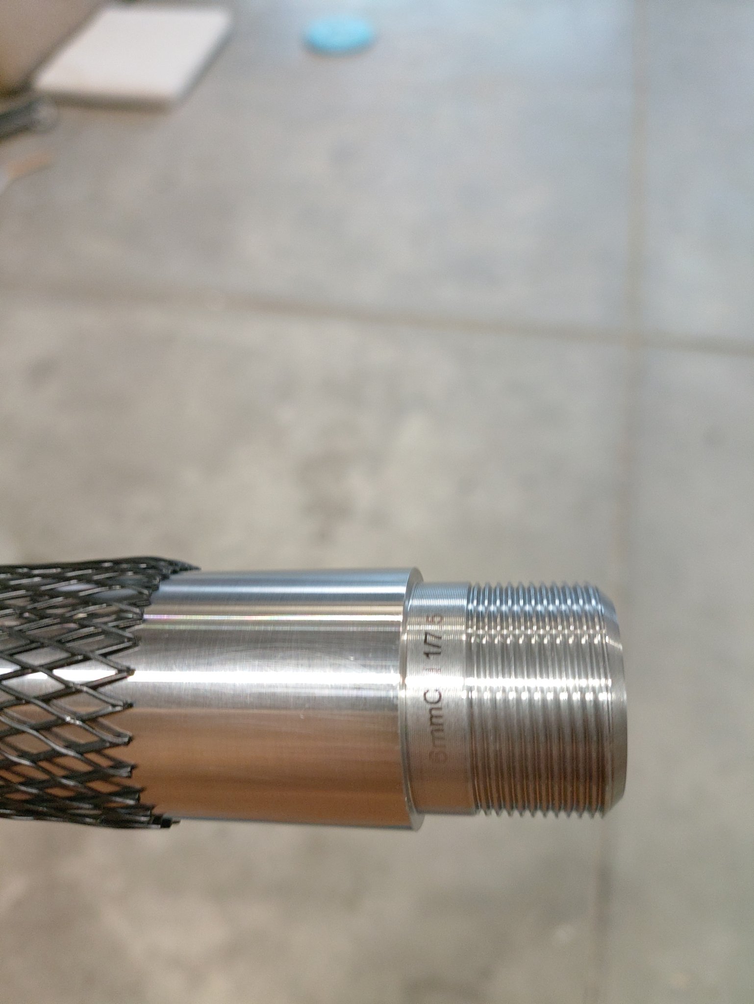

Got my 6mm creed overstock barrel today. Only marking on it wont be visible when screwed on the action. I'll probably bead blast and spray paint it anyways.

Being that it's raw stainless, you could always have someone with a laser mark your 90ª points on the sides when screwed into the action, and then laser engrave the cartridge and twist where you can read it when installed. Then have it cerakoted later if it shoots good. Or, vise-versa... Have it cerakoted if it shoots good, then have it lasered so you can read it cleanly.
Reactions: dk17hmr
Good points. My buddy has laser could definitely do that. Or I have 1000 58gr VMAX bullets on the shelf I could load them up just slower than the velocity they explode at and just let the kids merk pdogs until there's no rifling left.

I received my SS 6mm as well, looks good. Bore looks great through the borescope. I don't know that I'll shoot it yet as I'm going to get it cut to 21" and my nitrided 6.5 cut to probably 16-17".

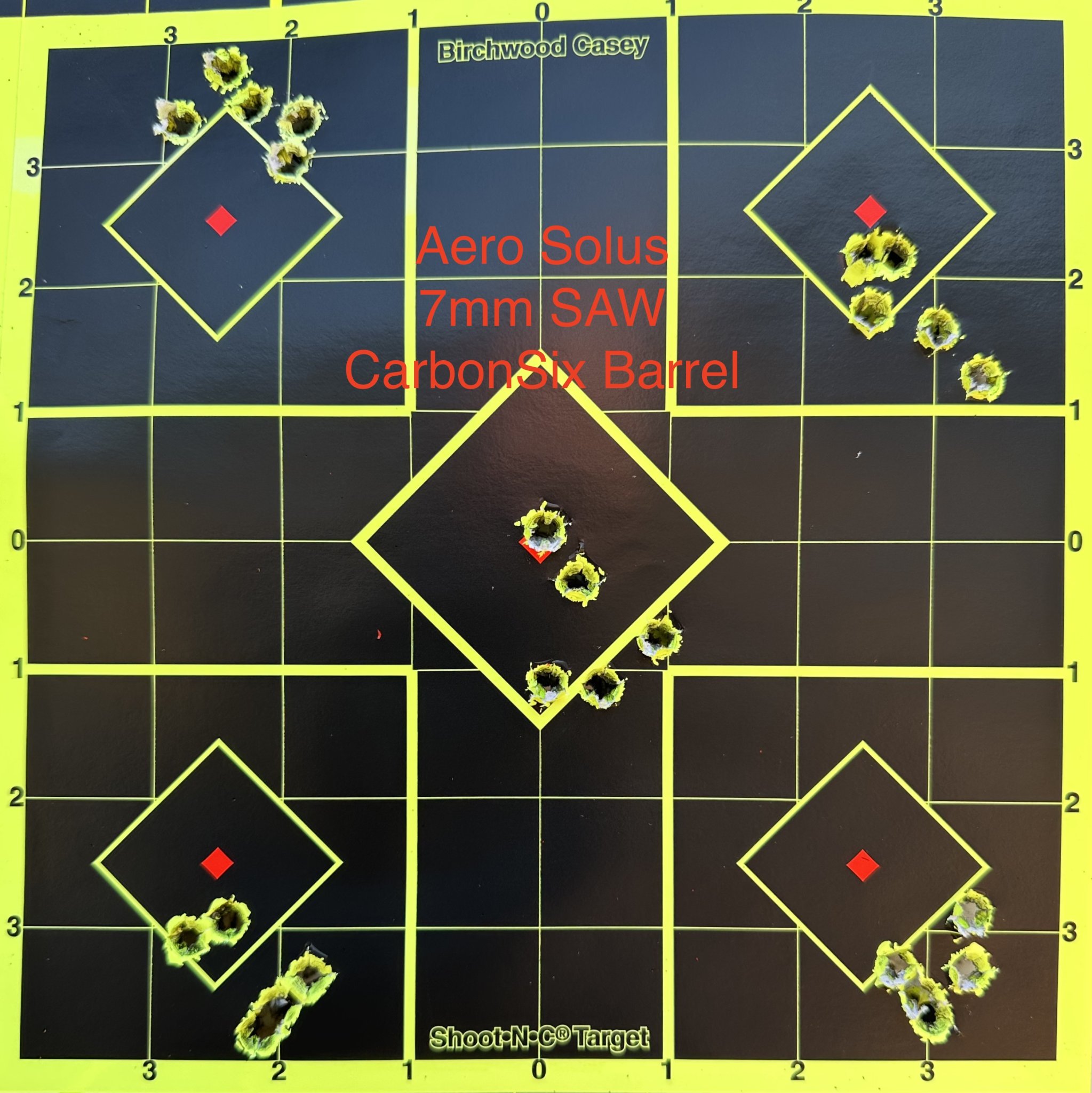

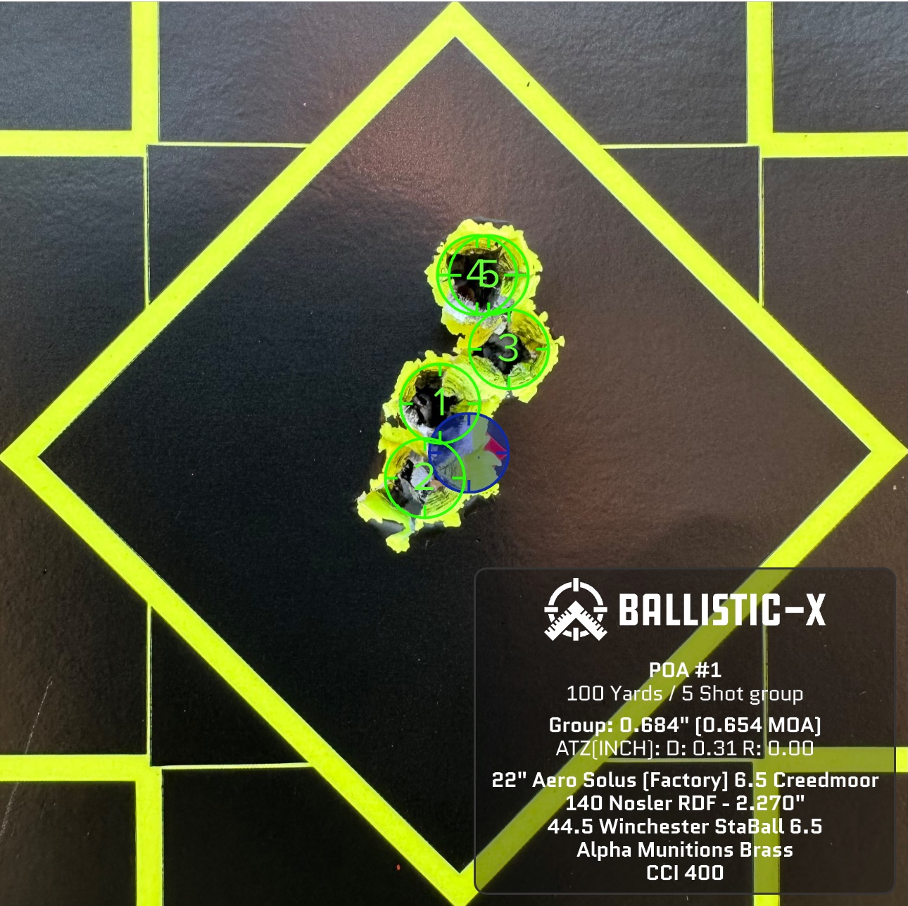

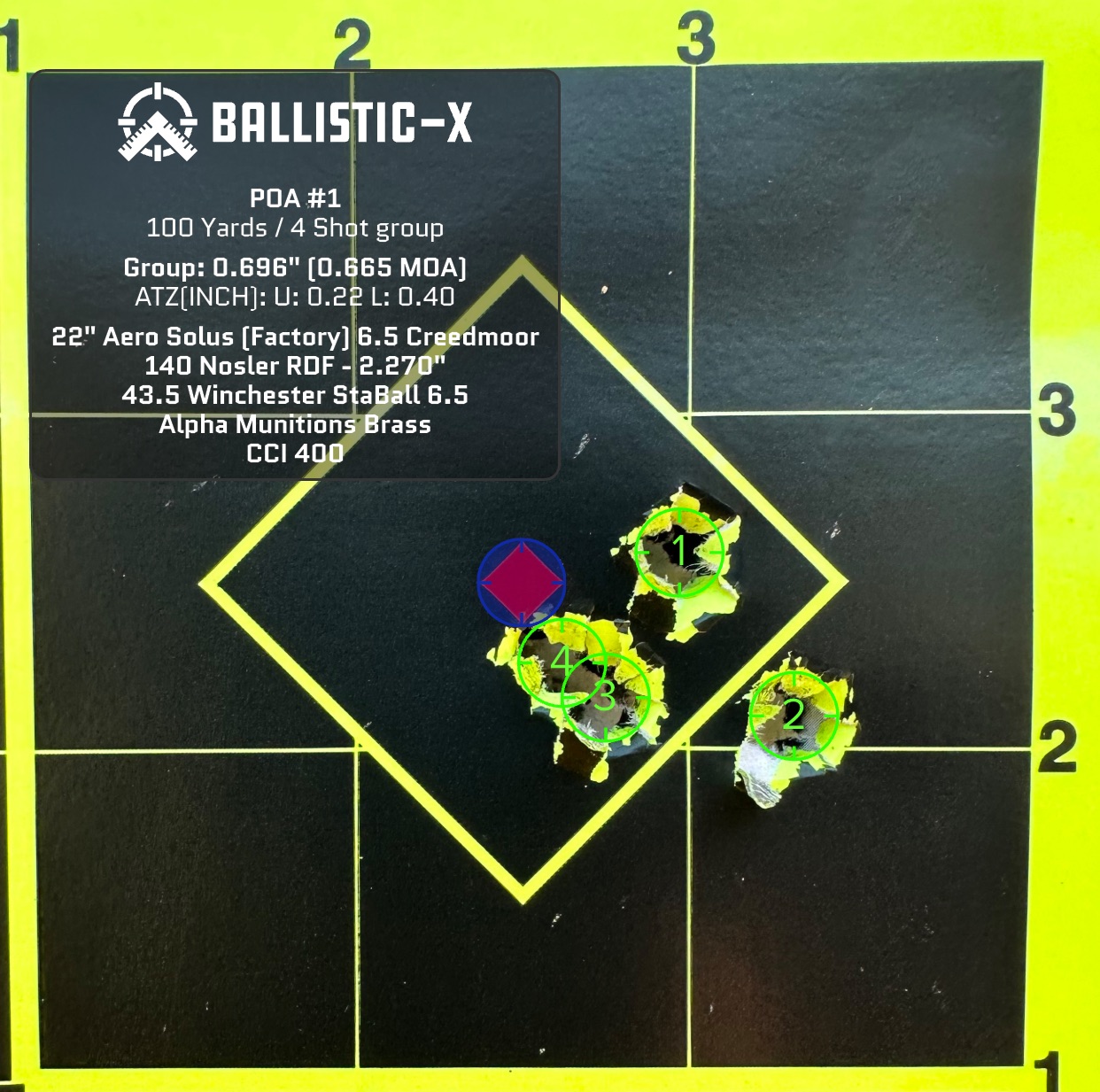

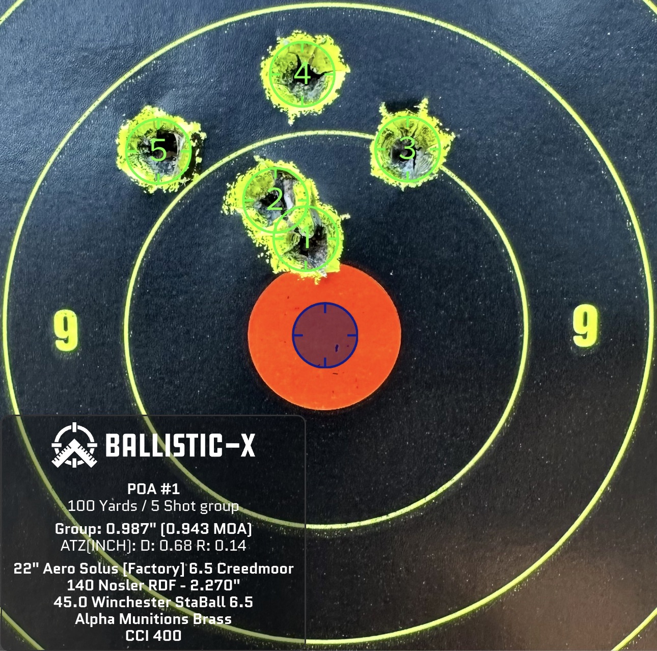

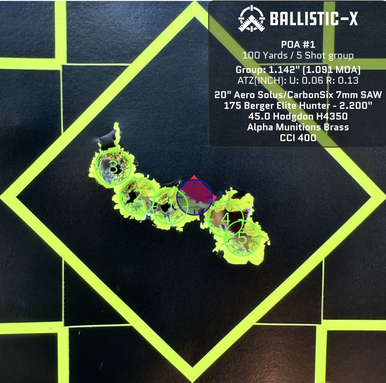

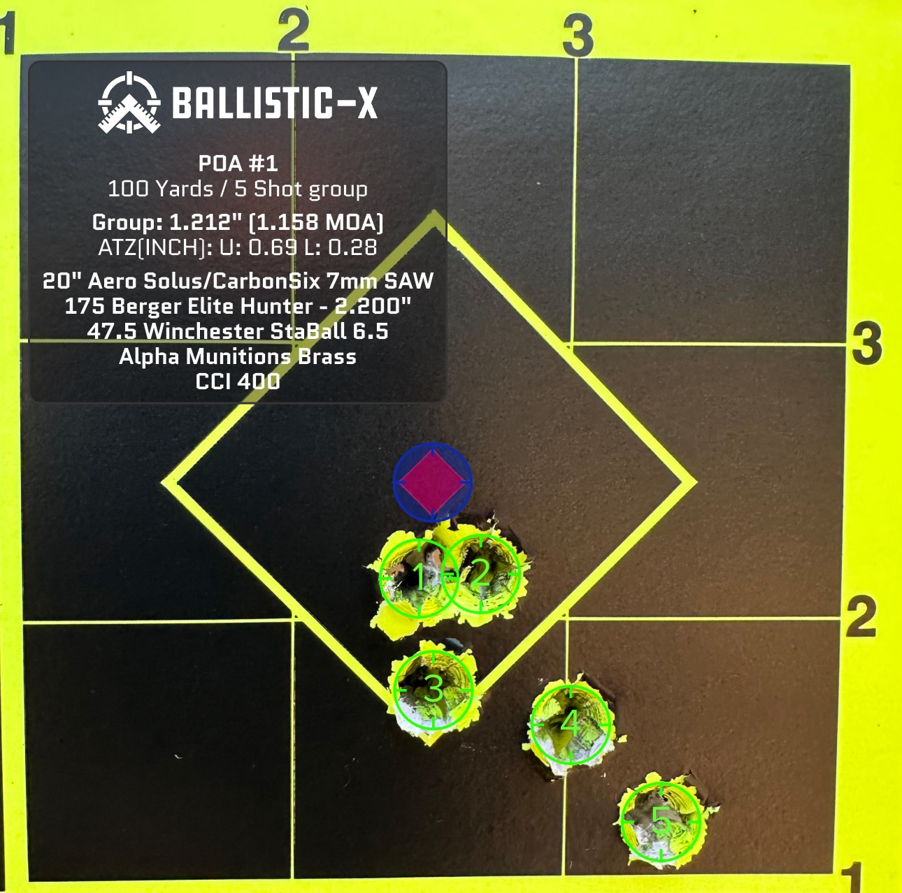

After last weeks shitty grouping continuation with the @CarbonSix 7 SAW, I decided to check concentricity, and the barrel threads are not concentric to the bore. All of my 9" cans leaned far enough with the alignment rod, that at the very end nearly had strikes. So, I decided, to try my 7" cans, and it was much better, but still cockeyed... But it was much more centered in the suppressor bore, than the longer 9" cans were, so I figured it would be less of a chance of causing any interference with the groups.
So, I decided to try my Magnus-S on the end to see if that would help... It actually, did, but still not enough for me to be remotely near happy with this barrel. I will be calling Gene tomorrow about a refund or possible replacement... A $1000+ barrel shouldn't be shooting more than 1/2-MOA at most with handloads.
So, here's today's groups... They were ALL shot with 45.0 grains of H4350, Berger 175 Elites, CCI 400's, 1x Fired/FL Sized Alpha brass, same everything...
IMG_3228.jpegimage_cropper_F1EF4A78-D184-4478-927C-CF0F59714CA7-594-000000A8F7CFECDC.jpegimage_cropper_360E18A7-702E-444A-8168-77FDC35C3105-594-000000A9F20C9609.jpegimage_cropper_4FC54932-2C92-496C-8326-0B9ECA8FCFE5-594-000000AAB8426140.jpegimage_cropper_57400FC5-6A54-4F2B-BC16-246A1DA31F2A-594-000000AB89CB8F96.jpegimage_cropper_37B89FC7-6F86-4E6A-82BA-865279F9A74B-594-000000AC47C9F4D2.jpeg

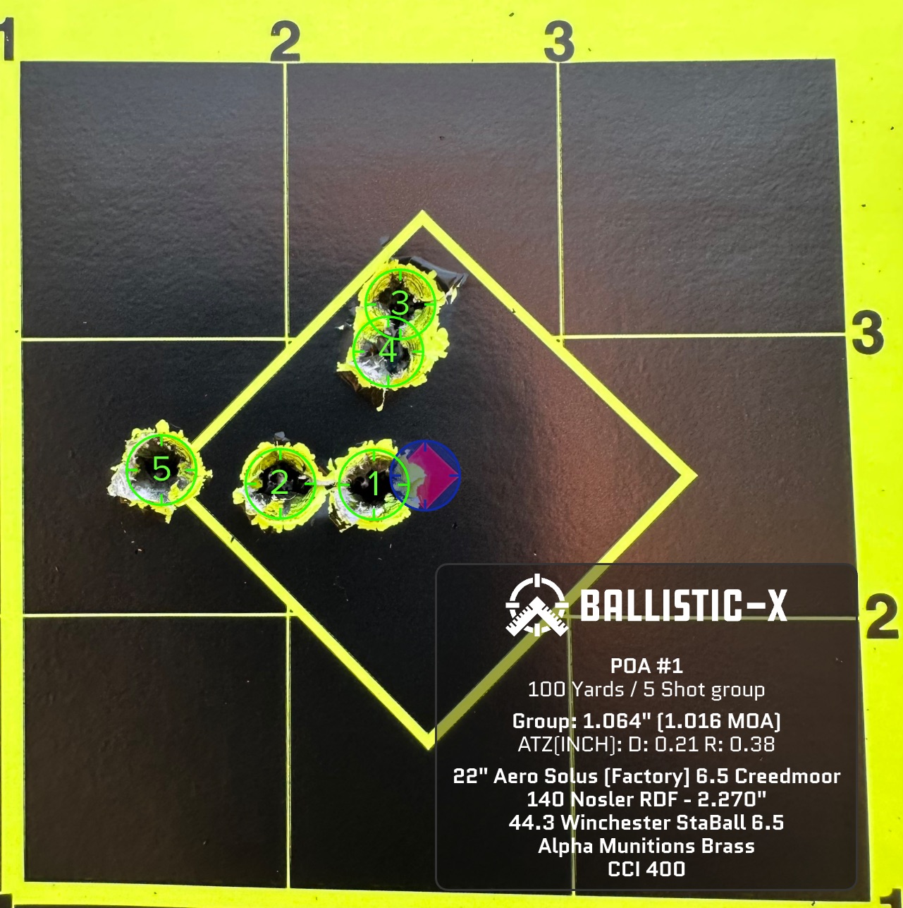

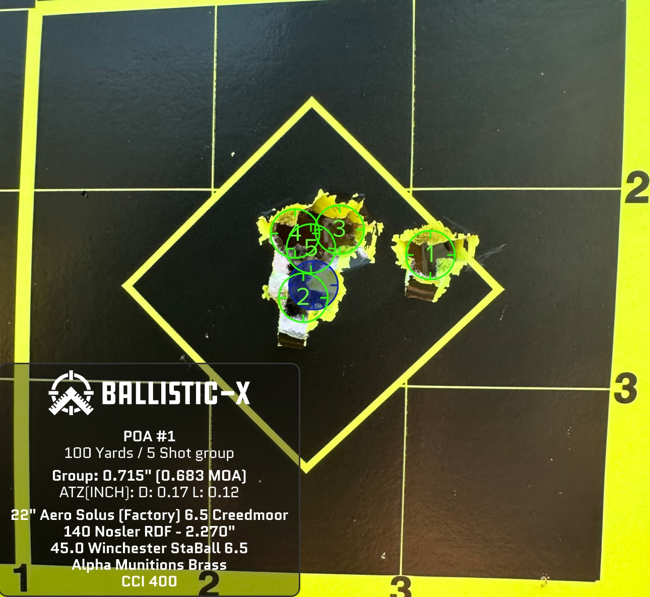

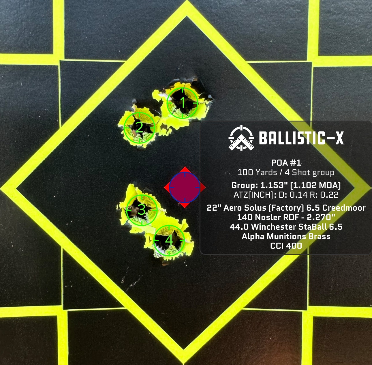

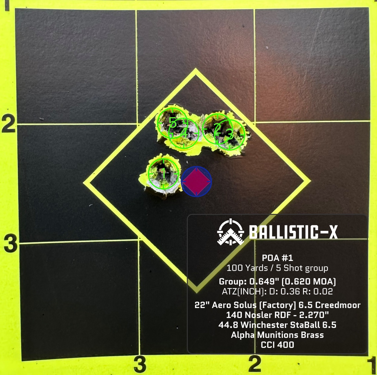

Shot 2 groups with the factory Solus 6.5CM, and the first group was kind of wild, but the 2nd was much better... If I had not had the random flier, it would have been 0.529", instead of 0.699". I hope it's still settling, as I still don't even have 100 rounds through it yet. Today was shots 51-70 using the best load that tested from my initial sets of load development. It may not be supreme, but it has zero issues pinwheeling the 3" gong @ 300 yards every time. I even had 2 other people shoot it that had never shot the rifle, never seen a DNT scope before, and never shot that cartridge at 300 yards, both nailed it on the 1st shot.

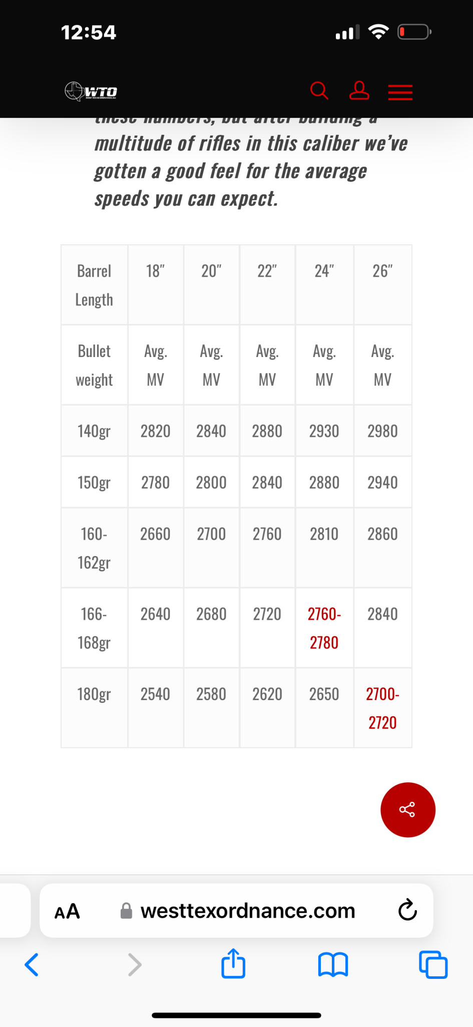

Just FYI incase anyone is wondering, this load is averaging 2,833 FPS from my 22" barrel.
IMG_3234.jpegimage_cropper_D87B8B4A-7CFA-4794-869D-03860807325F-1574-000000AE1F26270F.jpegimage_cropper_180B8841-7172-40FF-A17D-C4C0AC79BFC4-1574-000000AF0BA128A7.jpeg
Reactions: southernpew
View attachment 8529224View attachment 8529225View attachment 8529226

I have to say, it looks damn good on there! And even with the heavy Burris XTR-3 and the Aero chassis, this thing is actually lightweight enough to hunt with... I just weighed it with my Magnus-S on the end, and it's only 13 lbs. 11.30 oz ! I know that sounds heavy, but it's a hell of a lot lighter than it was when I had my M24 stainless steel .308 Win barrel on there. And it feels about as light as when my CarbonSix barrel was on there. When the new one comes back, I'll weigh it. If I stuck a much lighter scope on there, like my Vortex Viper HD 5-25x50, then I bet I could shave another 1.5-2 lbs. off it.
Well... After emailing Gene at CarbonSix, I asked him to contact me sometime after 2pm this afternoon (I had work meetings all morning, then a lunch meeting), so he called around 2:15, and after talking on the phone for about 45 minutes, and discussing all the things he was curious about, he said he wanted to get it back and examine it, so he sent me a label to overnight it back to them, which I pulled when I got home from work, and swapped on my new Aero contract overrun spiral-fluted 20" 6.5CM barrel just to have something to shoot in the meantime.
View attachment 8529880View attachment 8529881View attachment 8529882View attachment 8529914View attachment 8529913
Nice. I can’t wait to see how it performs. I have the same barrel on my bench. It will likely be a while before I play with it since I have a PVA 308 barrel on it now.
Reactions: FuhQ
I just ordered another box of Alpha 6.5CM SRP brass last night, so should have it by Friday. I don’t mix and match brass with barrels, unless I’ve completely burned the tube, and replaced it with another, then I FL size to get them back to SAAMI, then start neck-sizing again.
Also, I do have a really nice set of Manson Go/No-Go gauges that work for ALL the Creedmoor cases (which is genius on Dave’s part), and headspace was dead-on the new barrel, as well.
Reactions: KYAggie
