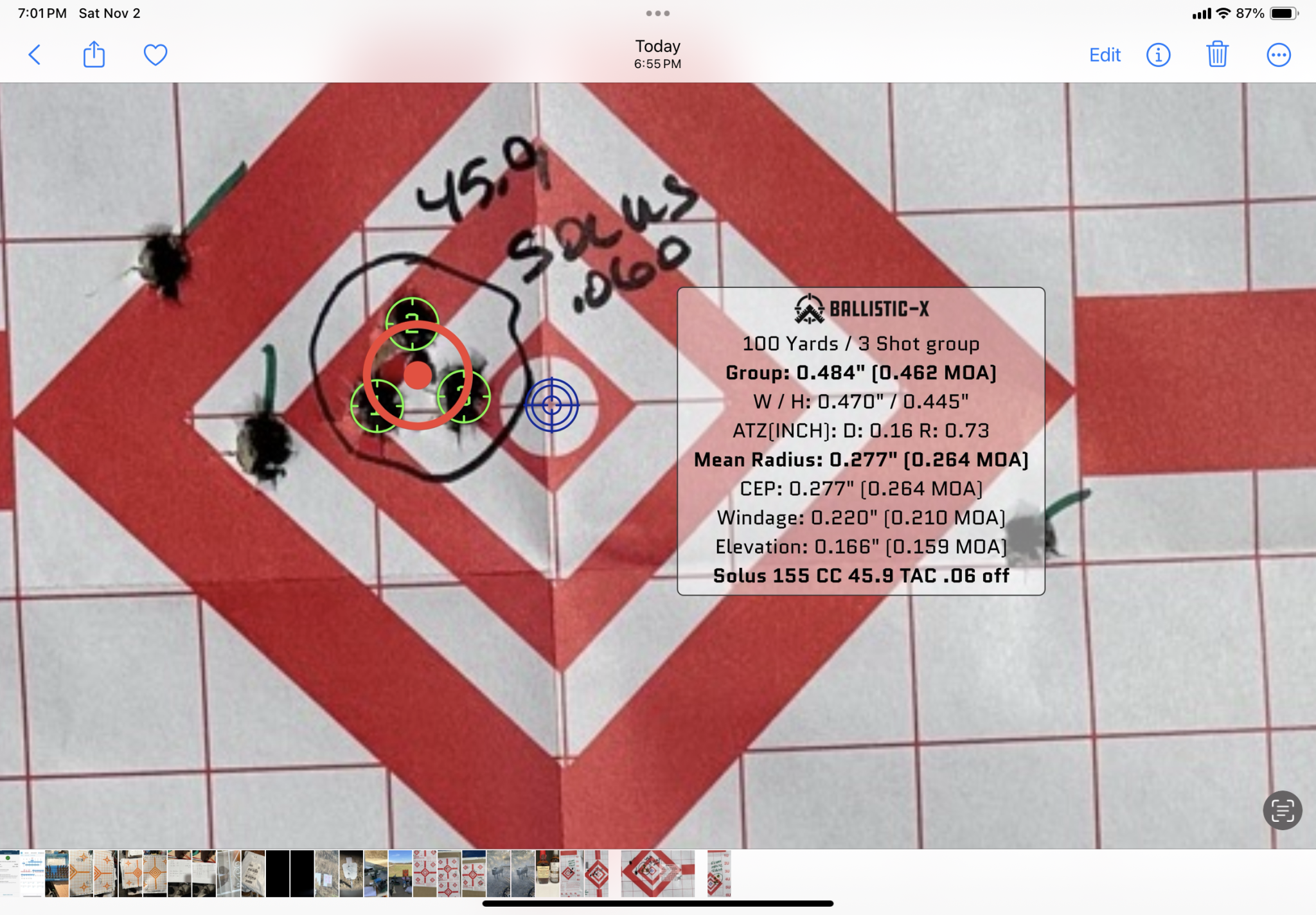

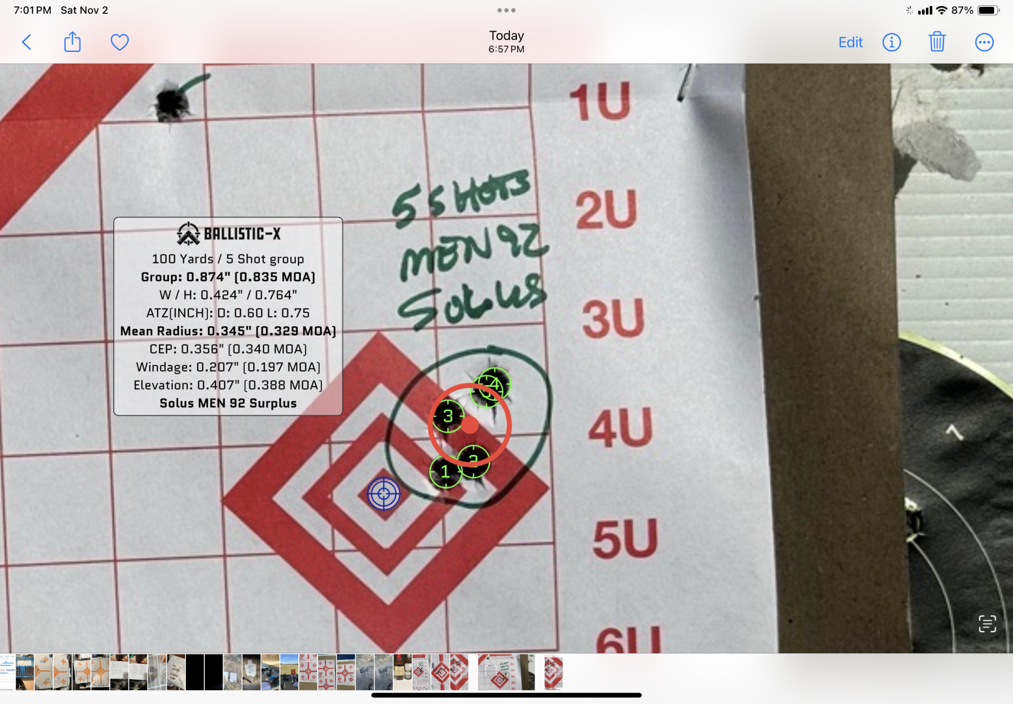

Took my 308 PVA barreled Solus out today. It seems to like a 155 Nosler CC with 45.9 TAC F210M seated .06 off. The suprise of the day was MEN 92 surplus. I’ve never gotten a group like that with surplus and it performed very well at 500 on steel. I also ditched the Mark IV 4.5-14 mix master for a Athlon Ares ETR 3-18.

I'm glad your .308 Win shoots good. It seems most of them either won't consistently produce equal results (like my .308 Win barrel), or just won't shoot good at all. Seems very few of the .308 Win barreled rifles are consistent shooters. I hope Aero/BA gets that issue figured out. I'm guessing they have, which is why all the .308 Win and .300 BLK Solus rifles are on backorder. I was told the .300BLK pistols had a barrel issue with the first batch, so they sent them all back, and are waiting on new ones, which is what is causing the huge delay (ordered it in July).

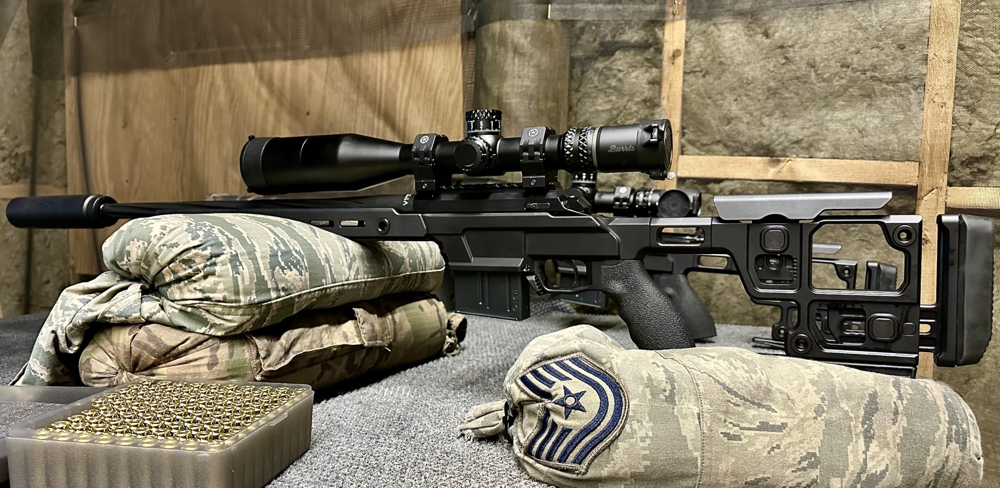

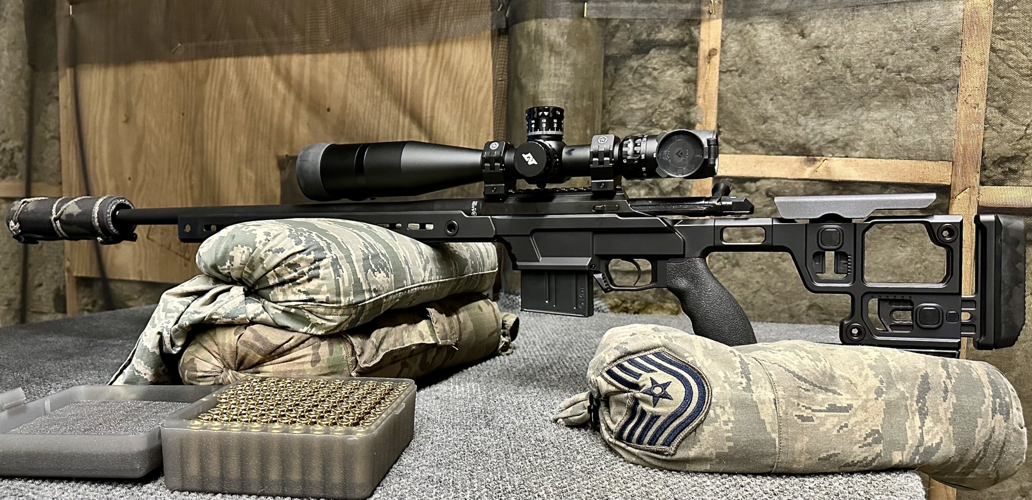

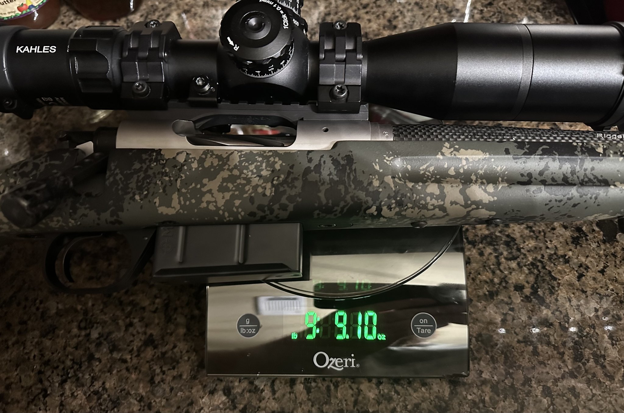

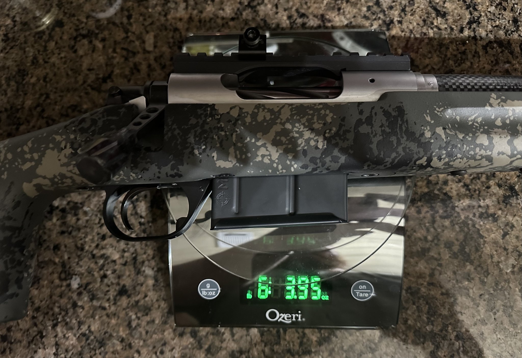

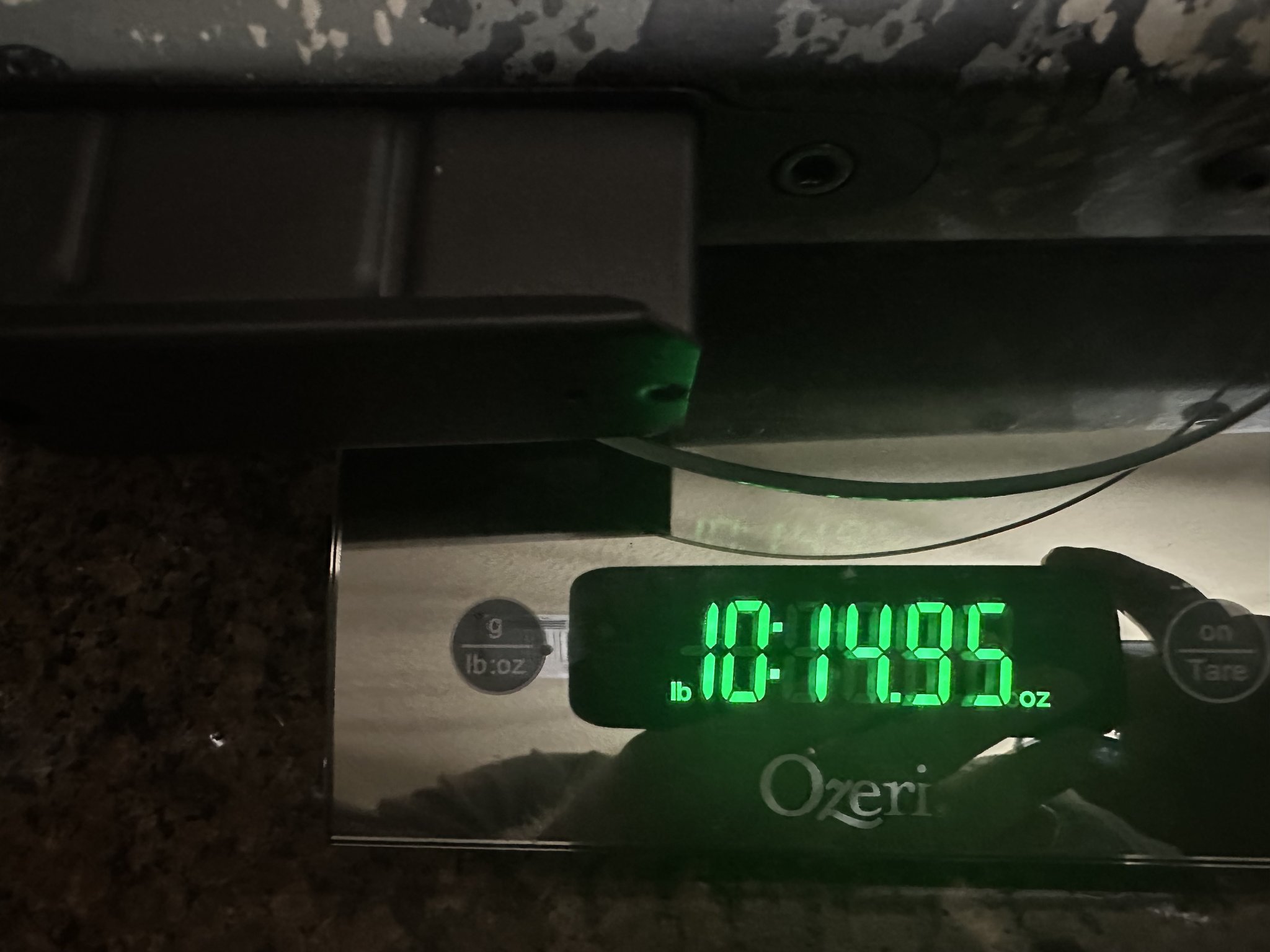

Forgot I did this last night, and took my hunting rig, which is a 20" @christensenarms Ridgeline FFT in 7mm-08 Rem, with a Kahles K318i on top, and stuck it in the new McMillan Game Warden Edge stock I ordered for it, and weighed it with the TBAC Magnus-S can on it, so basically in full hunting configuration, minus ammo... Also, I bought a Hawkins M5 AICS bottom metal for it. Really nice unit, and will be a great hunting setup. I'm very happy with the outcome of the reconfiguration. In person, while handling it, it feels like it weights a whole lot less than 10 lbs. but the scale doesn't lie... It's very quick and nimble in the hands.
I also removed the scope, and can, and stuck them on my Solus with the new spiral-fluted Sendero Lite 6.5CM barrel (416r) from the contract overrun, and put my K318i on top, and the Magnus-S on the end, and weighed it, too, as if it would be in hunting configuration, as well.
I did it mainly just for the name of science and to see how much heavier the beefy Solus and steel barrel was, over the Christensen Arms Ridgeline FFT 20" 7mm-08 barreled action with one of their 20MOA rails on top, incase I decide to get a whole new Solus action for this CarbonSix 7 SAW barrel on Black Friday sale from somewhere, and use this spiral-fluted rig as a hunting rifle.
Based on the actual numbers, I bet I could screw on a Proof 20" CF prefit, and make the difference LESS THAN 1 lbs. with the Solus action. So, there really (IMO) is no need to worry about the "lightweight" Solus actions, since they're only a few ounces difference between the regular and "lightweight" versions. I'd rather have the extra beef and strength in there, and just tote around a couple more ounces of weight.

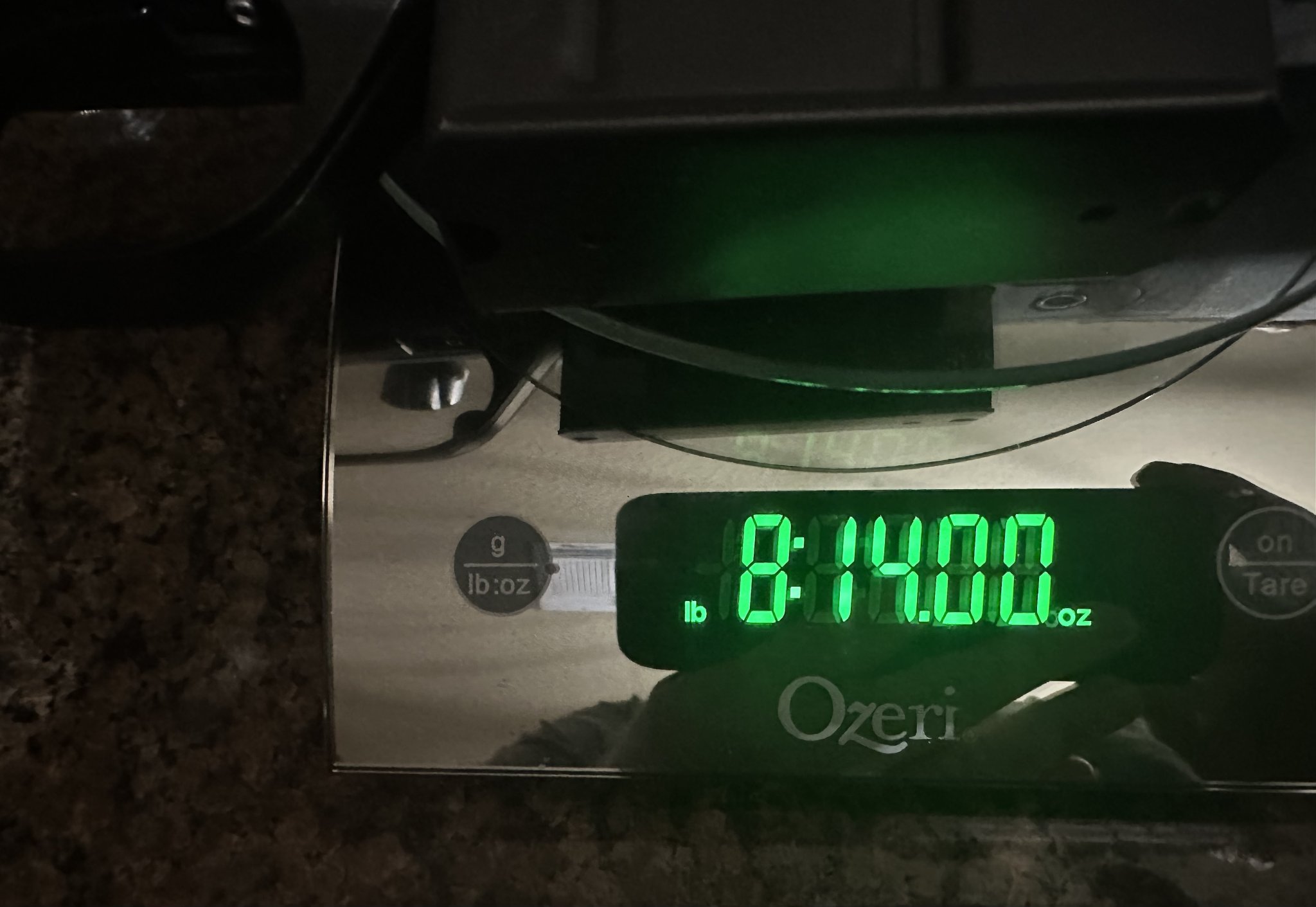

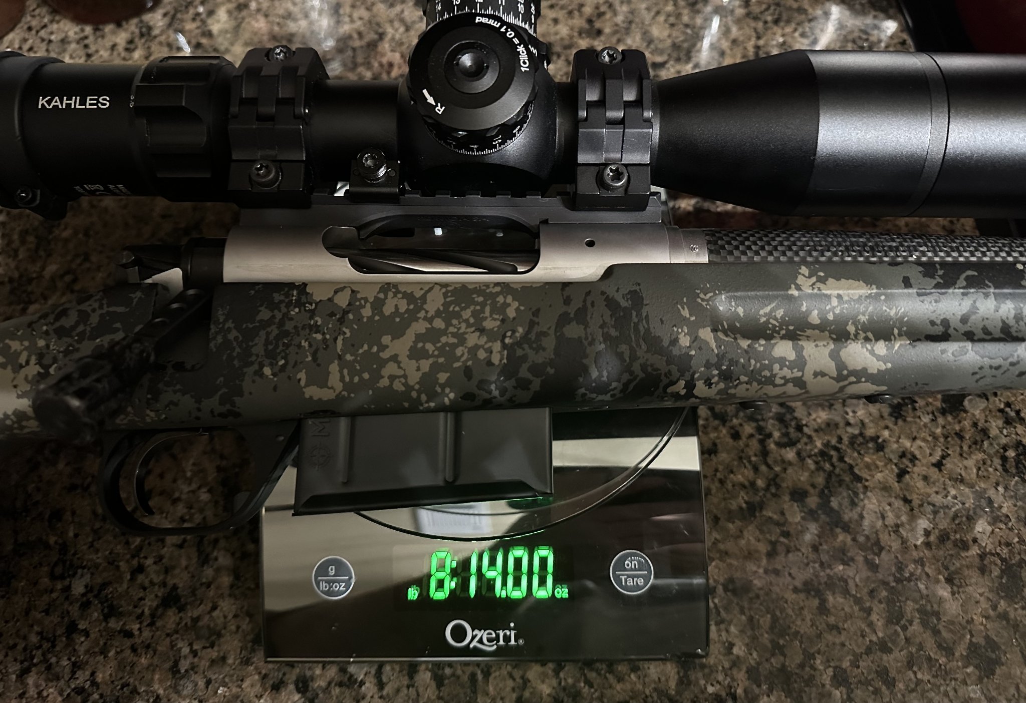

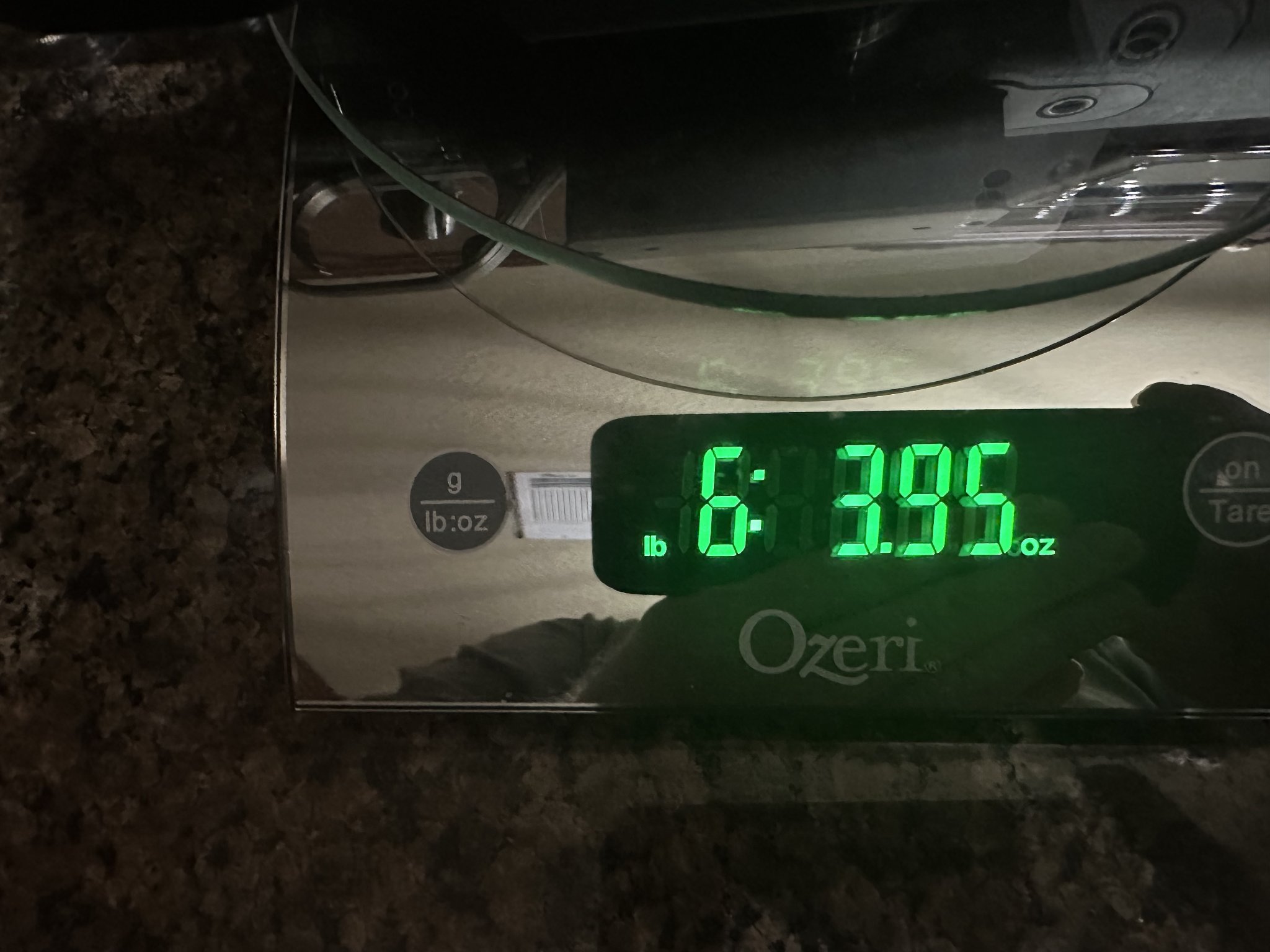

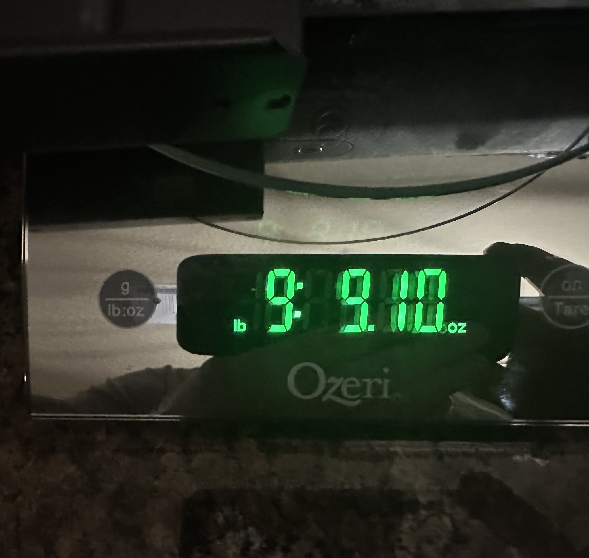

Here were the results...
Just the stripped 20" Ridgeline FFT 7mm-08 rifle with no scope and no suppressor...
Ridgeline FFT w/ scope, but no suppressor...
Ridgeline FFT w/ scope & Magnus-S suppressor...
Aero Solus w/ 20" spiral-fluted 6.5CM (contract overrun) 416r stainless barrel, K318i scope, and Magnus-S suppressor...
Reactions: KYAggie
So the Solus in the Gamewarden with no scope weighs about 7.5# if my rough math is correct. Not terrible. Maybe a little beefy, but if it balances, it would be fine. I like a total scoped and loaded weight of 8.5# max for a hunting gun, but I have yet to hunt with a suppressor, so that would add a bit. I tend to grab my R93 in either 270 or 300 Win mag when I hunt as it’s light and has excellent balance, but the barrels are not threaded, so no suppressor. I’ve thought about using my Aero overstock barrel, I have the same one, to build up something I could hunt with that has a suppressor, but I would probably put it on my Origin action as it weighs 28 oz which is lighter than the Solus at 36 oz. That’s half a pound lighter and with a light hunting scope would be within the 8.5# I tend to like.
Thanks for the info!
Btw, what does your Game Warden stock weigh by its self?
It’s the Edge Fill model, so VERY light. I think 27oz.

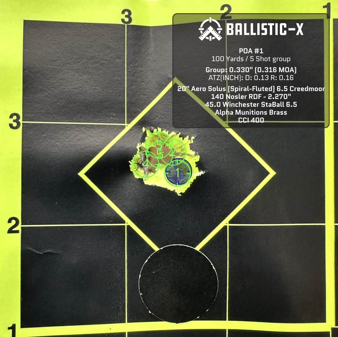

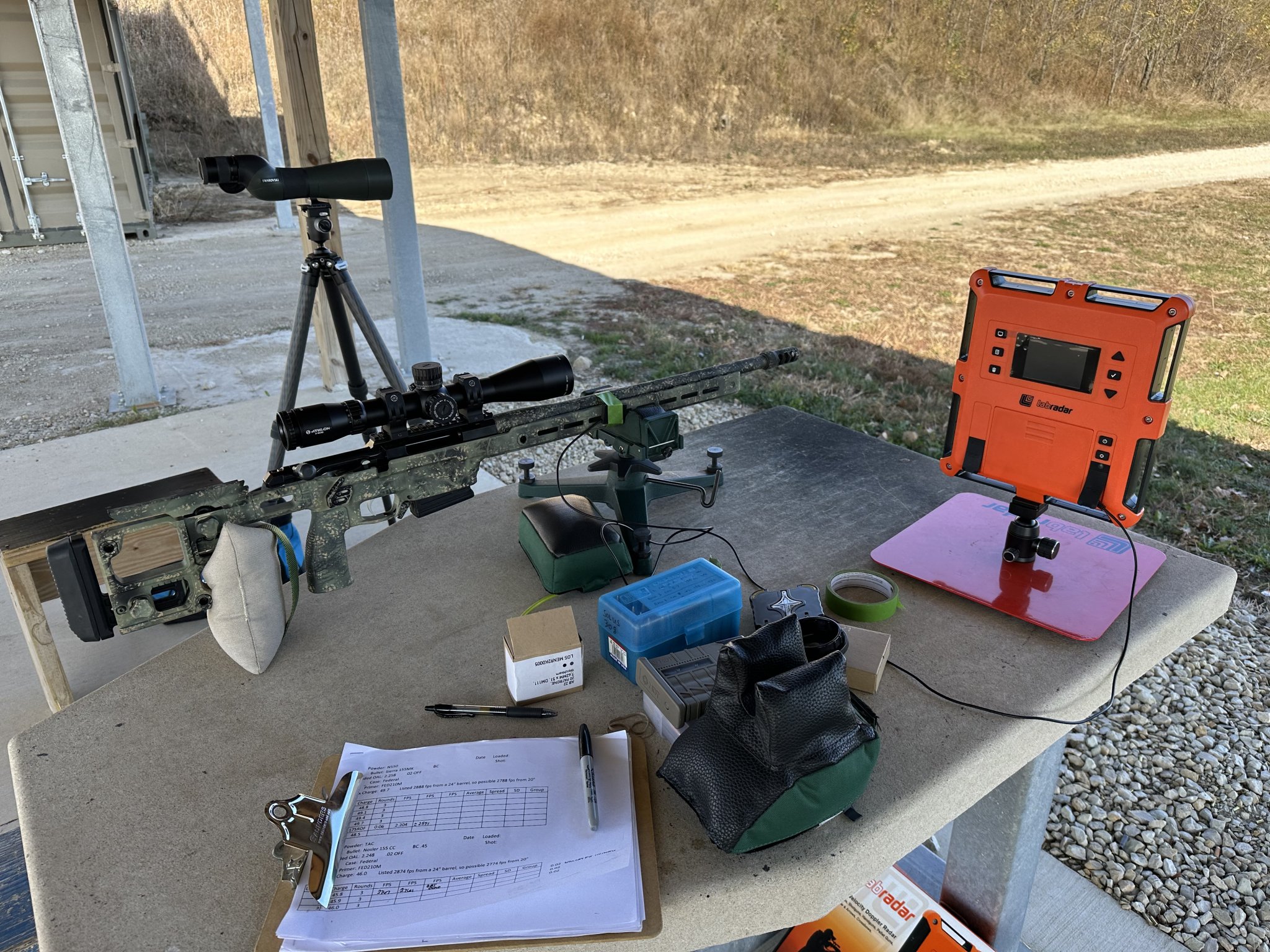

Well... I think it's safe to say that my 20" spiral-fluted 6.5CM contract overrun barrel has been figured out and was actually stacking right off the bat. All I did was torque it on, run a few wet patches with RemOil on them, and then patched it dry with a couple patches, and went to the range. I loaded up 25 rounds (for breakin/testing) of the exact same load that shot the best in my 22" 6.5CM Solus factory barrel. Same COAL, same everything. Sighitng in, I shot the first round and it hit the backstop. Guessed where it hit, made a quick adjustment, and then shot a 2nd round at the biggest steel gong, just to find my POI, and it was (overall, from bore sight) high 1.1 MILs, and about .4 MILs left @ 100 yards. Adjusted, and shot 3 pinwheeled the gong, shots 4 and 5 went into the same damn "hole" (steel gong, so no penetration), but the group looked like 1 shot. Had a couple other guys there today, and they were like "Damn... That's a shooter!" So, I decided to let it cool down, and shot round 6-10 into the first group on paper, then I went out to 300 immediately with a 1 MIL dope and started pinwheeling the 3" gong @ 300. Then at the final 5 shots (21-25), I put down another group just to verify the barrel is staying consistent... Here's the results...
20" Aero/Stag 6.5CM spiral-fluted barrel w/ the TBAC Magnus-S...
image_cropper_6F9908FD-0B59-467C-ABEF-81B0F1658A83-15323-00000CF398D5C24D.jpegimage_cropper_5E20E105-58E9-45C7-9BC7-7126BE276E8C-15323-00000CF4B7B8A4B1.jpeg

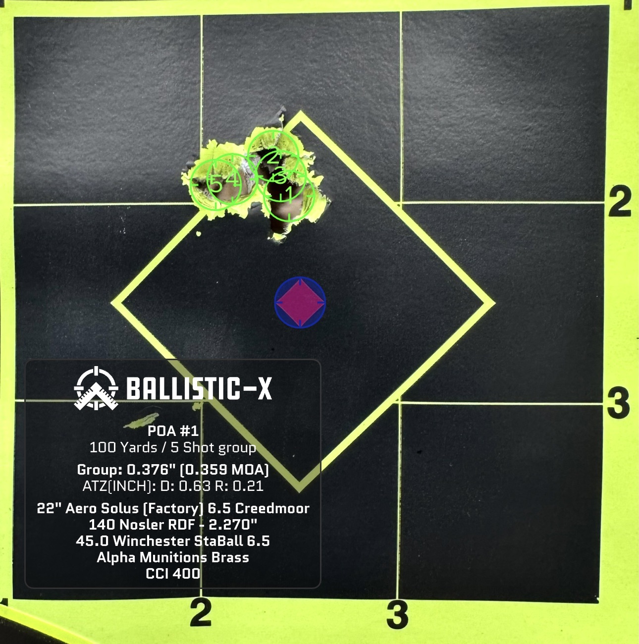

Here's how the 22" Sendero 6.5CM factory rifle shot today (same exact load as the 20") w/ the OCL Hydrogen-S 6.5mm...

Man I hope mine is that good! You were using RDF’s?! I have a few and I frequently get two groups about 1” apart. There will be three stacked and two stacked, but .75-1” apart. That’s with H4350 and a Rock Creek barrel that shoots Custom Comps very well.
I thought RDF stood for random damn flyers.
What speed are you getting with your 20”?
Yeah, those are 140 RDF's. I have experienced this as well in several different caliber and weight RDF's.
The 20" averages (so far) at 2,780 FPS MV. And the 22" is 2,833. Same exact load for both rifles.

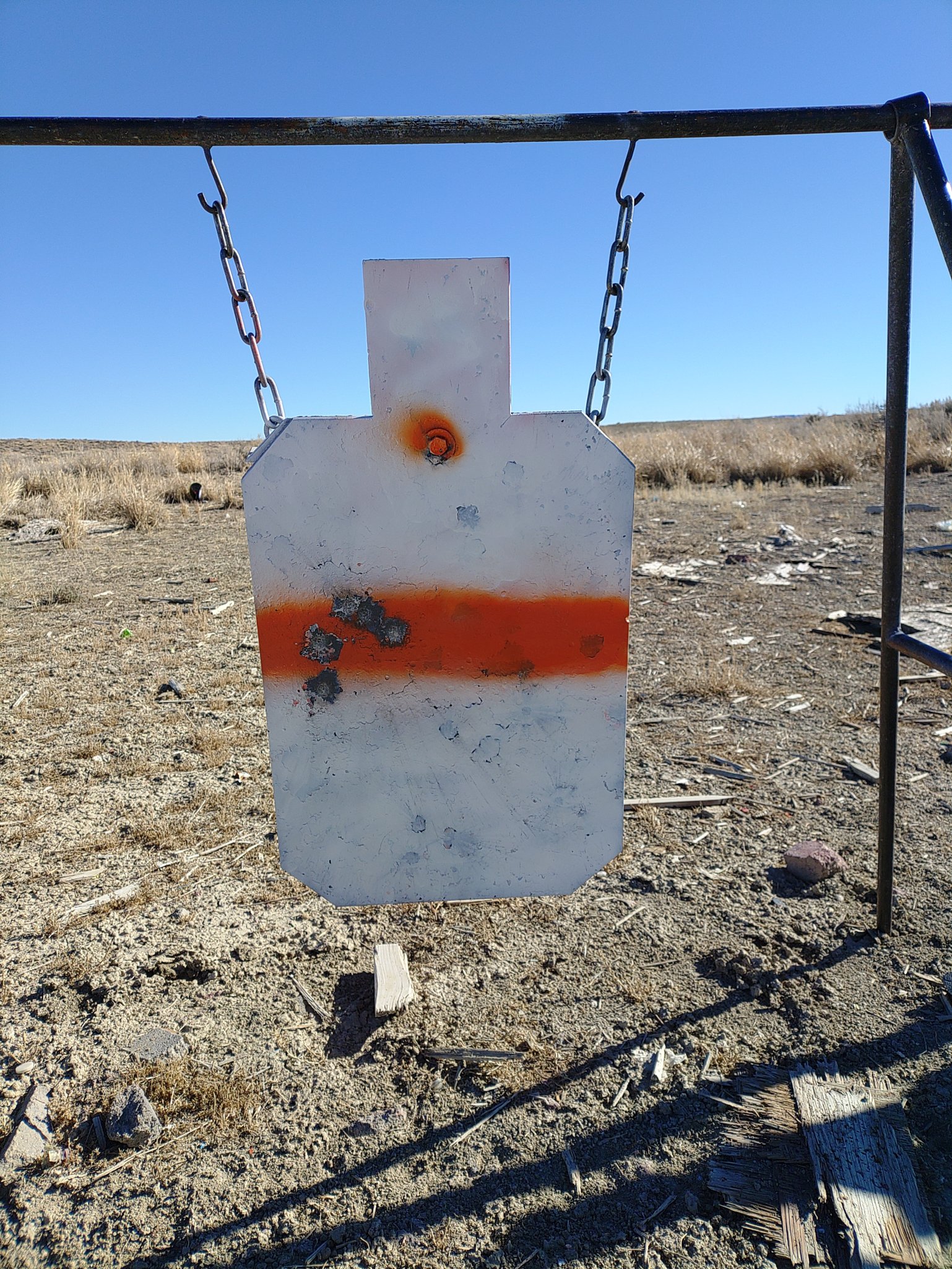

Did some testing with the 20" 308 imr4895 & Sierra 125gr tipped game changers.
3 shot 100 yards
It seems to show promise in the 2940-2970fps range and 3050-3065fps range.
The 5 shots on steel was from 300 yards 14mph right to left. With a charge in the middle of what I tested that actually grouped the worst at 100 yards....3 into 1.25" surprise surprise 4" at 300. I loaded those 5 to zero my scope before testing my I just did it as I was shooting groups so just blasted them at steel instead.
I'll do some more testing but so far it seems to like the lighter stuff
3 shot 100 yards
