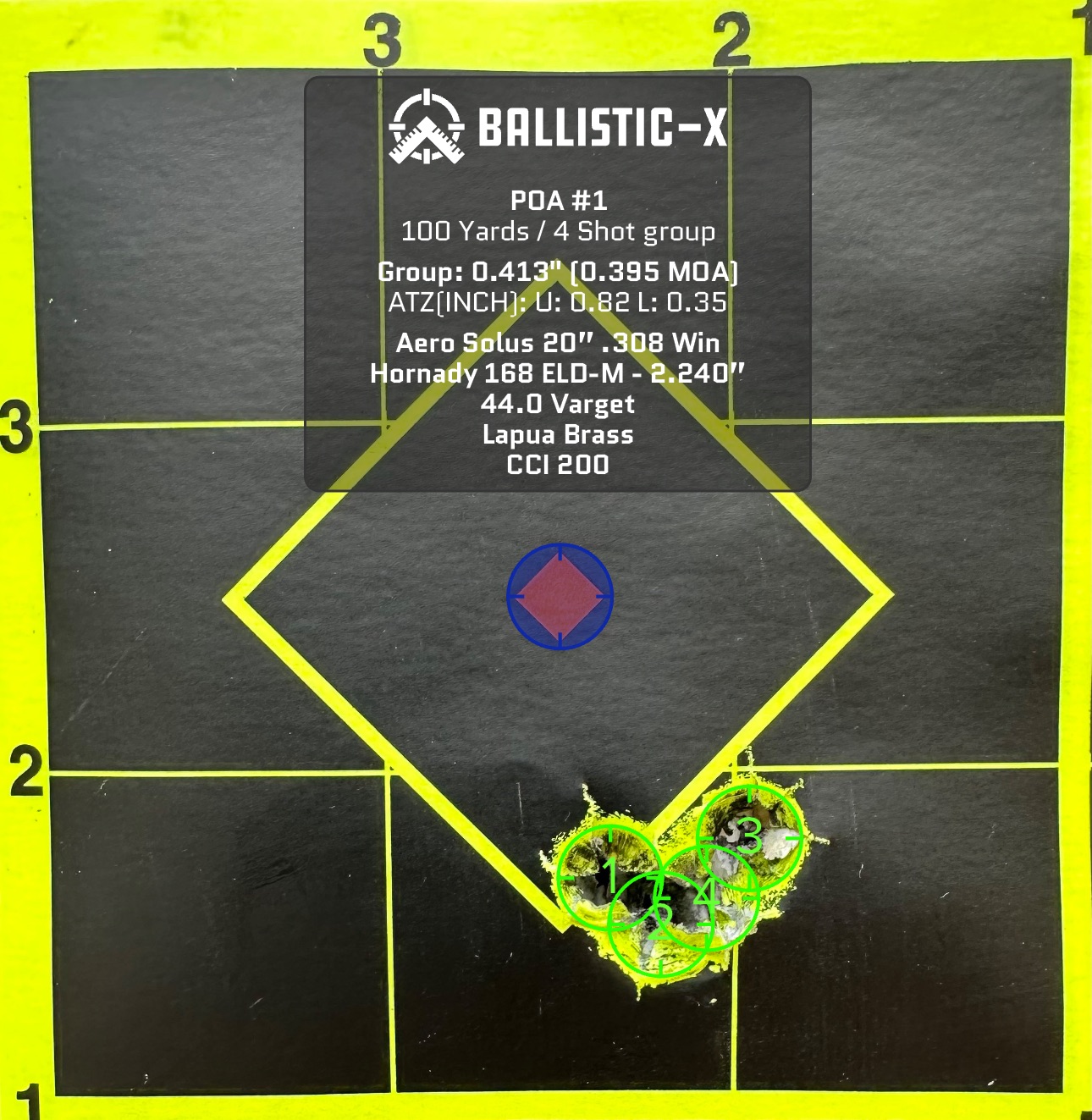

Well... It seemed to like the Hornady 168 ELD-M's better... Plus, I'm only jumping them 0.010" from the lands, and they're still well inside of mag length, and cycle perfectly.
Here's the best group of the day (it's only 4 shots, because it was the starting load, and I shot the first round to confirm my POI on another target)...

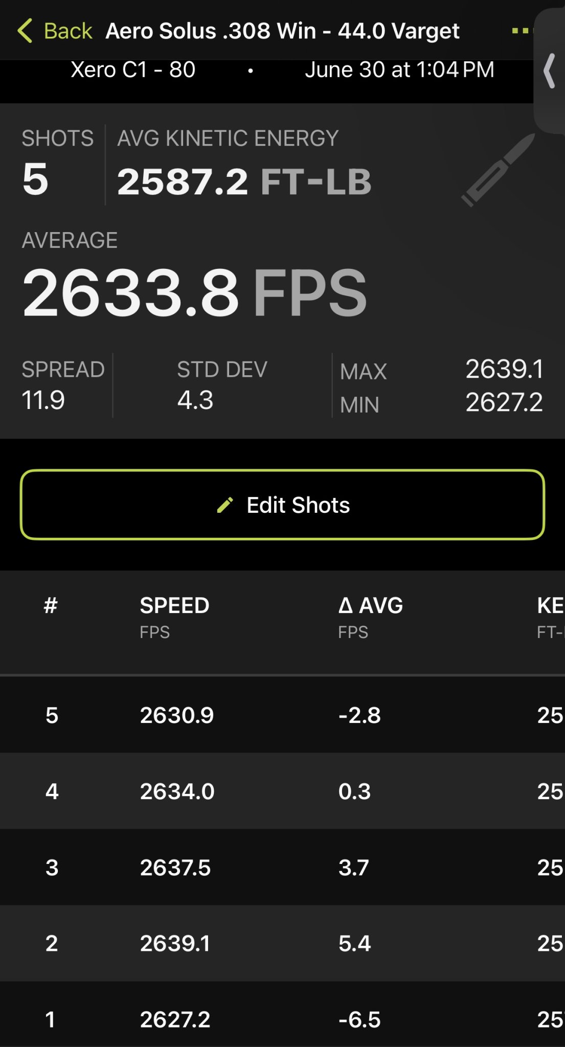

It definitely seems to like slower, than faster… Which is kind of a pisser, but 44.0 was pushing @ 2,634 FPS MV avg. Only 11.9 ES, and a 4.3 SD, too.

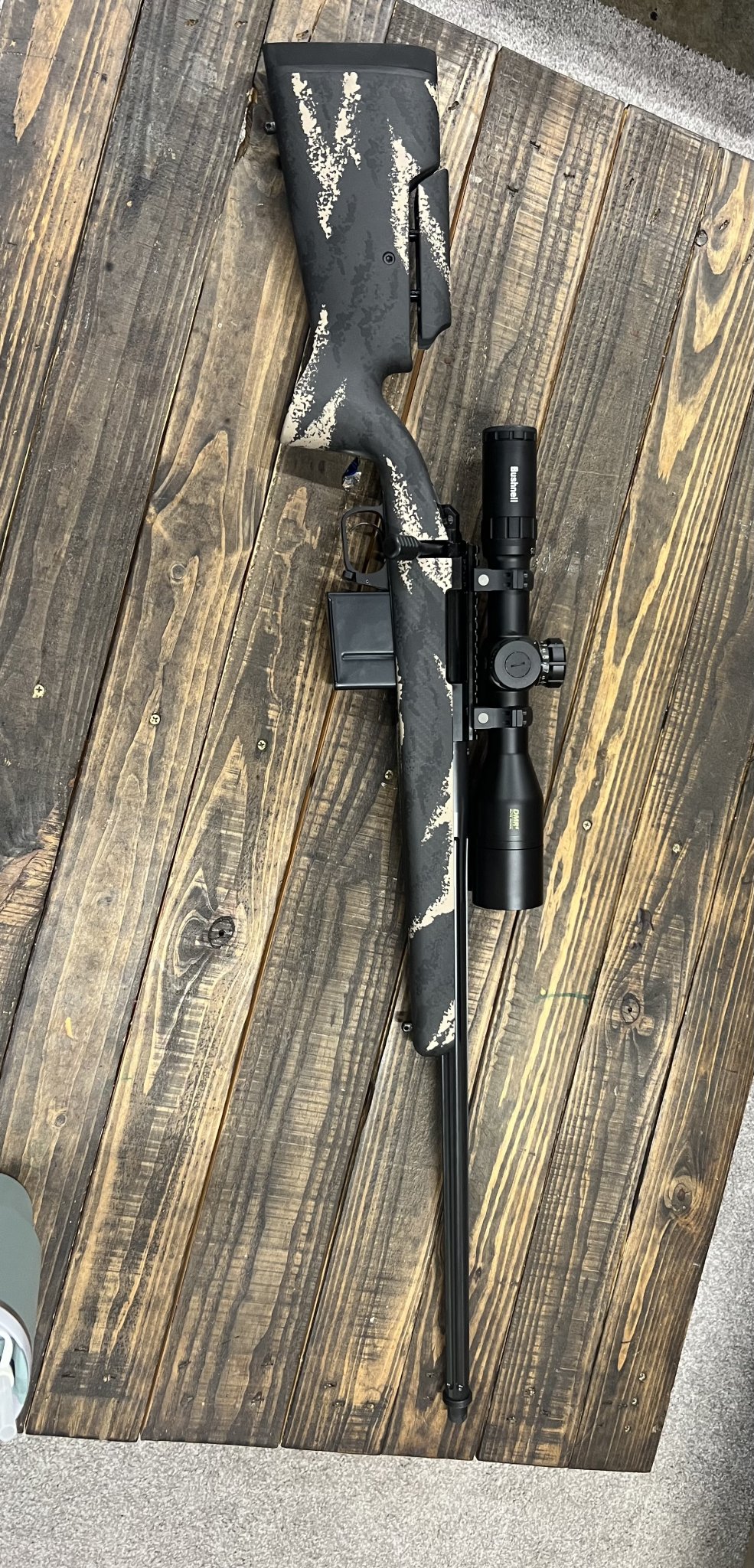

Finally got my solus hunter. Action is smooth but not as smooth as my Zermatt. Trigger is ok. Got it down to 2.5 pounds, which is ok but it will get swapped out eventually. The stock is great. These are very small issues for what I paid for it. Got it from midway for $1576 shipped. I need to get an Arca rail and muzzle brake for it still. Weight as it sits is 10.4 pounds. I’ll get some 147 eldm loaded up and see how accuracy is soon.
I’m having issues with the AW and the MDT 12 round mags feeding the first round. It just doesn’t want to grab the back of the round this seems like it’s more of a stock issue because I have the hunter version. I might try it in the solace precision chassis and probably all issues will go away. What do you guys do a magazine from falling down at the rear end, do they put tape? What do you guys recommend?

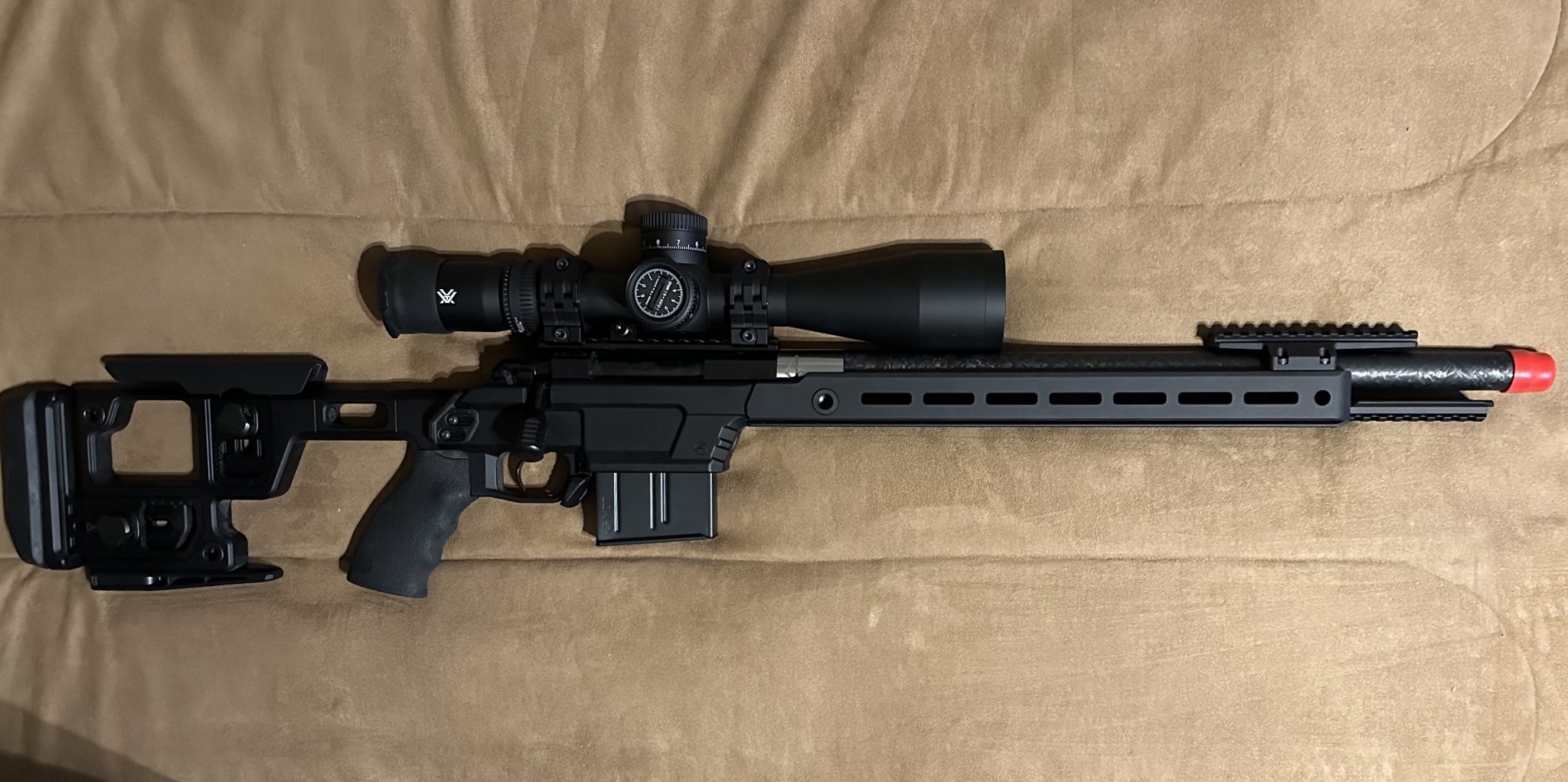

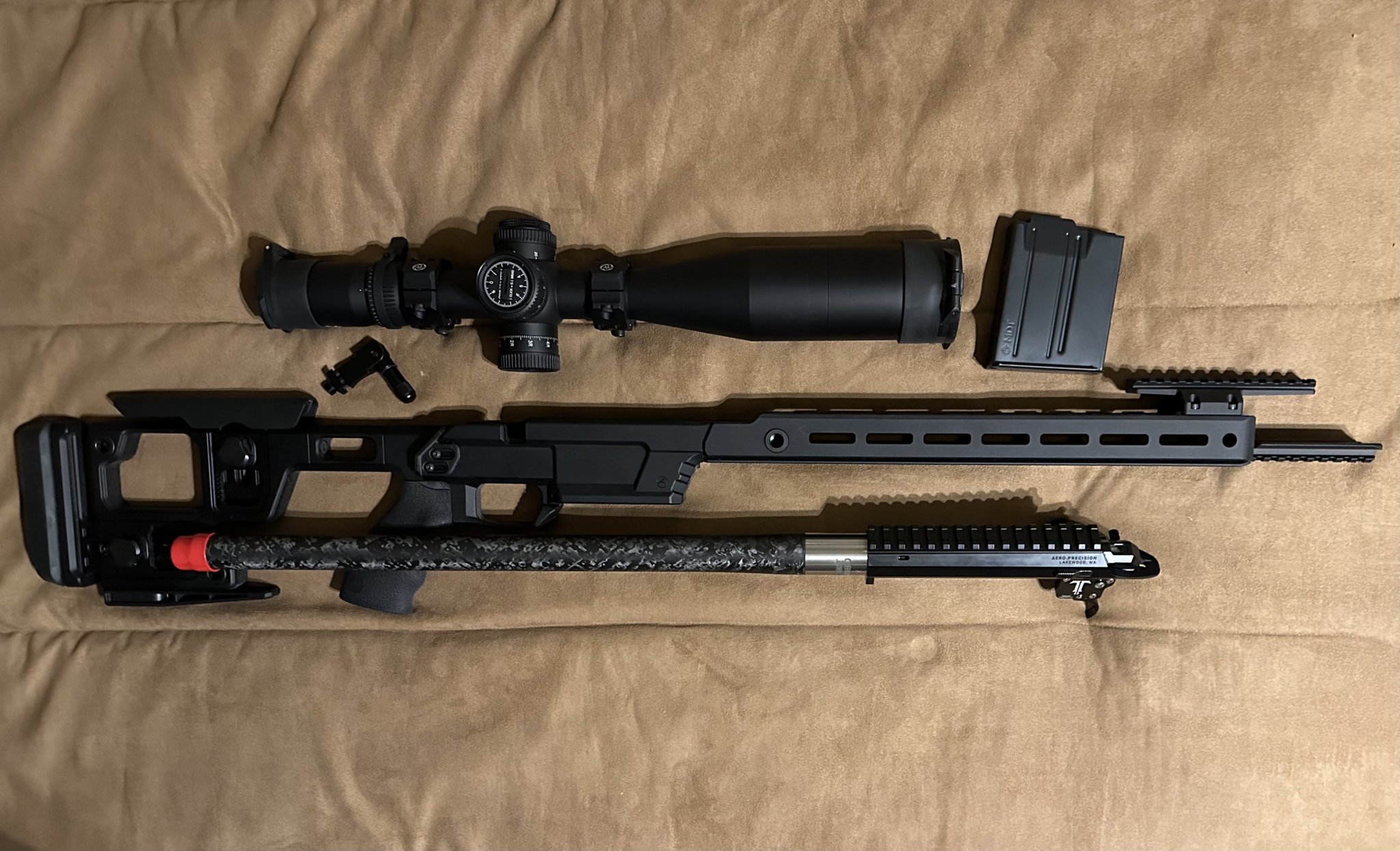

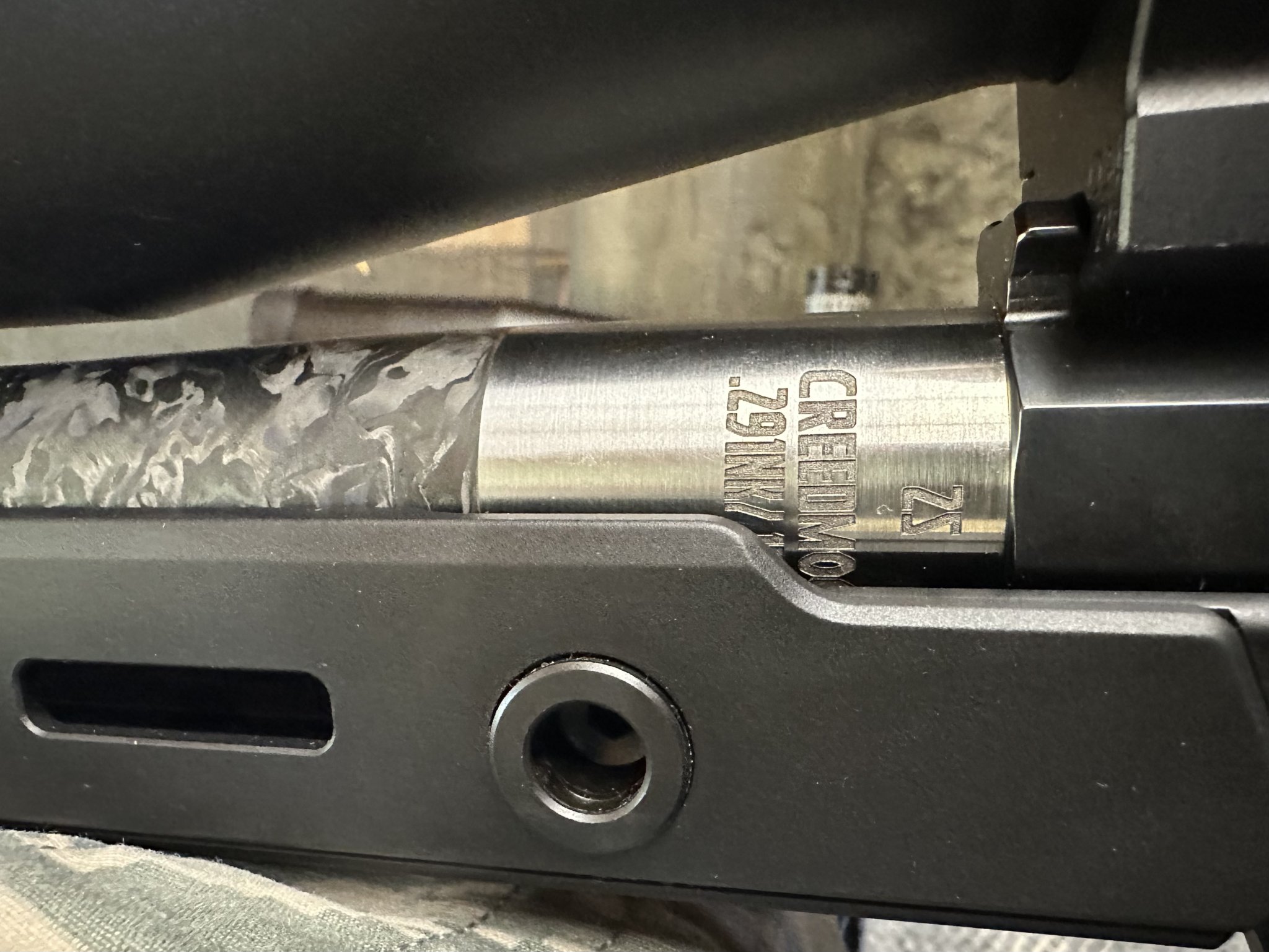

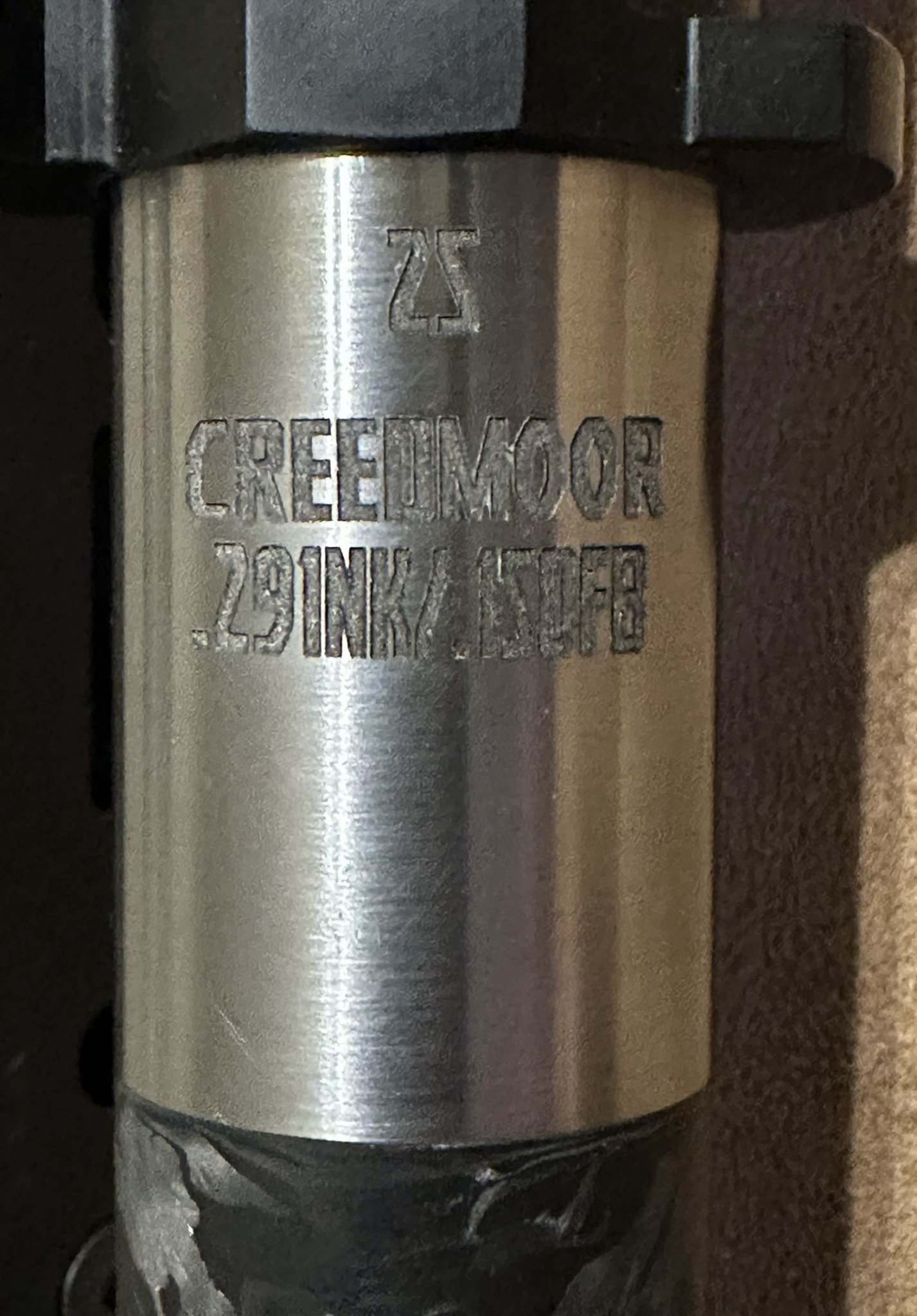

My Proof .25CM custom prefit barrel I bought from Evolved Ballistics and had machined and chambered by Blue Mountain Precision, will be here on Wednesday, according to the shipping company. Took 6 weeks, but still beat McGowan getting my blank to CarbonSix after just a couple months shy of a year... 🙄 McGowan can eat a dick. I haven't liked them (as a company and personally) for over 10 years, and I still don't.
So, next weekend we should be putting down the first shots through the custom Solus .25CM build after going on 2 years since I ordered the action.

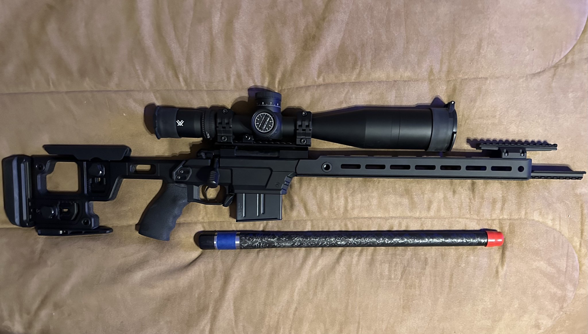

My Evolved Ballistics/Blue Mountain Precision 20" Proof 7.5" twist .25 Creed barrel showed up today... They do excellent work! The barrel threads are perfect, and all the threading and chamber are polished up and clean. They also put the neck and freebore of the chamber on the side of the barrel. So I torqued the barrel on with my old MAC 3/8" torque wrench, and the Solus action wrench to 80 ft. lbs., and mounted my SAC Modular barrel vise (35 ft. lbs for the big 3/8" allen bolt that holds the barrel still) in my Sawtooth Rifles Dependabite ARCA vise jaws, and it was solid as a rock. Checked HS with a set of Manson Go/NoGo gauges, and everything checked out perfect. So, she's good to go. Now, the only thing left to do is wait on my new set of ARC Medium 34mm rings to show up, because the Lows are too low for a 56mm scope with a Sendero profile Proof barrel. Hopefully they show up by Friday or Saturday so I can shoot it this weekend... If not, then it won't be ready to shoot until next weekend.
I just have to say, this barrel is beautiful... They really put some nice grains in this one, very flashy, and the machine work done by Blue Mountain Precision is exceptional...I'll definitely be calling them for another barrel in the future.

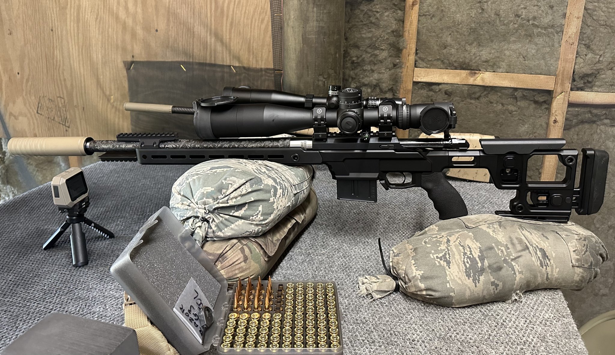

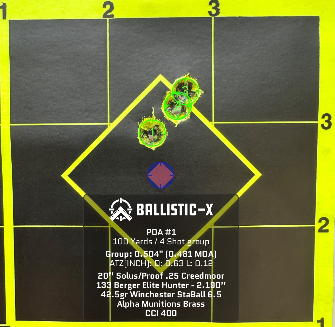

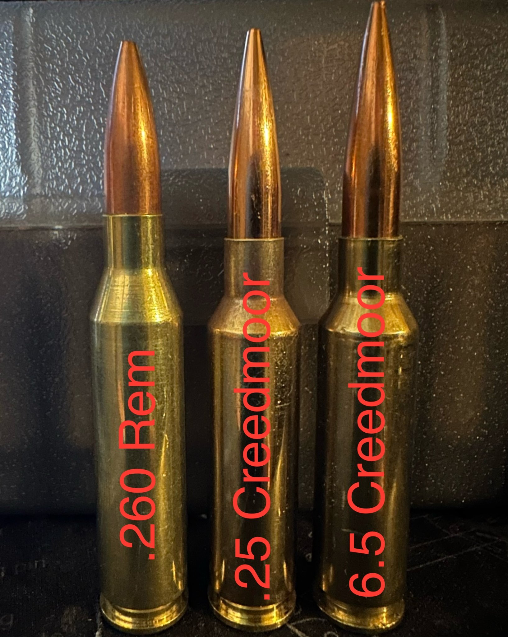

First set of load development rounds loaded for the .25 Creed with StaBall 6.5, CCI 400's, and Berger 133 Elites and new Alpha Munitions .25CM brass. They're seated to 2.190" B-to-O, which puts them at a very short 0.010" jump, which means that I shouldn't have any seating depth issues. At that seating depth, they still feed in the MDT steel mags with tons of room up front for even longer bullets.
The picture with the 3 loaded rounds are as follows (for comparison) Left-to-Right:
1.) .260 Remington w/ Nosler 140 Custom Comp
2.) .25 Creedmoor w/ Berger 133 Elite Hunter
3.) 6.5 Creedmoor w/ Berger 156 Elite Hunter

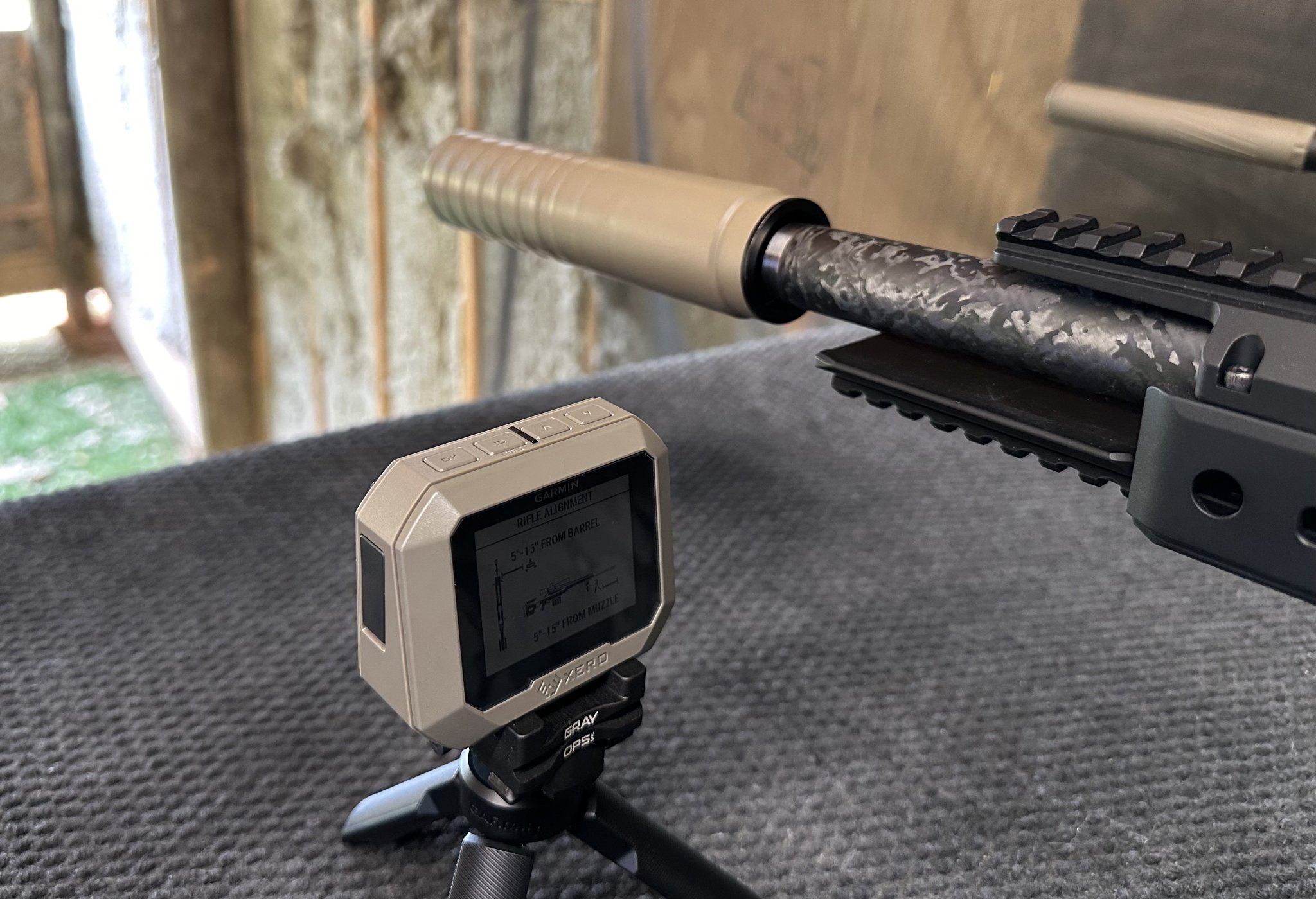

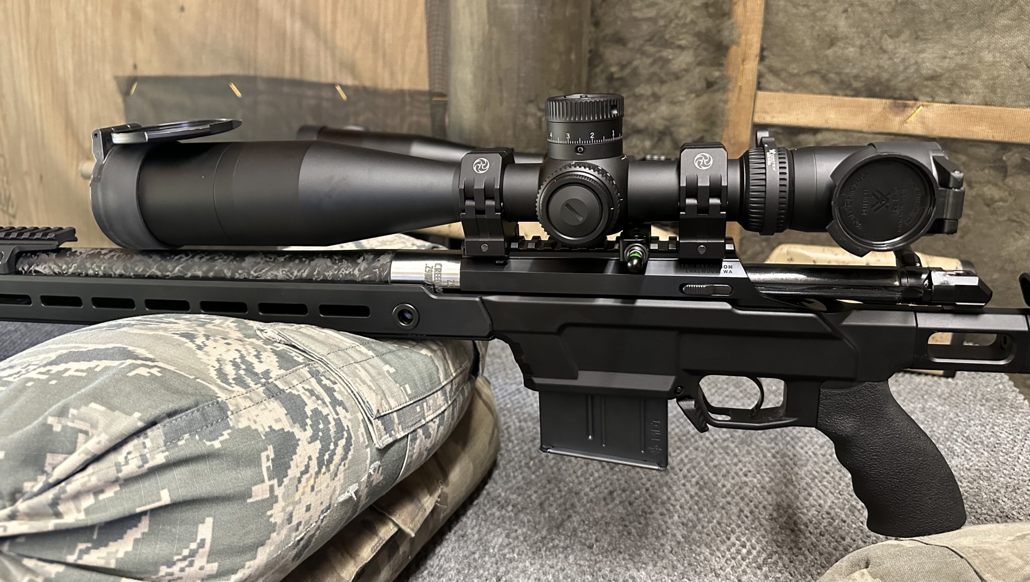

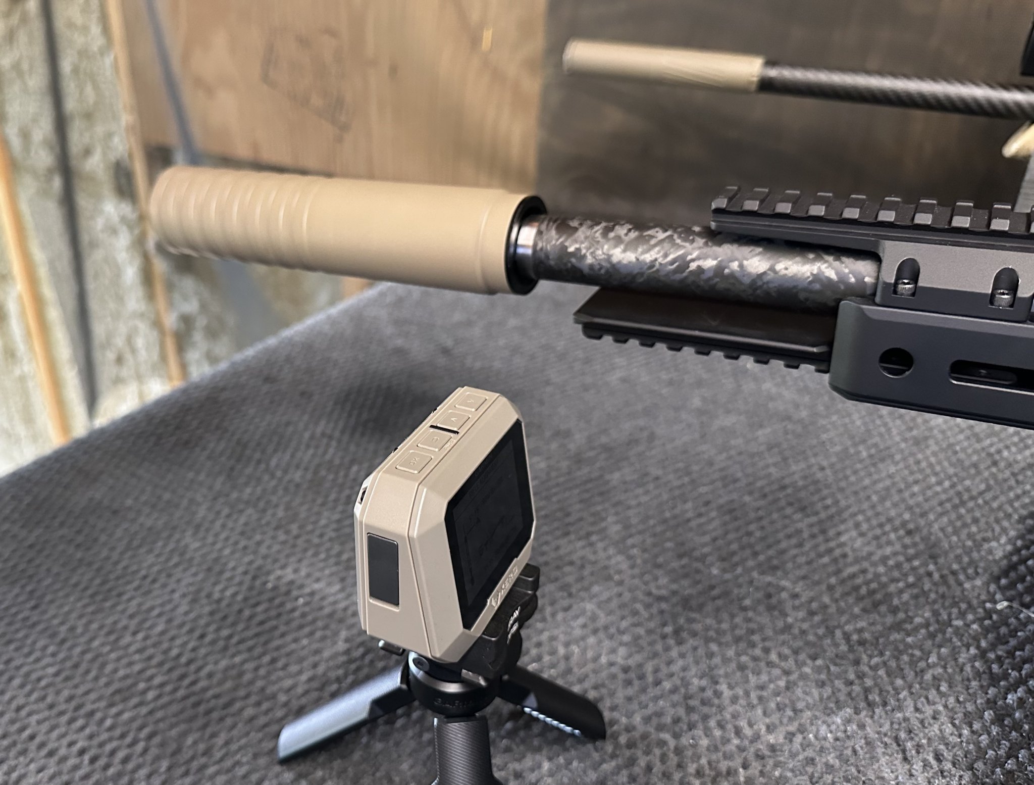

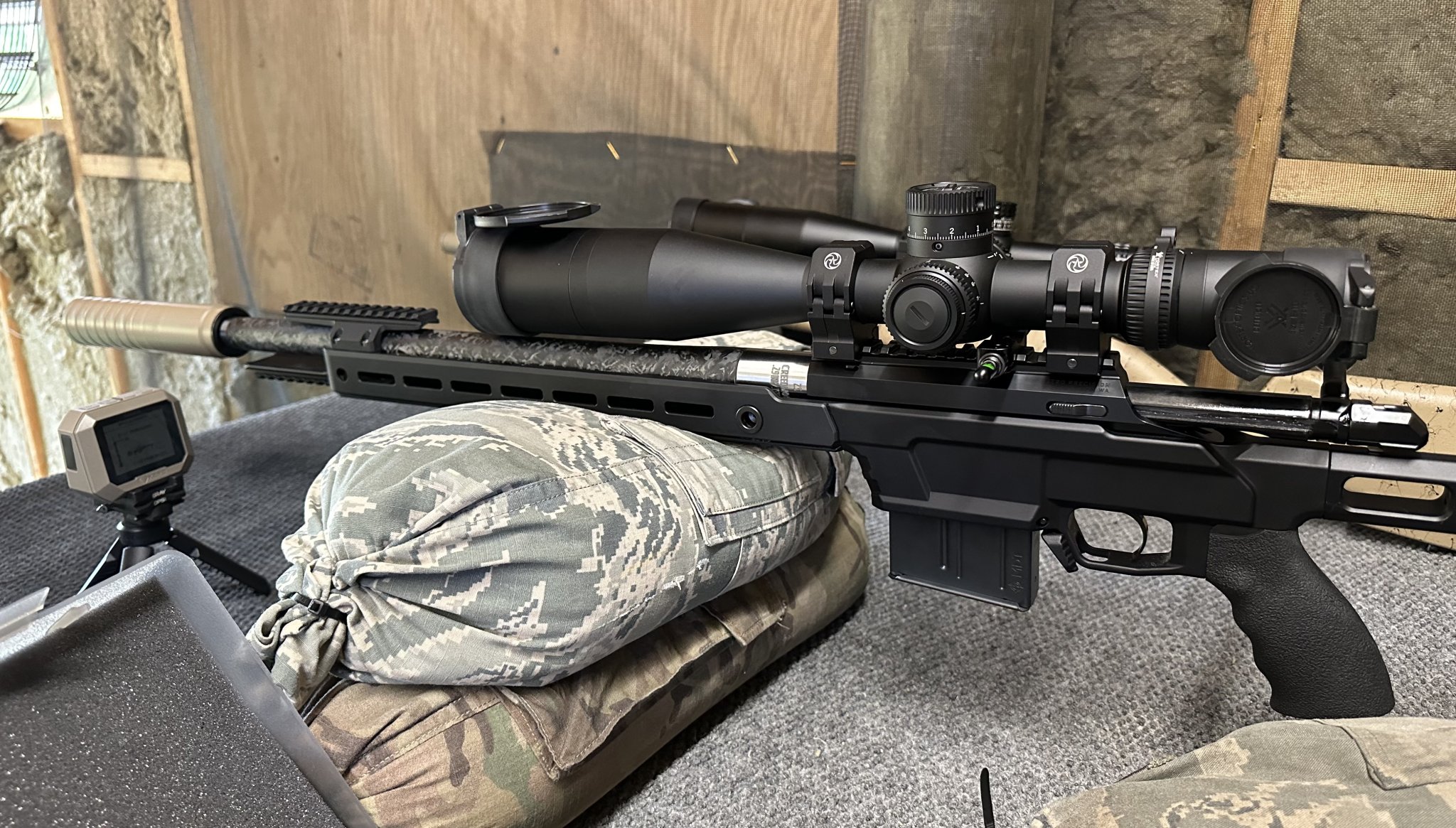

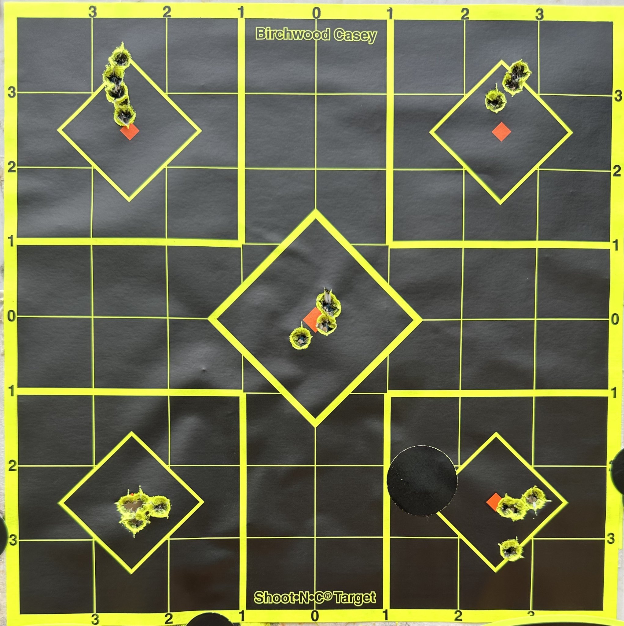

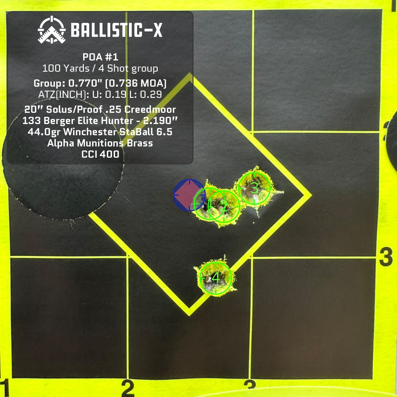

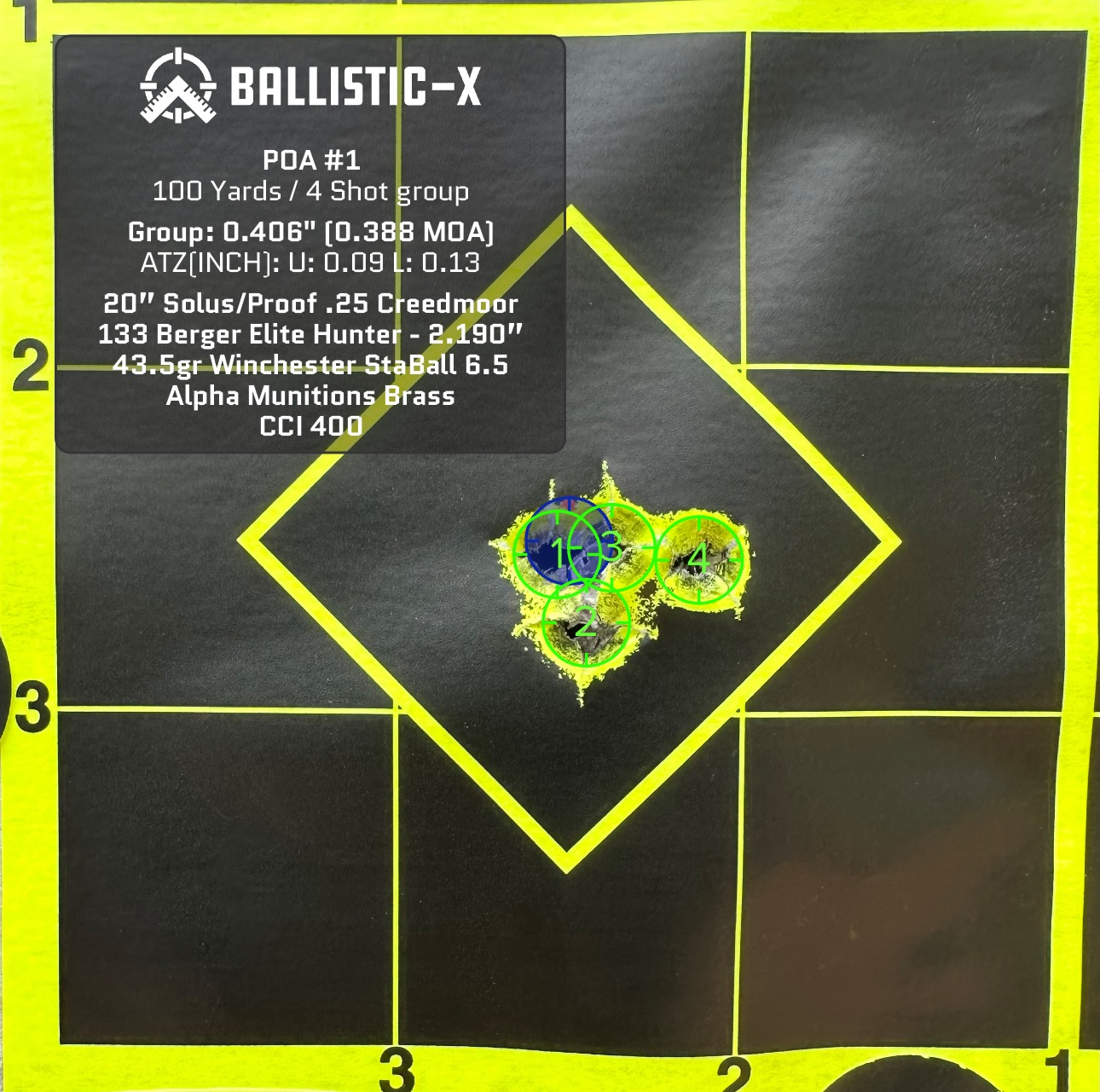

First sets of load development done this afternoon... Not a single group larger than 0.75 MOA, with the best ones in the 0.4xx" range. Keep in mind, this is also a brand new gun, cartridge, and scope for me, and it did take some getting used to the recoil impulse (even as little recoil as it has), just like anything, it takes some getting used to it before you can master it. I'm getting much more comfortable behind it now that I've put a few rounds through it, and gotten used to the scope, and finally settled in a bit behind the trigger.
The first 5 shots were a sight-in/ladder, with shooting 1 of each charge weight to sight in, but also to ensure my loads are not too hot. You can see where the barrel was speeding up in the very first group (shots 6-10) on the new barrel, and you can tell by shots 16-20 (group 4) where it started to settle in with a nice velocity node. I'm thinking 43.5 gr. of StaBall 6.5 will be my load, but my 2nd round will be 42.5, 42.7, 43.0, 43.2, 43.5 to see how wide that node is.
Also, I was running my OCL Hydrogen-S 6.5mm can on it, with their ZR0-DTA mount, and it sounds amazing! The 6.5mm suppressor makes a huge difference on rifles that are 6.5mm or smaller, compared to a .30 caliber can the same exact specs.
Here's some glamor shots and the very first set of groups through the new Proof prefit barrel built by Blue Mountain Precision.
IMG_9239.jpegimage_cropper_EE9DC7EC-61C3-4C88-856E-CA383E0FC7DC-586-0000011089ACB5A2.jpegimage_cropper_257668B6-89B3-4523-AC28-16E85373AF85-586-00000110BA15BAA4.jpegimage_cropper_7ABB571C-6EC1-49AE-8282-867DDA41493F-586-00000111D8A79B93.jpegimage_cropper_1BD7643C-8DA7-4737-9735-B2BEA044C2B0-586-00000112B2A4614F.jpegimage_cropper_75636F7A-6882-470A-98FA-BFD3720CF82E-586-00000113879D0B53.jpeg
Reactions: TDWilson
View attachment 8463814View attachment 8463815View attachment 8463816View attachment 8463817View attachment 8463824View attachment 8463818View attachment 8463819View attachment 8463820View attachment 8463821View attachment 8463822View attachment 8463823

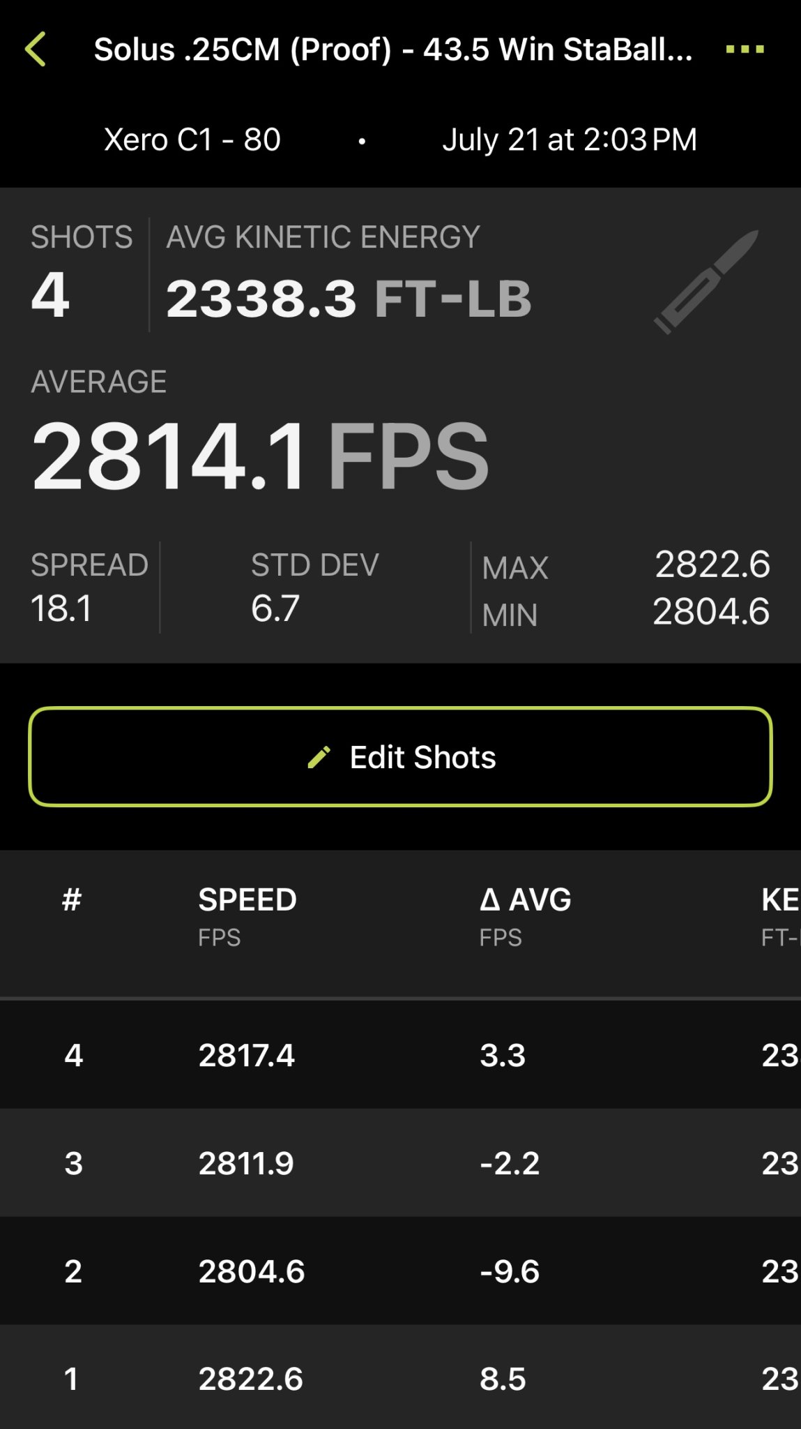

What velocities were you getting?
20" Proof 7.5" twist with Berger 133 Elites, CCI 400's, and StaBall 6.5, I was ranging from 2,696 to 2,836 FPS MV. My 43.5gr load that shot the best was 2,814 with an ES of 18.1, and an SD of 6.7. Pretty solid for a brand new barrel that hasn't even really been "broken in" yet, and I’m extremely happy with those velocities from a 20” barrel.

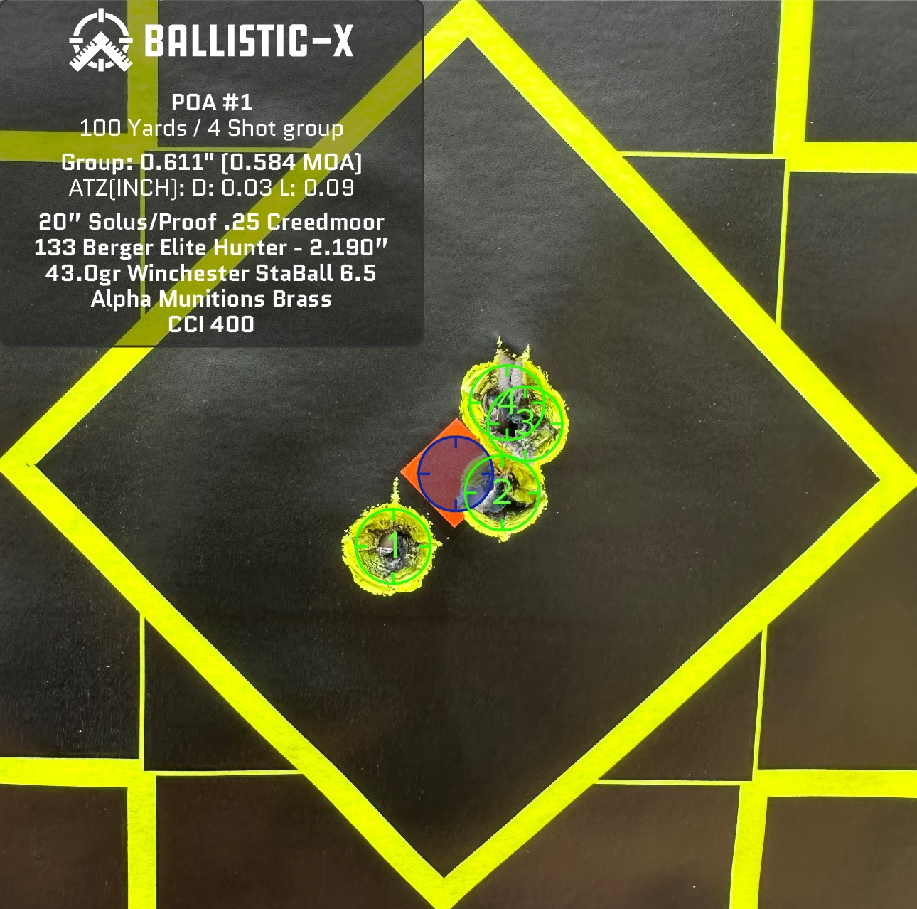

I loaded up round 2 last night... 42.5, 42.7, 43.0, 43.2, 43.5... We're going to see how wide that node is this weekend. If 43.5 shoots similar as it did yesterday, then I will stick with that load, as it had the least amount of vertical stringing, and I knew when I shot #4 I had slightly pulled it to the right, so that 0.4xx" group should probably be closer to 0.2xx", but that was on me, and I'm going by what Ballistic-X says it is, instead of my feelings on it, even though I know that final shot was me slightly pulling...I felt it when I pulled the trigger. I knew I would jinx that group after shots 1-3 being stacked on top of each other in the bull...And I did. 🤦🏼 But I'll still take a 0.4xx" group all day long even with me pulling a shot, as long as it will consistently do it.

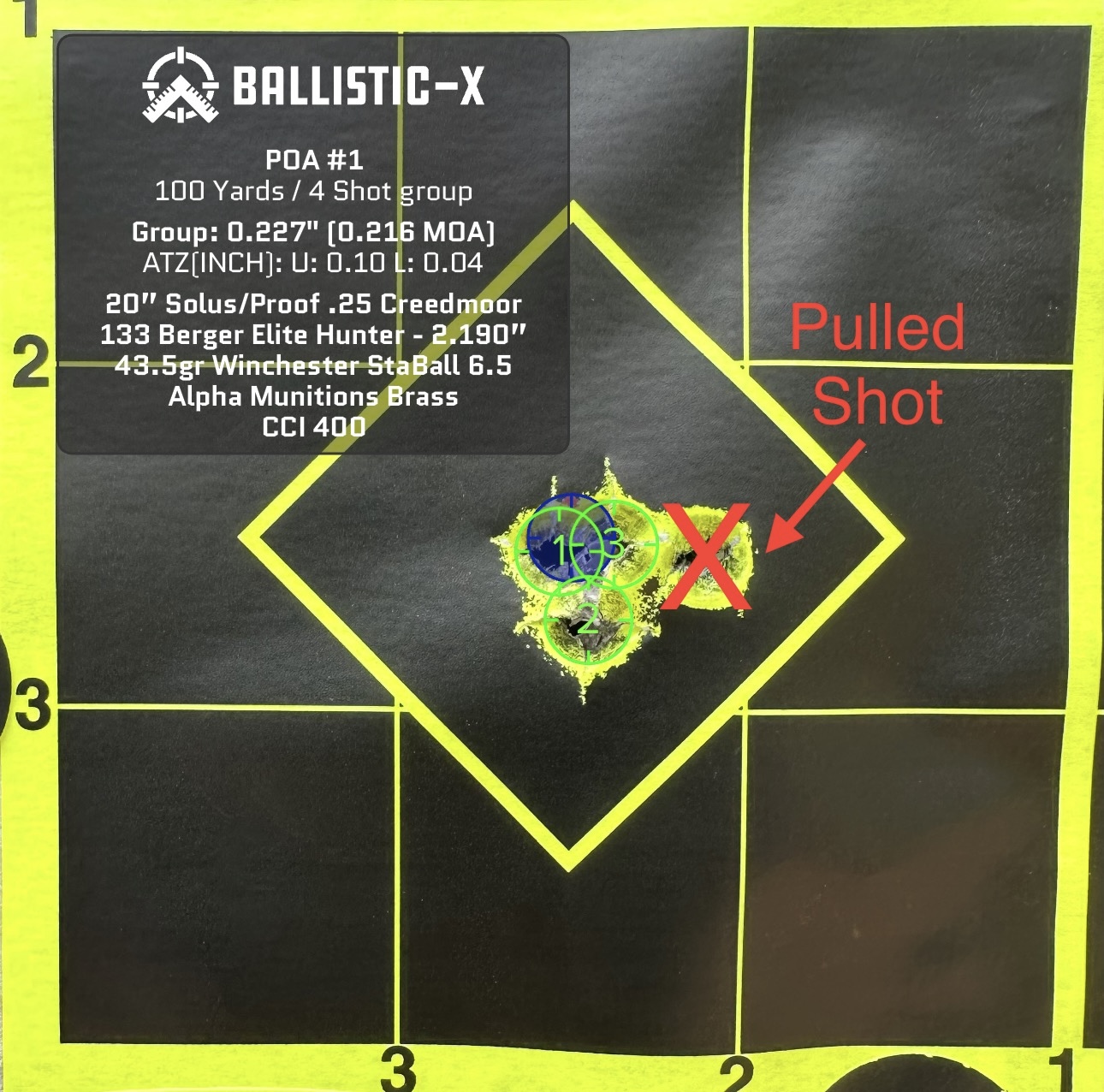

Just went back into Ballistic-X into my history, and then just for fun pulled shot #4 from that group, and let it only measure shots 1-3... Those 3 shots were a 0.227" 3-shot group. I'll take that any day!
This was just for fun, I don’t actually make a habit of removing shots from groups, I just wanted to see what it would have been like, had I stopped at shot #3, and not pulled shot #4.
