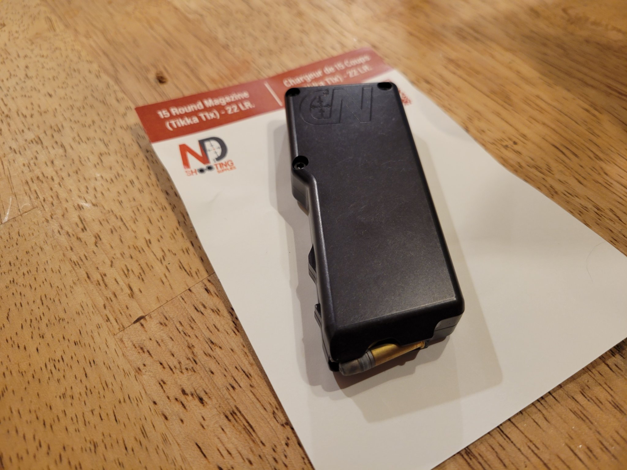

Well, pulled the trigger on one, finally. Bought the standard bolt ons, had a xray from a t3 laying around, got a timney trigger. First impressions with wolf target match were alright. Wasnt a great grouping rifle for a while. Maybe 200 rounds? All of a sudden it started to make 1 ragged hole at 50 yards right before a match. Took second. Lol.
Had an issue with the factory mag, feeding into the bottom of the chamber. Other two are fine. Guy at the match had a 15 round ND mag, all metal and seemed to work great. Ordered 2, they are expensive, like 80 bucks each, but damn are they sweet!!!!

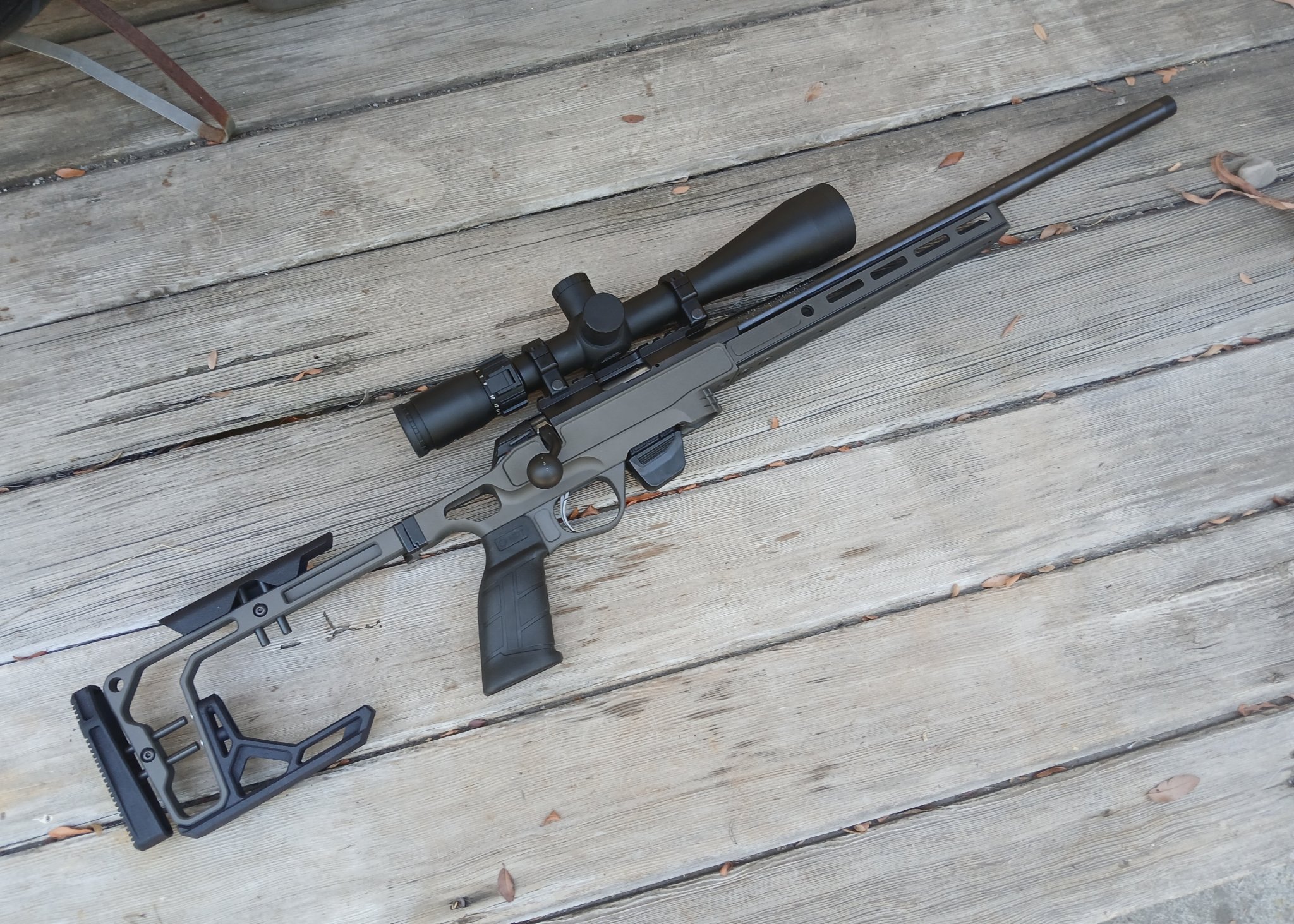

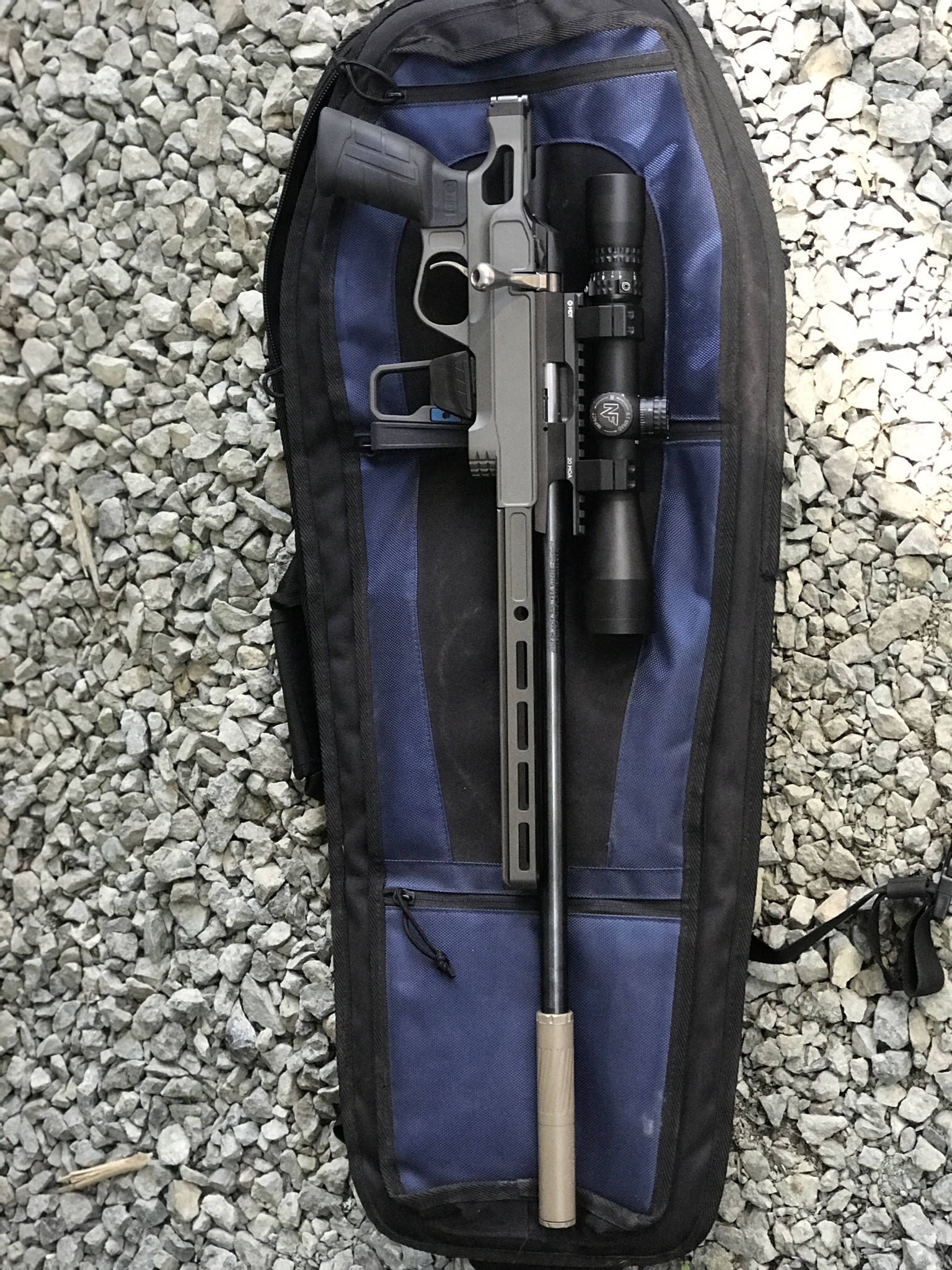

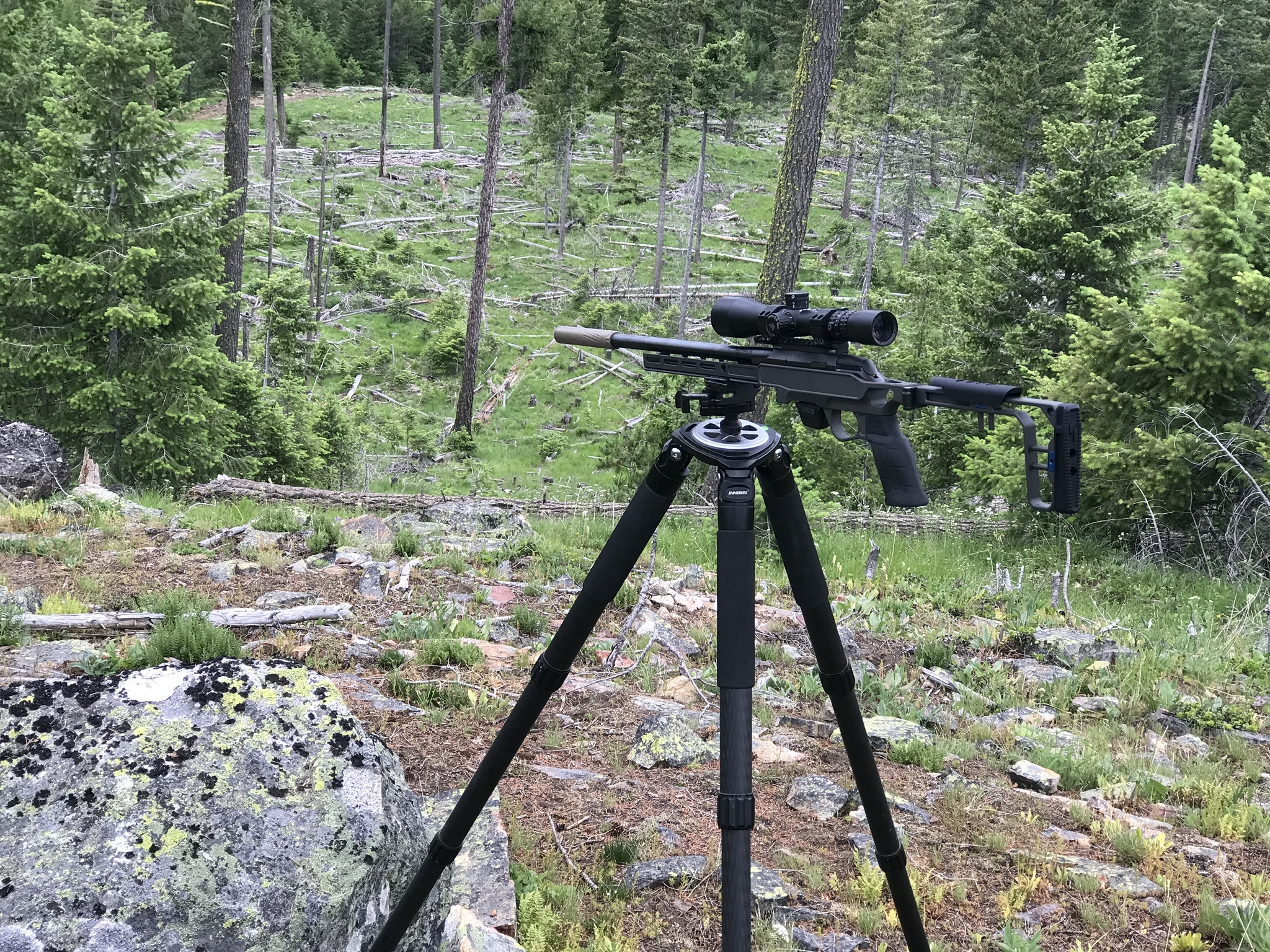

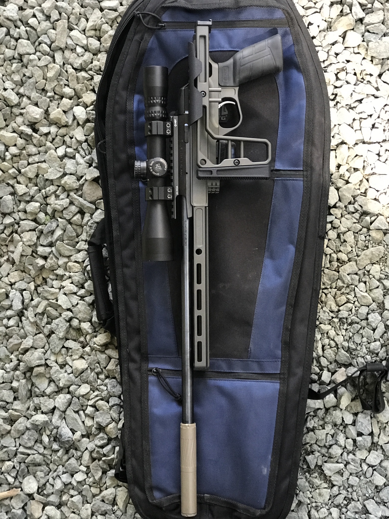

Has anybody used the lightweight chassis from Grey Birch Manufacturing Inc?
I saw that it was mentioned 2 years ago, but there was no more.
For what it's worth. I have my VQ 10/22 Lightweight with a 16.5" carbon barrel in the Grey Birch chassis. The key word for the chassis is Lightweight, with a March 1.5-15 scope (22 oz) the total weigh is 7 lb 6 oz. The chassis is 2 oz more than the original laminated thumb hole stock from VQ. that I liked a lot but I wanted the M-Lok rail and adjustability. It is a very nice chassis, well made and fits my VQ precisely. In no way does it compare to my PDC Custom chassis for my Vudoo. If you want slim and lightweight with adjustability, it fits well.

Oh no, I had no idea this Grey Birch chassis existed and now I have to figure out a way to get one to me in Europe. 😂
Seriously, it checks all the boxes for me. If they would make one for the T3x with CTR mags too so I could have matching ergonomics I would be over the moon.
Had an issue with the factory mag, feeding into the bottom of the chamber. Other two are fine. Guy at the match had a 15 round ND mag, all metal and seemed to work great. Ordered 2, they are expensive, like 80 bucks each, but damn are they sweet!!!!View attachment 8366574

ND. but i have an issue with these as well as factory. Its the gun, or should i say the plastic magwell. My mags need to seat up a hair more. The bullet sits too low unless i am pushing my mags up hard. Its usually the first few bullets, then its fine, 98% of the time.
I got a metal magazine catch, hope.it fixes it, otherwise ill have my gunsmith take a look at it.
