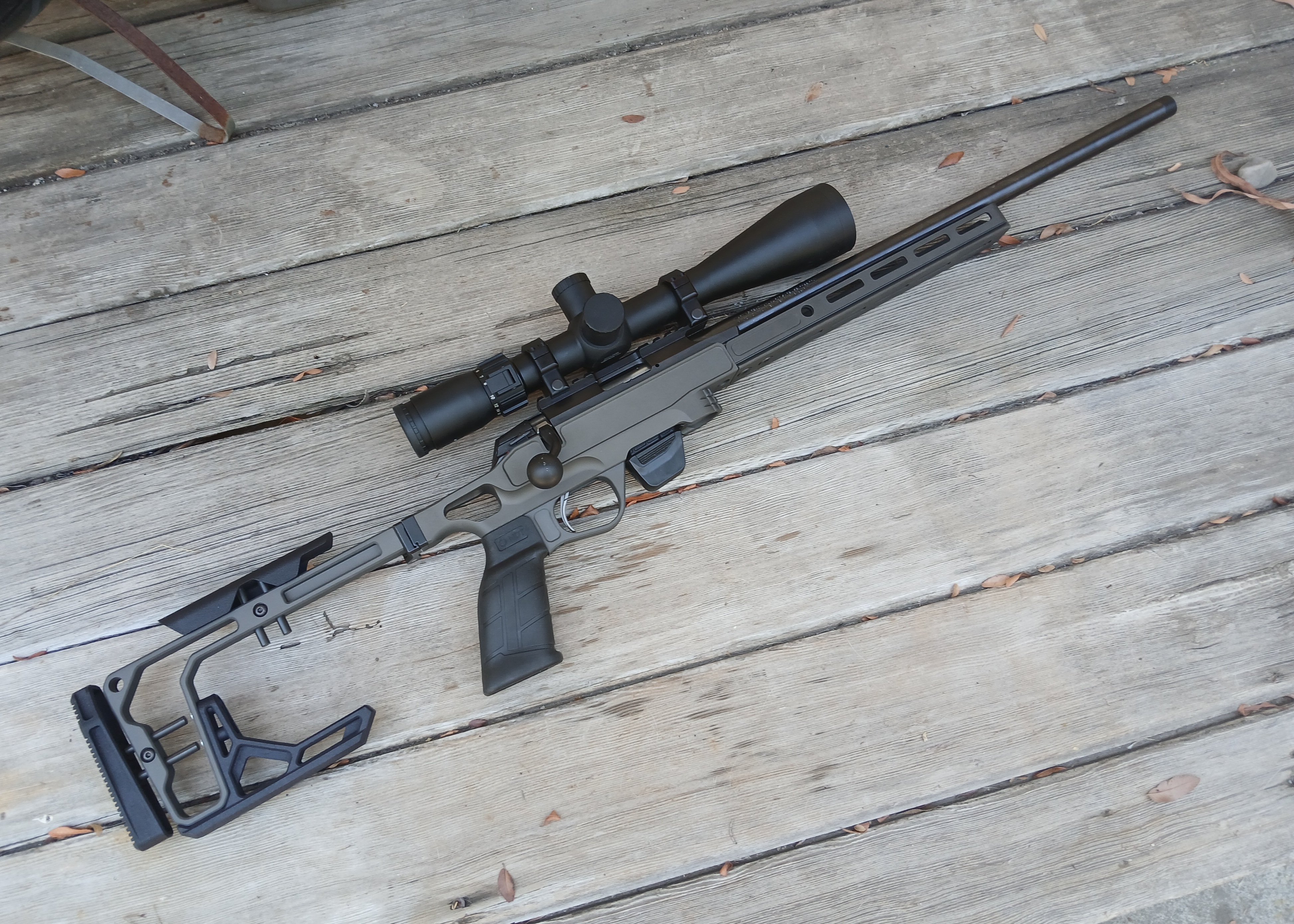

Tikka T1X
The chassis has 3inch magwel, so its designed for centrefire...🤪
Every un-necessary inch that GC is in front of the trigger is a design flaw.
.. lets just hope GC fits on that forend with the bipod still attached...
It makes sense to produce one chassis that can be used on the T1x and T3x, no different to any other chassis on the market.
However it does seem like they need an actual competition 22lr model, with the full length forend and a 24 or 26" heavy barrel. That way it'd actually match the centerfire model as a trainer and would make a killer off the shelf model for people wanting to get into the game.
Most shooters buying their first prs type 22 don’t believe in long barrels. They are sure they know better, without any experience. Experienced shooters will rarely buy an entry level rifle.

The market is missing a good factory option that splits the difference between a T1x MTR/457 and a full Vudoo build.
Might not appeal to the North American market but for the rest of the world R700 style builds aren't particularly accessible.
With the Anschutz offering like the 1761 APR, the AT-X, and the ACC chassis options I think there is a market there.
I don't think a 26" barrel would be universally appealing but maybe a a 20" and 24" barrel option would be ok.
If this existed as an option I 100% would buy one, certainly never would've rebarrelled my T1x, even without the hindsight of the headaches I've encountered.

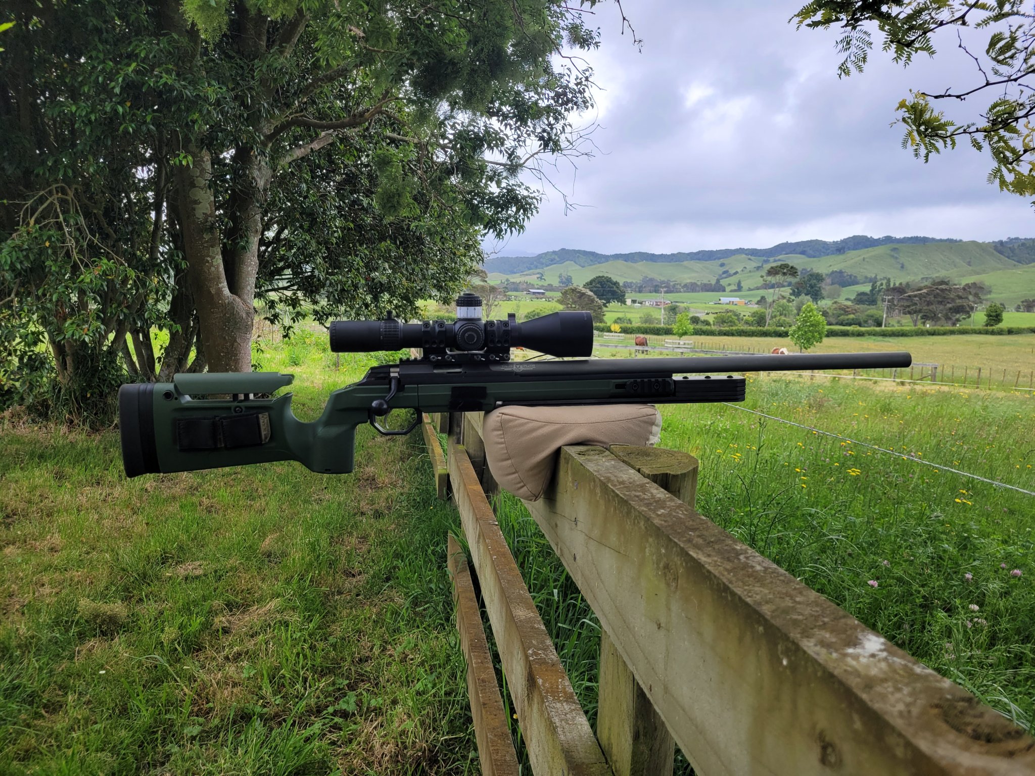

Here's my rebarrelled T1x.
25.5" Medium Palma, in a KRG Bravo (no rear weights) there's about 2.5kg of steel in the forend, between a custom full length t slot weight, 14" steel arca rail and the additional weights on the rail.
With just the slot weight it balances pretty well, just in front of the magwell, but to get the balance point 4" further forward need the additional 1.6kg of arca rail and weights.
I imagine if it were a heavier profile barrel or 28" long I'd be able to have it lighter overall but I don't know there'd be much in it.
I have been playing with a lighterweight scope (XTR3 3.3-18) and that definitely balances easier, don't really need the additional weights on the ARCA rail.
Personal thoughts based on the video-
The chassis seems extremely well thought out with nearly every option you can desire in an aftermarket version and then some.
Having an adjustable anything that returns to a preset is an awesome step forward.
Integral Arca-Swiss rail, one less thing to buy and worry about coming loose.
Fully adjustable grip, when so few options are out there anyway 👍
Only thing I can think of to change would be a longer forend and heavier profile 22-24” barrel.
I don’t give a flip about folding stocks, you go to a chassis for more flexibility in adjustment while having a stock that is the ultimate in rigidity.
Offer 15 round billet magazines and a true match trigger option for the win.

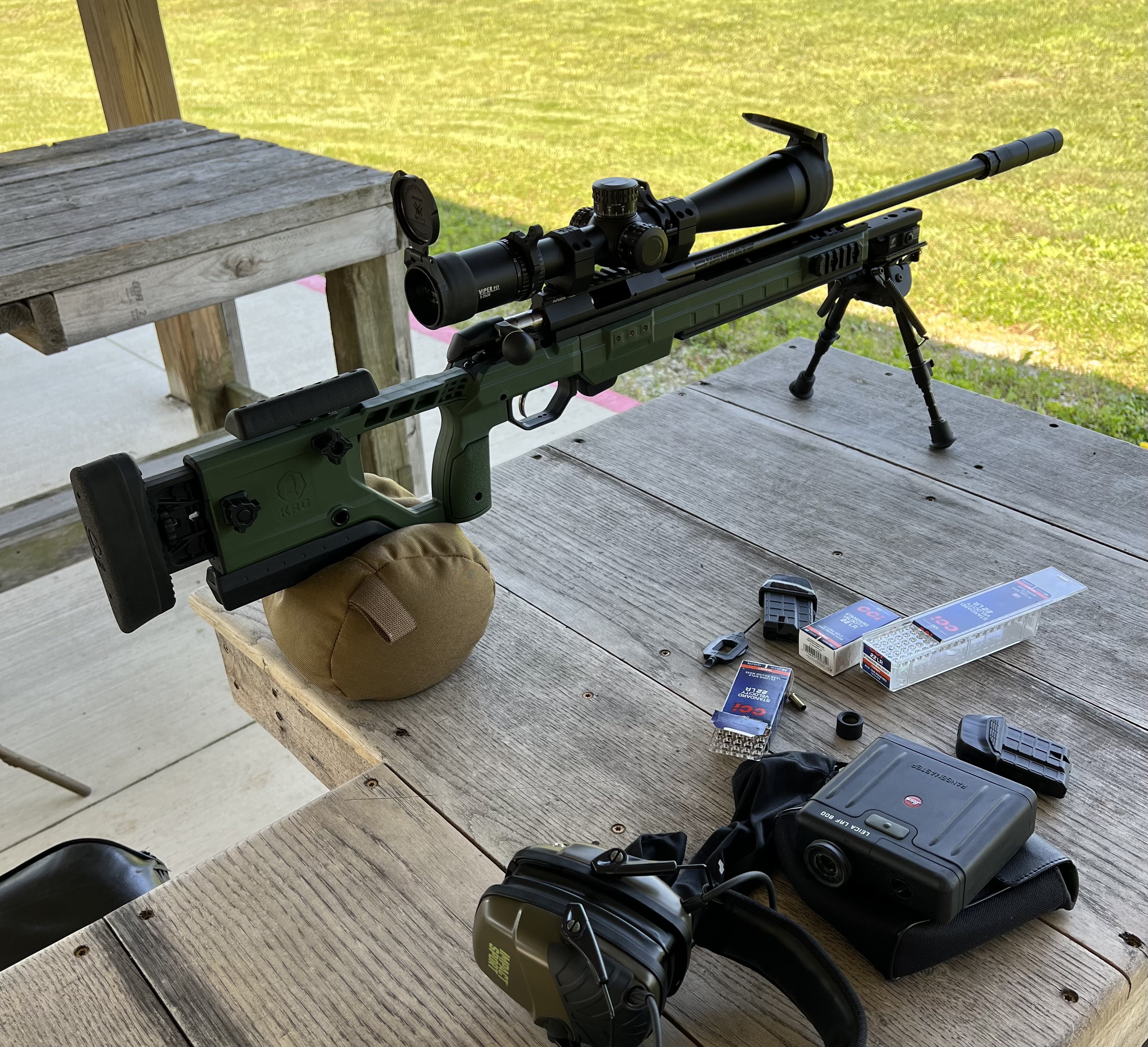

What are the details of your build?
Any pictures?
My Tikka has gone down the road. It was a 20” IBI 12T Calfee IV chamber in an ACC Premier folder. Razor G3, 1 piece MDT mount, 50MOA rail. My Duece is 24” 1.06” 14T Prevail chamber barrel in a blue ACC Elite. ARC 30 MOA mount on a 20 MOA rail. Trigger tech Diamond 2 stage. I don’t think I have any pictures.

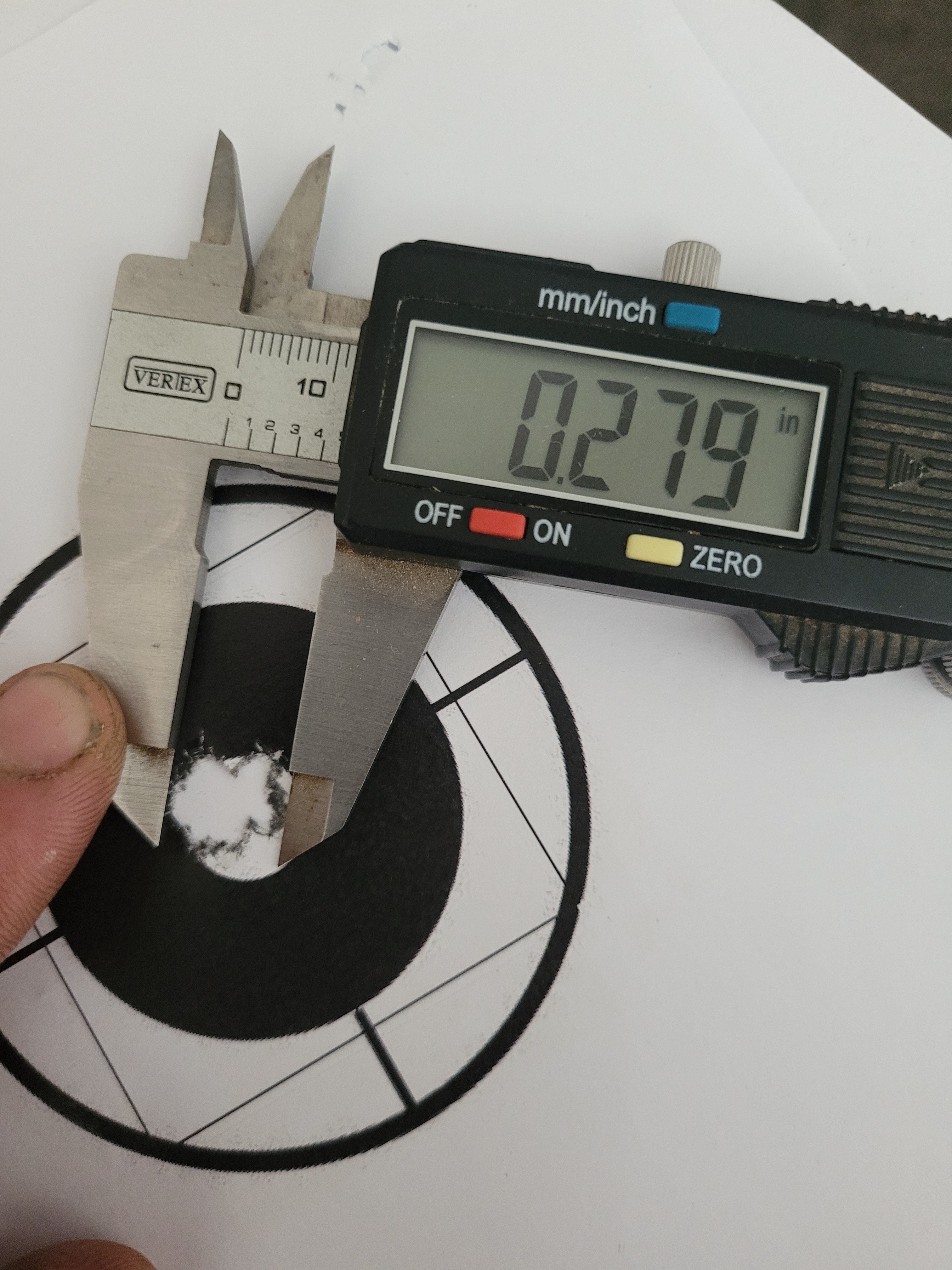

Took the T1x out to the range today for the first time in over a year. I was planning on stretching its legs a bit, but It was super windy so I just shot a couple groups at 50yds to check zero and make sure it is still awesome. Group likely would have been a touch tighter on a calm day. Lapua Ceter X
Yes, T1x is super accurate. In an indoor range, I get 0.25 MOA - 0.3 MOA 10 round groups on 50 yards using Center-X ammo with Tikka T1x. I get sub-MOA 10 round groups on 100 yards with Center-X or Eley Benchrest Precision. I was thinking of going with Rim-X setup, but I don't know that I'll get much better accuracy and Rim-X setup costs a lot more

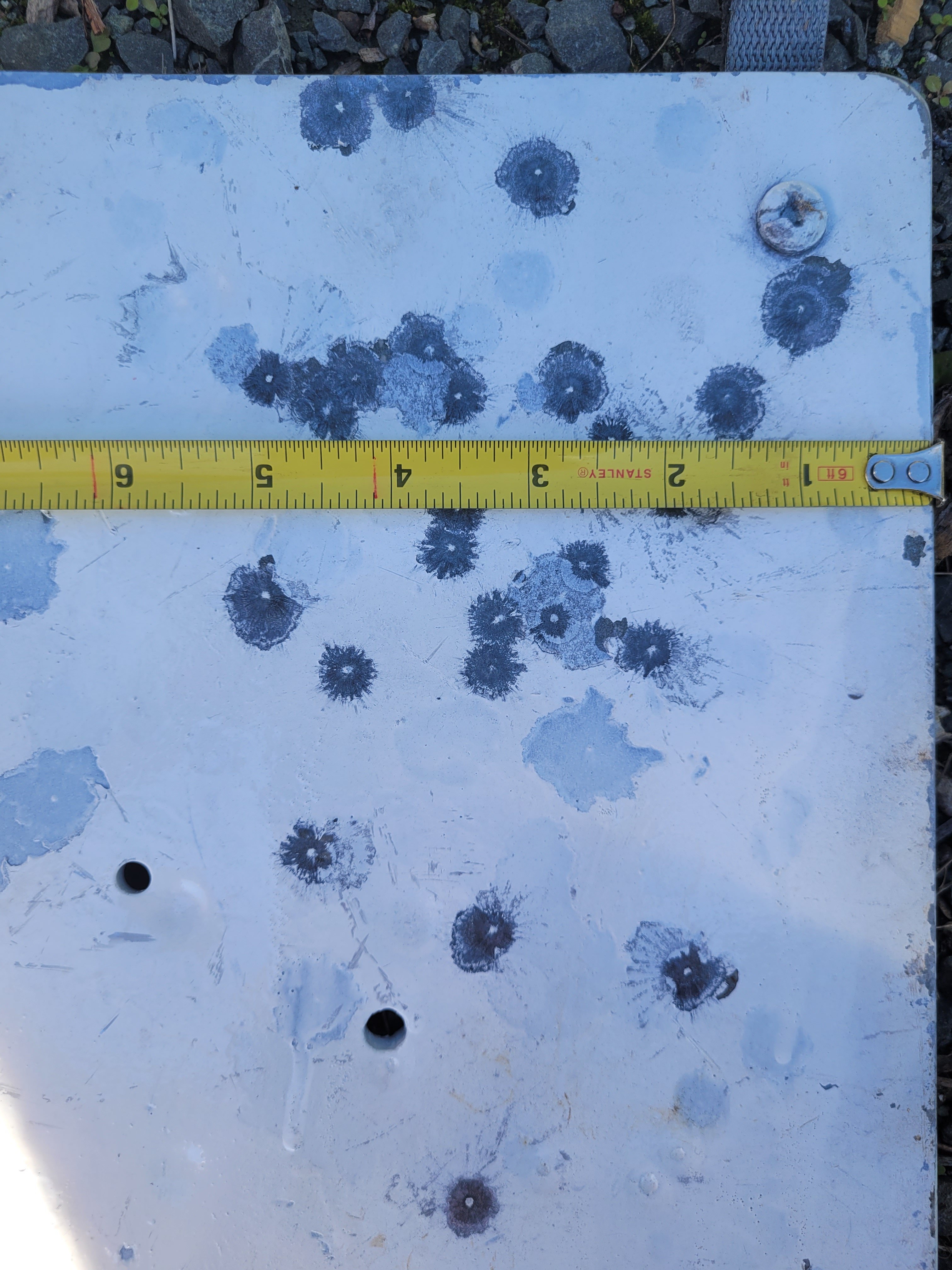

Stretched my T1x's legs out for the first time today. 10" steel at 250yds and 350yds. It was a bit windy. 250yds was hit conisitantly with a -38.75 MOA dialed on scope. 350yds was much more difficult. Wind seemed to have much more of an effect. Ran out out of scope adjustment at ~47 moa and need about a another 17 moa hold to get to aroujd -64 MOA. Yes, I know, make the move to mil. Ordered a MDT 40MOA scope base. Will re-zero and try again.

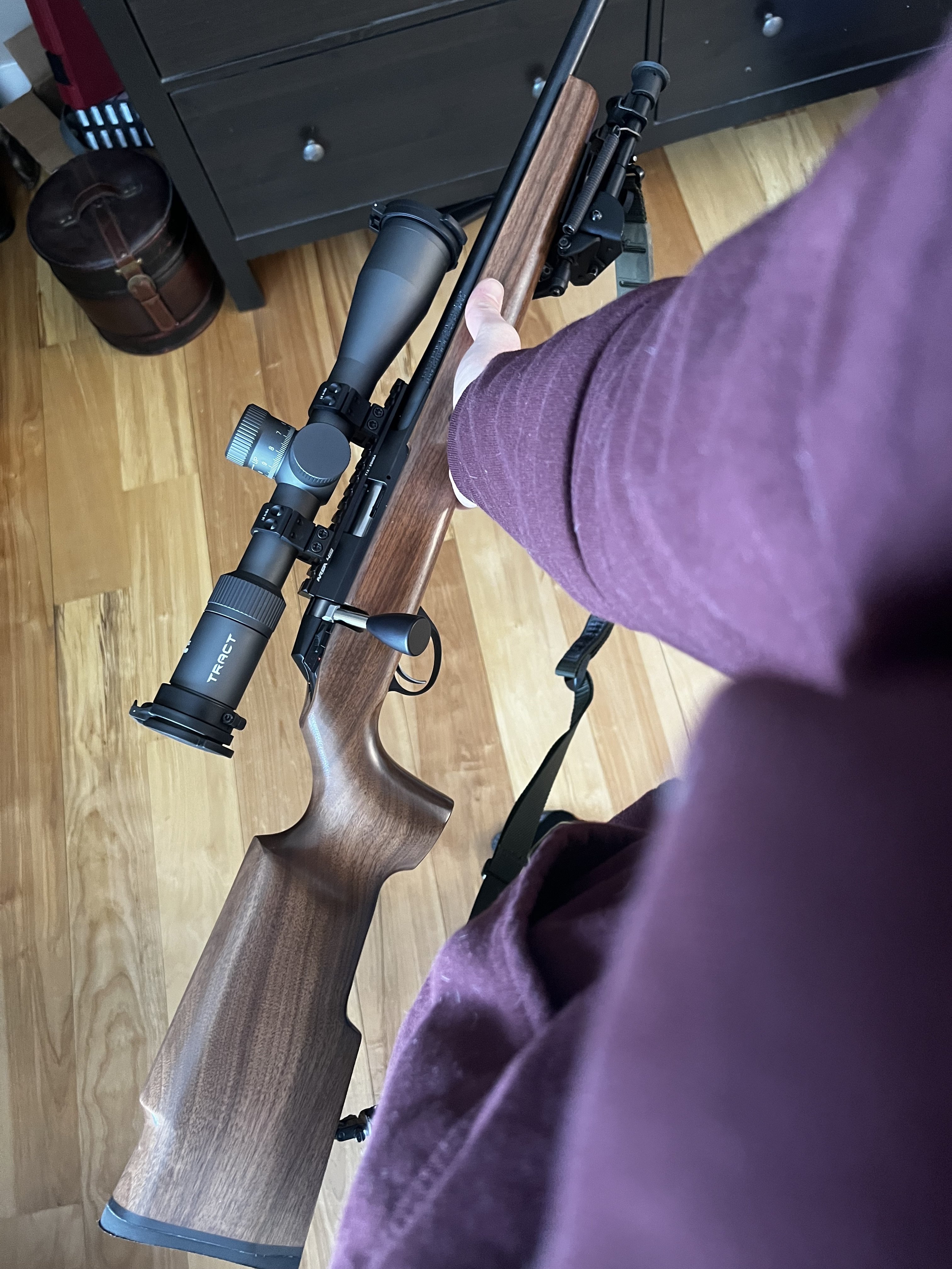

I've been quite happy with my T1x 22. Shot great out of the box and is just getting better. It could very well surpass my best CZ, we'll see. That's a pretty tall order but it is shooting better at this stage of it's life than any of my CZ's have at the same point.

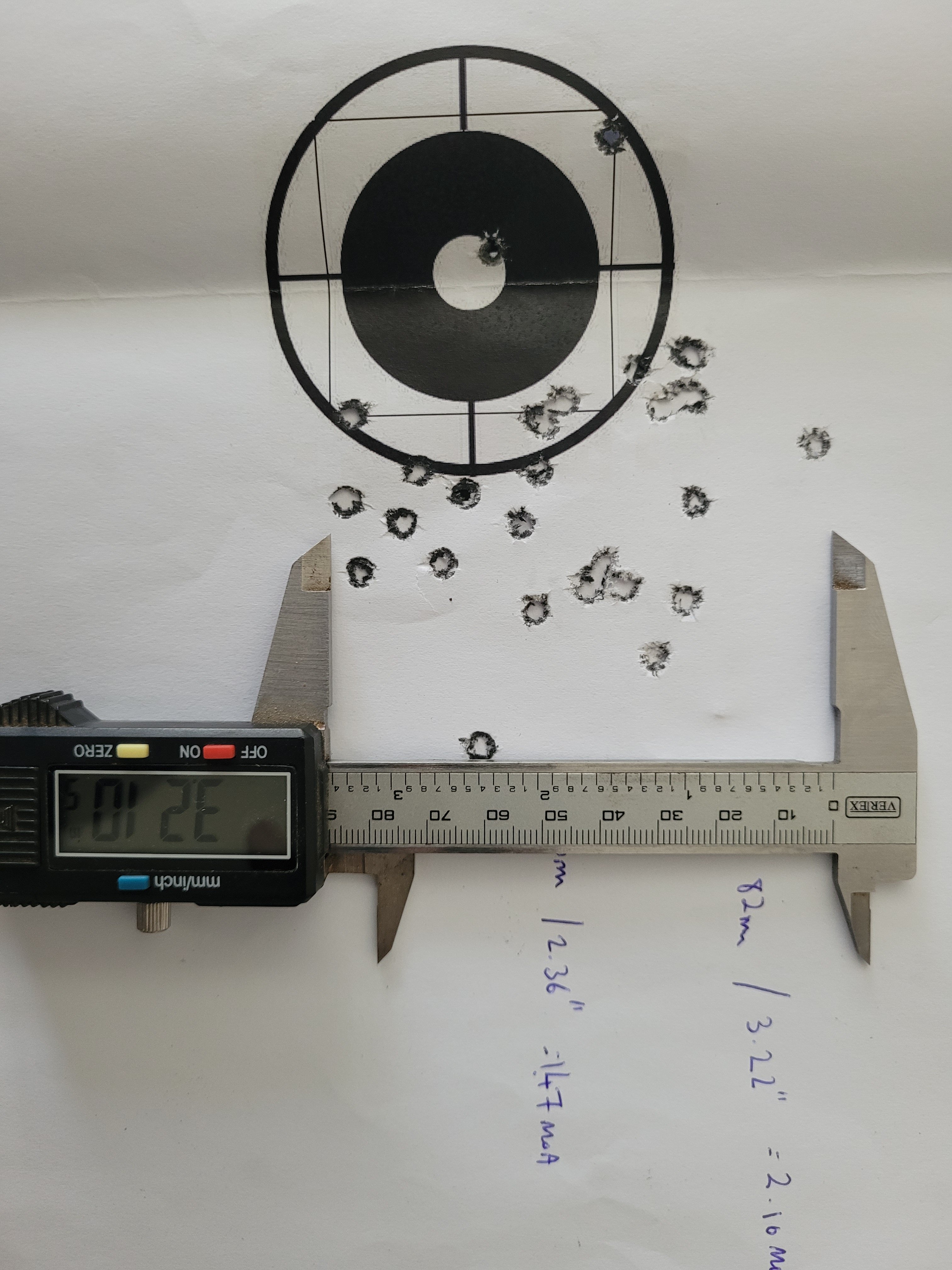

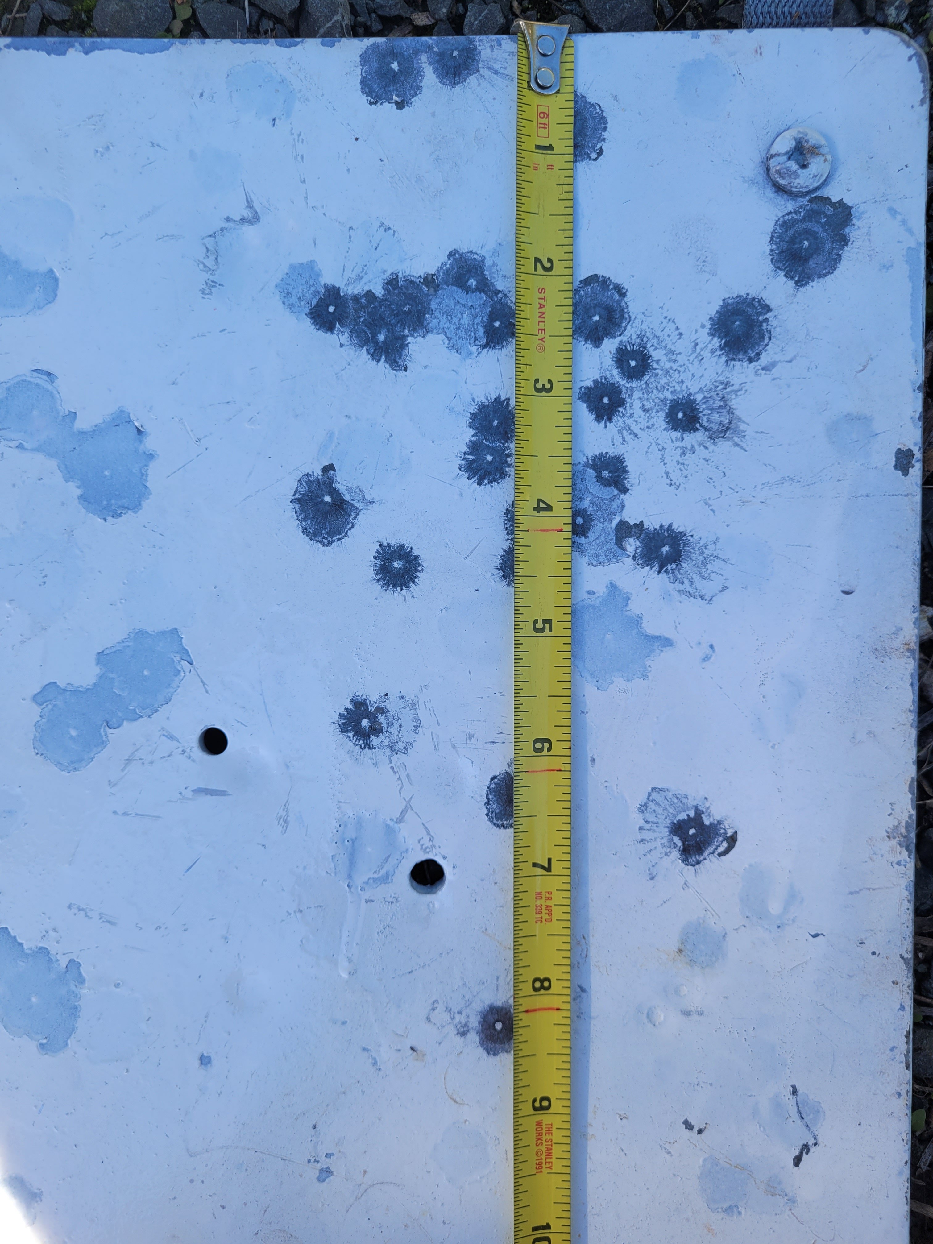

I have a brand new T1x here that I guess does have a slightly heavy bolt lift, definitely worse than my worn it Tikka with Sterk handle.
It’s the ammo, and perhaps the factory barrel. I had the same vertical spread with that level of ammo.
The ES of the ammo suggests a 7" tall group at 211m so 8-9" isn't bad with that in mind.
I've spent a lot of time recently testing different ammo/batches at distance and basically decided long range results are 100% ammo ES based.
Have seen it enough times now, groups much taller than they are wide, and more or less the exact height the ES calculates in Strelok.
Hoping to get hold of some R50 soon and will see how that goes.
Will zero and shoot groups at 30m and if the ES is good go straight out to 200m+.

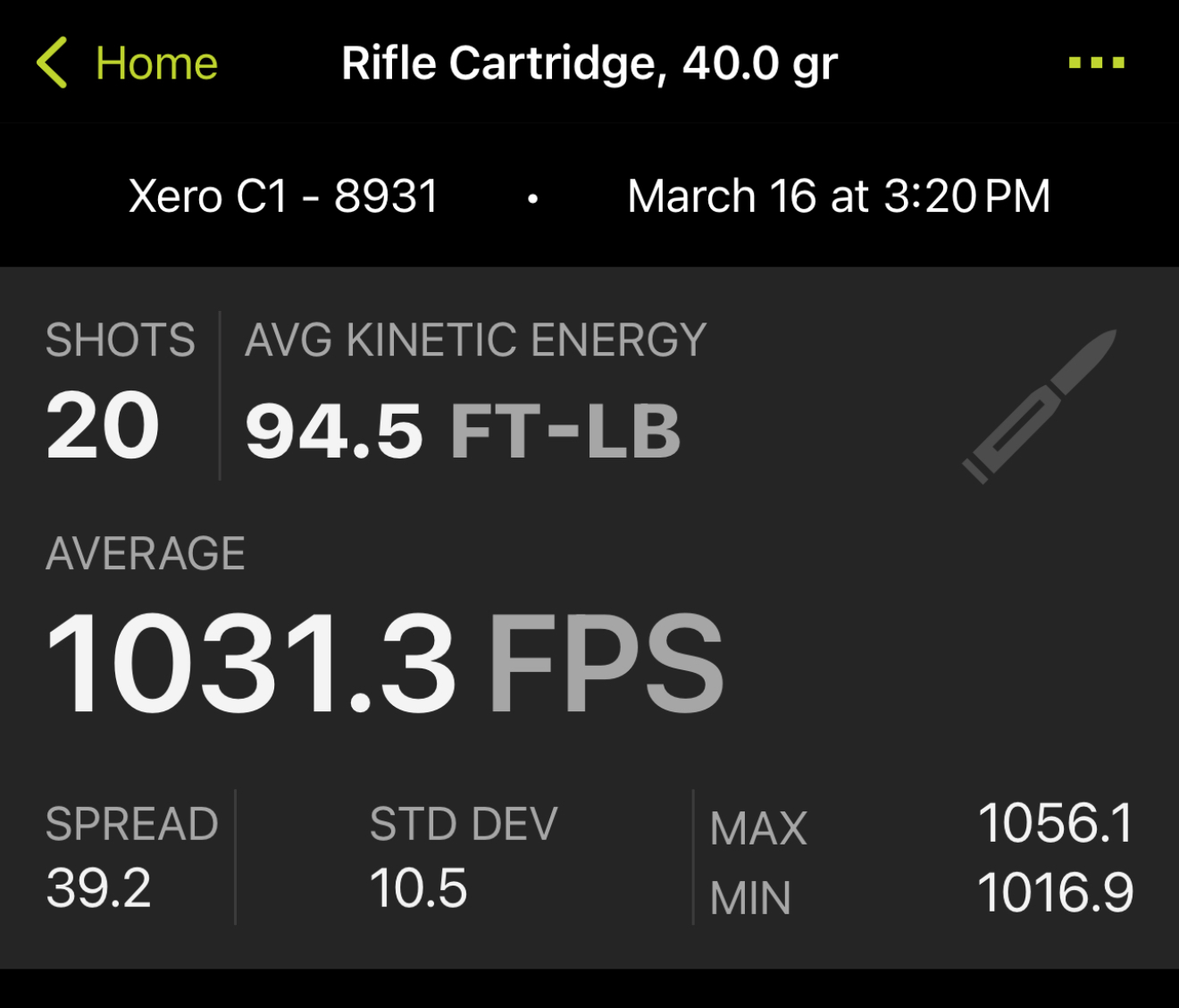

I must say the Garmin Xero has been a God send for 22lr.
It's nice not being driven crazy buy unexpected results, seeing high/low fliers on target and knowing it was the ammo not me takes away a lot of frustration.
Although chronying everything has made me realize just how bad some ammo is and just how much variability there can be between batches.
