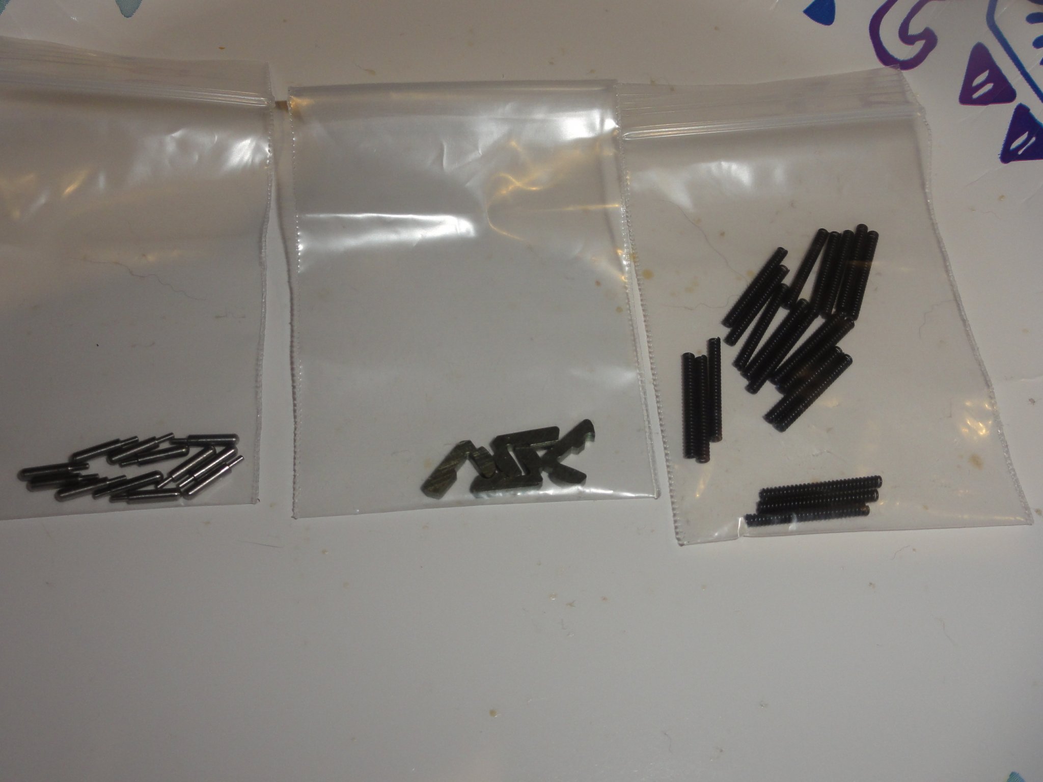

I have extra bolt parts just in case. They are also really inexpensive.
Shawn

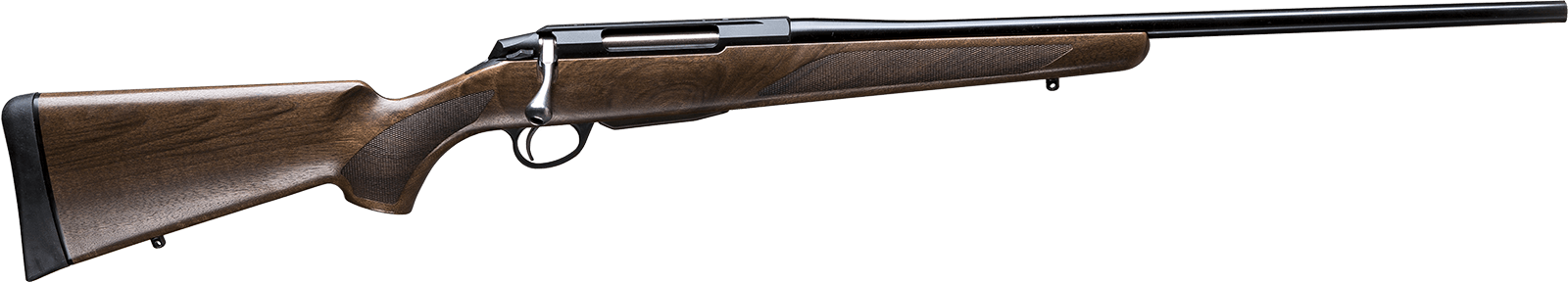

Tikka should call that thicc stock the “biathlon” model, not the sporter. Marketing dept was high on Finnish weed or something.
Below are the Tikka hunter and forest stocks. Pity there doesn’t seem to be a source for them, other than take-offs.

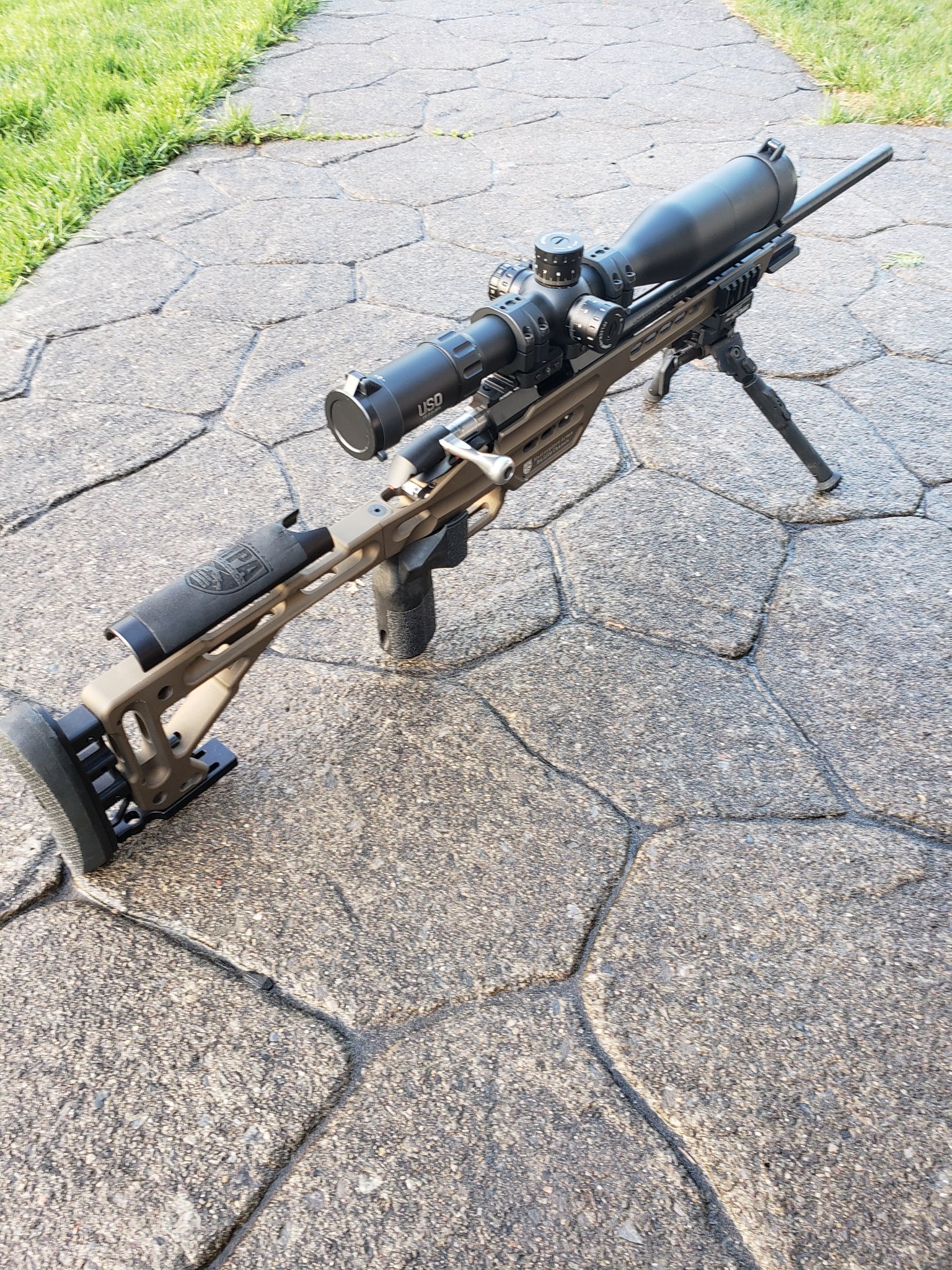

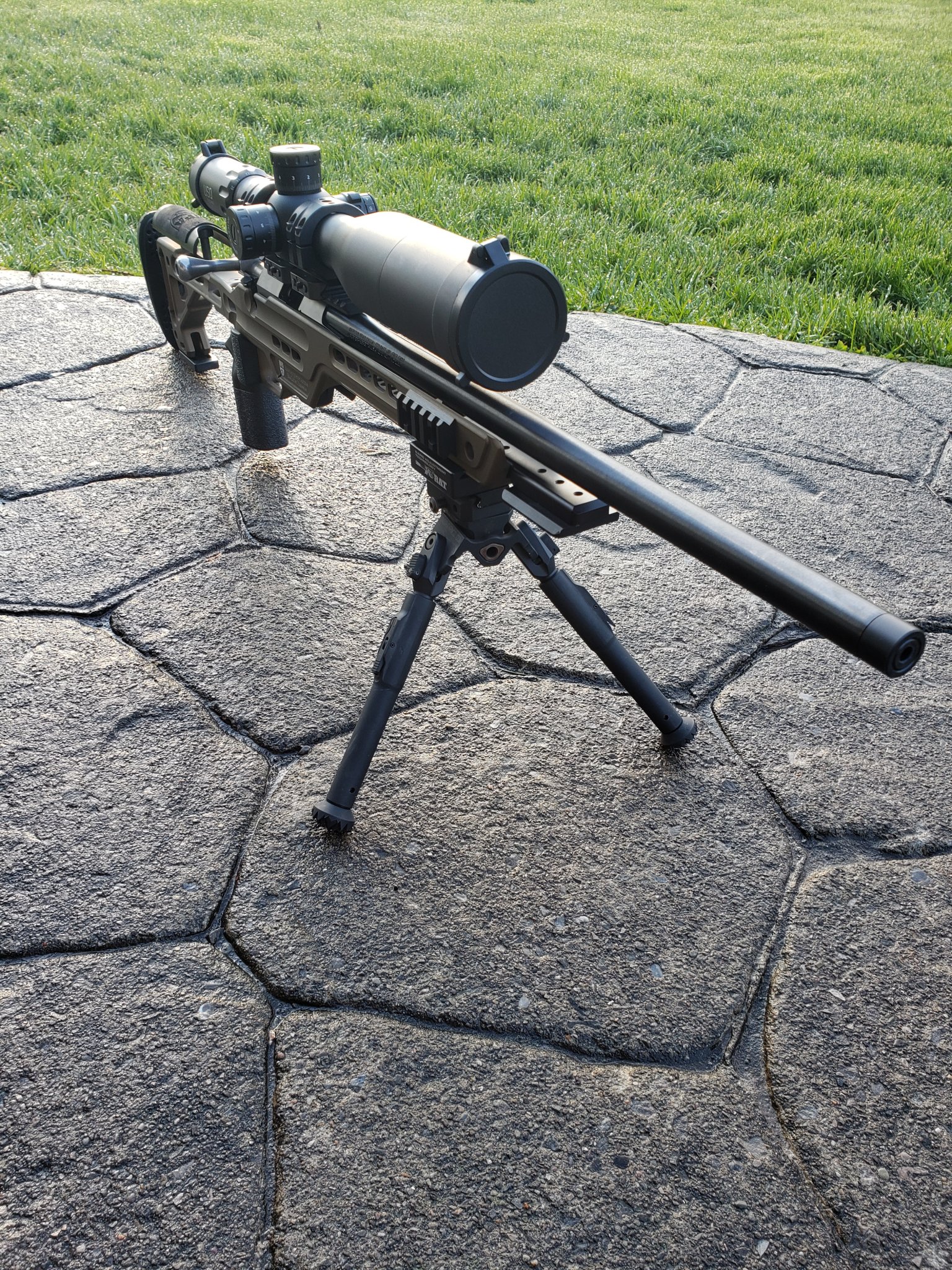

got the stock from my old T3 that I put in a chassis
here's the specs
T3x Sporter Stock
Tract Toric 4-20x50 UHD Scope with the PRS reticle
Spuhr 3001
Scope tape is Talon grip tape
Sterk wept bolt handle
APA little bastard brake
Henderson Precision 10" arca rail
MDT Ckyepod PRS legs, with a RRS SC-LR
The T1x will fit most any T3 stock as long as its designed for the factory single stack DBM. I have my T1x in a GRS sporter stock, and it's awesome. I've also fit it into the Mcmillan A3 that I had, a McMillan A6 that I have, and a Manners T6. They all fit nicely and make for a 22lr that fits way more like my full match rifles. The chassis rifles I know less about, as they're all set up for the AICS mags, so they may need some fitting.

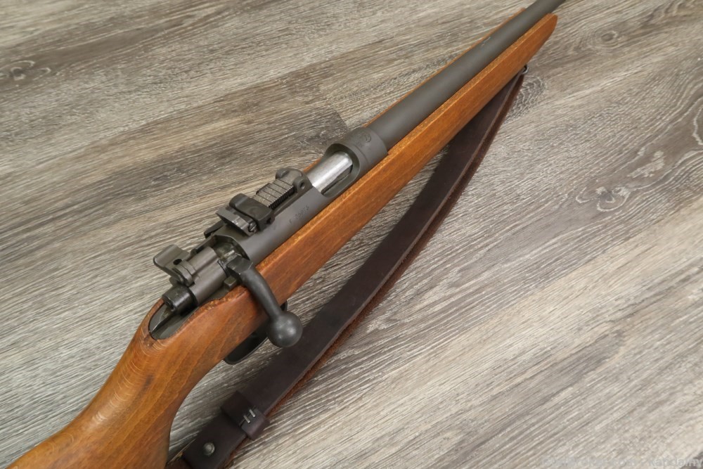

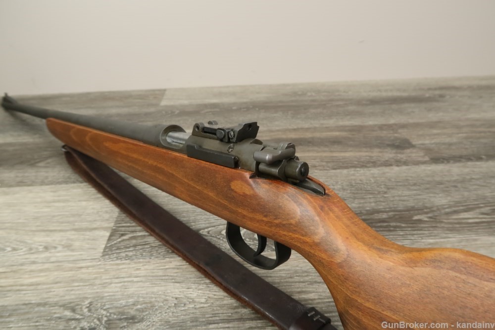

MM,
The last thing I need is another .22 bolt gun but when I look at your Tikka, I can hardly stop myself. What kind of pull weight have you been able to get? I hope MGW still has the stocks up until June. Who has been your best after market parts source? I'm thinking that I need to sell my 45-70 to help fund my second Vudoo. Other than shooting her with the .22 insert, I just never shoot her. :-(
Do you happen to know anything about the Lithgow 1o1A. I'm drawn to the rear lug bolt design. Don't know why, but it just strikes me as cool. btw.... SK seems to work well in all of my guns but have nothing that likes Wolf. I plan to get a case each of SK long range and rifle match and one of Center X next month after the house sells. I have gotten below 6 bricks each and it makes me feel very uneasy.
I picked up this MAS 45 recently and she is a hoot. I decided to broaden my collection to include military trainers. It turns out that she is surprisingly accurate therefor I'm having a base made for her. I better start a new thread for that.
Shawn

MM,
Shawn
