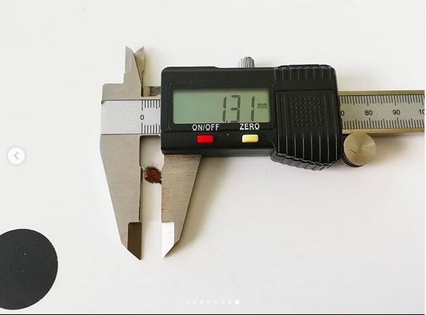

Went to a gun range and test shot my new load.
123gr Scenar with N150.
S..T, that these Krieger barrels are stunning accuracy.
0,171 MOA 5-shots 100-meters.
11,69mm - bullet 6,71mm = 4,98mm equal as 1,71 MOA.
Best group i have ever shot.
Only my Tikka 223rem has given even tighter group with Hornady ELD-M 52gr bullet, that was just one hole, that was tight, 1,31mm.

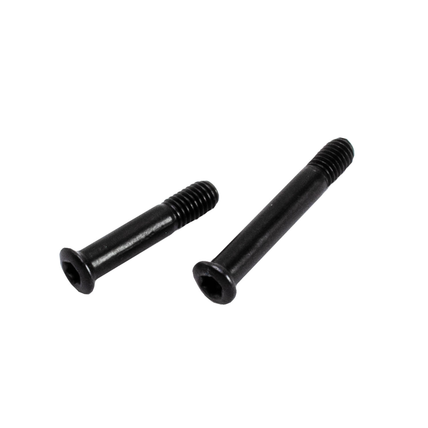

Does anyone know where to get Tikka T3x action screws at a decent price? Cheapest I can find is $27. Which is crazy for 2 screws. Would also buy used if someone has a set they have taken off.
Do you already have a set? I would take them to a hardware store and match them. If you don't I could do that for you today or tomorrow.
I just went through this with trigger pins for my Vudoo. I couldn't even find them on Brownells. Found them on a small companys website for $12. They were discounted 50% from $24 and shipping was $9. I just made a set from 1/8" drill bit shanks.
No, I don't have the originals. I bought a Bravo stock for it which has it's own screws and I sold my OEM stock with the screws. Now I have a Mcmillan ordered and need screws again. Ideally, I could buy a set from someone else with a Bravo stock but I haven't been getting much action on the PX so will probably need to buy a set.

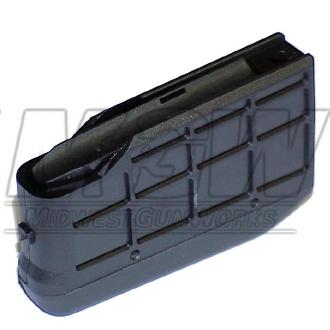

Now point me at the M+ magazines for the 6.5 CM (flush fit). About the only one that I saw that carried them was direct from Tikka. As popular as the 6.5 CM is, I'm surprised that more places don't carry them as they are perfect for long hand loads. The extended 5 round mags are easy to find but not the flush fit. Guess they think that everyone needs 5 rounds to harvest one deer :)
This one?
This one?
That's the mag but they don't carry the M+ version which is part number S58569827 and allows a longer COAL while still using a medium bolt stop. If you go with a long mag, I think you would also have to swap out your bolt stop otherwise if you had your cartridges too far back, it might not pick them up.

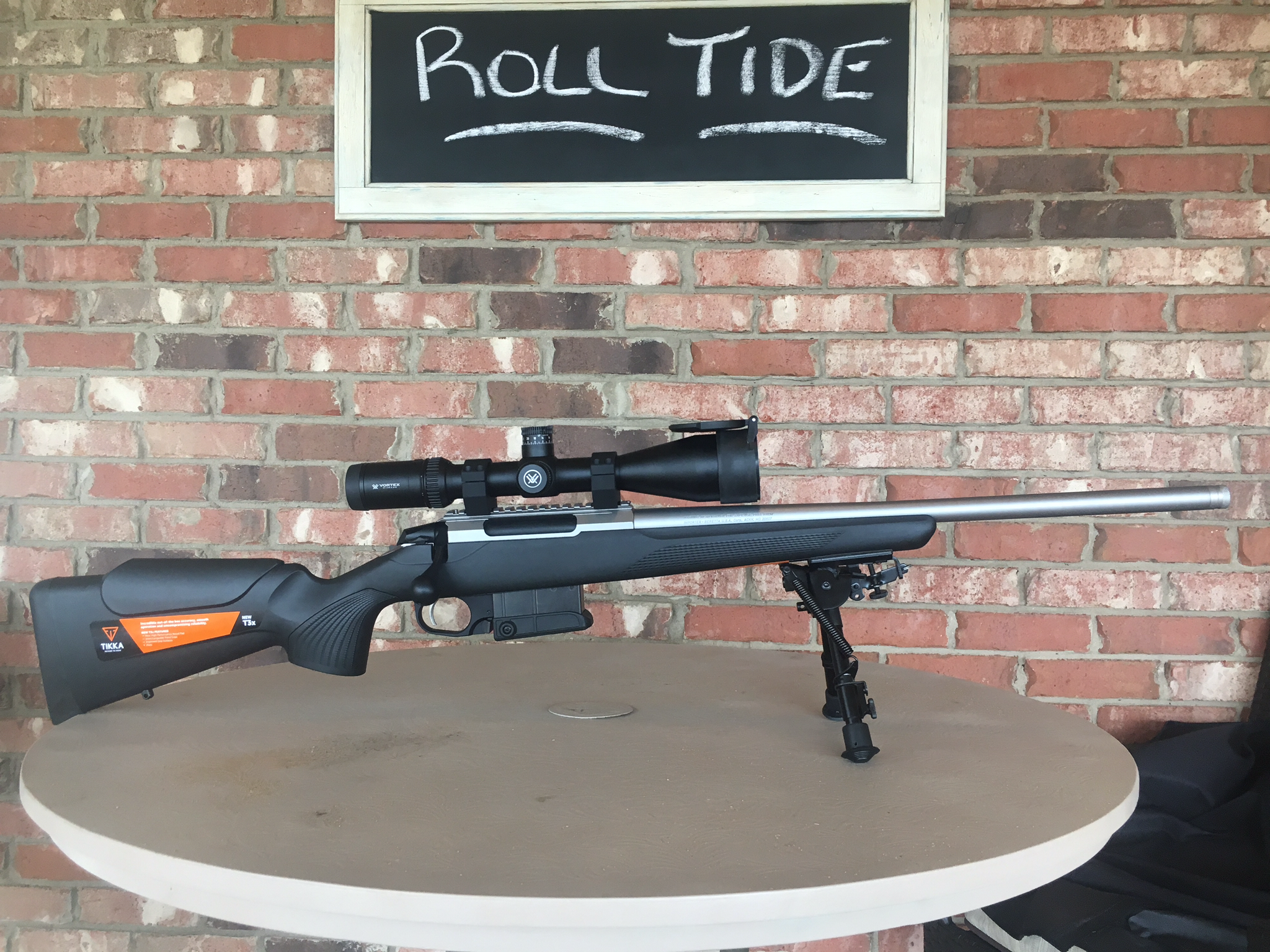

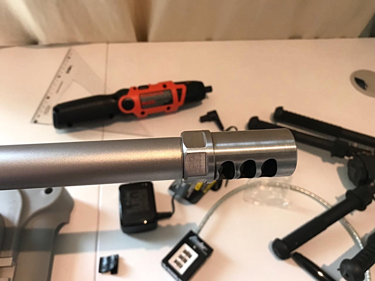

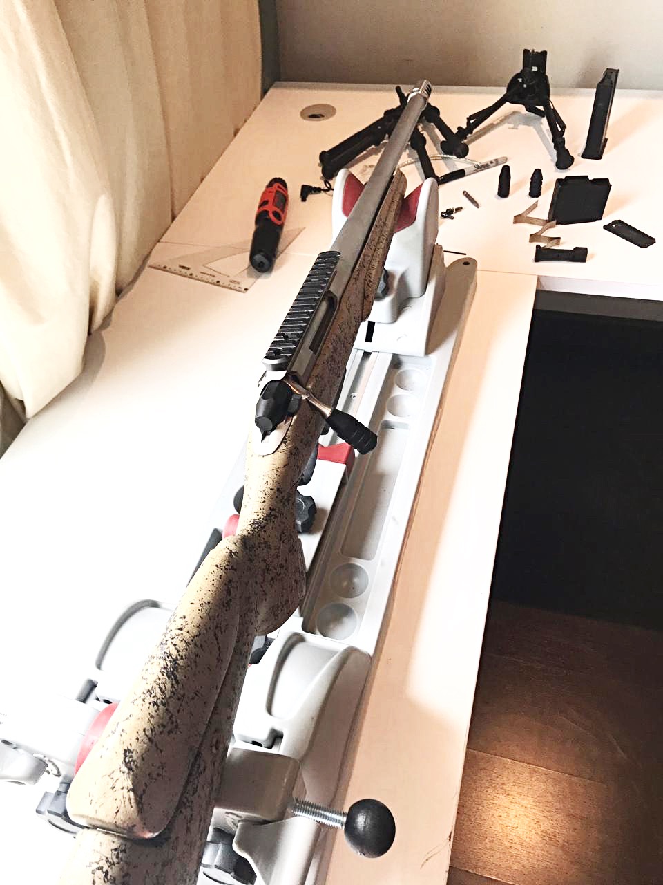

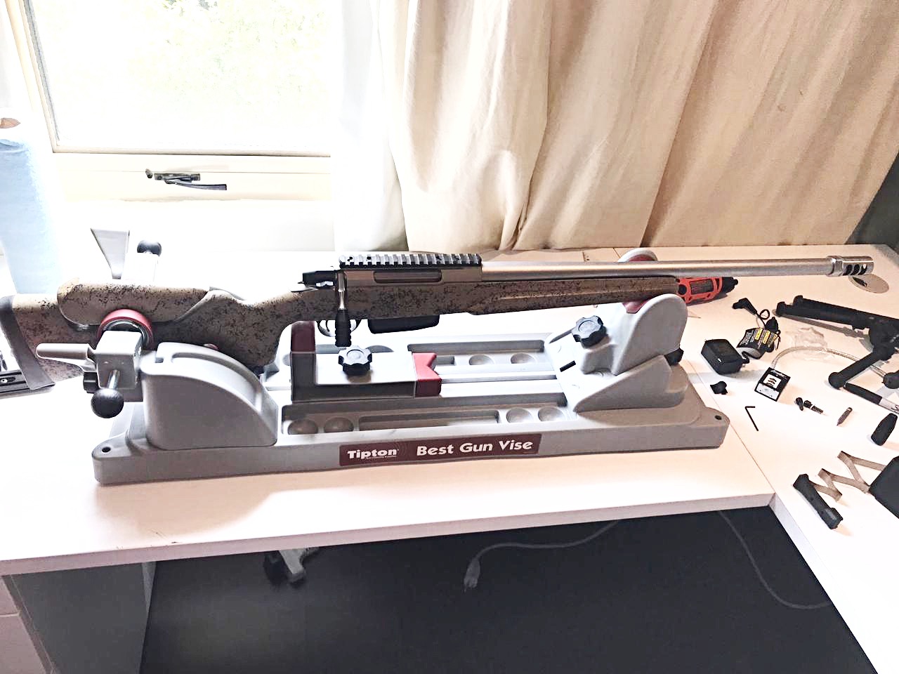

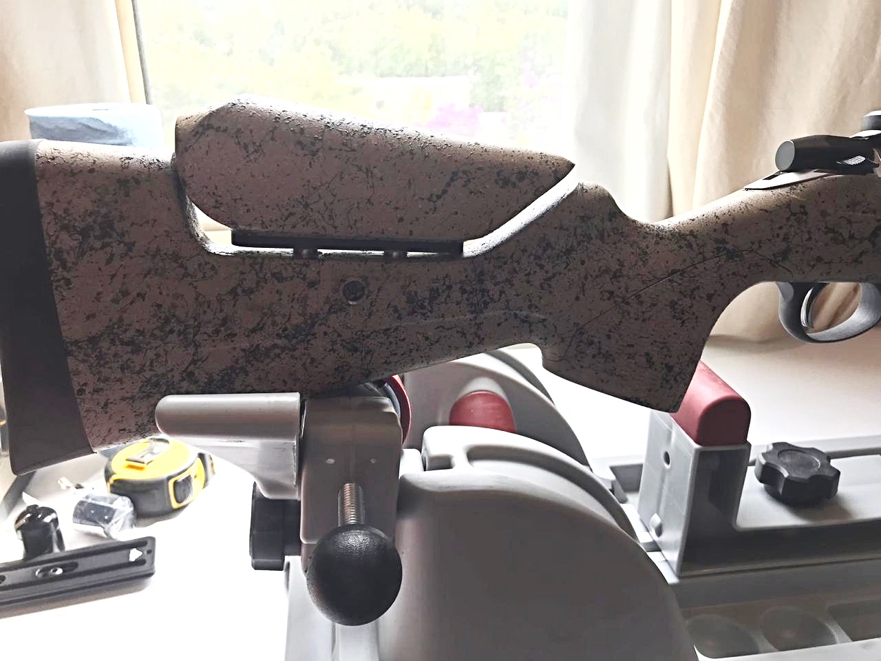

Just Got this one!! T3X Varmint Stainless, added adjustable cheekpiece, little bastard break, SS pillars, Devcon bedding, bolt handle, Vortex Viper PST II

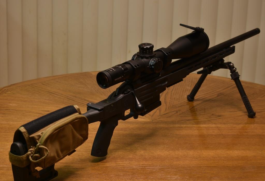

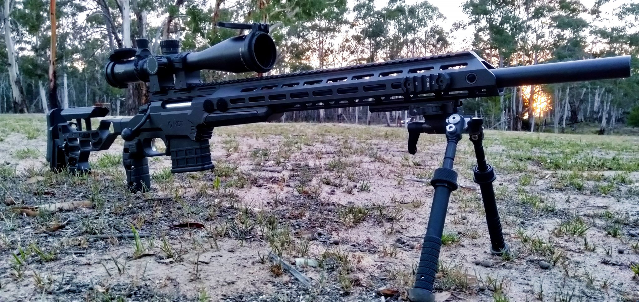

I think I need one of those bag riders for my Tac A1!

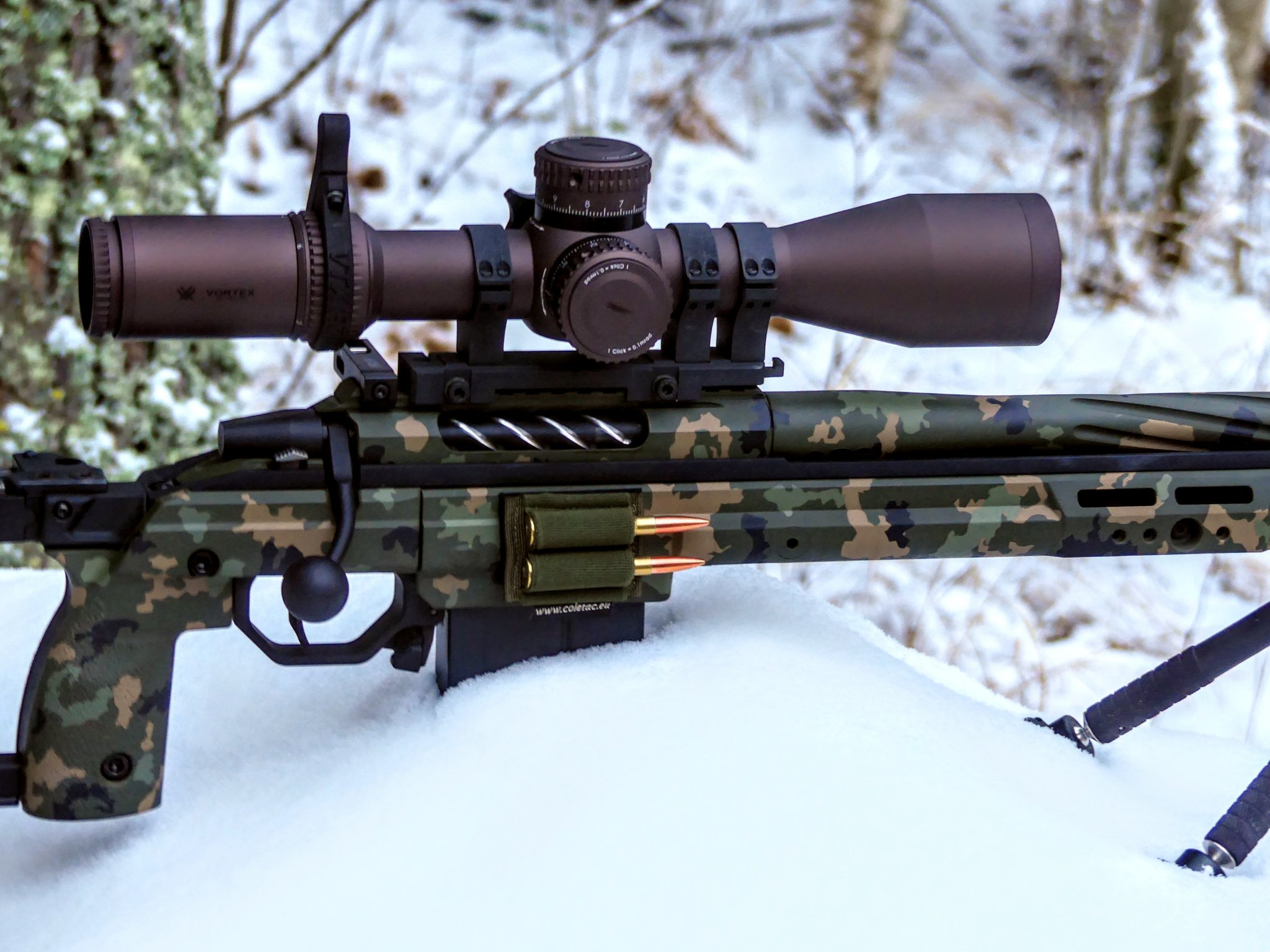

How do you like it compared to the Kahles?
First shots yesterday.
Quick look and thoughts, that in my opinion it has brighter glass than K624i Kahles, even my Kahles is the last 624i generation.
Need to do mo testing, but first impression is very nice.
Though it is a bit heavy, but so is the rifle, so no complaining.

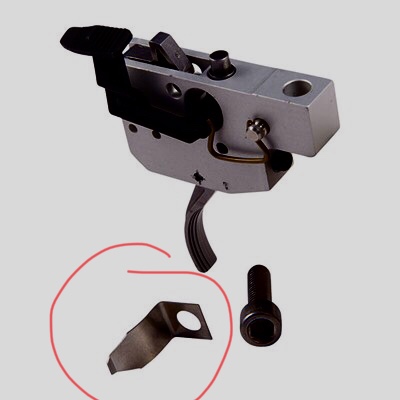

I’m In need of a magazine tension spring that mounts to the trigger assembly. I’m converting my CTR to use the standard T3 plastic mags. if anyone has one left over from your chassis builds, I sure could use one. I’ll be happy to pay. Thanks in advance.

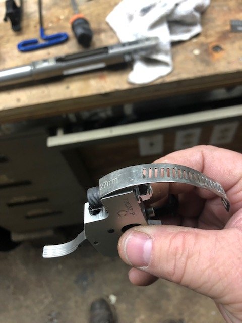

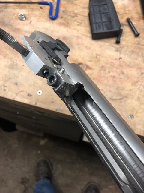

There’s a post somewhere in this thread wherein somebody used a 27mm Pipe Clamp.
