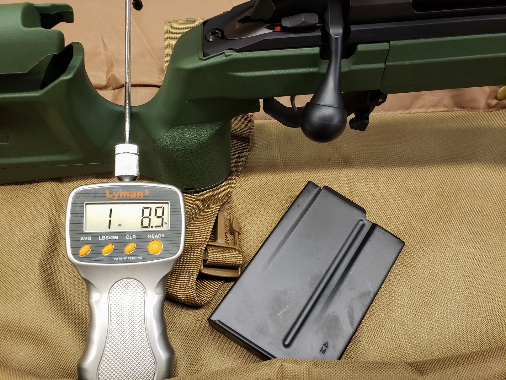

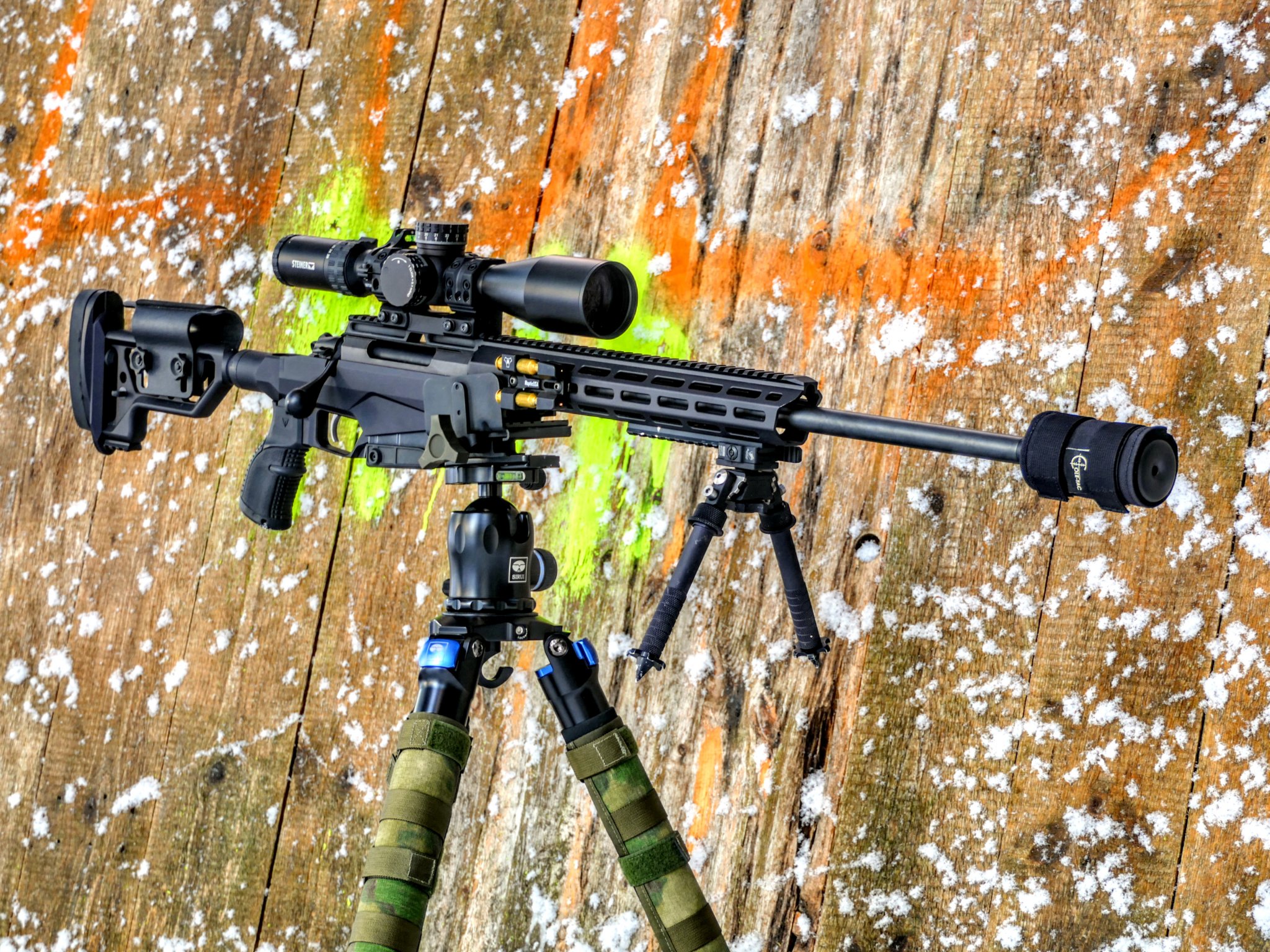

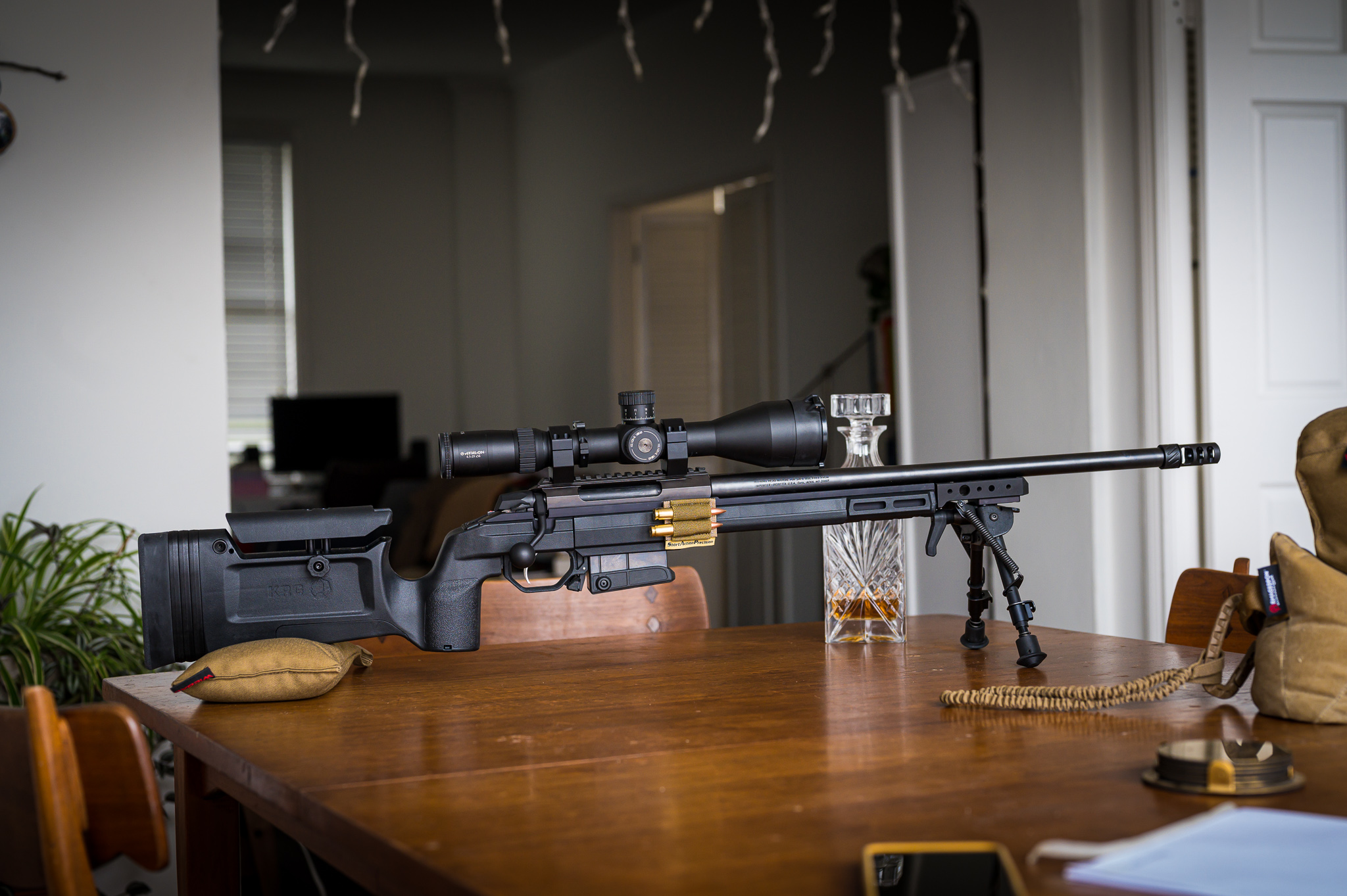

I've been hella impressed with my CTR so far! I adjusted the stock trigger to it's lightest setting, and it's felt like a real nice aftermarket trigger ever since. Zero creep, and a clean, crisp break! I brought her by my LGS to see where it was, and was stoked to see it breaking very consistently!!
where did you get that mlok quiver?
It´s a HopticUSA 2-ammo billet quiver.
How do you like your Bravo chassis? Any feeding issues? I am waiting for MDT to release their new stock/chassis then I will decide between the two. Thanks

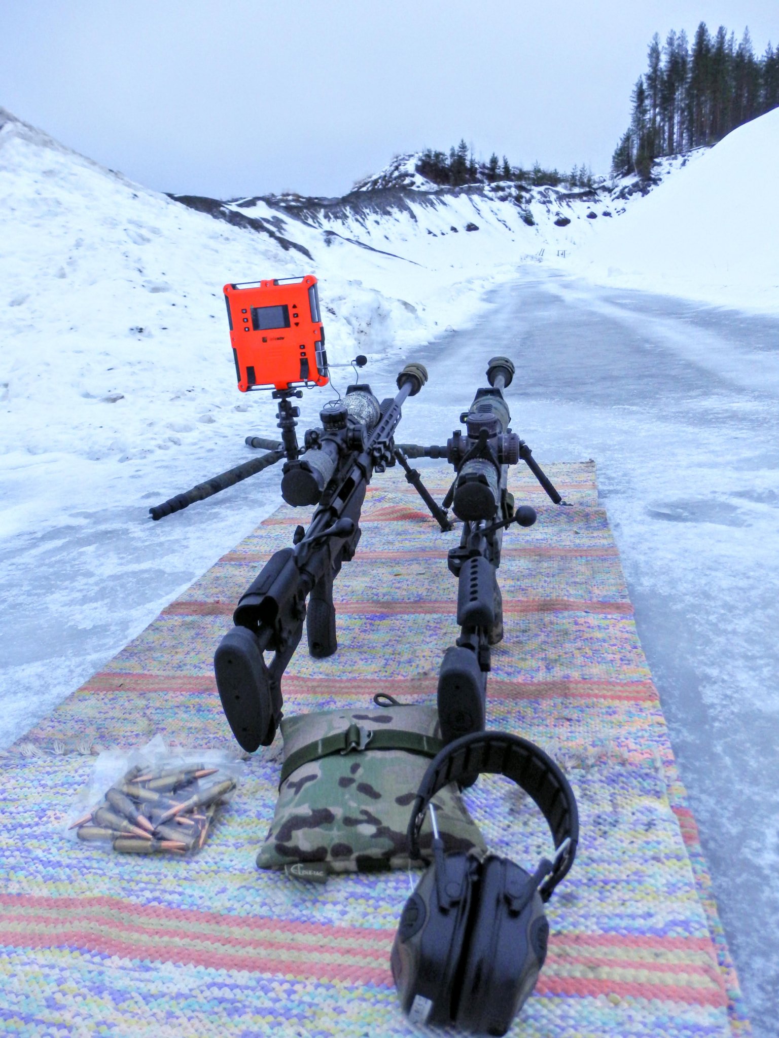

Custom barrel is custom barrel.
Krieger 1/8 twist 24" barrel is about 66 f/s faster than Tikka T3X TAC A1 24" 1/8 twist barrel.
Lapua 123gr Scenar Vihtavuori N150 38,6gr.
Krieger 876,8 m/s 5 shot average.
Tikka TAC A1 857 m/s.
1 meter =
3.2808399 feet
Both rigs had same size and model Ase Utra Sl5i suppressors.

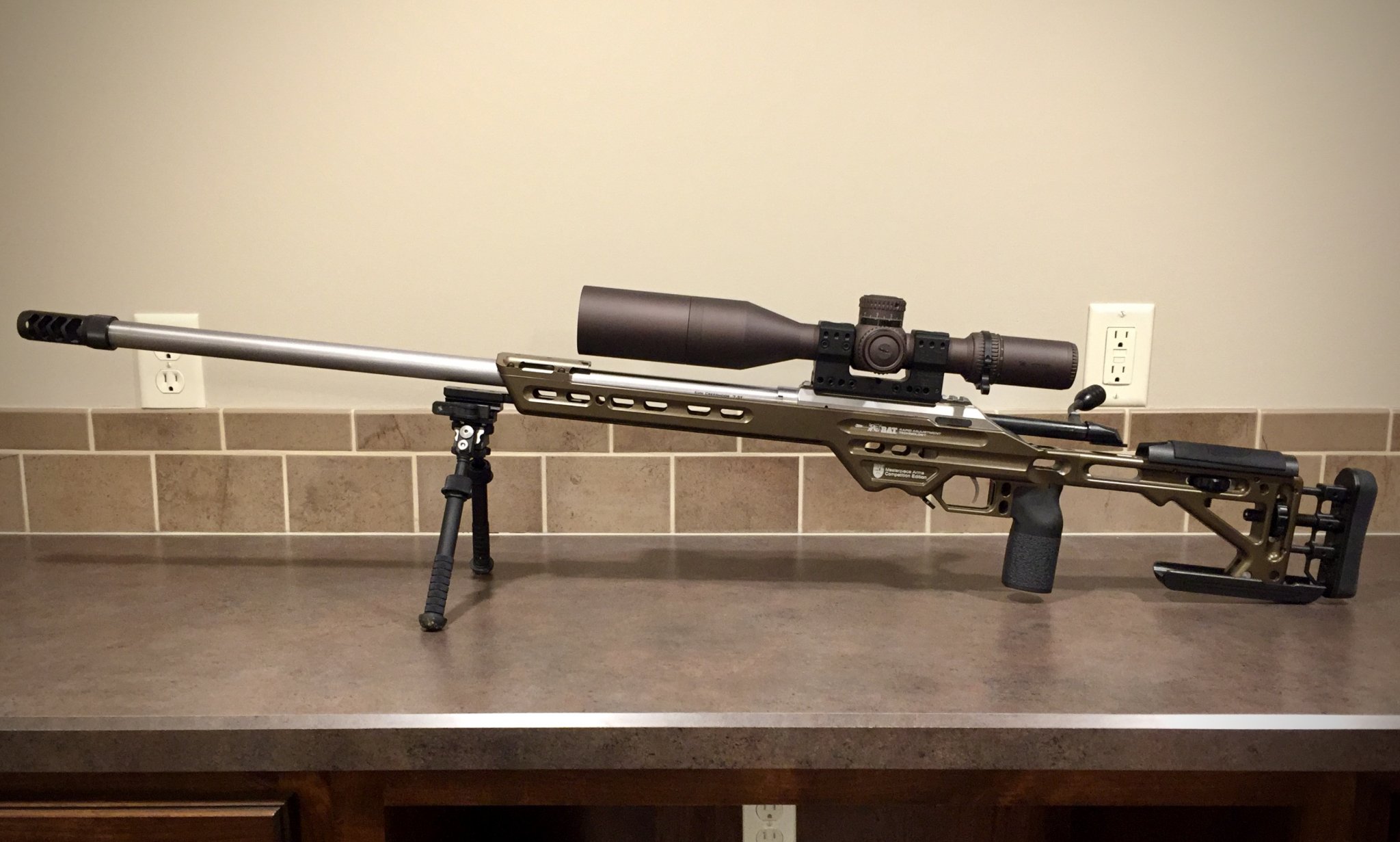

I just switched from the factory Tikka CTR stock to the Bravo and it is a significant improvement in the ergonomics department. As far as the XRS is concerned (just based off the marketing imagery), it could be quite a bit spendier than the Bravo. From an aesthetic standpoint... well, I think the Bravo is the clear winner in that department.
And you are still using the factory magazine with it?
How does that fit?

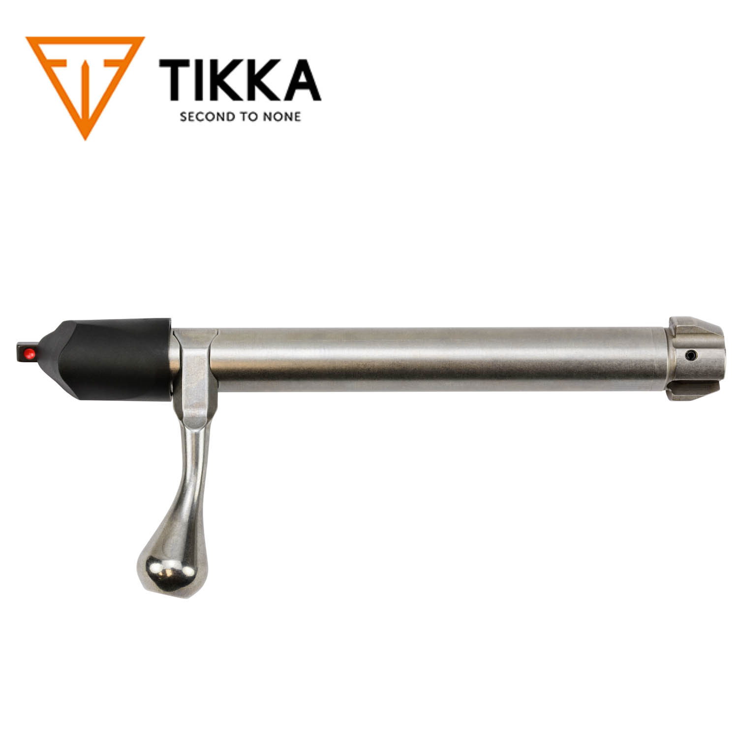

I purchased a T3 off this site for $400, took the bolt out and then sold the rest of the rifle as is for $200.
But if it were between an Origin and a T3 I'd have to go Origin. Bolt faces are available in everything. You can use a Hunts LR recoil lug and get all the TL3 prefits. Multitude of triggers. And then after you add a pic rail, upgrade the shroud and Handle you're looking at close to $700 for an action. Assuming you find a $400 donor rifle.
I'm not sure I follow through. You mention the better option is an Origin. You also mention I am looking at close to $700 for an action if I find a $400 donor.
There was a 50% off bighorn certificate that got sold here recently which I was going to buy. I started researching what a prefit, stock, trigger, would come out to for a complete rifle cost to me in order to see if it was some thing I wanted to buy. During my research, the certificate sold to someone else. I think I was going to be at about $700 for the origin action after I paid for and used the cert. Other than though, not sure what you mean I can get an Origin for $700. And if I do find one at that price, why would I need a donor?
Sorry, I don't mean to sound rude or sarcastic. If I do, I just really don't understand what you mean.
Ideally though, this build that I have the itch for, is just some thing budget friendly that I'm looking to do. I don't want a tricked out boom stick with a manners stock, some high end up piece of glass, etc. Just looking for a decent varminting, fun to mess around with rifle. But I'm also not a dumbass to let a good deal go by lol. That bighorn does sound good if I can get a great deal!
I was replying to both of you. You were asking about buying a 223 bolt. And both of you were remarking how expensive buying a bolt is. I presented to you an option.
You can get Origins from Brownells during one of their twice a month 10% sales. Comes out something like $745.
The$700 was adding up all the Tikka upgrades.
Makes more sense now, thanks for clearing that up. Yeah, I guess I'll have to keep an eye out and look for deals.

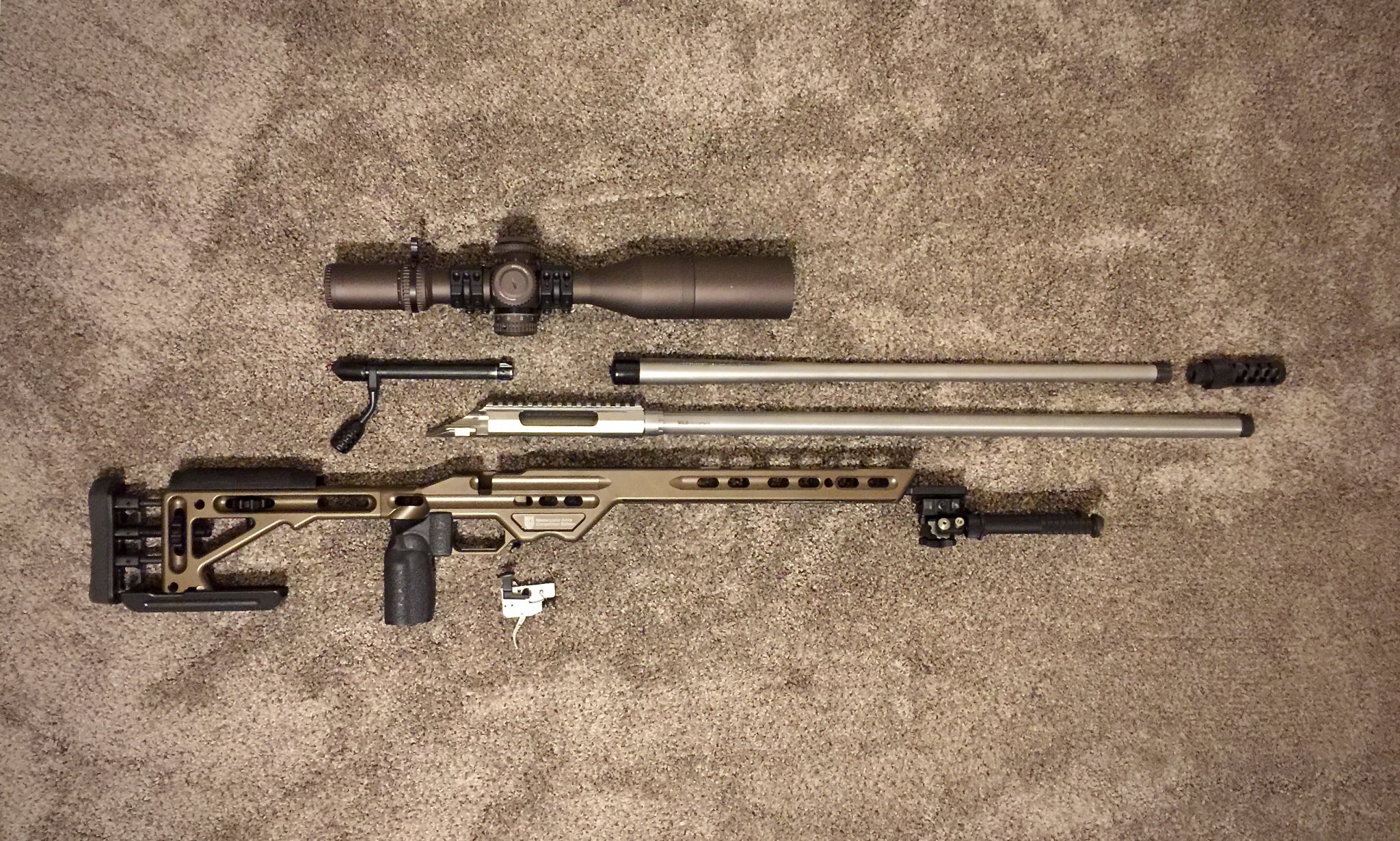

I need some help on my Tikka build. I'm planning on a Proof Sendero in 7SAUM in a KRG Bravo. Scope will be a Leupold Mark5HD in either 3-18x44 or the 5.5-25x50. Do I need a 20moa base to say shoot 1500 yards or so? Which height rings? Anybody done something similar or have a similar setup? Also if someone has a base for sale I'm looking. Thanks
@reubenski
Thanks for that cost analysis summary. Seems like the Origin is a better choice for the long term game whereas the Tikka CTR is better if you need a rifle RIGHT NOW.

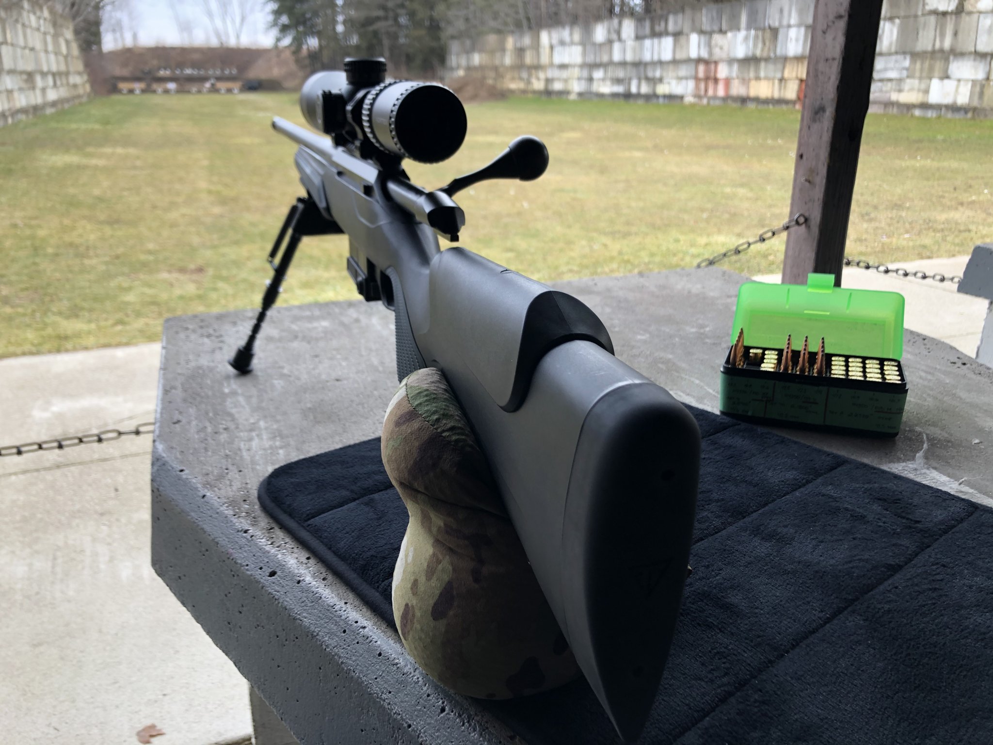

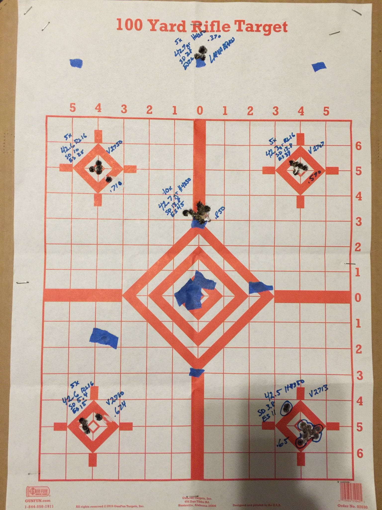

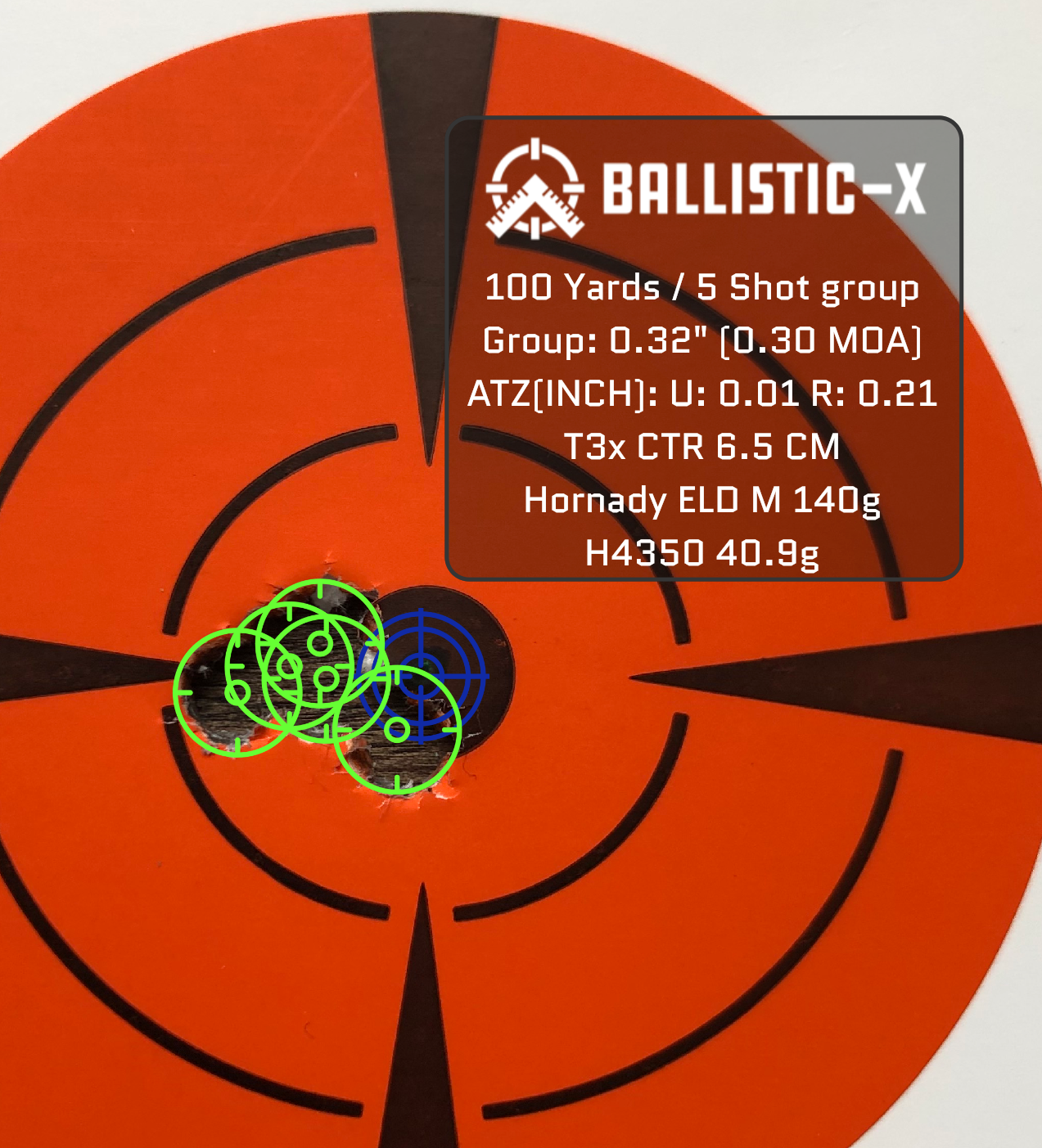

Well, my new T3x CTR in 6.5 Creedmoor can shoot! Finally got to the range with various charges and bullets under H4350. I’m pretty please :)
I plan to dial it in further next week. Shooting off a Harris bipod and rear bag.
