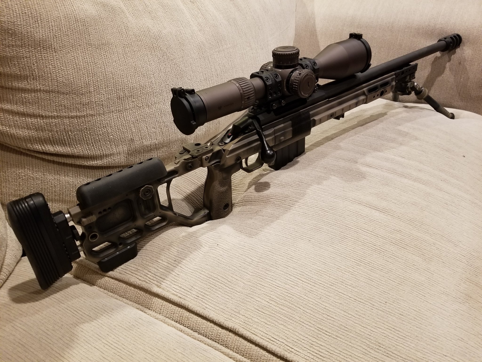

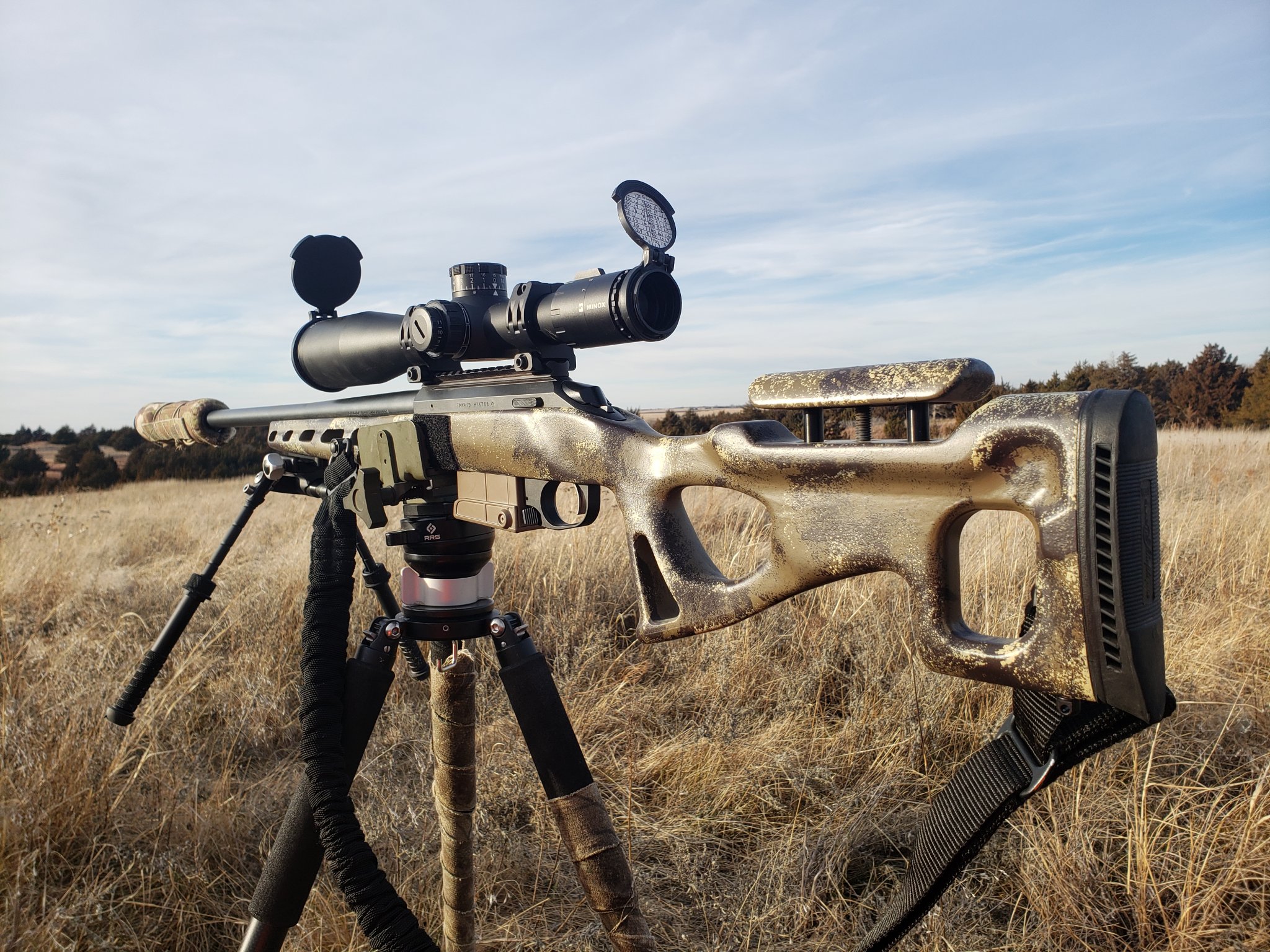

Well, there she is. 7.6 lbs of questionable life choices. I bought a new cantilever mount for the AR wearing that Trijicon and thought “Well, if it’s gotta come out of the mount anyway, might as well get some rounds out of the new Tikka.” No cheek weld to speak of, but plenty of eye relief. I’ve got a feeling I’m gonna be looking forward to adding another pound of scope** and rings when they arrive, as well as my limb saver, once I get it out. My ammo arrived today for testing, too...
**I did call Doug at CameralandNY and bought something reasonable. I tried local first because I like supporting LGS when I can if they merit. I found a store that at least had a PST 2 in stock and might have decent selection under more normal circumstances...however, $999 wasn't gonna get me to bite.
ETA2: the first range outing was “OK.” I made it through a box of Barnes LRX w/ no more than mild discomfort. No groups to brag on - maybe next time. The LRX stabilizes with no issue, seemingly, so there’s that. Now, the vintage .300 Wby that I fired is another story - the first and only time I’ve had a scope bite me; nowhere near enough eye relief for me, should have seen it coming. I did do some cleaning on the range, but I’m gonna let it sit for now...no appreciable copper fouling to be seen atm.

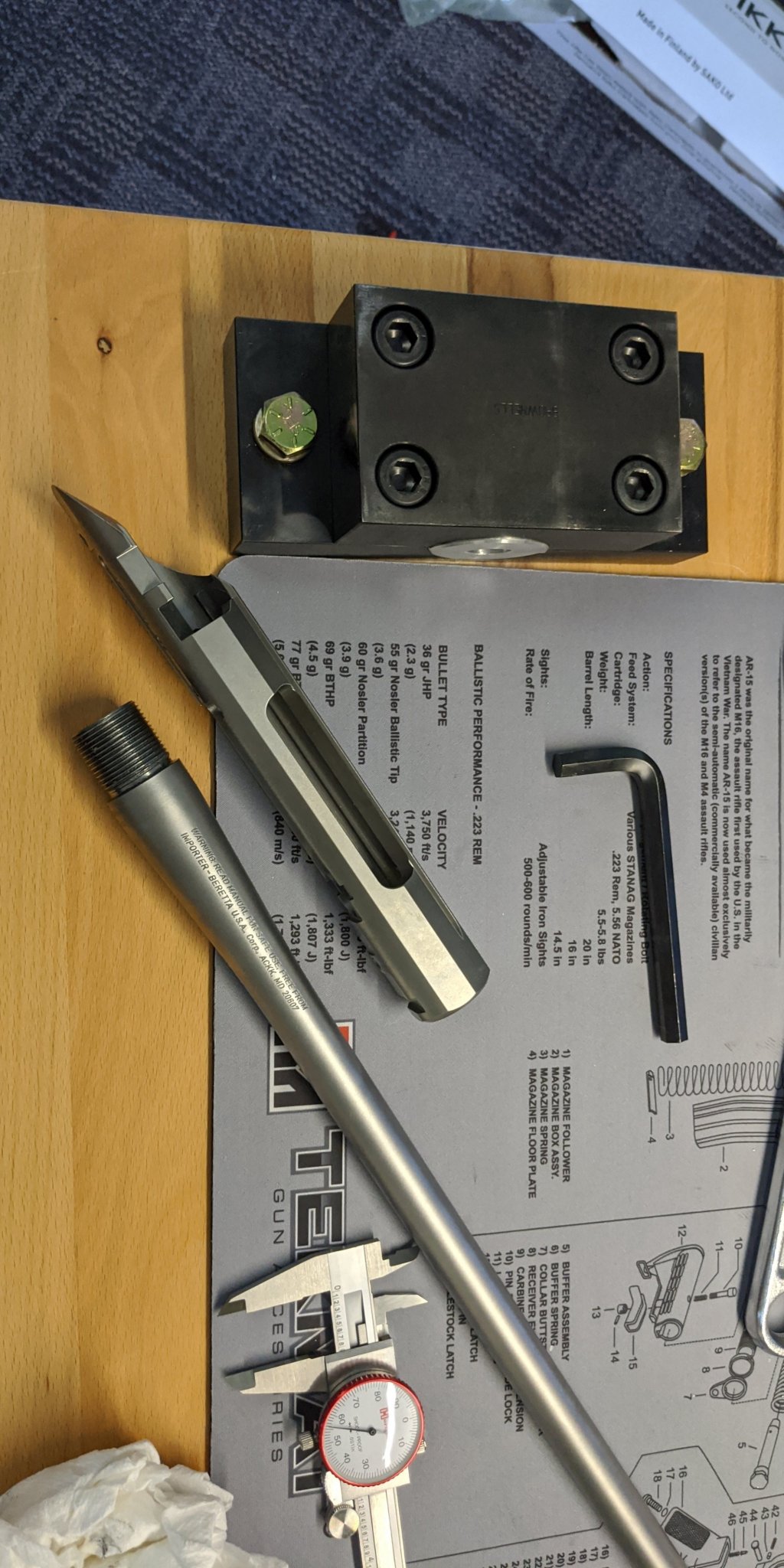

I just removed the factory barrel from my CTR action. It took 5 different tries but in the end the successful combo was a barrel vice clamped in a vice bolted to a 4’x8’ steel work table and an external action wrench with 2’ handle. I soaked in in liquid wrench for 4 days in a row. You need a very rigid setup to shock it loose.
I assume soaking it was the 5th and final attempt?
Edit: I went back and read your post...that was your 5th attempt LOL! Sorry
Did you try a little heat?

I soaked my barrel threads in kroil and PB Blaster for a few days prior. Came off with no issues on the first try. I had a CTR that I converted to Bugnut.
No I wanted to avoid heat. My next stop was going to be the lathe. To protect the action from marks I had been using gorilla tape, but switched to a toilet paper roll. It had a lot less give than the tape. As I said rigid is key.
This has been stated before and is one of the mistakes people make.
Putting to much clamping force on the action wrench compresses the action threads into the barrel threads and makes it harder to remove the barrel.
All that is needed is to tighten the action wrench just enough to not have any movement of the jaws against the action to keep it from marring the action.
I did this the first barrel I tried to remove and could not budge it.
I loosened the action wrench just enough to hold the action without the jaws moving and it spun right off without a single mark on the action....I've removed several now doing this with no problems at all.

I have taken off four Tikka barrels and two Sako TRG barrels with no trouble. Just a whack of my hand on the action wrench spun off the Tikka barrels and a couple whacks on the action wrench handle with a rubber mallet broke the Sako TRG barrels free. Easy.

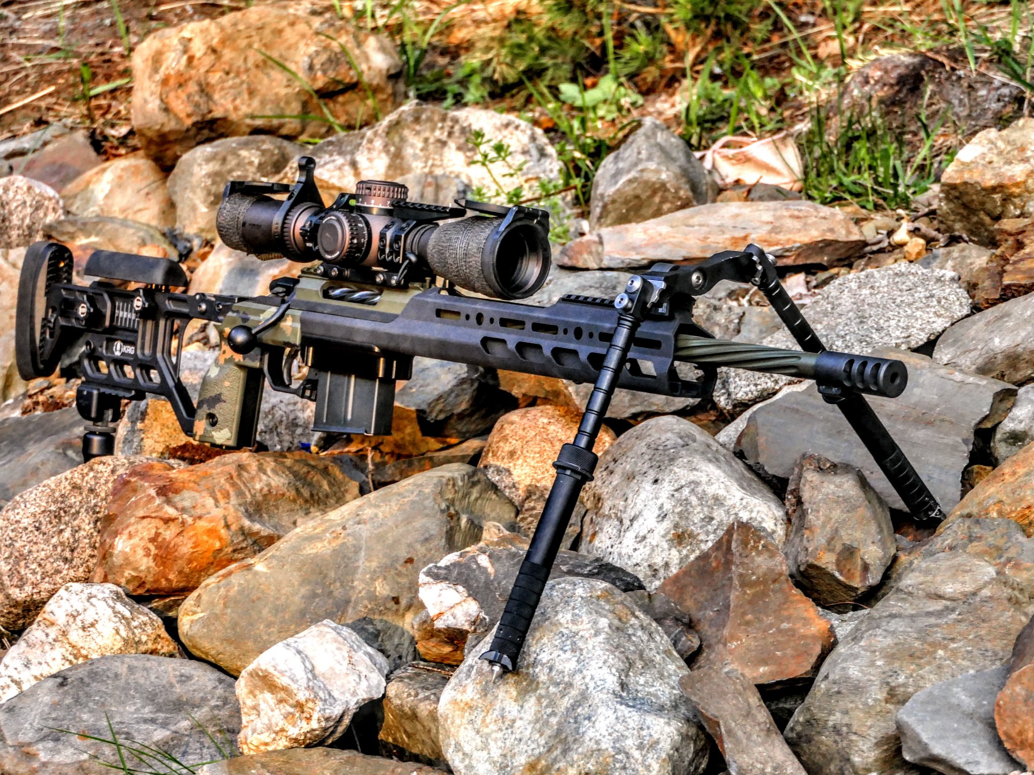

If you like a chassis there is this:
I know you are concerned about weight with the KRG Bravo, however, I run one that's sitting at 18ish LBS. I live in California so, no suppressor for me. I do have a 26" MTU barrel. When I had a stock 20" barrel I came in at 13 - 14 LBS.
They have a ton of accessories that would add weight as well as lots of empty compartments that you can fill with stick-on tire weights or pistol projectiles to add weight and balance. Another positive is has an option to come AICS magazine ready.
if I go with a pure chassis, this would be my pick. Seems to be really light comparable and I do like the looks. However I found that my ARs get freezing in during winter coyote hunts and would like to stay away from the metal. Maybe for another build

Are there currently any stocks/styles I should be looking at? Mesa precision, McMillan or manners all seem like they have some solid options but there’s a lot out there.
I was going through the same process. I went with a KRG Bravo. After a couple months I decided I didn’t care for the chassis. I sold it and picked up a McMillan A 3 with edge fill. That’s a much better fit for a hunting gun in my opinion. Also I switched the bottom metal to Mountain tactical with the factory plastic mags. This saves around 7 oz.
All up weight will be a shade over 9# with a Vortex LHT in Seekins rings. I am using a MT tactical rail and have an ASR break on the front. Sub 10# with my Omega on the front.
