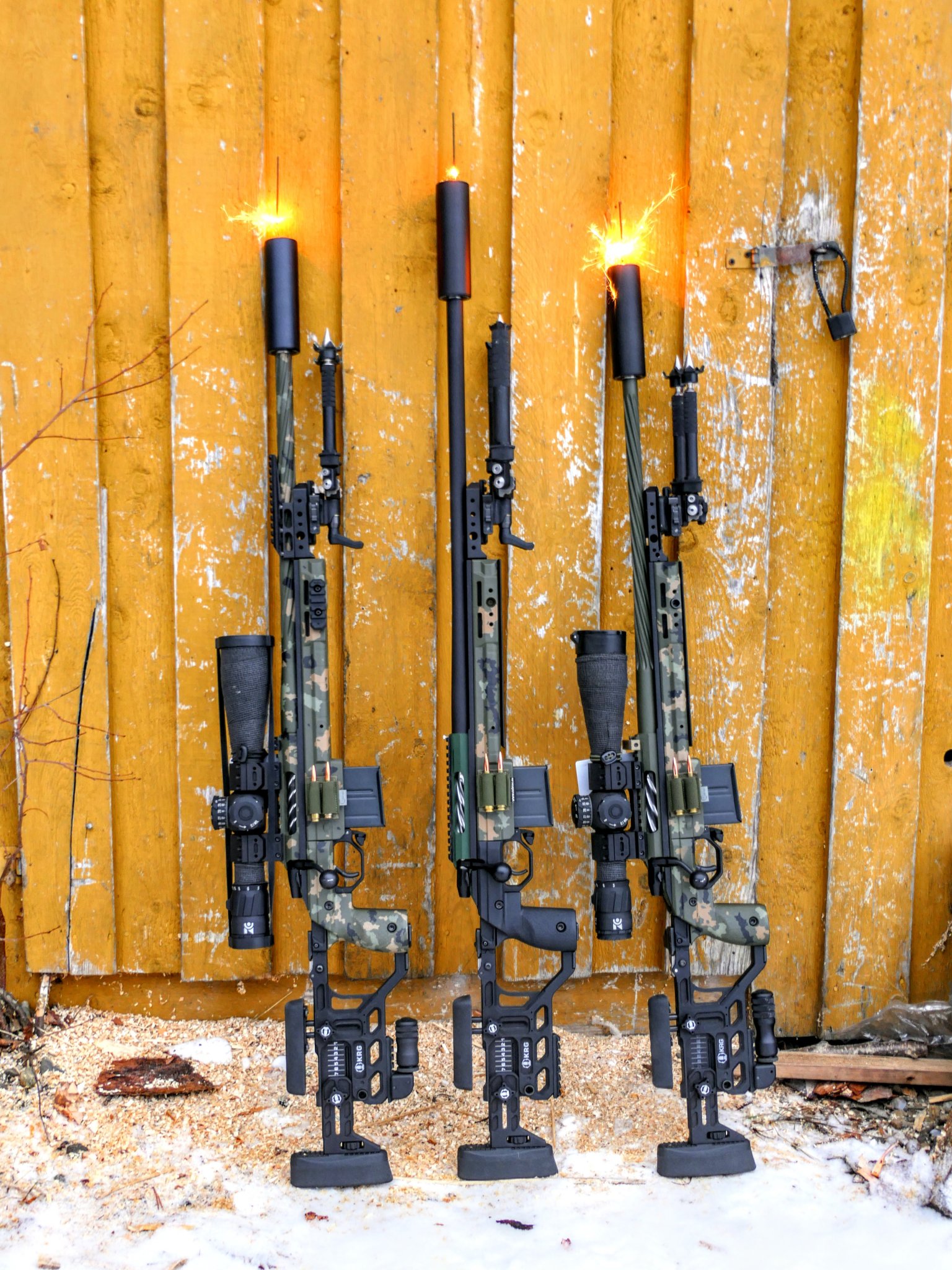

I had once SL5i borelock suppressor, but i did not liked that when you mounted the suppressor on, the POI did change quite a lot.
If you can handle that, it would be no problem, but i did not liked.
Here is BL SL5i suppressor.
And the BL brake.
It is very nice combo, and very durable.
And the BL brake.

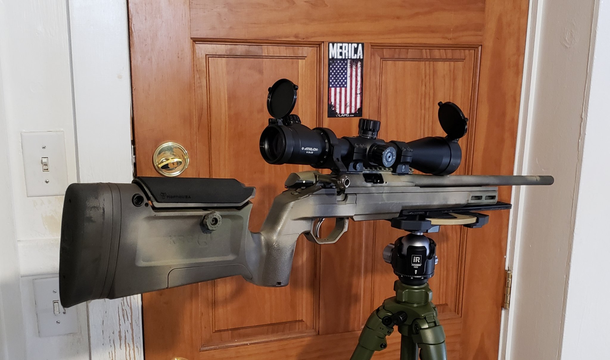

Will a set of low (.82) seekins rings have proper clearance with a 44mm objective on a CTR rifle? I ordered a vx-5hd scope and want to go ahead and order some seekins rings, just not sure the which height.
Should be ok. I'm running .82 rings on my T1x with a 30MOA rail and 50mm objective and it clears with scope caps, albeit close.

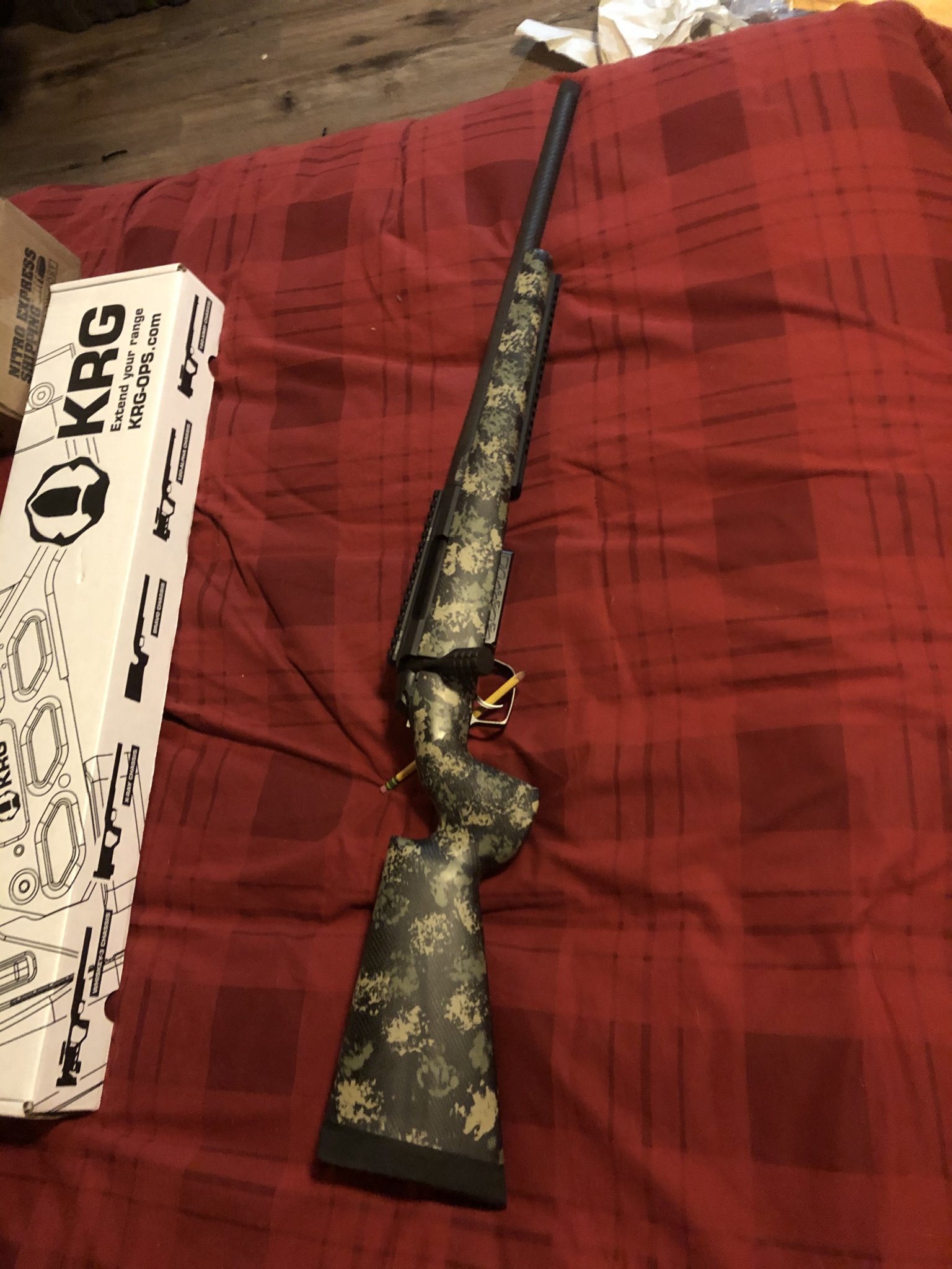

Is that a Carbon Six barrel? What caliber? Nice looking rifle.
@260284
It’s a Hells canyon armory barrel (benchmark blank) in vanilla 6.5 CM
I still haven’t gotten a scope mounted, need to get on that really want to shoot the gun.

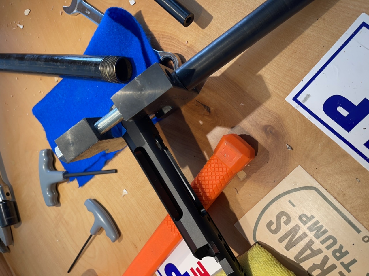

We used the viper barrel vise and a wheeler action wrench #1 you just have to turn the curve side up so the wrench has too flats contacting the action
Any slippage? I keep hearing people saying that the VIPER barrel vise will slip too much and is only good once the factory barrel had already been taken off.
One of the problems with slippage in the barrel vise (no matter which brand) is clamping the external action wrench too tight.
All your doing is compressing the action/barrel threads into each other and creating more friction.
Tighten it enough to keep the action from moving in the jaws is all that is needed....

I found that to be true also. Very little tightening of the action wrench bolts cause greater resistance. After I got the barrel off I experimented using the notched part instead of turning the top jaw upside down. It did seem to be able to tighten the wrench bolts more with the bottom flat jaw against the top of the receiver and the notched part on the bottom of the receiver.

also, I used sections of toilet paper core cardboard around the barrel, torqued the Viper vise bolts to 60 ft-lb and there was no slippage when using a 4' iron pipe.
