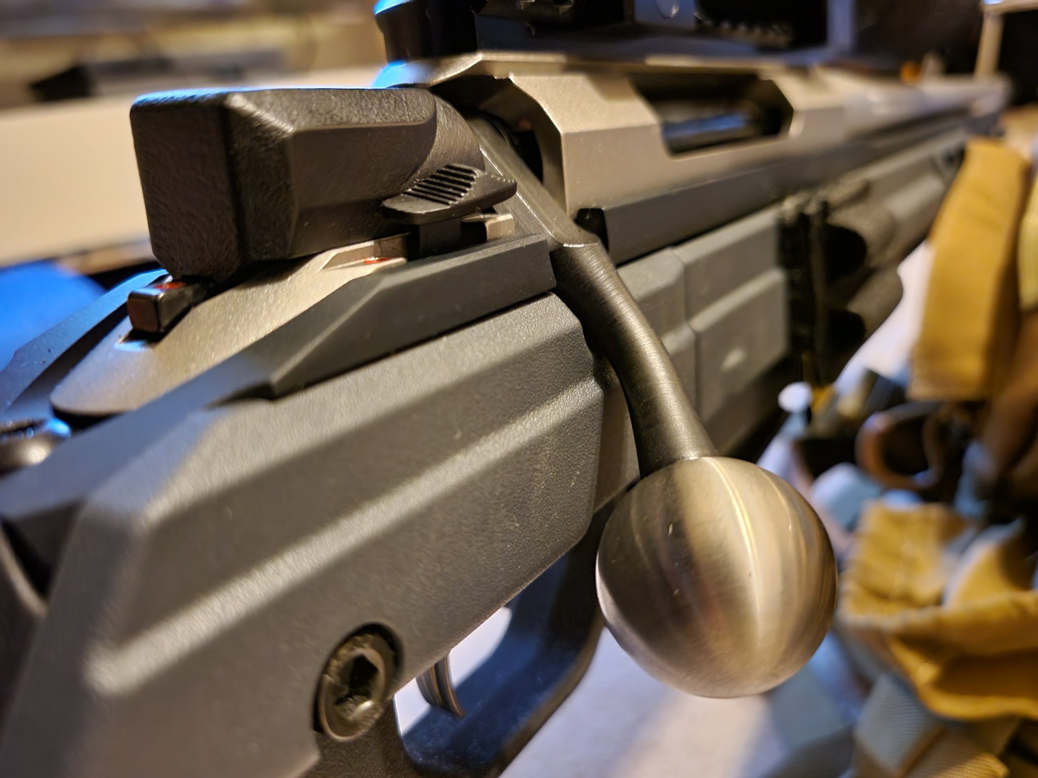

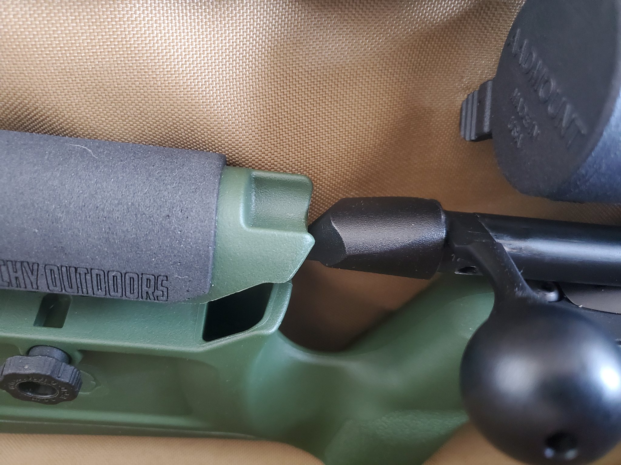

This caught my eye…can you expound?

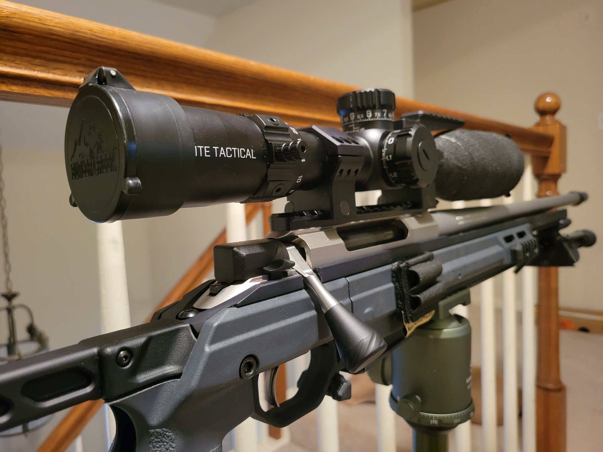

Above a certain cheek pad height the bolt hits the cheek piece before it comes all the way back to pick up a new round.
Ok…. Maybe this is obvious or not…. But why not take the cheek piece off or lower it to take the bolt out….? Mark the raise point on the check piece lugs so you can get it back to the original position…. This is what I do with my MDT XRS
KRG makes a specific cheek piece with a larger cutout to clear Tikka bolts and R700 long action bolts. If I recall it was included in the purchase of my Tikka Bravo direct from KRG. They are also available under their spare parts section.

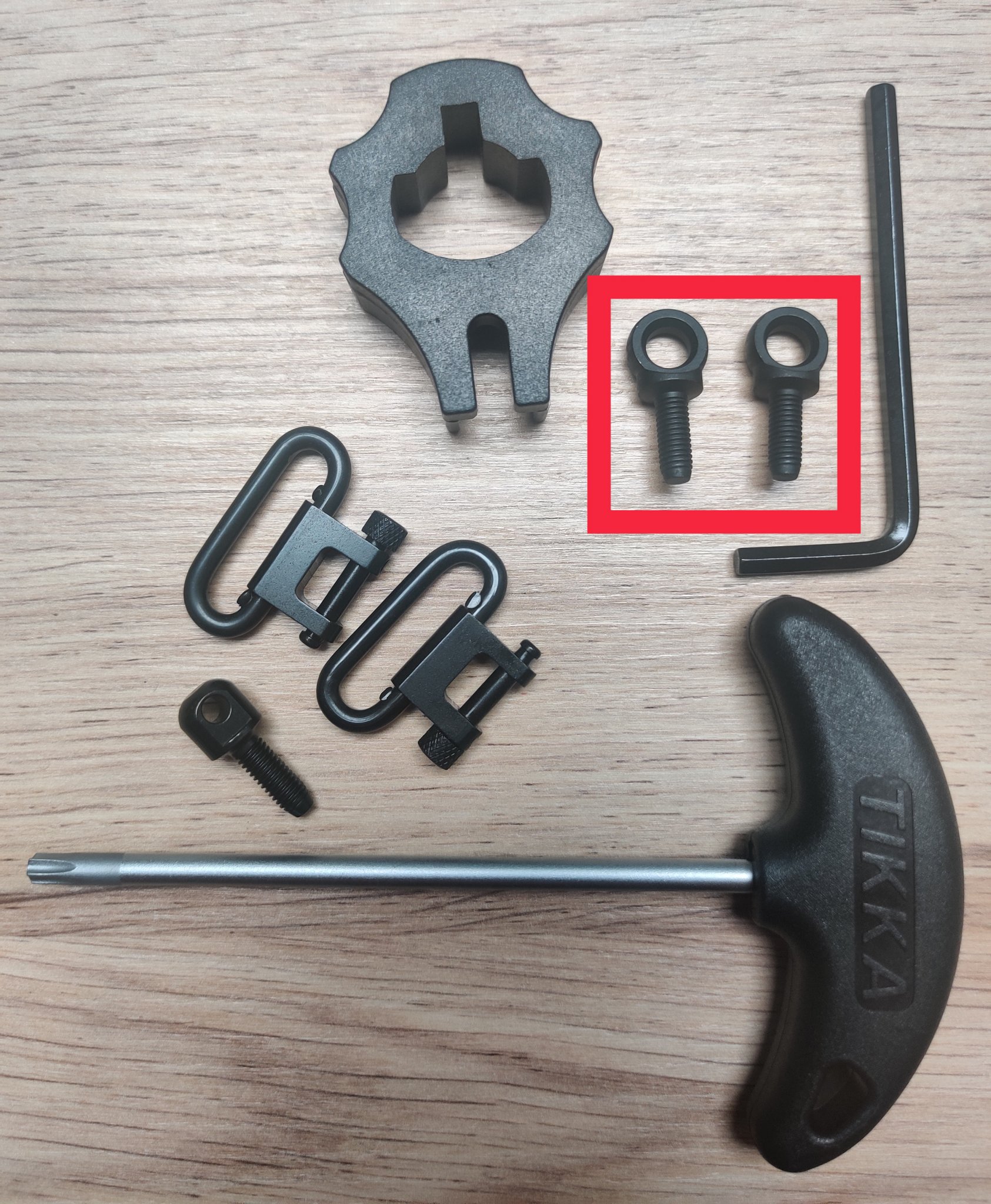

I just received my new .308 Super Varmint, and there was something.. that I can't figure out, in the box.
These are the tools / parts that came with the rifle. Pretty standard stuff. Two screws for the sling swivels were already screwed to the stock. But.. what are the screws with larger holes in their heads. What are these used for? Some other kind of sling, or..?
You can mount these to your bolt side to the stock.
