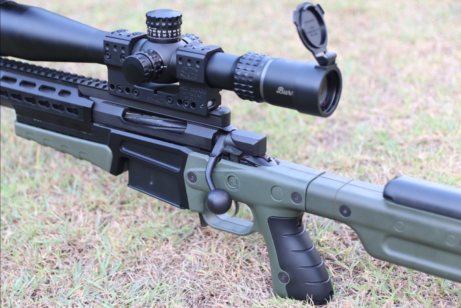

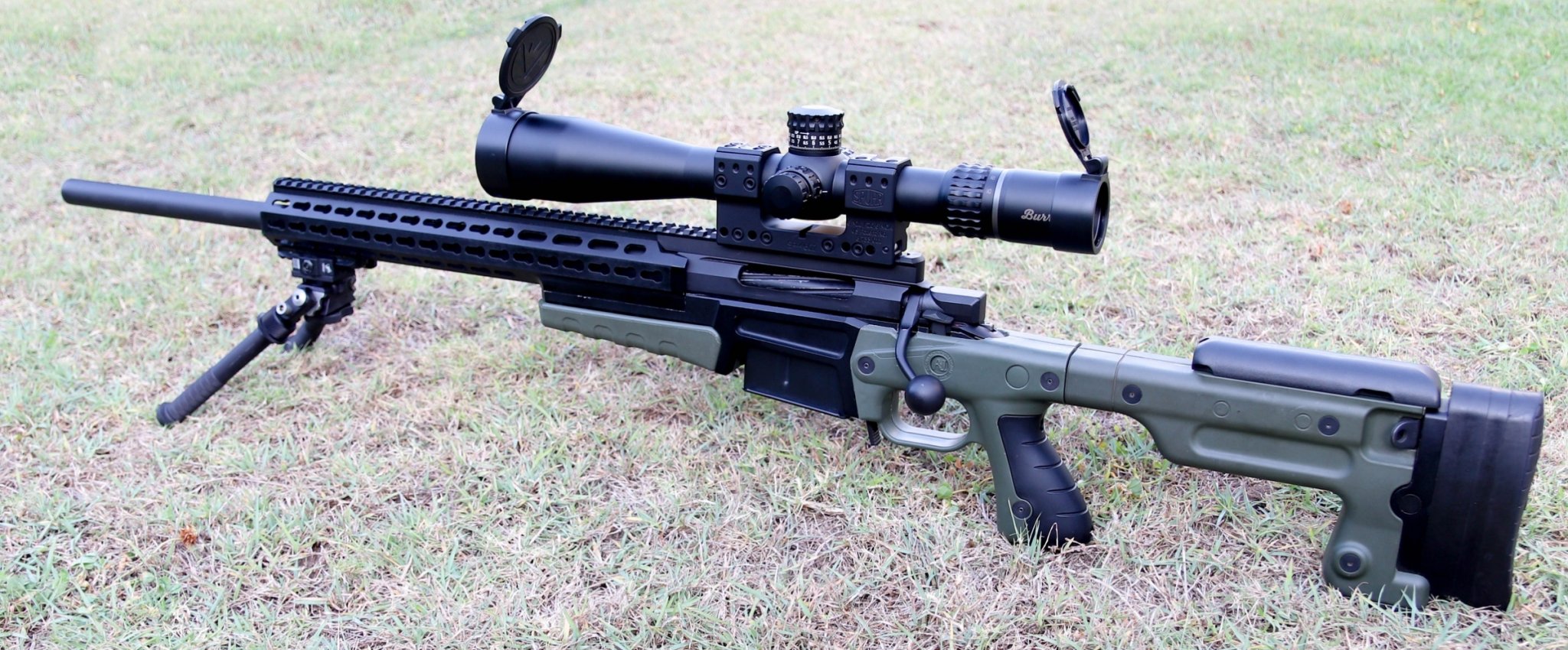

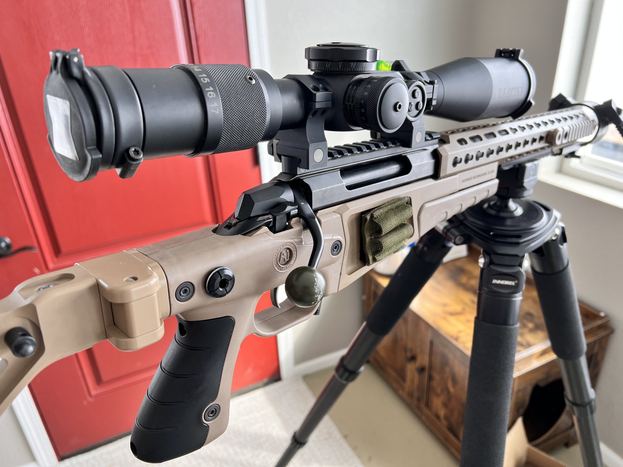

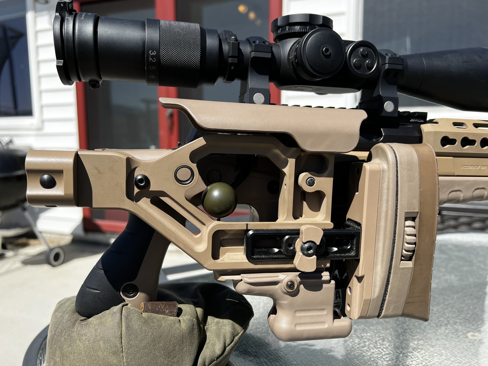

Behold the TAX (Tikka in an AX)

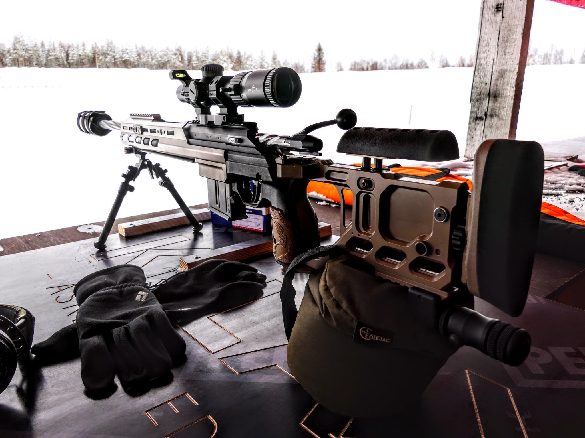

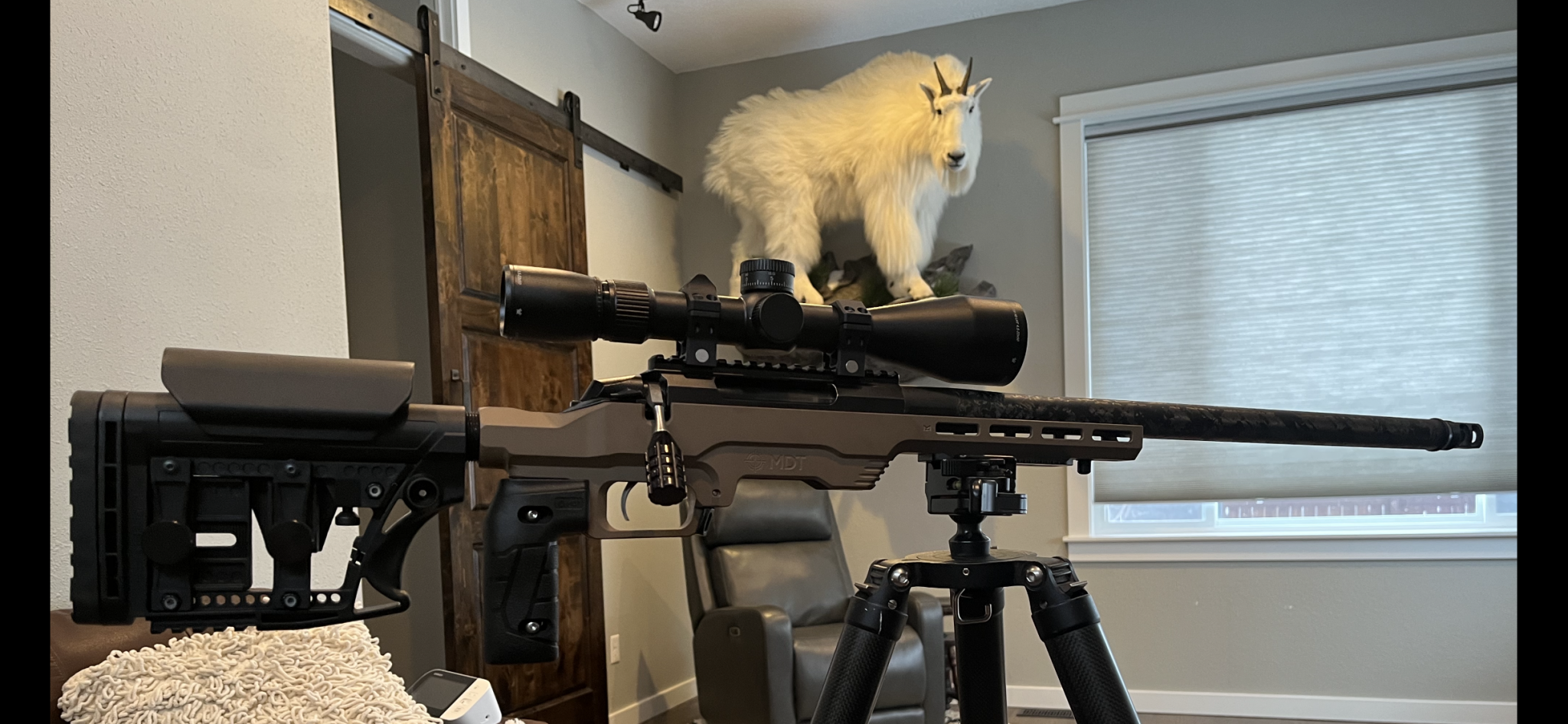

I milled out the chassis, bedded the recoil lug into the chassis and bedded the action. I did this about a year ago. Runs well and feeds smooth.
View attachment 8106150View attachment 8106152View attachment 8106153View attachment 8106154
After 11,939 posts I do believe we have a winner.
Sir photographs of the internals of the bedding area inside the chassis would be appreciated.

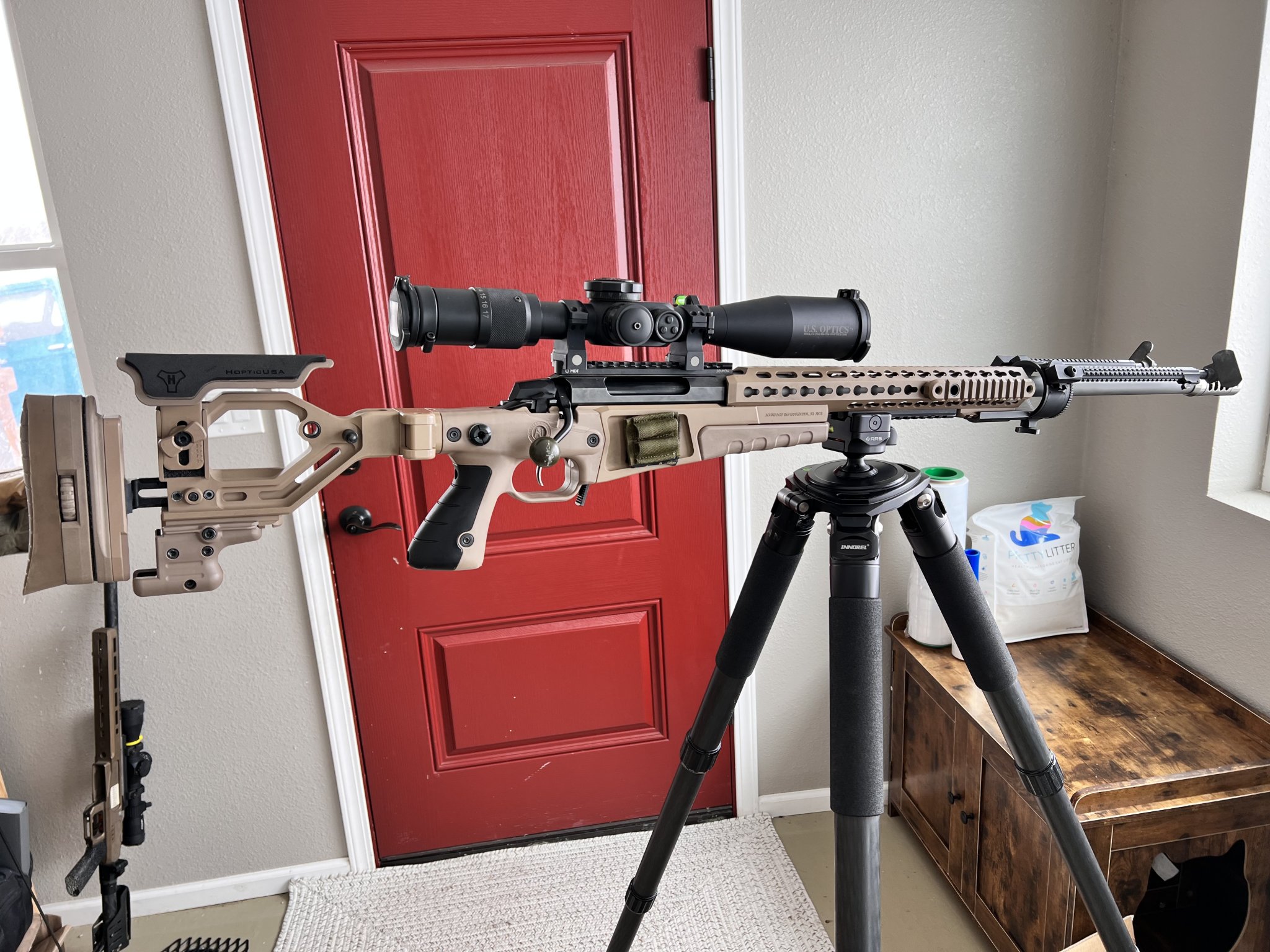

Looking at a NIB, Left Handed Tikka T3x Tact A1... is it worth the $2299 before sales tax?
I see tension knobs on the cheekpiece- is it just friction and pressure that keep the cheekpiece from dropping under use, and do Tact A1 cheekpieces stay put when tightened?
Is it easy to find a spigot for mounting a bipod?
Will any aftermarket magazines work?
Because I'm Left Handed, so many LH chassis are out of stock/have a wait time, LH actions too, and I'm not sure I want to wait for a custom action and higher end chassis.
@Rob01 , @Lowlight , @MarinePMI
Aftermarket magazines the way it is? No. That chassis uses Ctr or sako trg (don't remember proper trg number) that the ctrs are a slightly cheaper version of.
Why are you specifically wanting the taca1?
What the A1 gets you is a threaded heavy barrel with a 2 stage trigger in a chassis. Are you going to be happy with that chassis?
Another option is to get a left hand lite stainless and modify.
If you want the 2 stage that's harder to replicate but has been done by modifying for left hand a midas trigger (which is currently out of stock). Or just get a $10 trigger spring and lower the weight of the very good single stage it comes with.
Whiskey 3 for Tikka are available and is easy to modify for left hand. Only a bolt handle cut out needed. Same for krg's other chassis. For left hand use the folder isn't needed since the bolt handle won't let it fold all of the way. Whiskey 3 are available AICS ($960), or CTR with enclosed forend ($1130).
If you want a heavier barrel, shouldered prefits are available so you can get what contour you want. Barrels can be harder to get off but not impossible.
If you start with the lite you may not have a 2 stage but you will have a stainless action.
I started with a lite stainless. Haven't changed the barrel yet other than getting it threaded by Thunderbeast.
Other places have that A1 and the lites for a cheaper price. Check out Locked Loaded.

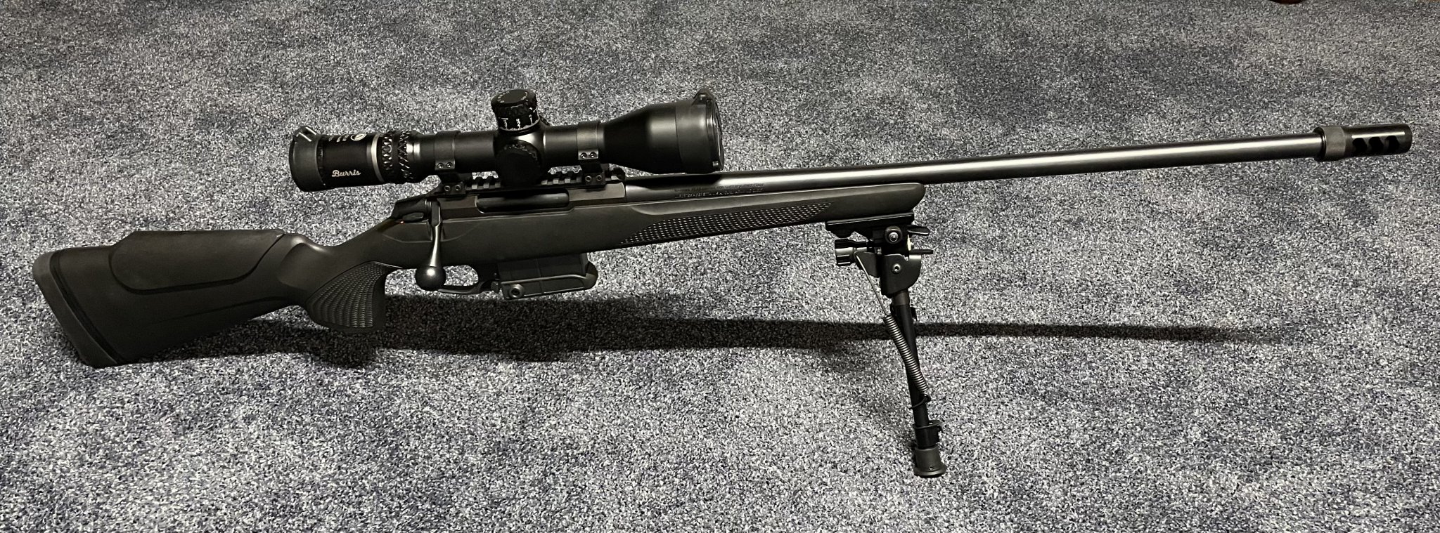

Finally after 2 years of trying purchase a T3x Super Varmint 20" .308.
Disassembled cleaned and inspected, lite trigger spring installed, YHM QD brake, all fasteners torqued to spec. Hopefully it shoots close to my T3x .223 Varmint. The Tupperware stock fits the action like a glove and actually feels decent. (y)
POS Tikka's don't shoot worth a damn.....
This result makes it worth the two year wait. Those groups were shot in the 35- 40 total round count on the barrel. I did a one shot thorough clean 2 times, then a 3 shot group and thorough clean 2 times and shot 33 rounds today.
110g to 168g with a 1:11 with a 20" barrel works for me. (y)

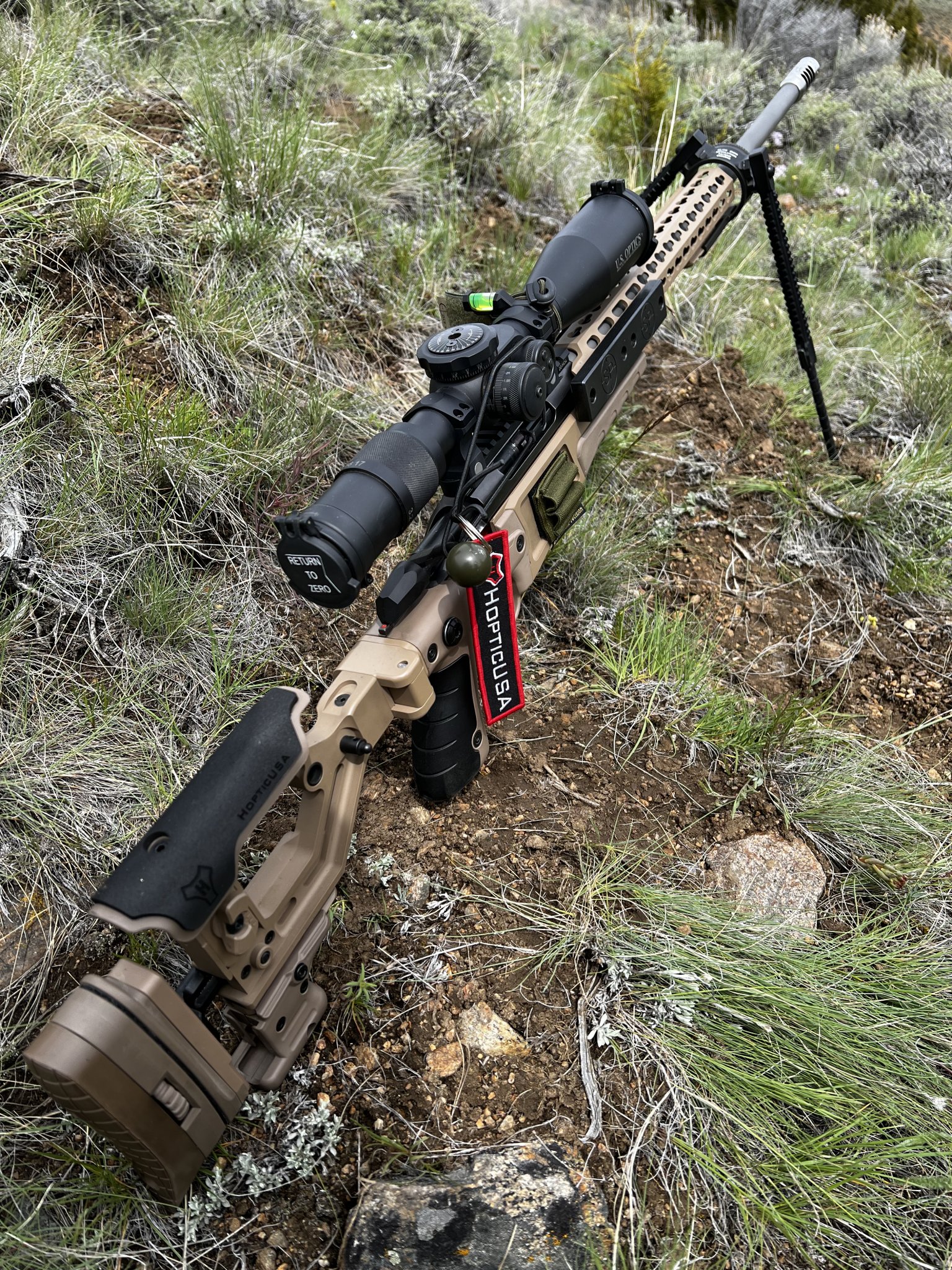

I finally got the Tikka CTR out to the range. Still in factory condition with factory magazine. I tried 4 different loads. Got a couple under 1 MOA in windy conditions. The most frustrating thing was, every other round, the magazine came loose and the bolt failed to pick up a round. It got to be like malfunction drills with handguns. Shoot, tap, rack. Any thought?
Reactions: kdhope
View attachment 8121111View attachment 8121112
With a flat screw driver pry out the magazine catch. Little cut out in the back of the mag. This will make it lock more solid and less rattle.
edi
edi
This made a big difference in how solid the magazine locks in. I’ll try to report back after I get to the range again. I’m confident it will be fine now. Thanks for the help!
Reactions: ejg
I did that to my ctr and it helped a lot, once any bugs are worked out ctr mags are fantastic. They are so smooth compared to aics
