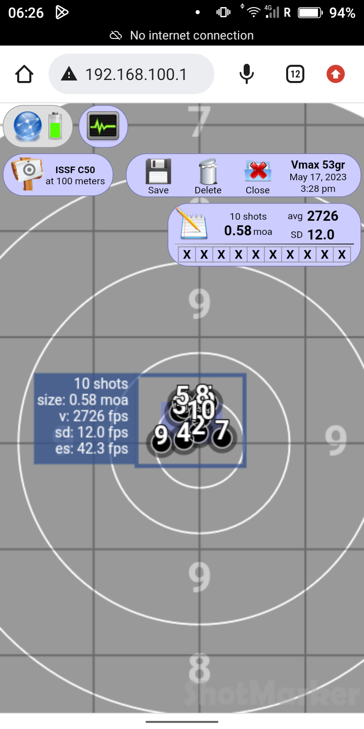

Got the shorty out to 1k for the 2nd time with norma 143. ABMobile doesn’t have 143 golden target in it so having to use the pdm that’s been uploaded. Need to figure out how to do bc alterations, was .4mrad high of my output at 1k.
Fun morning! Solid wind and the 143 going slow didn’t have any issues dealing with it.

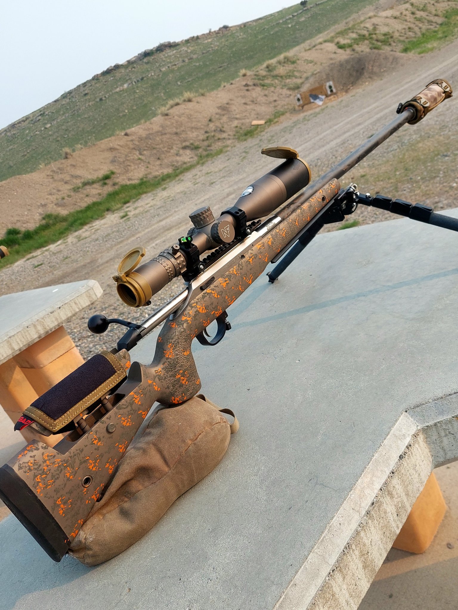

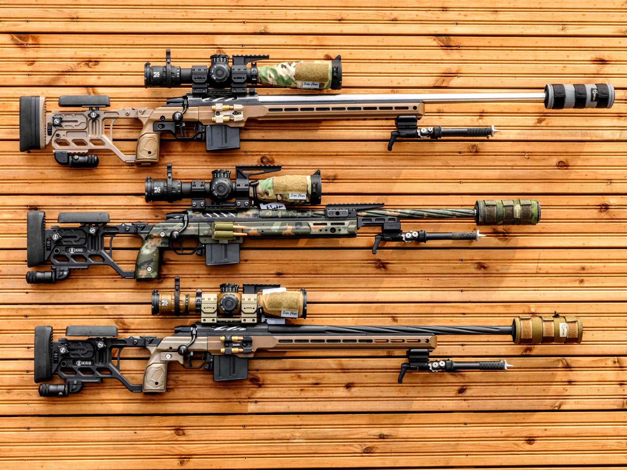

Not enamored with the TikkaT3X recoil lug and the bolt release pin/spring assembly. Seems more work needs to done to improve stock to lug fit. The factory lug liter falls out of the stock….too damn loose. So, it has been replaced with a Mountain Tactical “ Bombproof “ lug. Plus, replaced the bolt release pin with drill bit of slightly larger in diameter. This is all regarding my 7MM RM Tikka. So far, not as impressed with this Tikka than my old Remington 700 Mountain rifle in 260AI. Time will tell.
BTW, my 260AI has many upgrades. It has accounted for many mounts on my walls. MTG

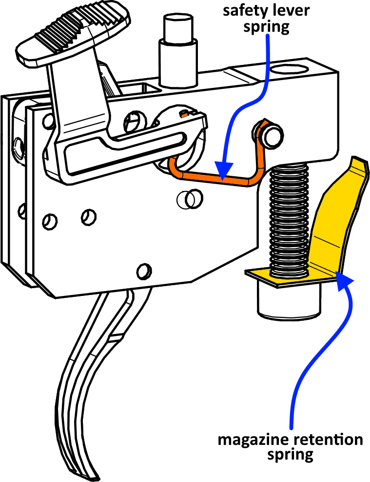

If the magazine retention spring is removed from under the trigger screw you're good to go. Keep if if you ever want to use the lite mag in the original stock.

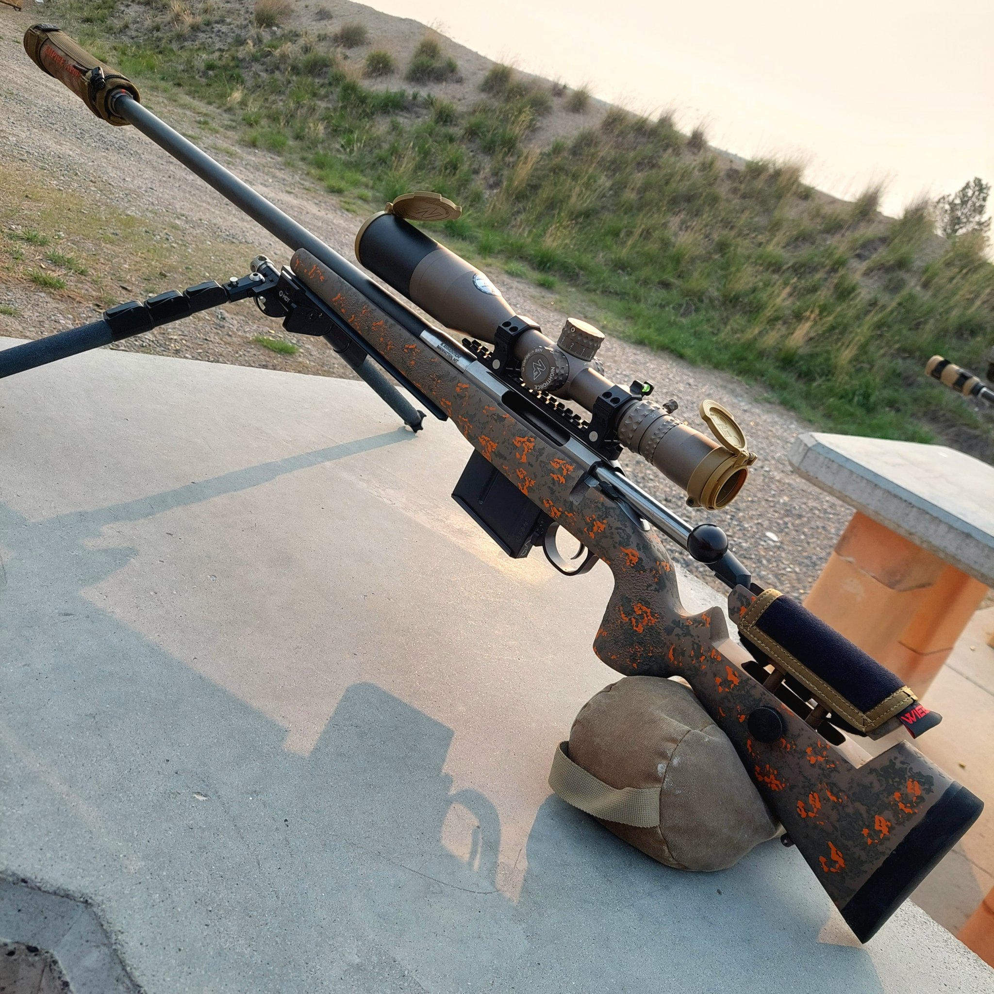

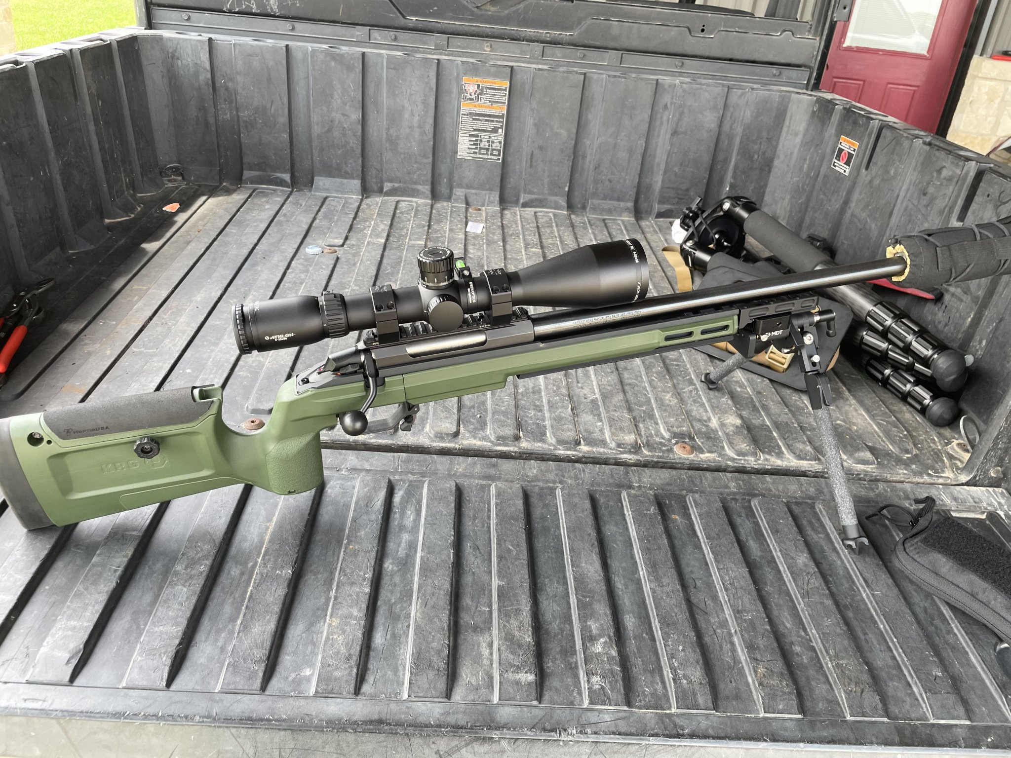

I have the .223 varmint in bravo stock I really like it. I recently had the barrel chopped and threaded for a suppressor. Only problem with varmint is the barrel isn’t threaded.
Nice looking rifle. I always liked the Bravo. I still have one for my Bergara Premier .
Good observation on the Varmint vs Super Varmint. I hadn't caught the threaded barrel. (Not sure I need/want the threads for my use but it's a consideration.)

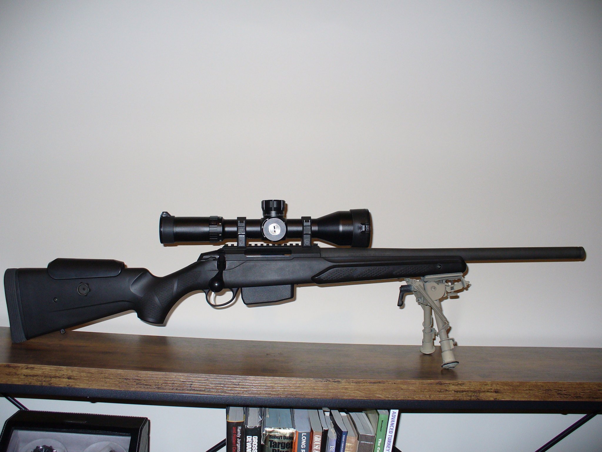

Quick question. Would my Tikka T3 Tactical barreled action drop right into a McMillan stock inletted for a CTR without any modification to the stock or receiver? I read I'd have to remove the T3's mag retaining spring/clip. I'd be using the CTR bottom metal/mags. Thanks in advance. Below is my gun.

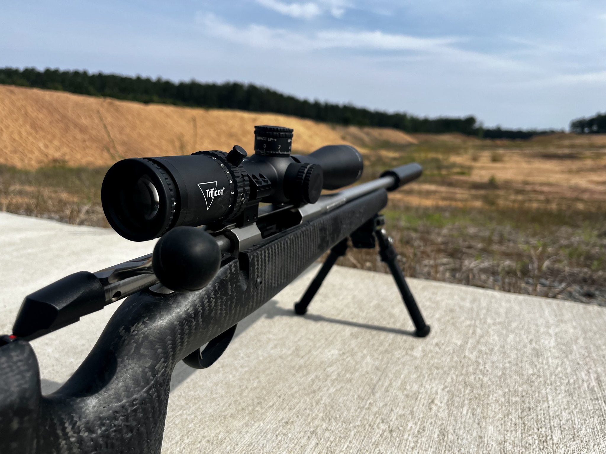

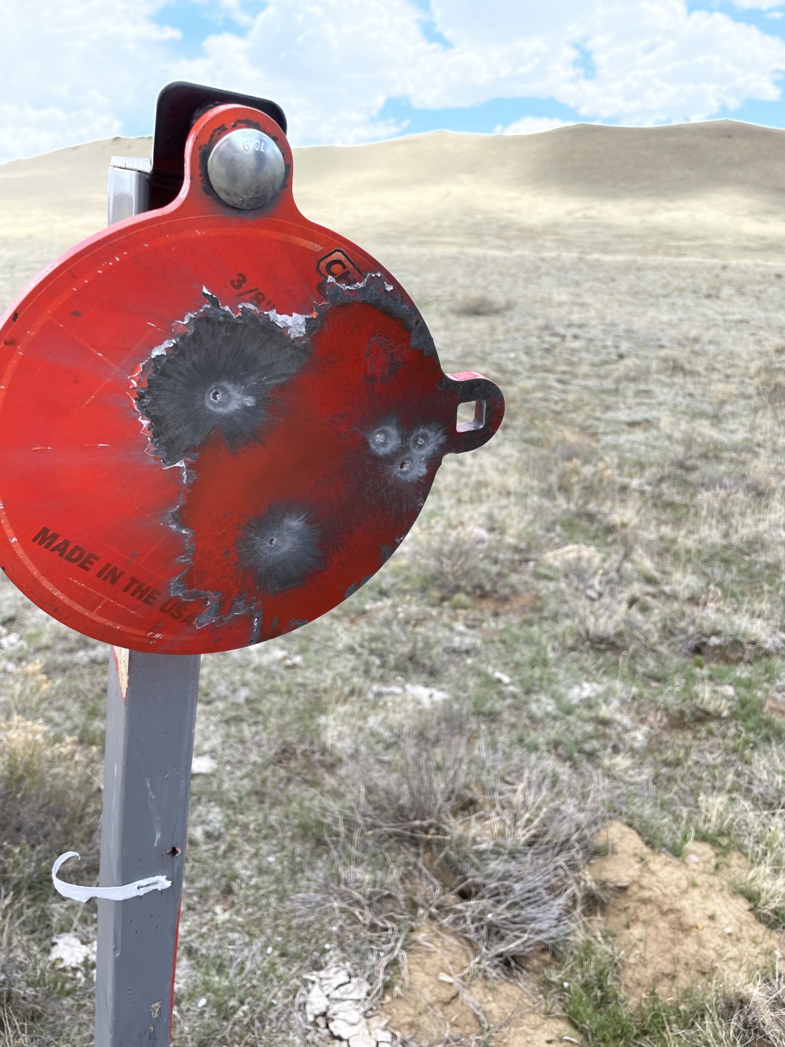

I finally got to shoot the CTR with the bravo stock. The range I went to was closed for maintenance so we just shot prone on some public land. First time I’ve ever dialed a scope for elevation. Zeroed for 100 yards, dialed up .5 mil and hit an 8 inch plate nine out of nine times at 200. I know that’s not a big deal for you guys on here, but now I’m hooked. Can’t wait to start stretching it out.
The scope looks out of level in this picture, but it’s not. Must be the camera angle.
This picture shows two hits from my buddies 30-06 and my last 3 to the right. I was aiming at the bolt hole due to a steady right to left wind.

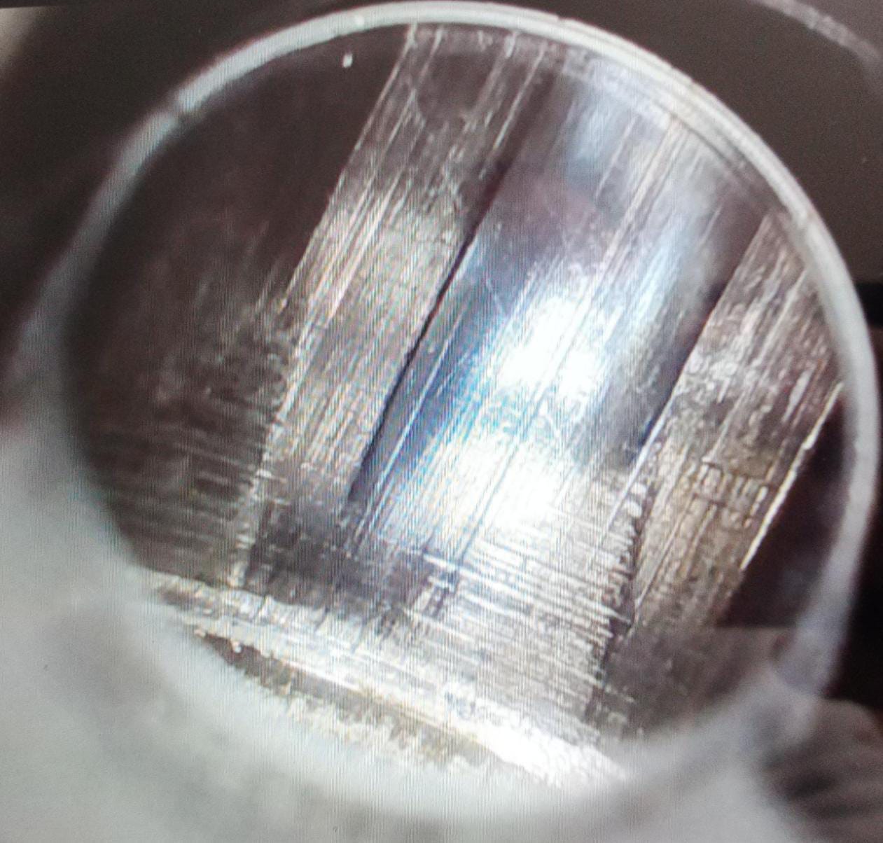

3.41" is your maximum OAL allowed up through the bottom of a T3x action. I found this out by happenstance when I was loading 183gr Sierra Matchkings. I have a T3x in a Manners T4 stock with a CDI bottom metal which allows me to use AICS magazines which allow a very long OAL.
I loaded the 183's to about 3.6" which was about 0.020 off the lands. I load the magazine and try to chamber a round.. no joy. I look amd see the round still in the magazine and the nose was pointing downward because the tip of the bullet wasn't clearing the bottom inlet of the action.
I was full of great ideas, so I decided to file a groove/V notch so the bullet tips would rise up through the action unimpeded. It worked, BUT I soon round out I needed to tune all my magazines to give all rounds of all types a slight nose-up angle, otherwise I'd have some rounds, like my preferred Berger 168 Classic Hunter nose-dive into that notch.
So, my "fix" for 1 type of bullet ended up causing malfunctions for other bullets, which required other fixes to fix the fix.
You do your thing. To he quite honest, I wouldn't hand cut that V notch again, even though everything works fine on my rifle now.
I may actually get a professional TIG welder to fill in that notch.... or I'll be stupid and do it myself 😅
Stay tuned for more Shade Tree Gunsmithery brought to you by our sole sponsor: Brute Force & Ignorance.

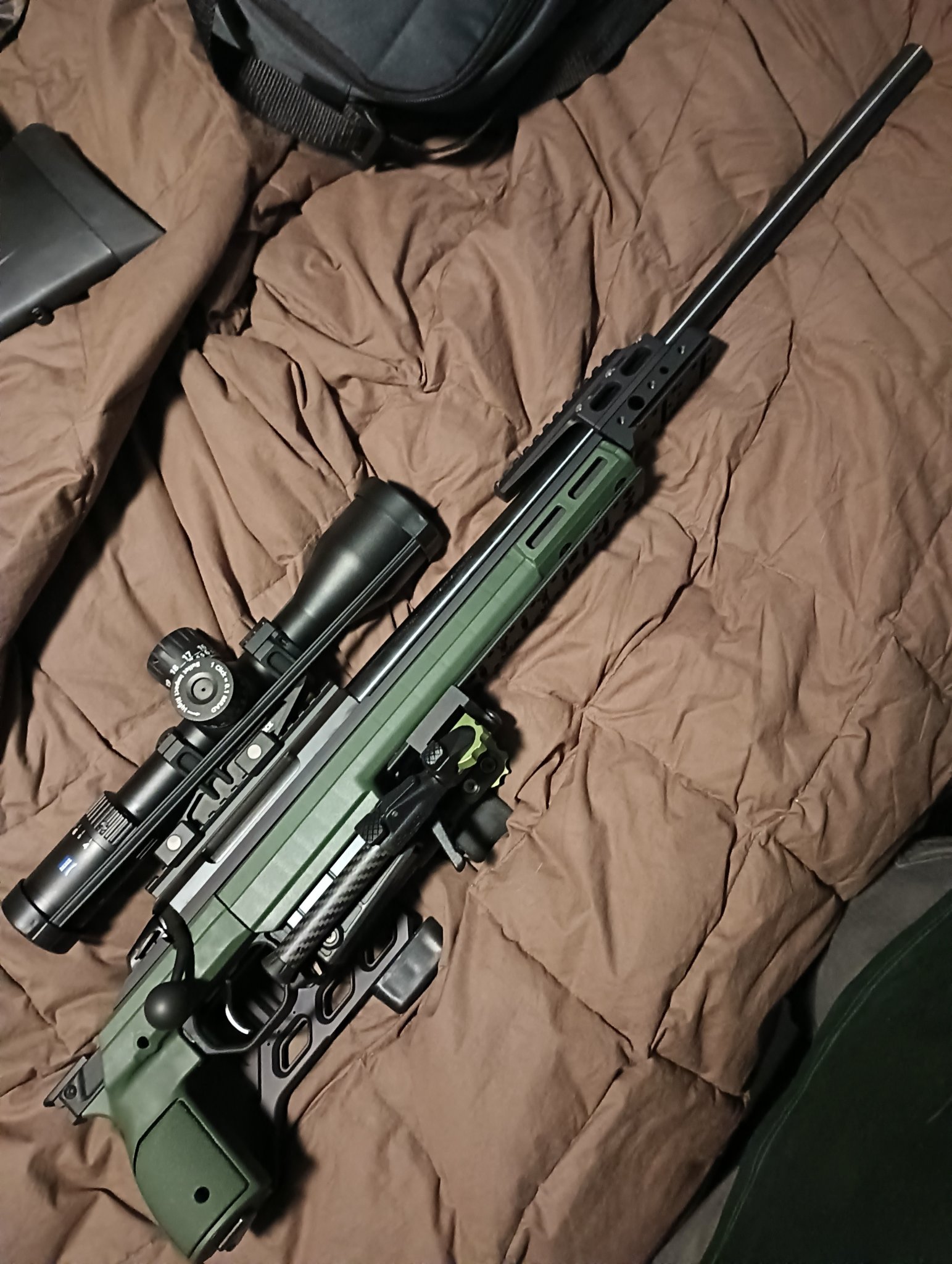

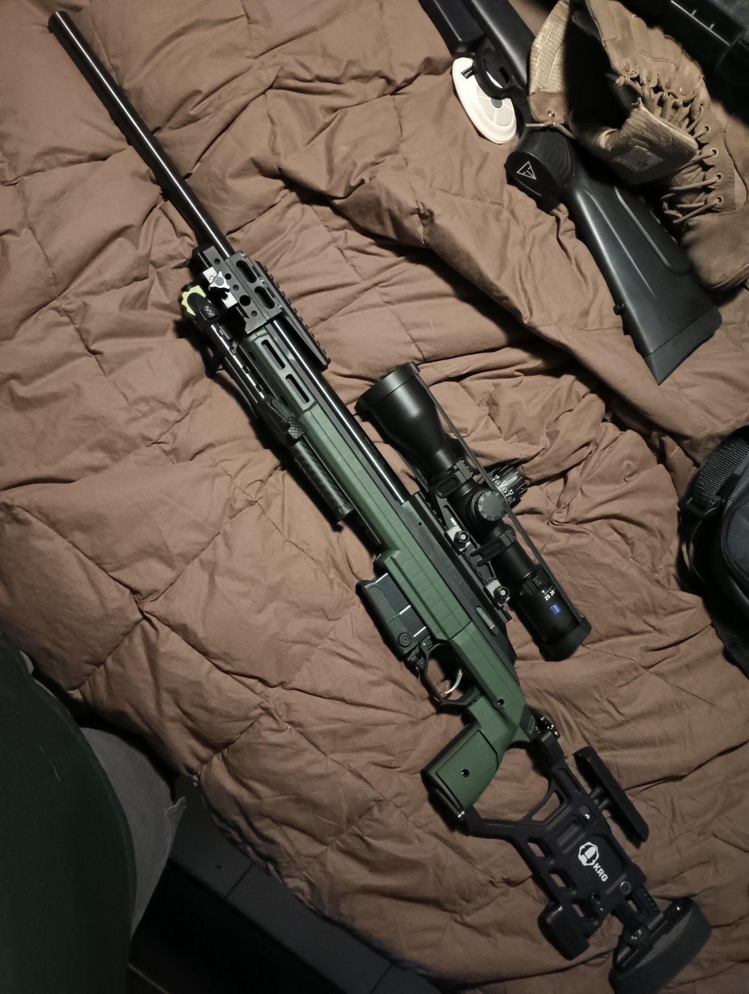

T3x .223 Varmint, KRG BRAVO CTR, KRG NVMC, KRG ARCA Spigot, KRG ARCA rail, KRG/TRG Folding butt stock, Sterk swept back bolt handle, Murphy 20moa stainless rail, Nightforce Unimount 20moa 34mm 1.54", Zeiss S3 LRP 4-25x50 ZF-MRi #16, MDT GRND-POD.
Still need to thread it, second T3x .223 build but this one will keep the factory barrel and will be fed everything
That's a fucking 🔥 setup. Put a good suppressor on there and you're shitt'n in tall cotton.

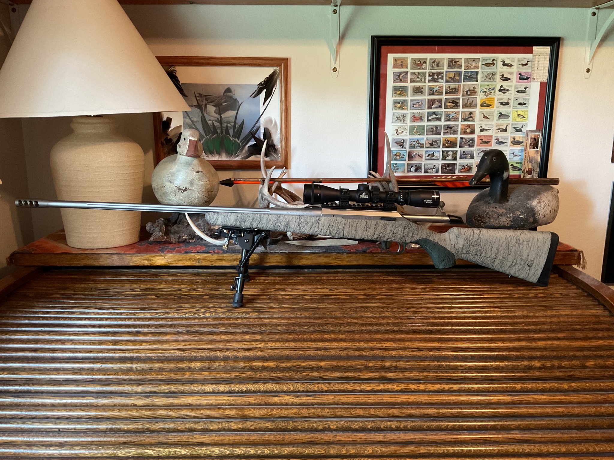

Just thought I'd post up my latest Tikka .

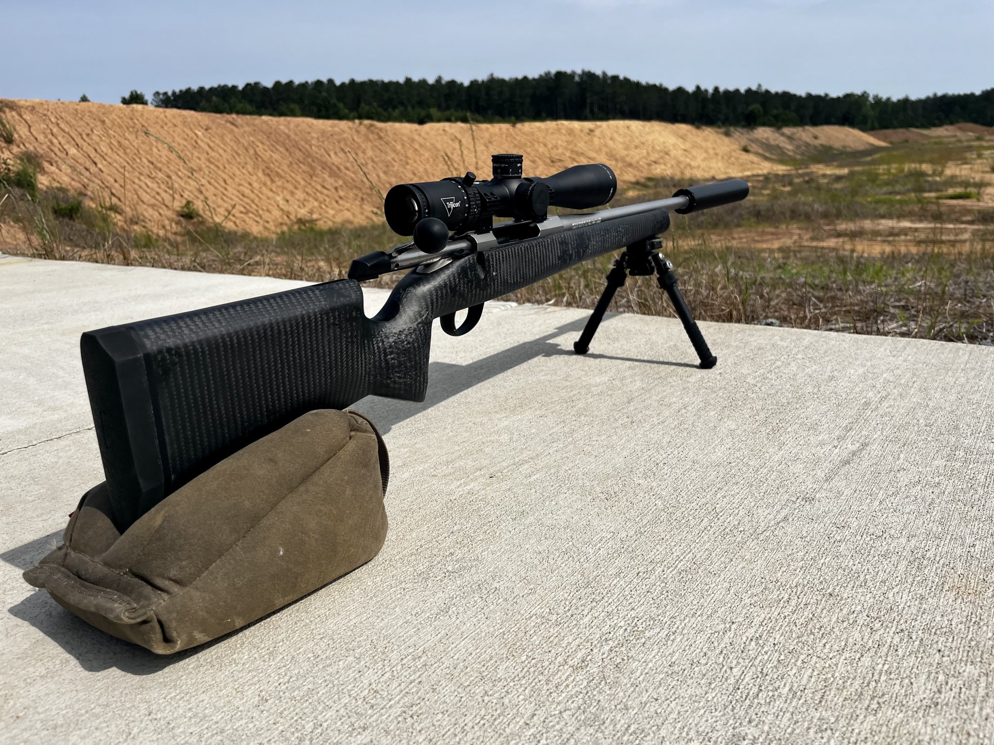

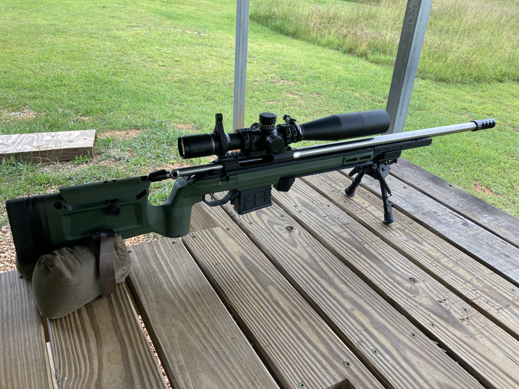

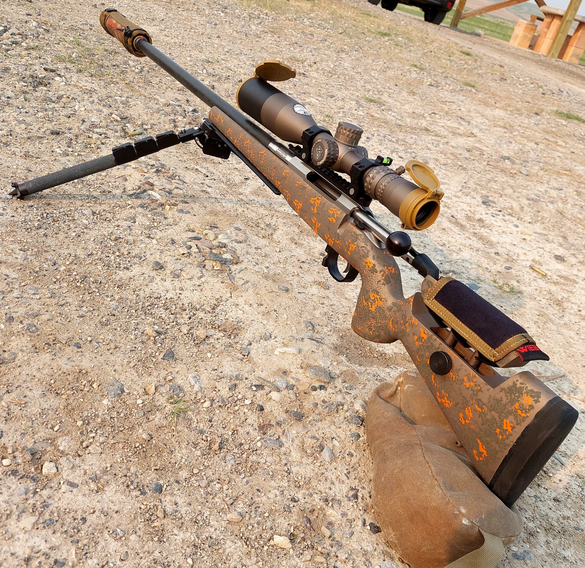

I notice that you have a rear monopod on all three of those Rifles.
Could you give a review / advice of their usefulness and performance.
I’ve never used one and would be interested in your opinion .
Cheers
Ken
Monopod is nice to have, it will go every where you rifles goes, every time.
Like if you forgot your rear bag, you still have monopod.
I like the monopod on hard table, it will be nice to have the precision adjustment you can make with it.
I was shooting with my 2 sons today, we only used monopod on the zombie rock chucks olympics :D
Reactions: Harronek
How do you like the monopods in terrain /out of table? I had one in some of my service rifles (TRG with a foldable stock) and never really found a way to make the most of it.
At the end of the day I always felt like I was wasting time with the adjusting and eventual readjusting, especially in multi-target situations

I have a Tikka T3x SuperVarmint in 223. Great fun to shoot and even shoot 1000yds using ELDM 75gr bullets. I just don't seem to get the precision with 53gr VMax bullets.
Below is a photo of the leade. I have never seem anything like this. Been like this from new. It appears as if the leading edge of the lands have been machined away.
Have anyone seen anything like this before? What is the purpose? How in darnation do you even do that?
That would not go away even with the hardest hand lapping.
But if it shoots, i would not mind of that.
It looks to me, that the finishing has not done to the end, cold hammer forged is the way Tikka makes barrels.
It will go away after few hundred rounds, or so.
