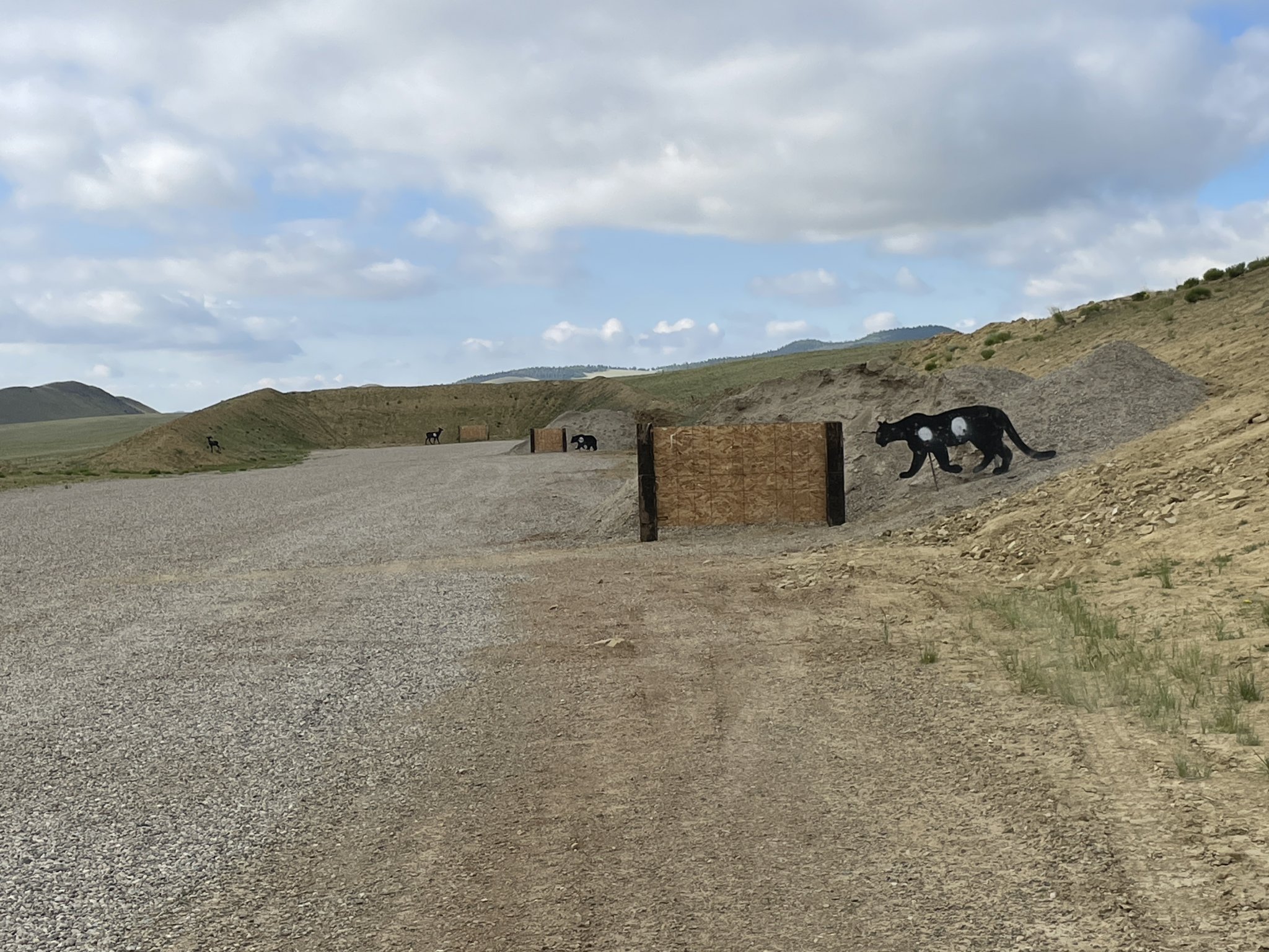

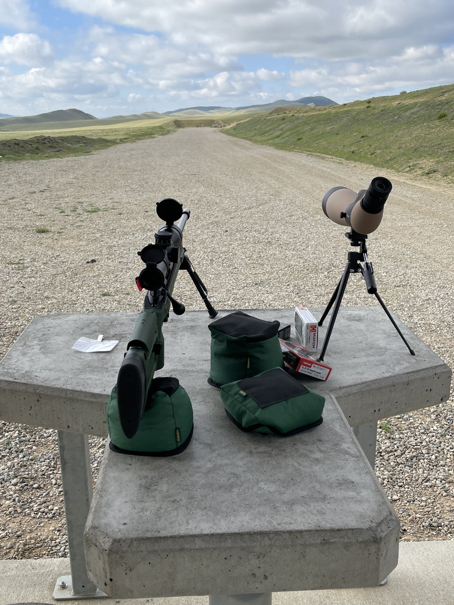

I got a chance to stretch the CTR beyond 200 yards this weekend. The range has a 600 yard bay with steel silhouettes and target backers a 400, 500, and 600 yards.
I started at 400 yards. After a few shots things tightened up. This was my best group. About 1.25” at 400 yards.

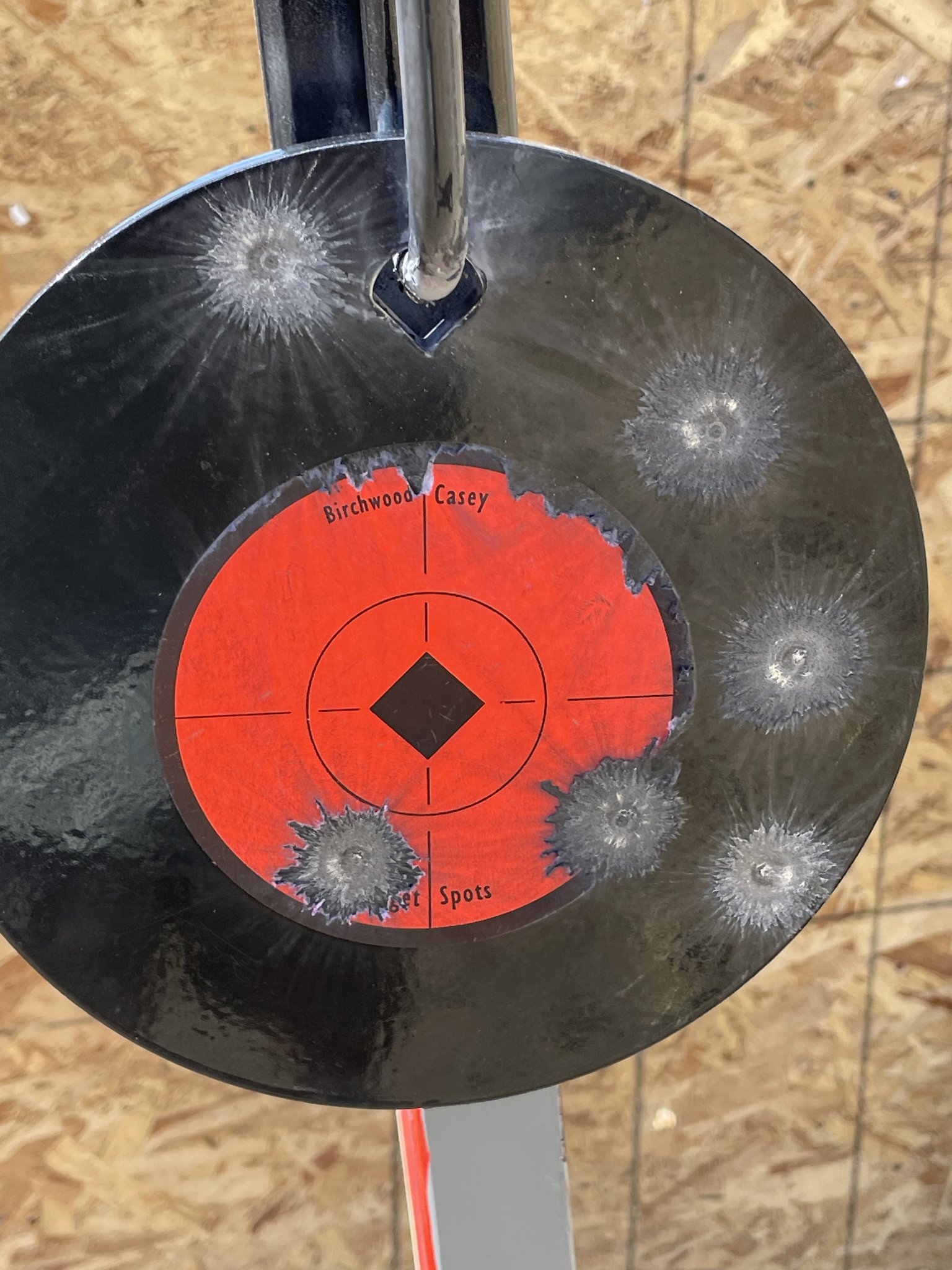

Things started opening up a bit but I was able to ring this 8” plate 6 of 6 at 400.

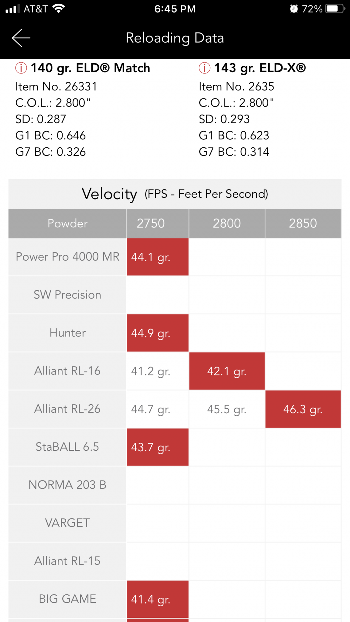

RL26 is a proven performer, just make sure you take temp changes into account. Find your node and stick to that MV adjusting for temp. So if it’s hotter, reduce charge to match MV. If it’s colder then increase charge to maintain the MV. Whatever you do, don’t load up 500 rounds all the same charge and if you do don’t vary from your established temps by more than a few degrees.
I actually used to bring a cooler to the range to keep my ammo at winter temps. RL26 is a proven performer.
The attached chart is for 140-143 grain ELD. Of all the listed candidates the highest MV is the R26

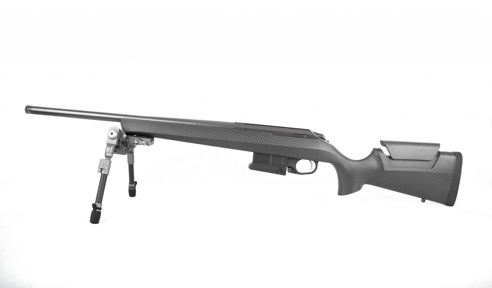

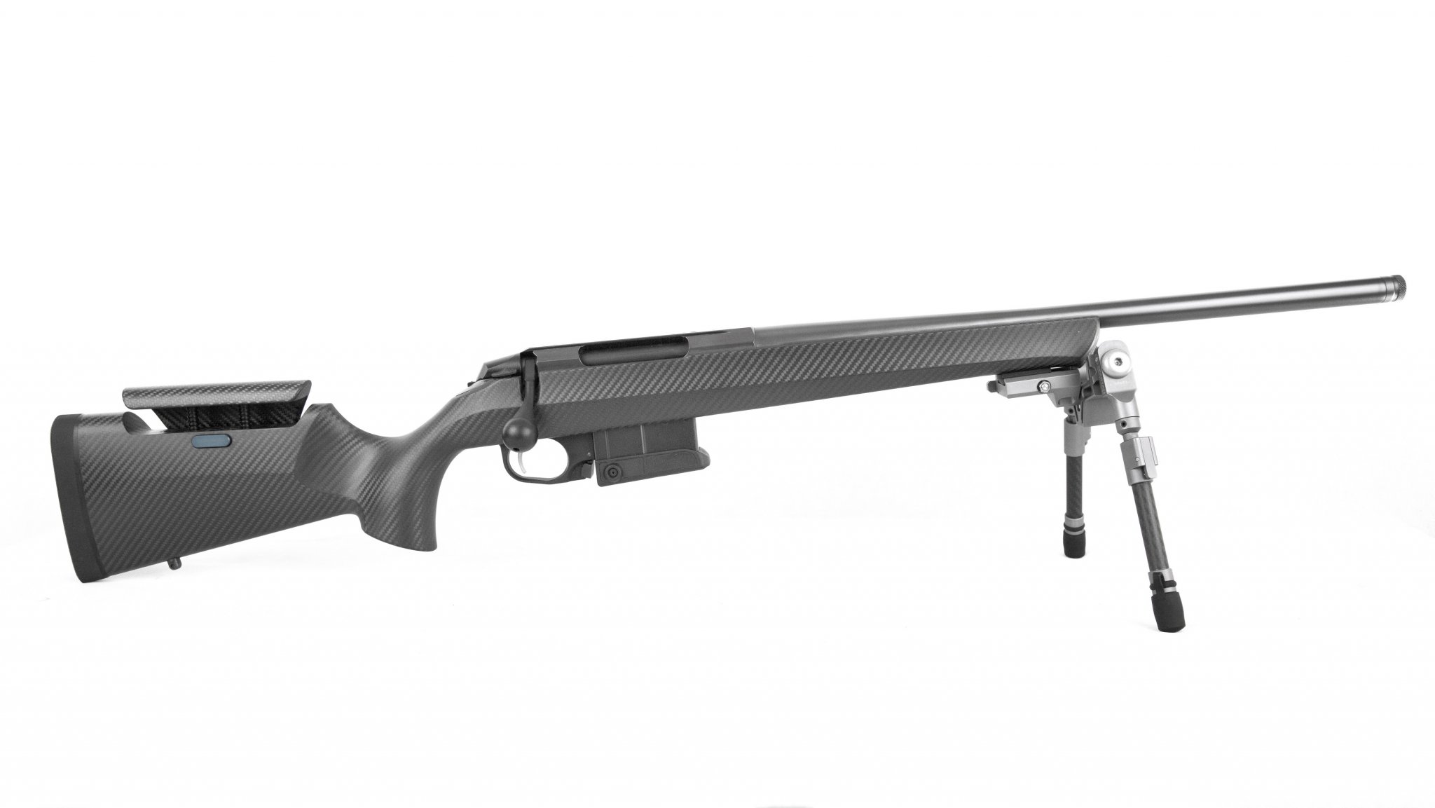

Would anyone happen to know a rough weight difference between the hnt26 compared to the lss gen2 chassis with a mft minimalist stock? Also would the cost be worth the weight savings?
Loking at the website I'd guess 1.5-2 lbs. Cost vs weight is up to you, guess it depends on how thick your wallet is..... Carbon is cool, also nice on your hands in the cold compared to aluminum.

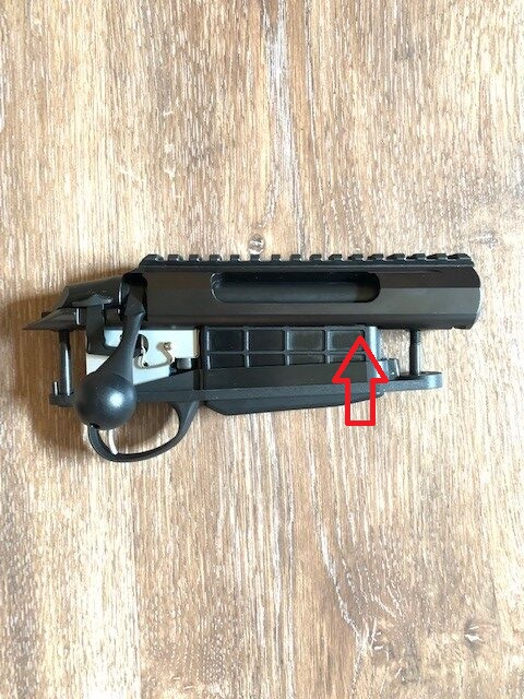

How to I modify a Standard T3 action to accept a CTR mag?
Is your Tikka T3 model, NOT T3X?
If it is T3 and you want to start using CTR magazines, you need to do side way cut to the bottom of the action.
All Tikka T3X has this groove under the receiver, that is on the CTR magazine using rifles must have, or the CTR magazine feeding lip is not going up, and the magazine aint going to feed the ammo.
I had one T3 that i put in to a TAC A1 chassis, and that needed to do to the receiver bottom.
Milling machine and about 5mm wide and 2mm deep.

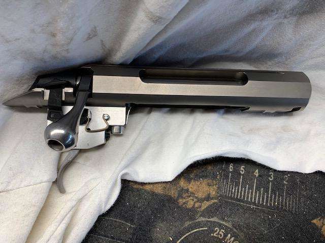

Here is a picture of T3X action.
And here is T3.
You can seen that there is no that groove, that the action needs, if use CTR magazine.
