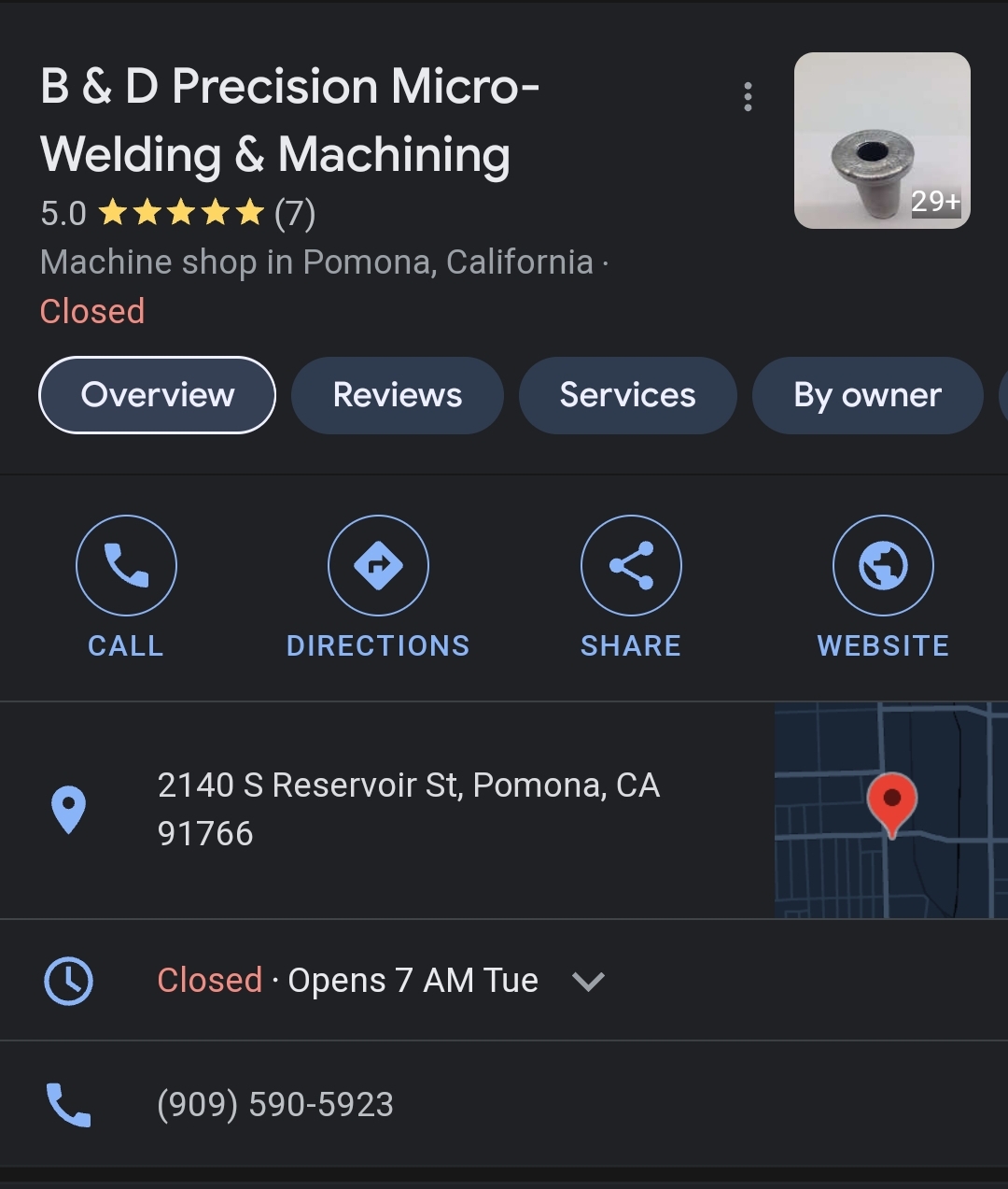

Yup. You gotta find a place that does "micro TIG" welding.
Don't know where you are, but I took mine to https://bndprecision.com/
Reactions: LeftyJason

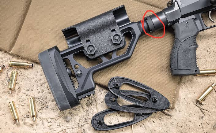

How to open it, I have tried it and it is very hard to open it
Castle nut wrench should do the trick nicely
Seems like it, but no, they are glued shut on the Tac A1. The pain in the ass really occurs when a screw comes loose, making the stock wobbly, and it’s only able to be accessed from behind the hinged part.….fuckin sucked. They aren’t meant to come apart and Tikka wanted me to send the rifle back to replace the stock. A shop got it off with a lot of heat and tools.
mine became loose here. Those two parts are connected by a screw. And the head of the screw is behind the plate of the hinge

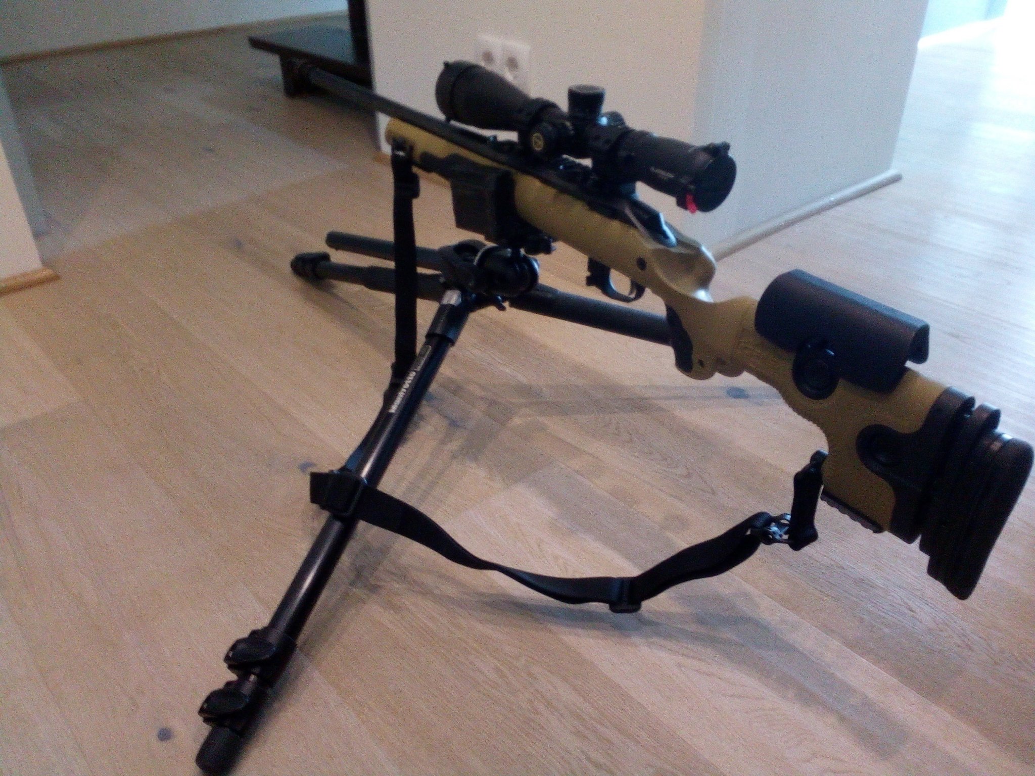

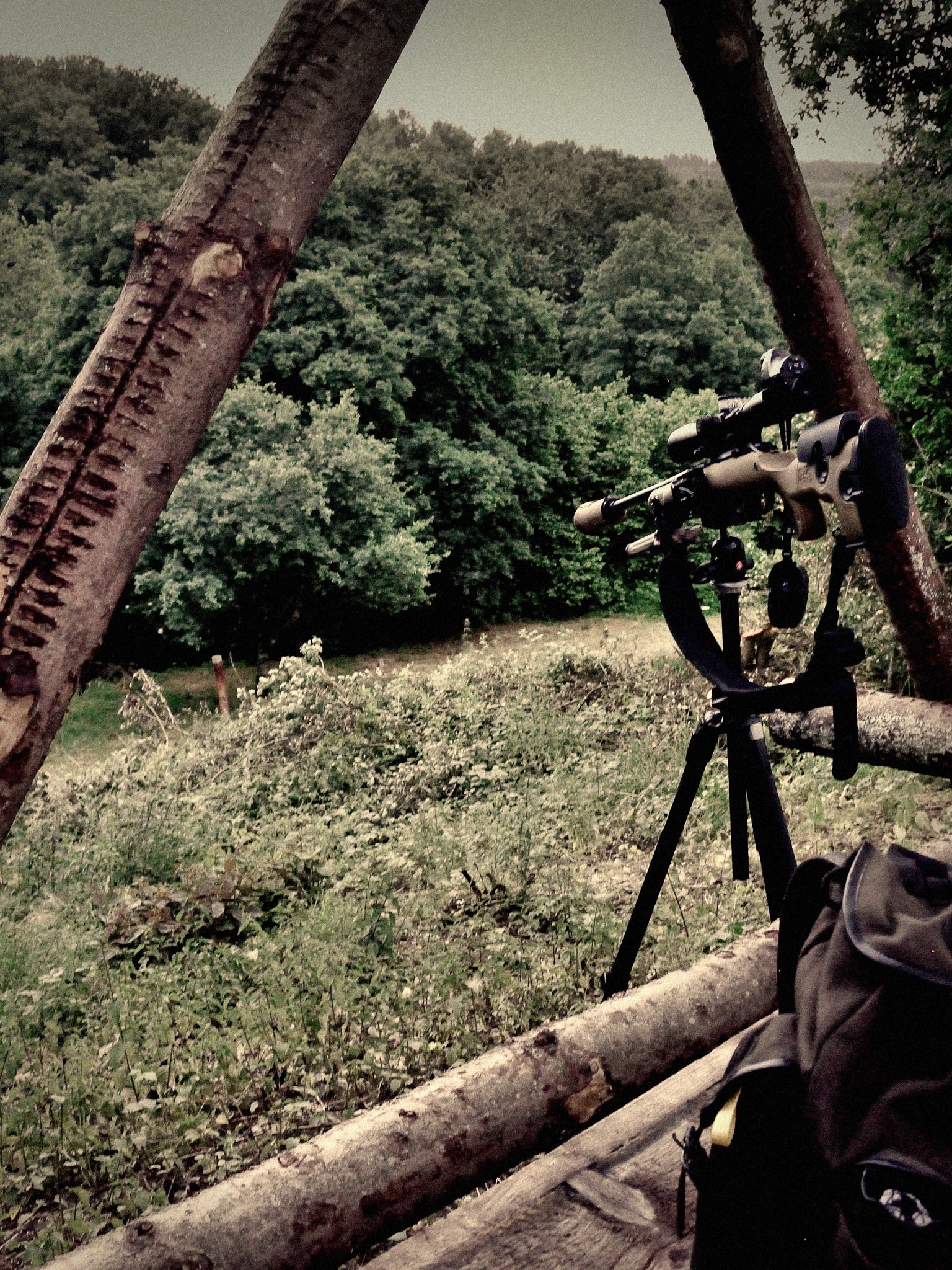

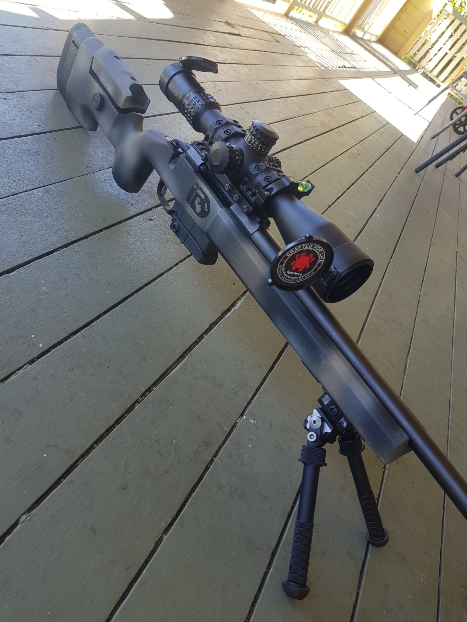

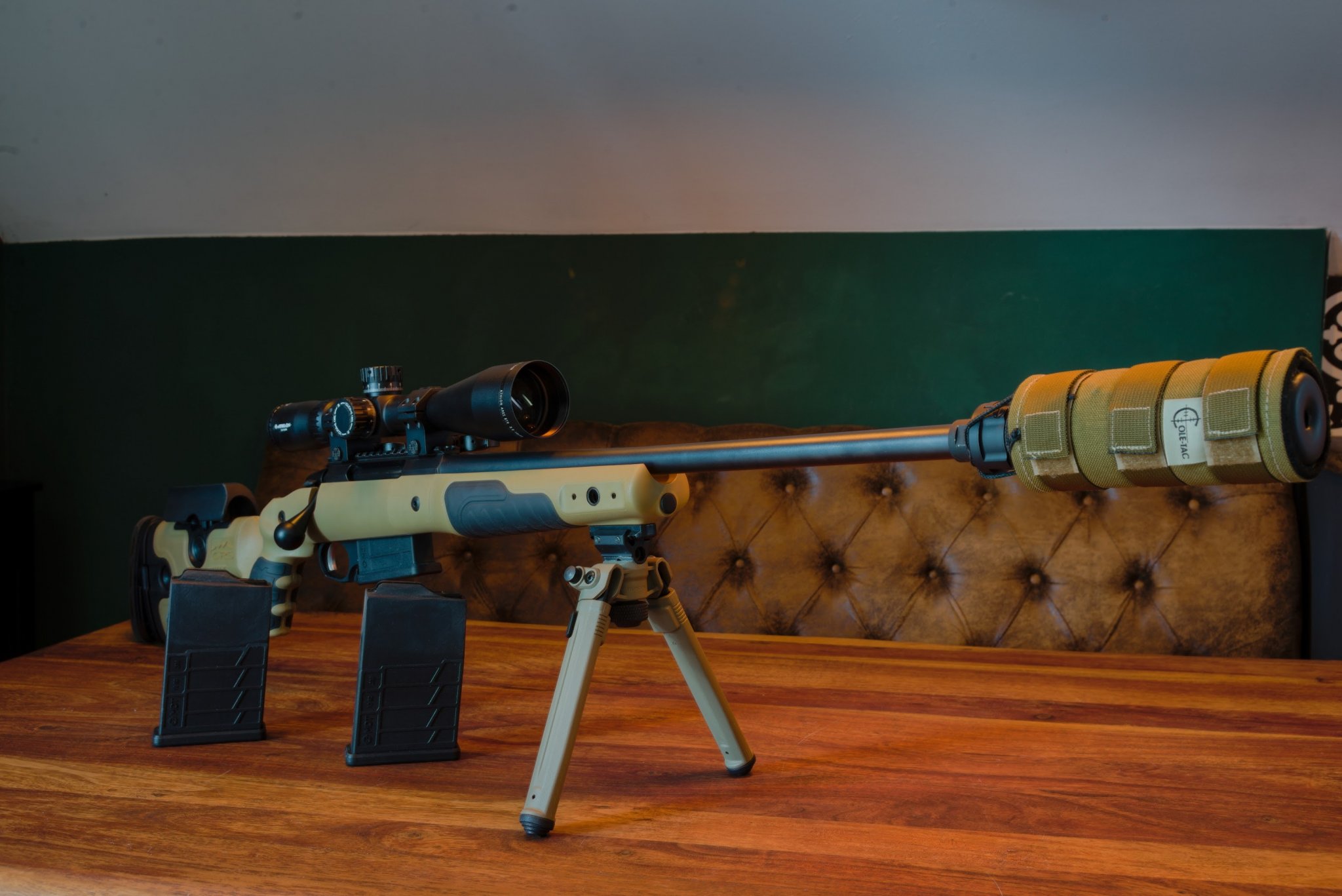

Hey folks,
new member here based in Germany. I use my Tikka T3X CTR .308WIN 20" for hunting and sporting purpose.
Changes so far:
Swapped the factory stock for a GRS Bifrost
Swapped the factory bottom metal for an Atlasworxs DBM to be able to use them AICS mags
Putted an ASE Utra brake onto it and combined this with an ASE Utra SL7i silencer.
Scope is an Athlon Optics ARES BTR 2,5-15x50 FFP MIL.
Throw a magpul bipod to the front.
I am very, very happy with this setup so far. Stock's ergonomics are superb.
I use a handload with Hornady ELD-X 178grains, but in Germany we will have to shoot leadfreee while hunting within next year, so I will give those CX bullets a try.
Rifle's weight with loaded 10 round mag is 7.2kg / 15.8pounds. Absolute pleasure to shoot.
I am stitching my own shooting bag at the moment and will put some BT80 rails to left and right side to connect the bag with some QD buttons. We will see how it turns out.
Some pics of the rifle and a 100m / about 100yards 10 shot group. Repeatable result.

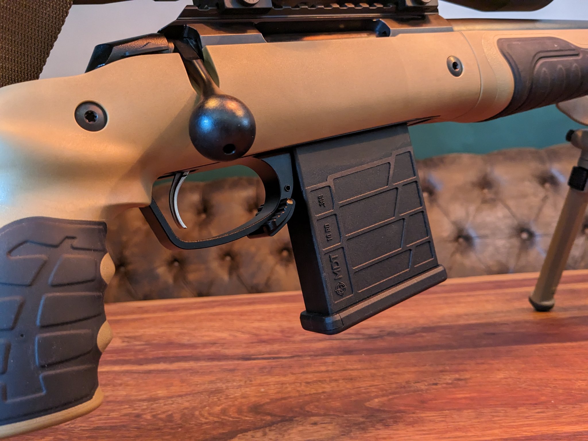

This quote came from KRG's website talking about using AICS mags in their selection of Tikka compatible chassis : Tikka rifles accept AICS pattern mags with the exception of the Magpul AICS polymer mags.
From what's been posted over the years the pmag was designed around the rem 700 actions.
They have a wider inlet.
The Tikka has a smaller inlet and the lips on the pmag are too fat to fit it.
You might give the MDT polymer mags a try they have thinner designed lips and the ones I have all worked fine on the Tikka's
That's totally true.
I run 2 5round and 3 10round MDT polymer mags in my CTR with Atlasworxs DBM. They just work smooth as butter as we say in Germany.
PMags have to be sanded down at lips on each side of the mag.
