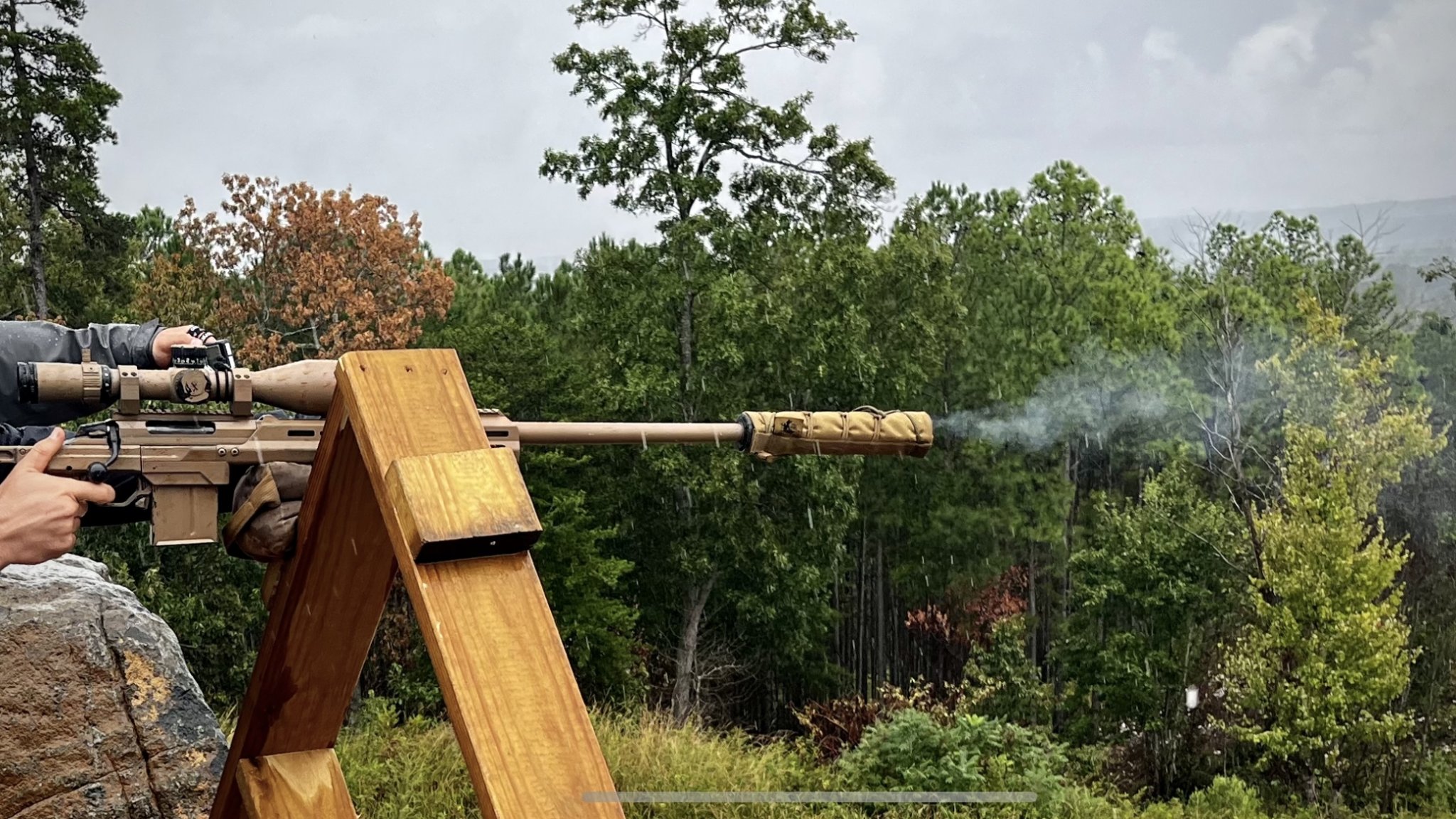

Not a fan of muzzle brake, but the heat mirage is mild vs suppressor, when you DO send the pills on.

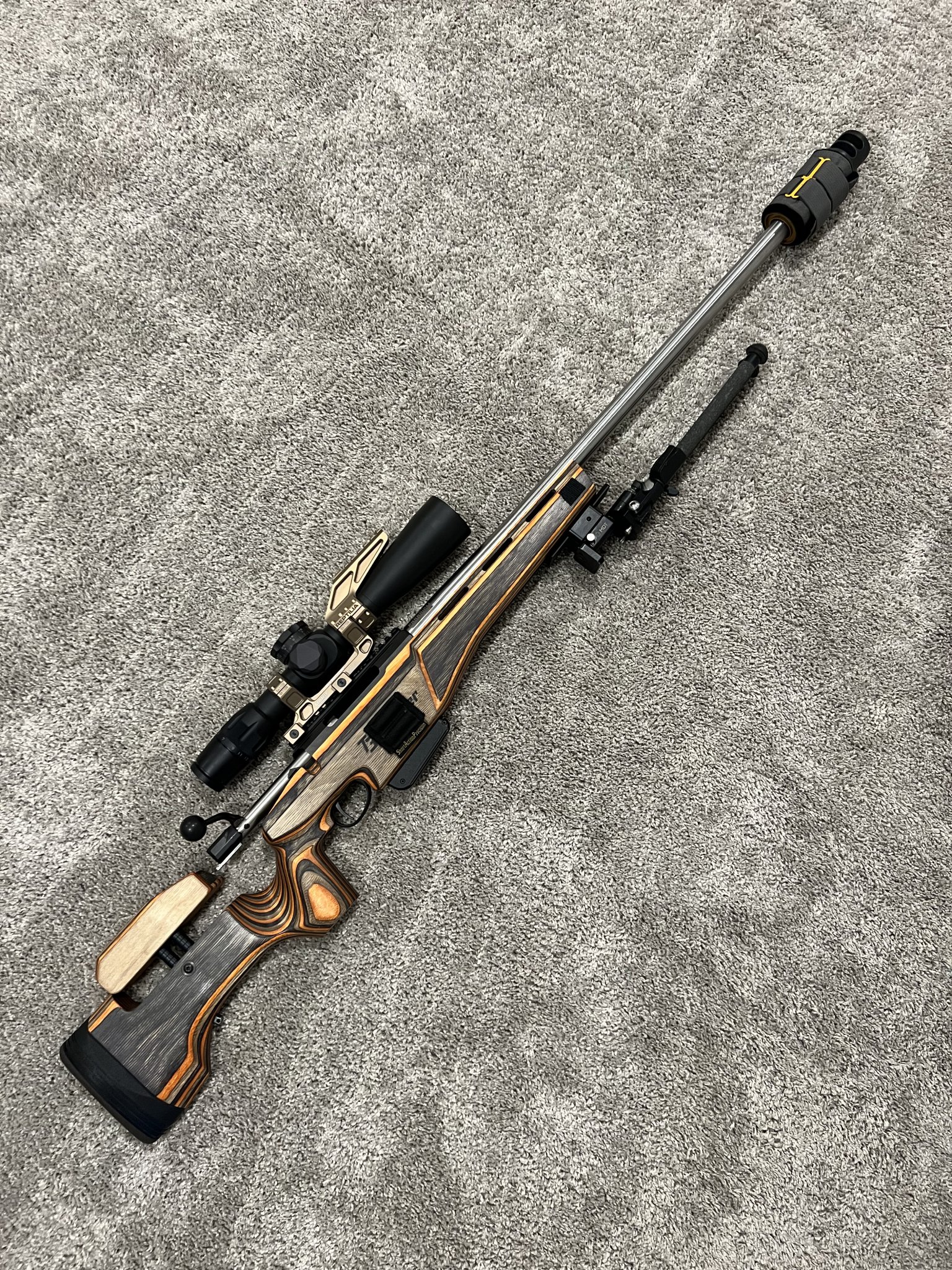

I haven't got the XRS, but if you are in Europe I would advise you to look at PSE Composites. I have the Etac mil spec for my tikka and it's absolutely fantastic. Still around 2lbs even with the extra reinforcement. My t3 with 20 inch 223 ctr barrel was 10.5lbs with 10rd aics mag, sling and 37oz dmr2 scope in that stock.
They have a few different models for tikka. Super stiff and light as hell. They do aics or tikka dbm inlet. Wait time was like 2.5 months for mine. Beats manners and McMillan by a mile for wait time alone. Great company to work with, emails back and forth within an hour or so during business hours. I know Edi the owner is on here sometimes. I can personally say PSE makes a killer stock and I'd buy another if I had another rifle.

They definitely have attitude. Had a GGS Ranger for my T1X first.. wanted a second one for my CTR, but got a lot of struggle. That's why I now use GRS in both of my rifles. But it's not 100% what I need. 🤔

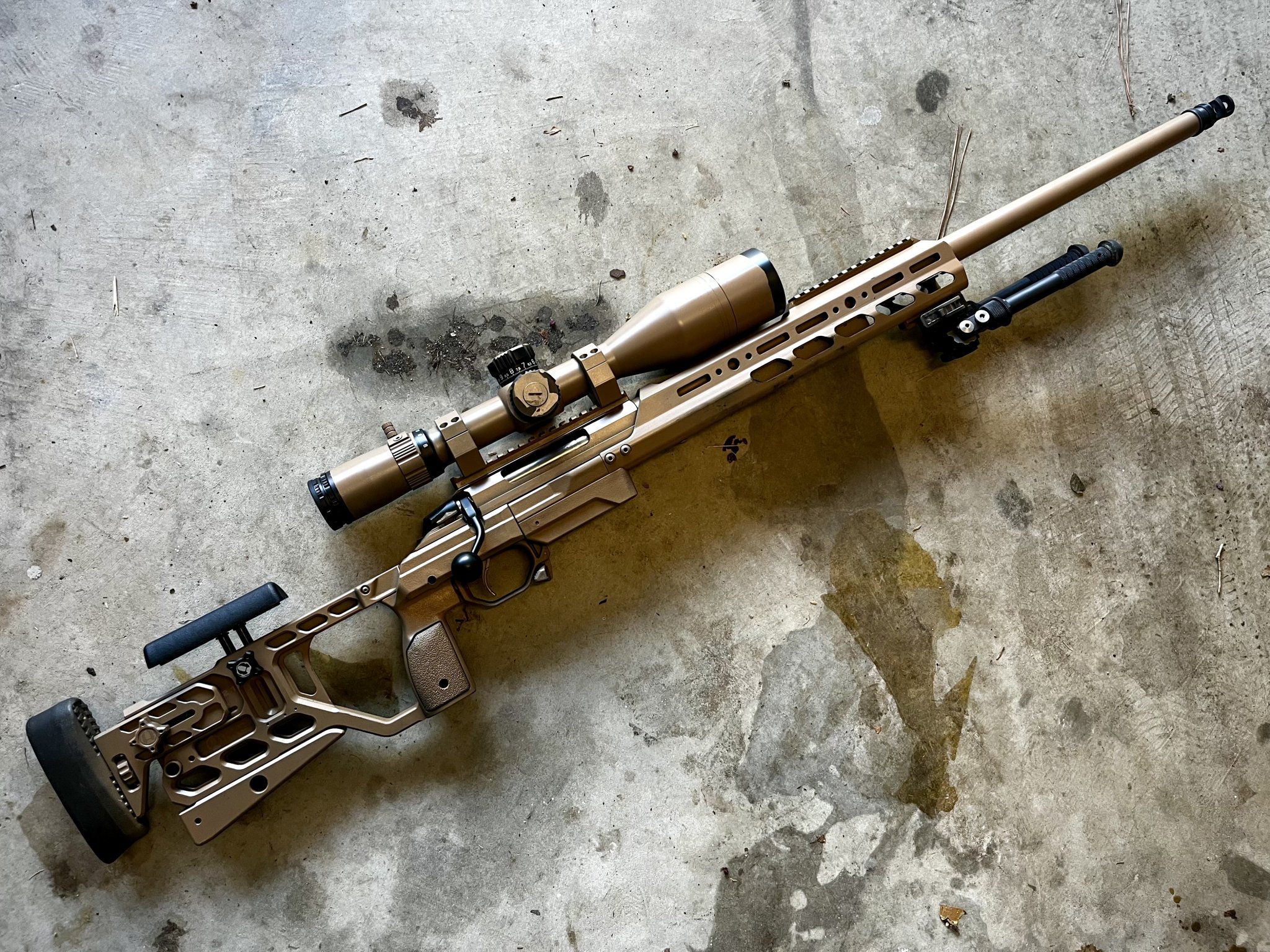

I shoot a Tikka in an XRS with the metal MDT mags and I love it! With the different grips you can change the angle as you wish.

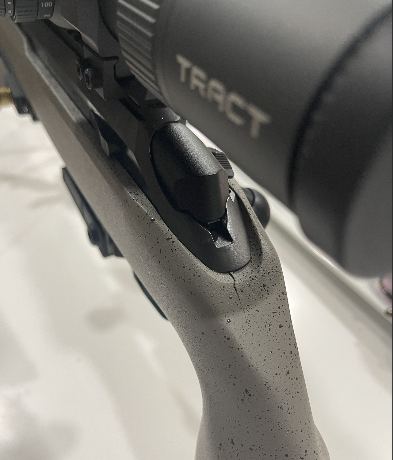

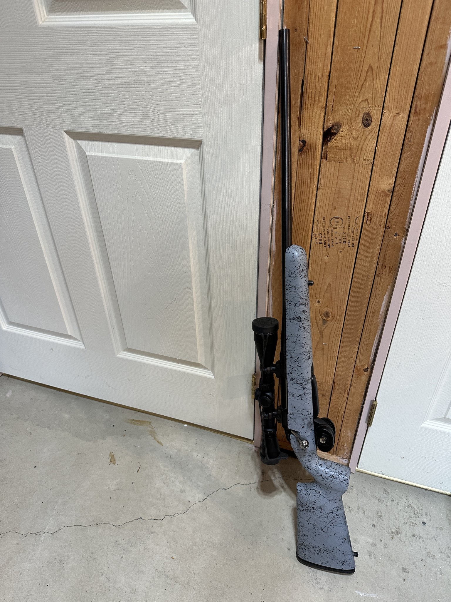

Well, two months in and I have a crack or delam going on with this UPR. Since it's off-center, I'm thinking it's just cracked and not delaminating.
I absolutely love this rifle, even the stock, but really disappointed. I should have just pulled the same action off a cheaper version and threw it into a Bravo or something. No, it has not been dropped, lives in a flight case and action is torqued to spec. Any ideas as to why this would happen? Can't imagine recoil would do this.
What cal? The stock is made of two halves (left and right) which are then glued together. As you said crack is off centre, so going through the composite.

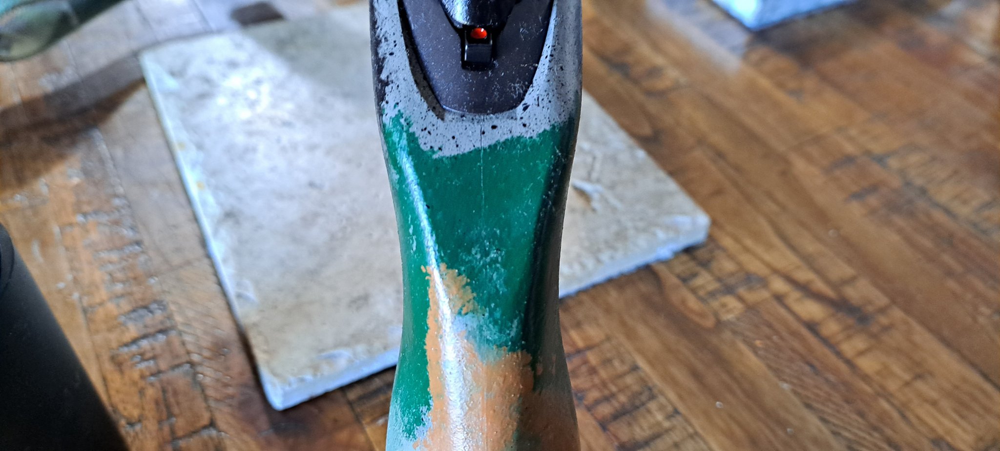

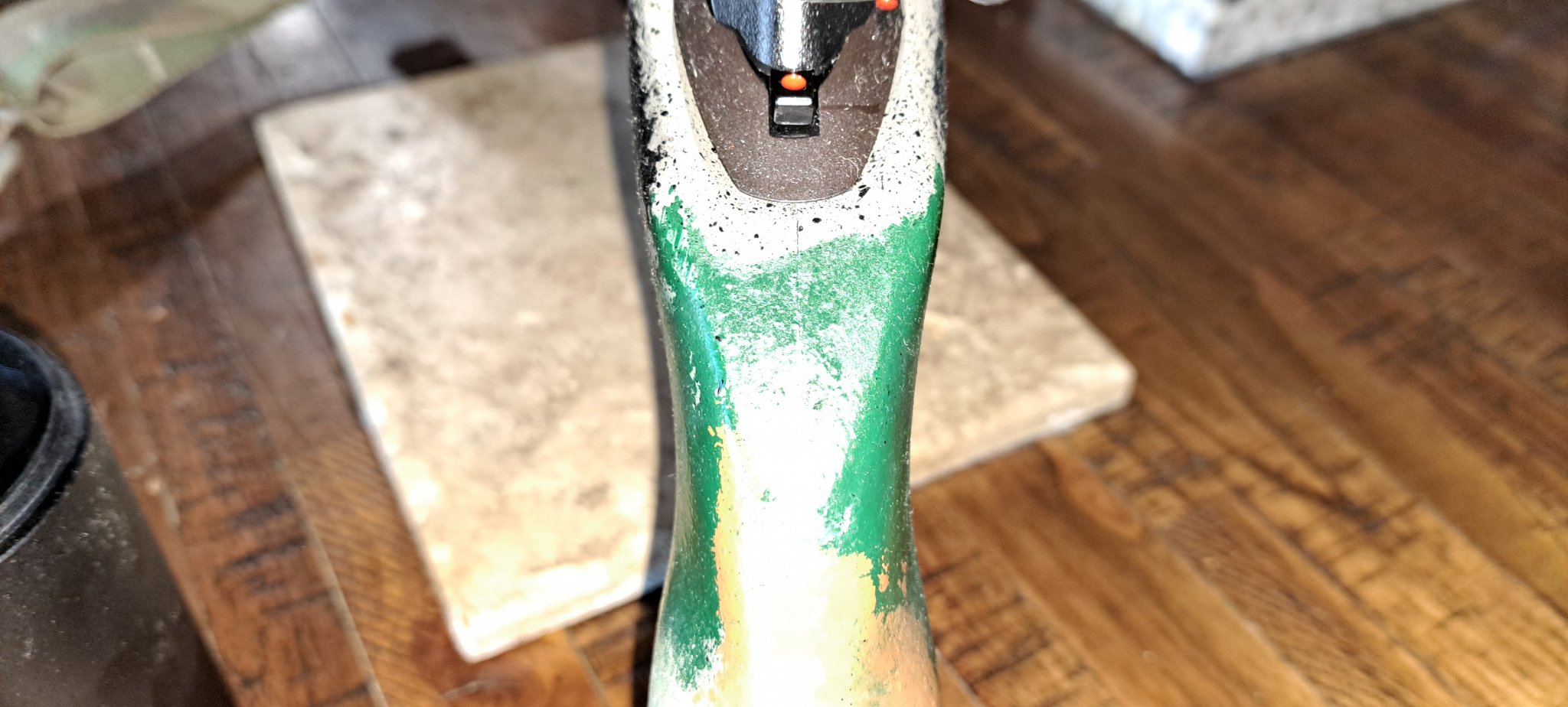

So I have to ask now- is mine cracked too?
I had understood this stock to be two pieces put together, so at first I just assumed the line was normal but now I'm worried it's broke?
Sorry about the terrible camo job and the photography ... it's actually easier to see with the flash off, I took one pic with on and one off.

To me that looks like delaminating and not an actual crack through the material like mine. If you track that line down to the orange, you can see where the two glue up together. I'd keep shooting if it's not getting worse. Mine is like a windshield spreading down

If you modified it they’re not going to honor the warranty, they don’t care if it has anything to do with the affected area. They’ve denied warranty claims because people didn’t send their rifle back in the factory stock for shit that has nothing to do with the stock.
If it were me I’d dremel it out, fill it with marine Tex, repaint it and bed it and call it a day and not waste my time with Beretta.

OK thank you ... I haven't shot it in a bit and I saw this and it made me worry. I wonder, is this a warranty type of thing? I am pretty sure when I bought it, they offered some sort of additional years of warranty if I registered it online.
But I know this company sucks to deal with.
Anyway thanks very much.

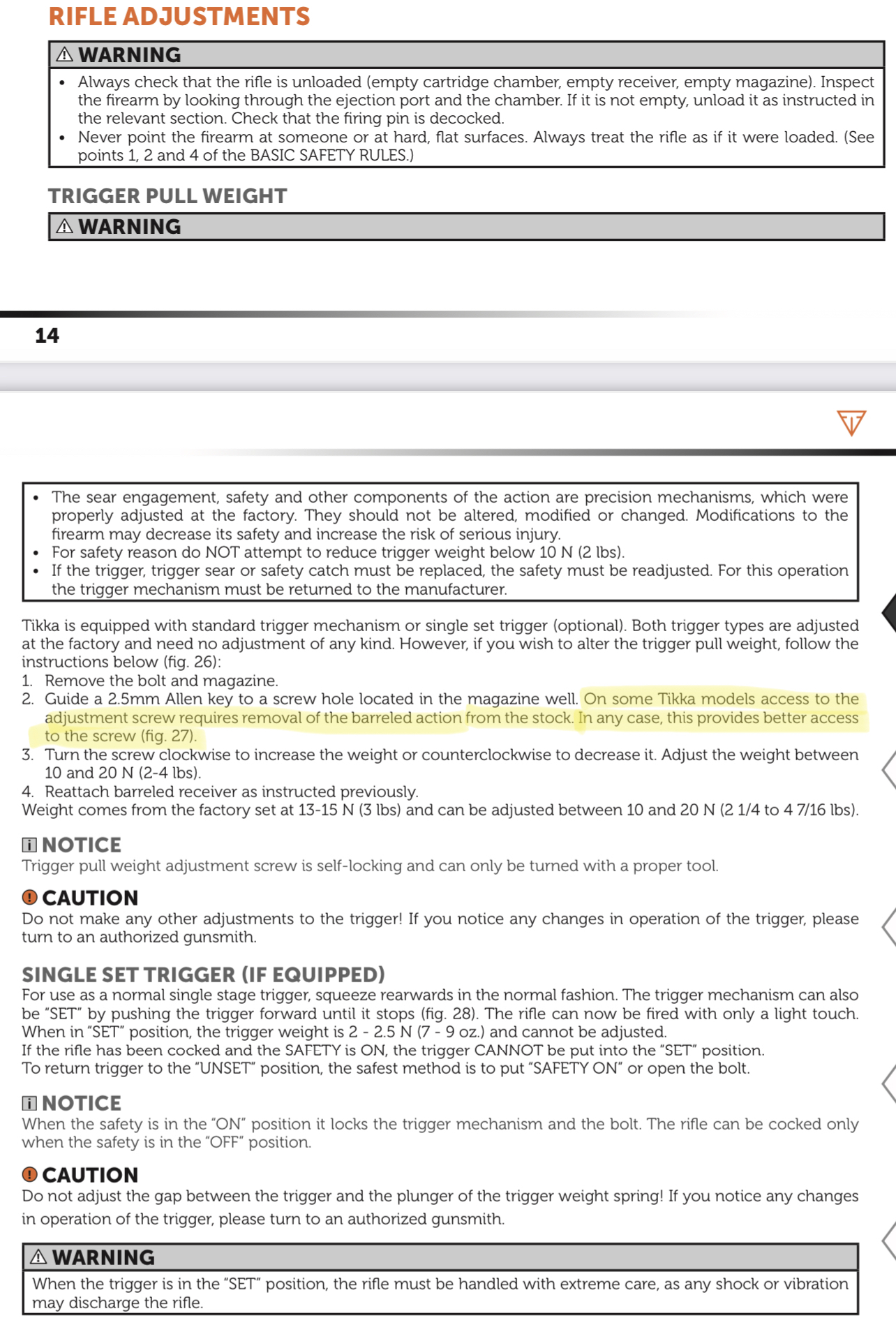

But one must take the stock off to adjust the trigger, correct? This is what I would say, regardless if I adjusted the trigger or not.
They cannot deny the warranty if they tell and/or suggest that the user remove the stock in their very own user manual.
