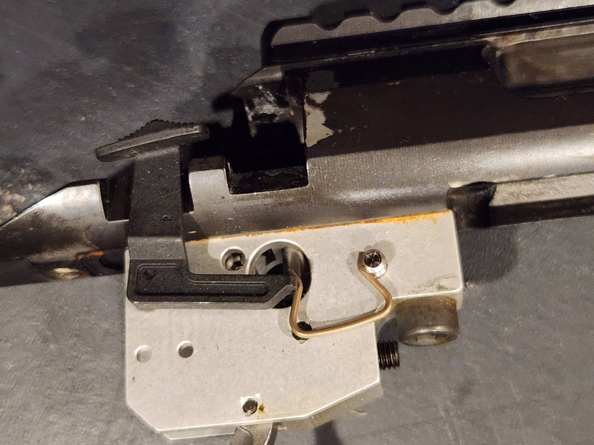

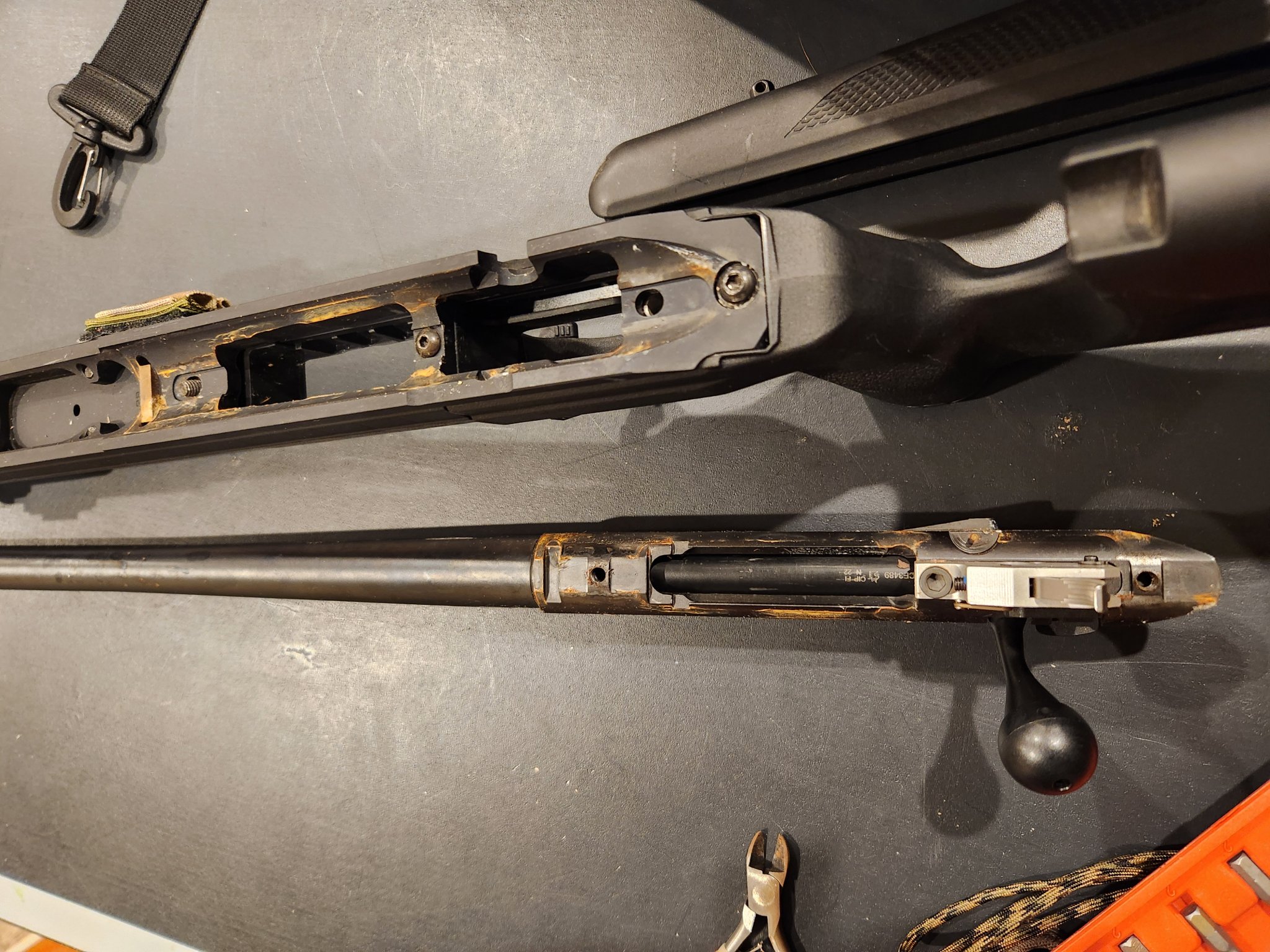

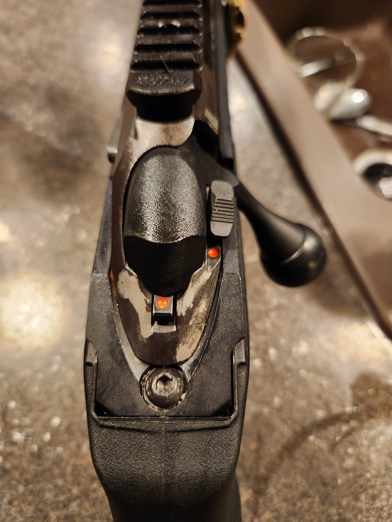

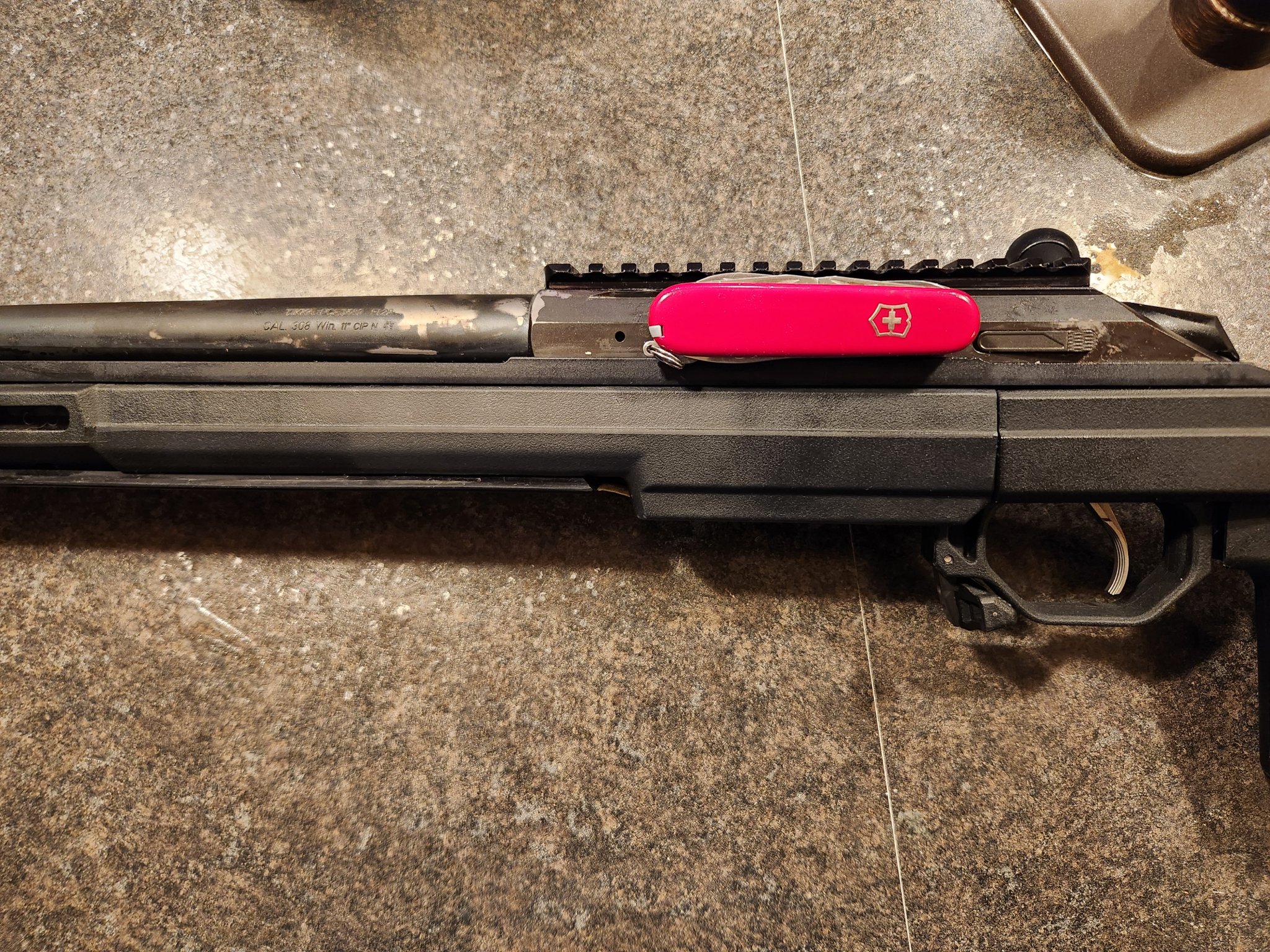

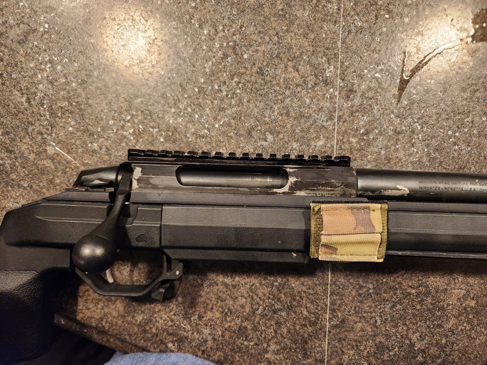

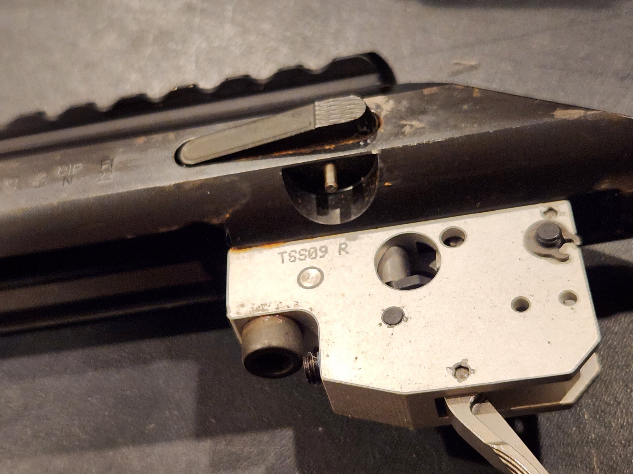

So.... I've got some questions and concerns about the finish on my Tikka T3X CTR in 308. Before people get too excited I need to say that I bought this rifle to get used, and shot. I expect it to get scratched up and show signs of wear and I see that as a badge of honor that a gun earns over time. My CTR was bought really for two reasons. 1.) I think it's just a good reason to have a decent 308 laying around ready to go because they're fun at the range, hunting, and take a military caliber. 2.) I like to shoot team matches where one guy has to use a military caliber and when your new guy partner has a 6.5cm, 6mm whatever or some other weird caliber it's nice to have a tried and true 308 that can be pressed into service to be "good enough" to shoot a match with.
Having said that, I recently loaned my rifle out to a buddy who went to Mammoth with his brother in law. His B.I.L. didn't have a rifle and I said borrow my 308. I expected the rifle to come back looking worn and would have been shocked if it hadn't. When I looked the rifle over though, honestly I was shocked at just how much that rifle looks like hell now. To be perfectly clear, I absolutely do not blame my buddy or his B.I.L. about this. I'm actually more shocked at how the finish just seems to have been wiped off like a chemical hit it, or flaked off in other areas etc.
Here's the thing, I honestly don't even really care that it looks nasty right now because ultimately I'll be putting a coat of krylon on it to make it look even worse. My question is if this type of thing is normal for a Tikka T3x CTR, because I'd been thinking of buying another in 6.5cm in the future just to have another spare rifle for hunting/competitions/or whatever.
I'm not sure if this matters or not, but I lent the rifle with both factory stock with tikka mags and KRG Bravo that uses AICS pattern mags thinking they could chose how much weight they wanted to carry. They opted for the KRG Bravo, and whatever corrosion showed up on it literally just wiped off. I've recently purchased a Grayboe to try out and the KRG Bravo will be going to the PX classifieds soon enough.
Is this type of finish wear and tear normal for a Tikka rifle?

My guess is all that Cerakote destruction occurred during some sort of coked-up ape cleaning-snorting / Asian hooker party.

Is that rust or the remains of your Cerakote lining the inside of your chassis?
I’d be a little worried about, well, every part on your gun but especially your trigger. Don’t want whatever that crap was flowing down into your trigger mech. I’d disassemble the whole damn thing to clean.
Does it smell like anything? Sulfuric acid? Lol
Do you have a “before” pic? Curious.
Man, scratch that fella off your ok-to-loan-to list. Holy cow.

I hate to say it but someone is phuking with you
Some kind of chemical was thrown on that bad boy to make it do that
Reactions: teddy12b
Steel Tikka actions have a surface finish, they aren’t nitrided like a lot of nice custom actions are. Yeah the finish is just going to come off if it’s getting thrashed for days in a backpack. Hit that sucker with some scotchbrite and then wipe with alcohol to get the rust off. You can get DIY surface bluing liquid if you want to cover the bare metal up in the area where the action sears into the chassis. It won’t color match what’s on there.
Congratulations on having gun that looks like it’s been used.
Reactions: teddy12b
Is be asking this “friend” to cover whatever it takes to fix this rifle
Reactions: Big Bo and teddy12b

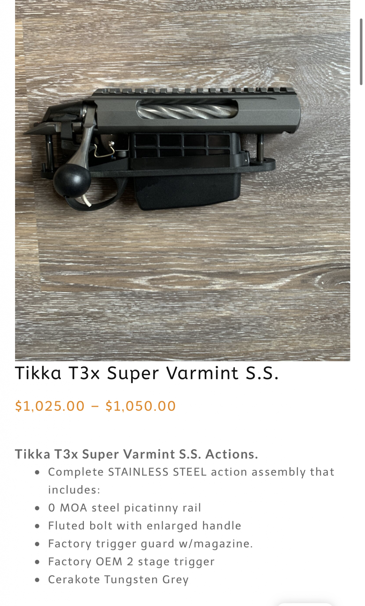

Tikkas either come as bare stainless or as coated carbon steel. The action in question is steel, the action and barrel are not stainless underneath.
According to a few sites:
https://jaoutdoors.com/product/tikka-t3x-super-varmint-s-s/#:~:text=Tikka T3x Super Varmint offers,ready for hunting, are you? (seller of used Tikka parts)
This is not absolute proof, of course.
Maybe this rifle in question is indeed carbon steel. But just saying some Cerekoted Tikkas sure seem to be SS.
I have read in a couple places that some SS Tikkas do rust more than other brand’s SS actions. Or perhaps there was a batch of them that did. After all, SS used for guns does does contain carbon and can rust.
It’s dumb that Tikka doesn’t say what it’s made of on their site.
Don’t make me call Tikka lol
Edit: in my above screenshot, I note the pic rail is called “steel”.
Not going to lie, it does look like Charlie Sheen and Hunter Biden partied with this rifle.
Any rust on any of the parts really just simply wiped off. I was more concerned with the finish coating over everything else because this rifle will see rain again many more times.
The action in question is a CTR, which comes only as bare stainless or treated carbon steel. There are some Tikka actions, like the Super Varmint (stainless) and the Roughtech (either stainless or carbon depending on the model), that come with factory cerakote. The rifle in his picture is just a surface treated carbon steel material like a regular factory Rem 700.
Ah, you were referring to just CTRs, eh?
Well, a @carbonbased CTR (har har de har)…now that would rust as shown. I missed the poster’s mention of CTR.
Scratch the acid-cleaning suggestion, then, as no Cerakote was involved. @viking78 ’s suggestion of in a wet bag for days seems on point…although I’ve had rust start on a carbon rifle after a list misting within three hrs stored in a case (I was eating at a restaurant ok! lol).
I sorta hate blued rifles for this reason. They look nice though.
Edit: For all I know the Mammoth was a rain-soaked affair. Two day match, right?
If I had borrowed a rifle, there’s no way in hell I’d return it like that, even if it had unavoidably rusted during the event.
I would’ve at least cleaned it up so there wasn’t rust staining just lying about like some old whore. lol. If the BIL of your buddy didn’t clean it up, then man, your buddy should have.
Did they ring your doorbell, run away, and leave it in a wet paper bag on your doorstep?

The aluminum in the chassis caused a galvanic reaction with the steel, dissimilar metals do that
That isn't galvanic corrosion, it's straight up rust. Anodized aluminum can't experience galvanic corrosion anyways - it's anodized, the surface is now a different chemical structure. The aluminum is fine. It's a steel action that got soaked and beat up in a backpack.
If you have high alkali dust mixed with with moisture, not only will it hold the moisture but it gives the the moisture an electrolyte for dissimilar metals and galvanic corrosion.
Stainless Steel and aluminum don't play well together in sea water DAMHIK.
Austal USA will tell you all about it with the early LCS Vessels. Any damage to the paint coating near the stainless steel wear rings in the water jets became a major issue with corrosion pitting on the aluminum hulls in sea water.
They got a handle on the issue with better coatings, more sacrificial anodes and using a cofferdam and compressed air to keep the water jet intakes dry while the boats were stationary. Yes, I have first hand experience with the LCS, JHSV and EPF Programs.
Reactions: x0mb13
Dude - it's bare steel that got soaked with water and rusted. IT ISN'T STAINLESS. I don't know how many times I have to repeat that the guy's action is made of a carbon steel, and is not made of stainless. There isn't some hoodoo-voodo magical anodic corrosion that happened in three days. Guys get waaaaay too cognitive about anodic corrosion. There is very little anodic corrosion outside of extended periods in saltwater environments. It's just steel with water trapped in a spot that it can't quickly dry out...

Not to throw shade on your friend, but I was at Mammoth and Friday night until around lunch Saturday it rained. Lots of people weren’t ready. Due to nature of match lots of people and gear exposed to elements for long period of time.
Additionally, I saw a some of surface coating come off my Grayboe stock where it contacted pack buckles/zippers over the 27 miles or so. When you ruck run things move around and jostle a lot.
I dried stuff out throughout rest of match and put everything in front of a fan when I got home.
I 100% get it. I've been to Mammoth twice and took a different rifle each time. That's why I was really shocked to see all the finish off the gun as much as it was. The surface rust was to be expected as far as I'm concerned, but where the finish just completely came off was a really new thing to me. From what I heard, the Mammoth this year was a great one to miss as far as the weather goes. I'm looking at doing the 2025 mammoth, and it's very likely this 308 will be going back with me.
