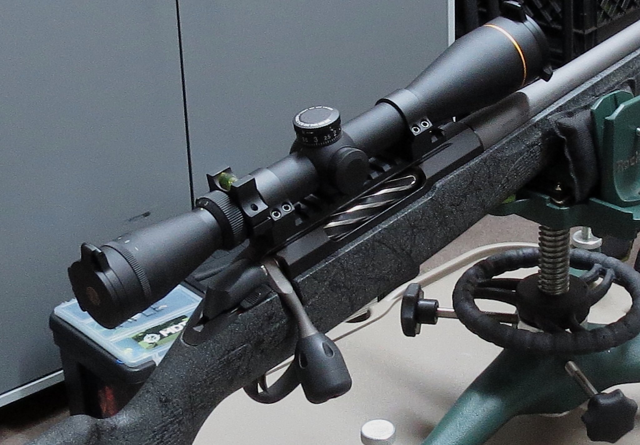

Anyone had their bolts fluted by LRI and have you noticed any difference in feel once you did? I’ve heard that the fluting can make them ‘less smooth’ but I’ve never felt one myself. Figured I would ask before having Chad & Co. go to town on mine.

I’d be very interested in this feedback as well! Love the ‘buttery ness’ of Tikka actions, and have long wondered if spiral fluting hinders that.
Absolutely not !

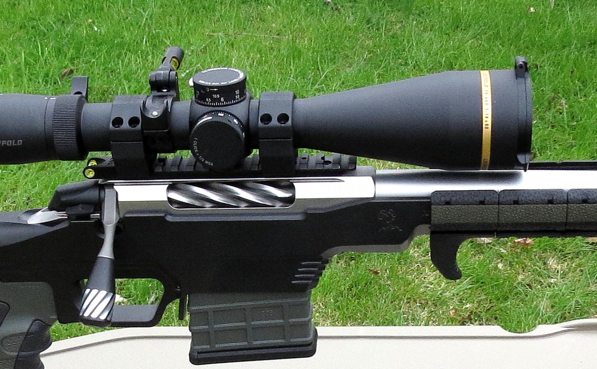

I've had LRI flute two tikka bolts and they both run just as smooth if not smoother than they did before.

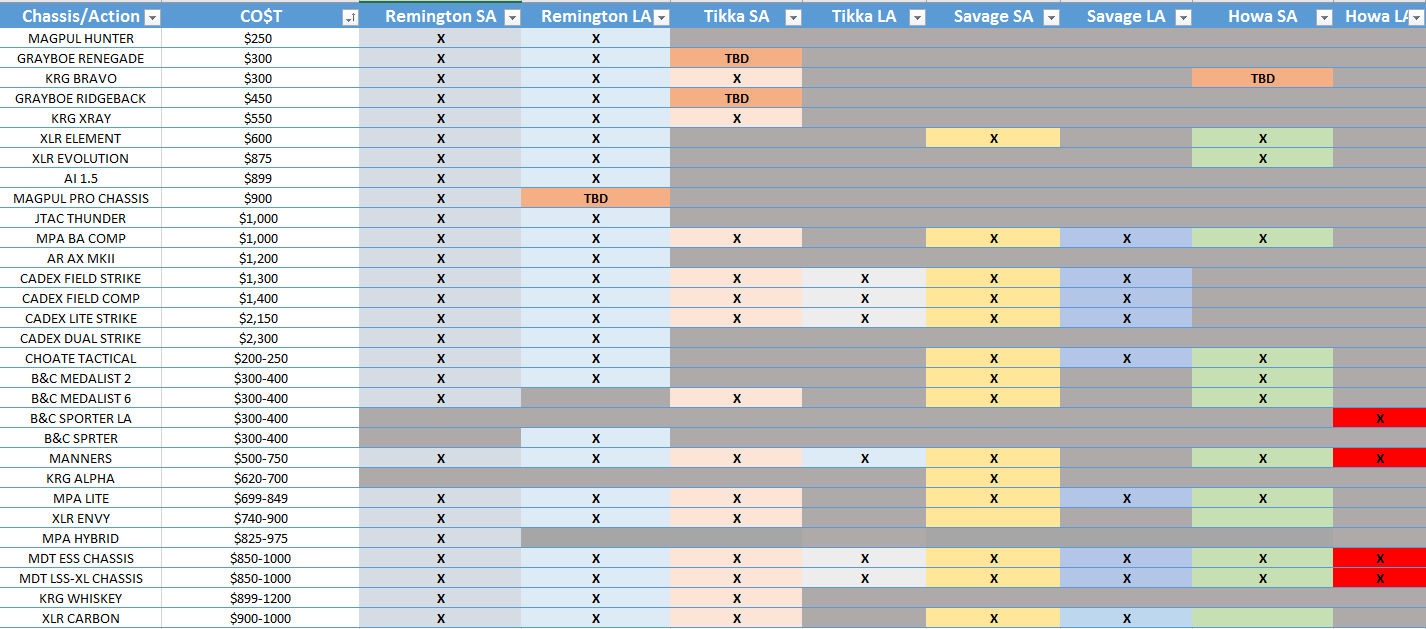

Here is a tikka buying guide 101 condensed from my own research and reading this whole giant thread and other tikka threads. The 2 most important criteria is action options and bolt face (changing that is $400).
T3x action you have 4 options. (note all are same length)
Blued righty
Blued lefty
Stainless righty
Stainless lefty
Bolt face you have 3 options. Some bolts are factory fluted.
223
308ish
Magnum
Bolt stop length is a part that can be changed.
Barrel options are generally 4 as well
Blued thin (2.5-3ish contour) non thread (9/16 at most possible) possible factory fluted
Stainless thin (same) non thread (same) possible factory fluted
Blued heavier (light Palma per @bohem ) threaded
Stainless heavier (same) threaded
Ed: there is also varmint which is slightly heavier than the ctr but isn't threaded. There is a super varmint that is threaded. Not sure on contour vs varmint.
Trigger you generally have 2 options
Two stage trigger (Tac A1 and Super varmint) 3 position safety on A1 and 2 position on sv.
Excellent single stage (all others. Some change out with a $10 trigger spring. Fewer change out to a different trigger. This ain't like Remingtons)
Note from all that I have seen here in this thread the factory barrels all shoot great. Barrels are chf and pretty much same as Sako. Some may be a little slow (per @Lowlight and a few others). Also they may be throated a little long from what I have heard.
Magazines you have 2 options.
CTR pattern 5 or 10 (Tac A1 and CTR only. 10's come with. Extra 10's cost on par with steel aics)
Basic tikka flush fit sized
Note most chassis only fit short action aics only. Somebody somewhere on the hide went through and created the spreadsheet attached. If I remembered who I'd credit.
Magpul aics Do Not work with any tikka without Extensive filing of feed lips which makes them prone to troubles.
Tikkas generally do not need blueprinting to work. The general consensus is you could but why waste the money? Aftermarket shouldered pre-fit barrels are made by a few different companies.
Pic rail.
CTR and tac a1 come with 0 moa rail. Rail pretty much has to be removed with heat of some sort (clothes iron or blow torch and then scraping off residue.)
Actions come with a dovetail that spuhr (and maybe a few others) makes stuff that fits. 20, 30, and I think 40's are available. (Currently no tac a1 specific slanted rails exist that match fore end.)
Bolt handles are dovetailed in. Swept are available from some. Metal shrouds are available as well. Reviews and pictures are in this thread. Aftermarket are available from
Sterk (@cannoncrossfire )
Glades armory
Anarchy outdoors
Mountain tactical (tikkaperformance.com)
When you are looking at tikka and you are in the USA, make sure you are looking at the en-US site. http://www.tikka.fi/en-us/rifles
It is tempting to look at the other international site http://www.tikka.fi/rifles but they don't import alot of those options.
Aug 2019 edit
Aftermarket trigger options
Yodave spring or similar $10
Krg midas 2 stage trigger top safety $289
Timney 430 2 stage trigger. $248
March 2020 edit. Krg Bravo is now available with ctr mag fit.
Oct 2020 update.
If you want to have an aftermarket 2 stage trigger on a left handed tikka you will need to get a slot milled in the right side for the safety. Or move the safety (carefully) from the left handed trigger (works on midas). @K2e2vin has done it.
March 2021 update.
Long rifles Inc now has aftermarket bolts available. Jan 2024 update.
Www.Choose.tikka.fi/usa shows lots of great options but per a conversation with the Beretta Dallas flagship store they won't order anything in that ends in MTB. Stupid teasing. The ones that they import start with JRT
August 2022 update: added bolt fluting and barrel fluting notes since they weren't in there.
Hope this helps. If anybody knows more about other options chime in.
July 2023 update
Super varmint update. Sv has single stack mag. Sv has 2 stage trigger. Cheek piece is adjustable. Bolt is fluted. Barrel is threaded. Epoxied 0moa rail. Stock has some texture. Not sure if stock is stiffer. No left handed options.
March 2024
Havent seen @cannoncrossfire / Sterk in a while. He is still making his parts.
Also updates to triggers.

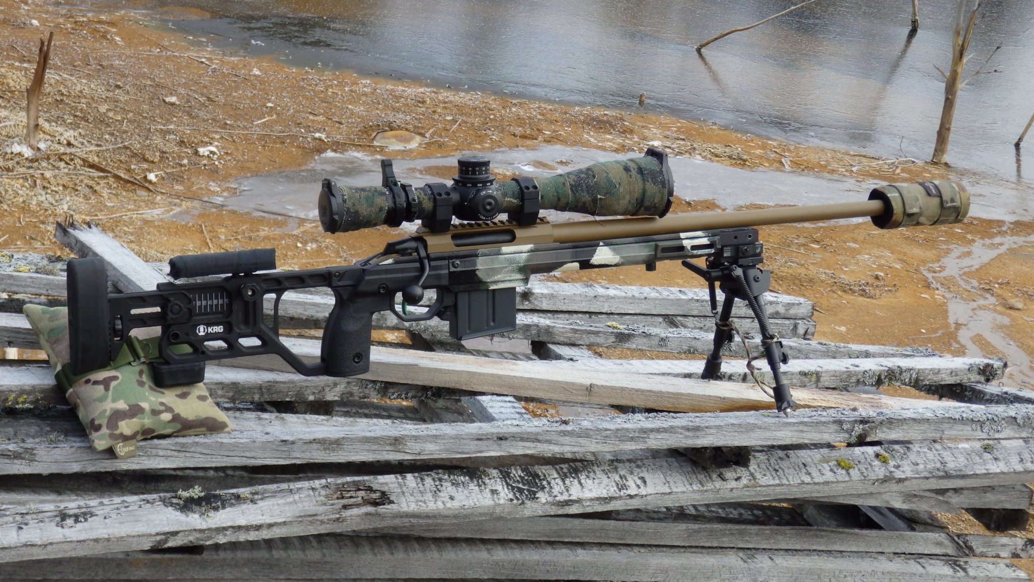

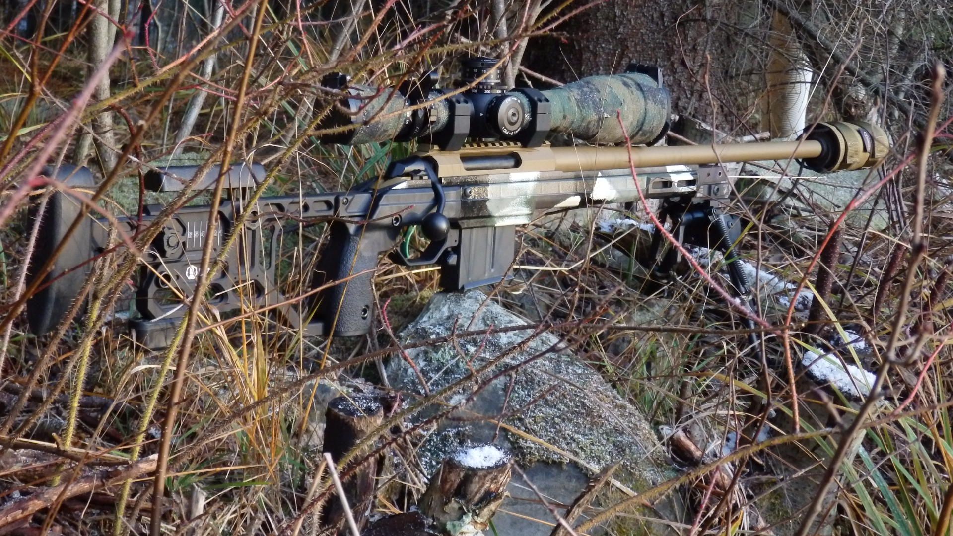

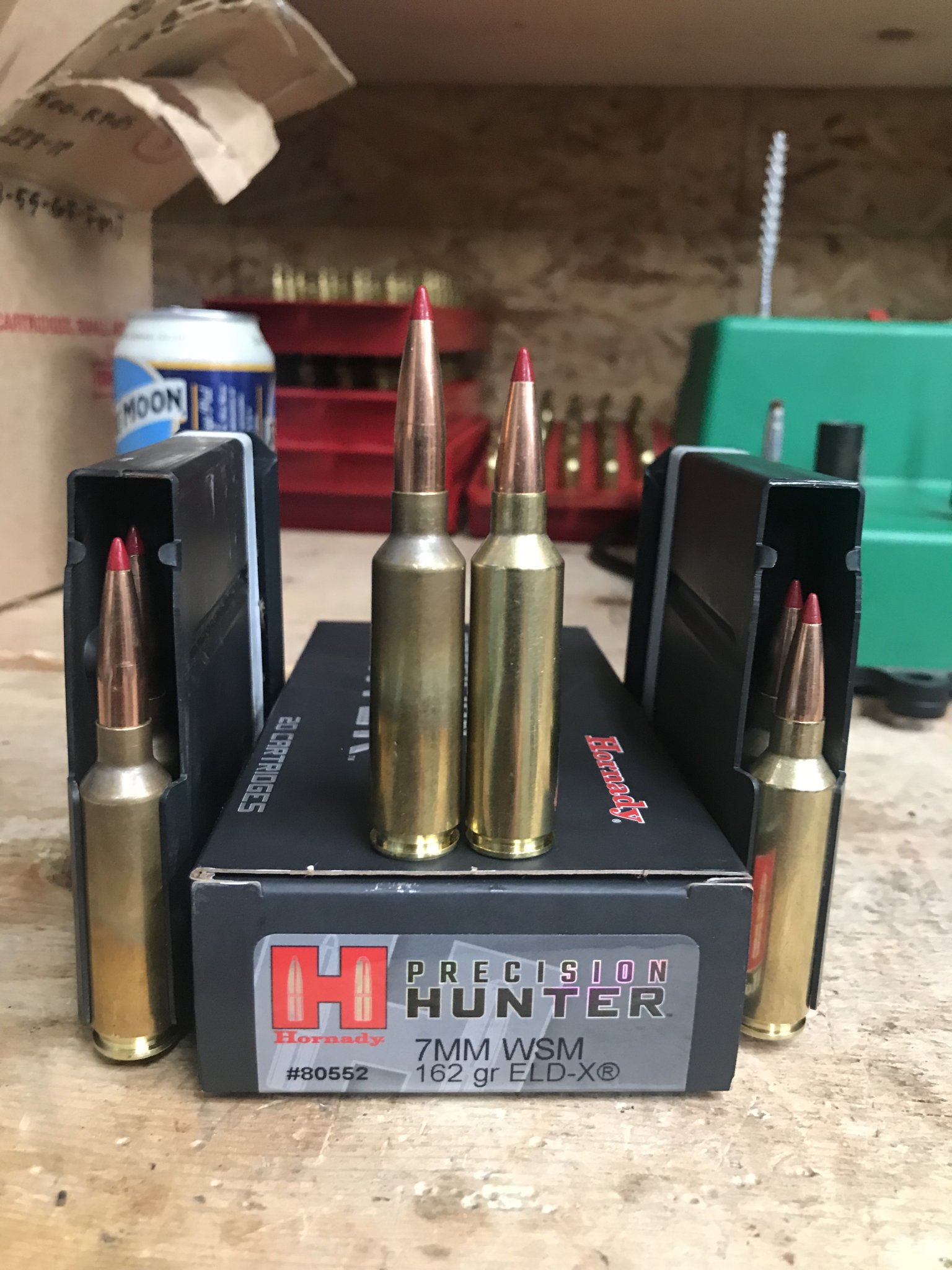

Thats why I went with MDT LSS-XL Gen 2 for my 7 WSM. I load nearly to 3.2" COAL with long action MDT magazines for the Tikka with plenty of mag space. Still feeds like butter even with factory 7 WSM loads as well a 2.860" SAMMI stuff.
Disregard the sling. It’s a long story ;)

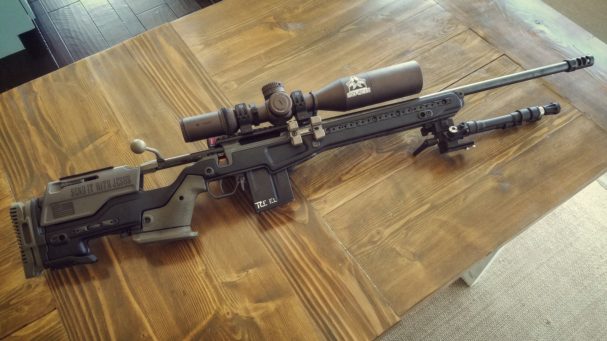

Tikka CTR 6.5CM 24" Factory Barrel
TIkka Performace Elite scope rail
TImeny 2 stage trigger
Hoptic 2 round quiver and cheek pad
Sterk Handle/shroud @cannoncrossfire
Little Bastard Brake
ARC10 Rings
Vortex Razor Gen2
Evo Bipod
J Allen Tikka Chassis
The thing is almost perfect, once the Arca rail gets in it will complete the package. The wait was well worth it. J Allen is making their own bolt stops to replace the factory when you drop it into the chassis, they also have a set screw below the pin the keep it from backing out. It is user adjustable SA to LA with the change of a collet that you buy separately. I will get more pictures once the Arca rail and new bolt stop show up.
ARC10 Rings
Vortex Razor Gen2
Evo Bipod
Oh man... that's beautiful. Well done!

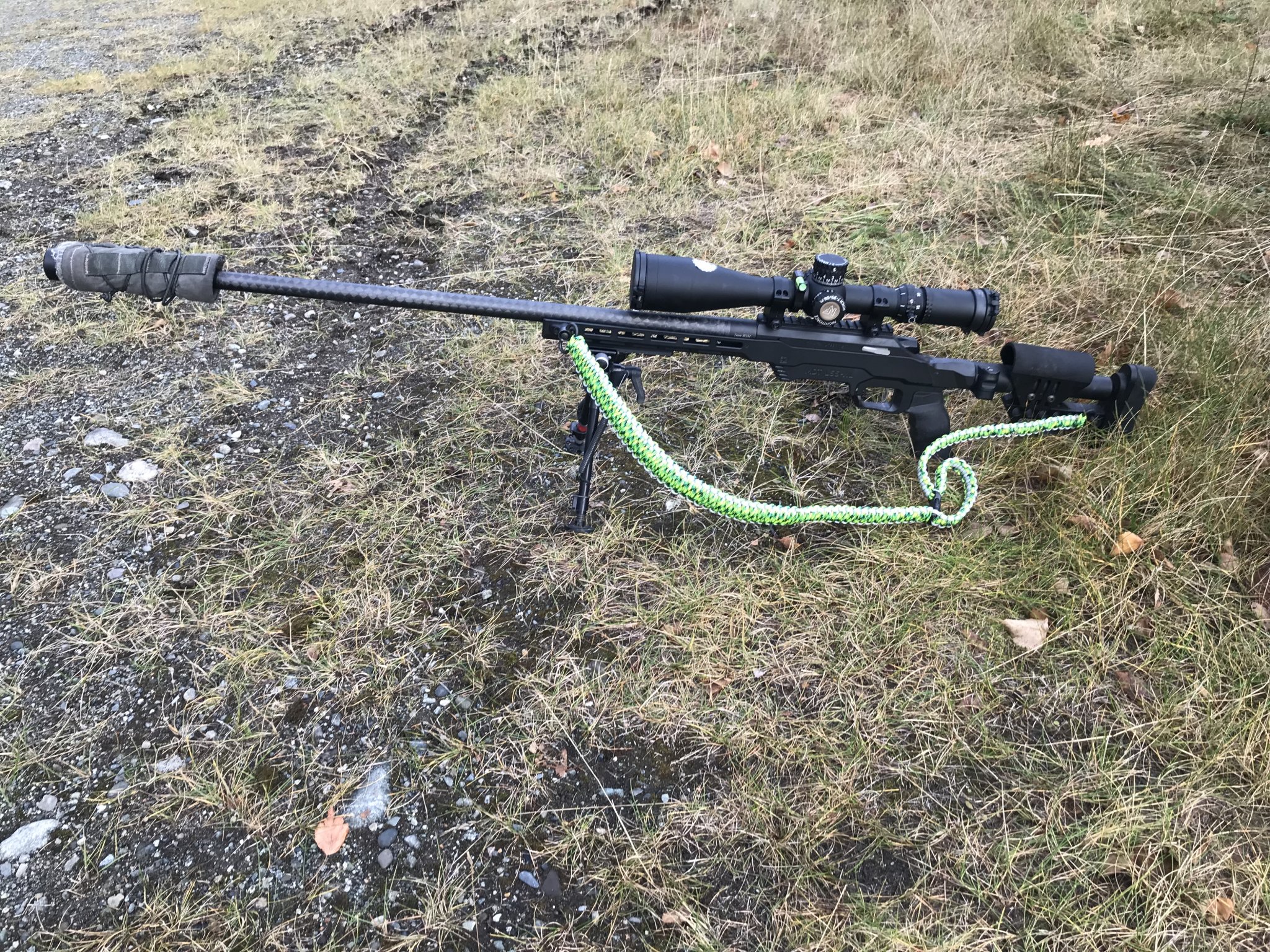

Just got my Tikka t3 lite threaded today, can't wait to get the scope mounted and go zero on sunday. Always wanted a lightweight hunter that was suppressed. .308 and 9/16-24 threads.
Who did the threading? Did you have to cut down the barrel at all or is there a decent shoulder behind the threads with a 9/16-24 rate?

Tornado Technologies did the threading. There is just enough to place a washer and time my thunder beast brake onto it.
