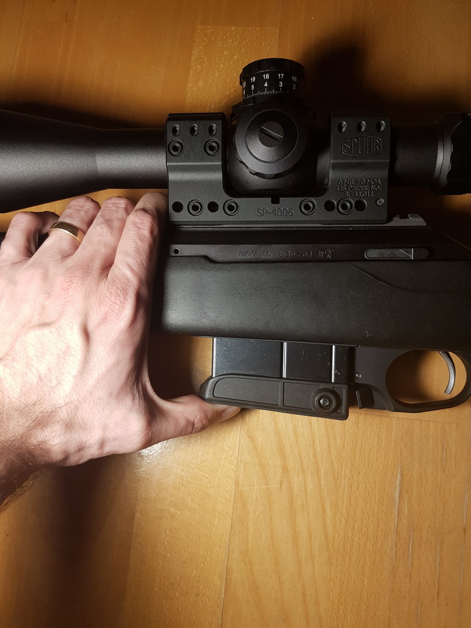

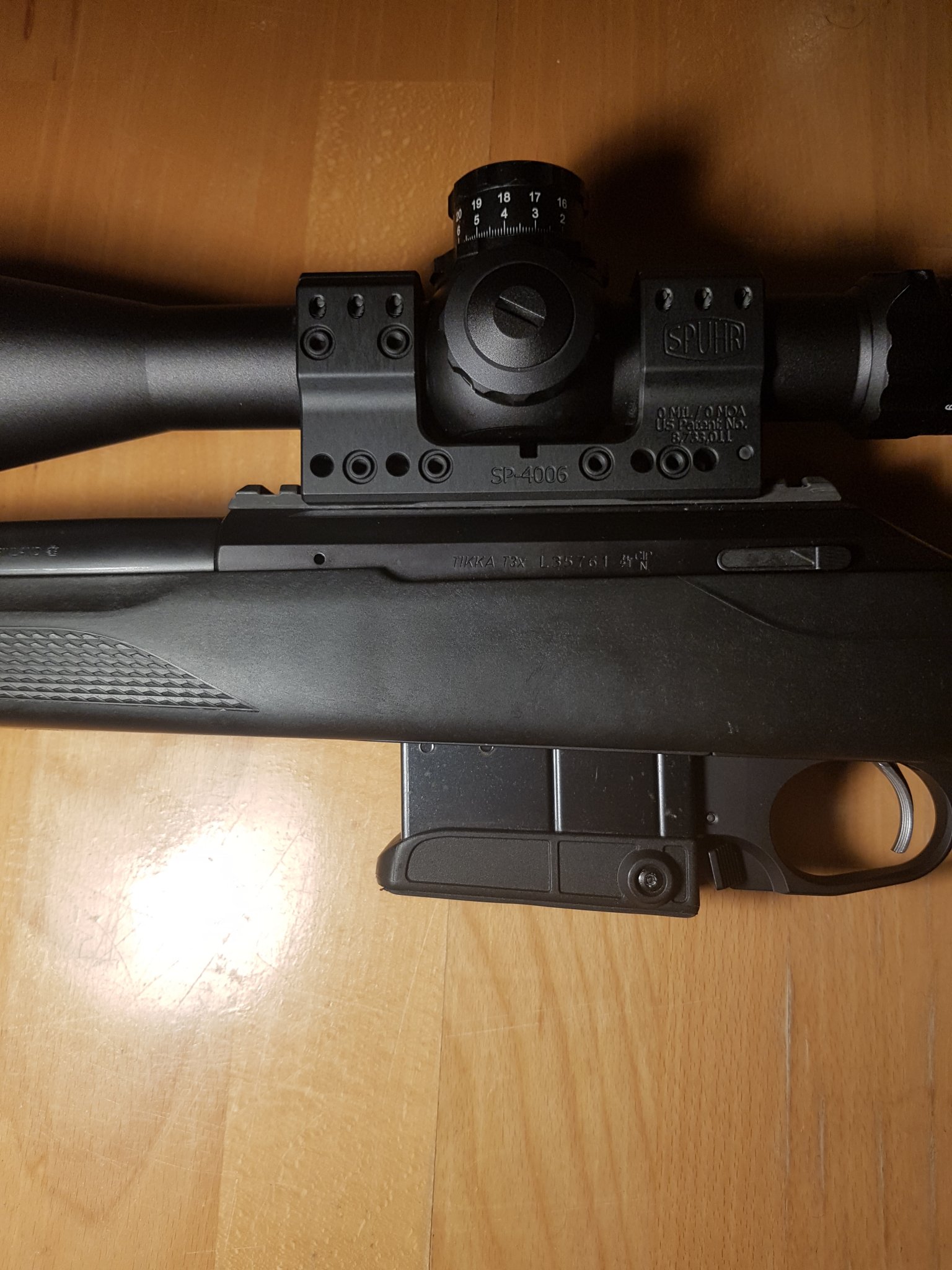

Here's my problem:
Doesn't feed:
Feeds:
Note how the round spot welds in the front of the mag shows in the top picture. Upon examining the magazine, I don't find the follower to be out of place in any way. It's as if the magazine is too short along the axis of the cartridge, so that it can't rest against the walls of the magazine well without tilting forward.
Am I really the only one with this issue? It bugs me when I'm shooting, because the bullet will often get stuck along the way to the chamber...
Except for this weird fault, I love the gun. It's my main hunting rifle for the time being, as my old Sako is temporarily broken.
Here's my problem:
Doesn't feed:
Feeds:

Here's my problem:
Doesn't feed:
Feeds:
JGR was spotting it right.
You have removed your stock off one point, and when you have put it back together, you have not seated it right,
That over pressure hole is closer to the stock, your front is not seating properly.
Loosen both screws, and set it up right, you can see, are your action seated right, when you look in the action from magazien weld.
Precision to the game ;)
Check this picture, and you see, how close to stock that hole is.
Reactions: JGR1953

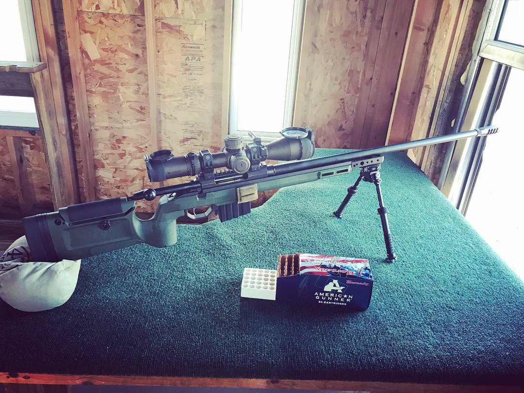

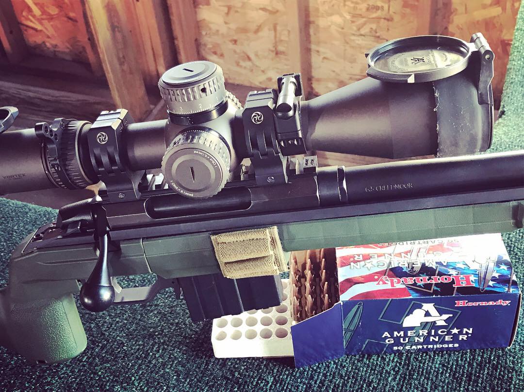

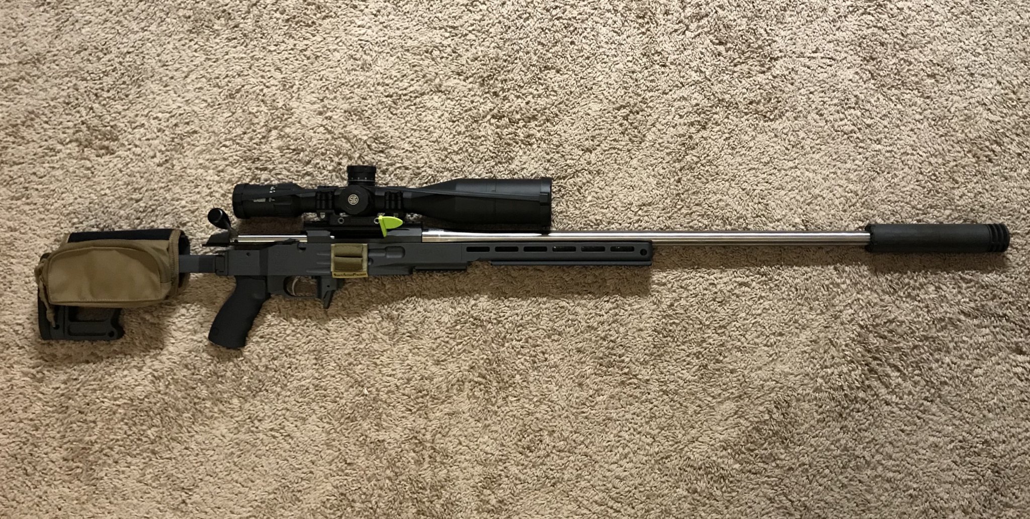

I pre-ordered the new MDT vertical grip a few weeks back and it came in yesterday.
Setup is a cerakoted CTR action (blot fluted) in an MDT HS3, which I have modified with a barricade stop in front of the magwell and a cheapo Amazon Acra rail up front. Still need to trim the rail to integrate better. The new grip is not a perfect fit for this chassis. I posted first impressions HERE as well.
Going to run this setup until the ACC chassis is available in a Tikka inlet.
So that vertical grip can be used in every ar style mounted grip?
Is it rubberized?
MAN, I think i want this :)
Is that a tango 6 4-24 and how are you liking that scope in comparison to your other ones?
Does it compare in any way to the 2nd Gen Razor?
It was a Tango 6 but it was 5-30x56 model. Nice scopes, they are made by LOW, just like the Gen 2 Razors. I would say they are very comparable to each other. Glass in the Tango 6 is very nice, turrets and tracking are good, and they have a nice mag range. The one downside to both of them is really size/weight - they are both massive.
I would go with whichever one you can find for cheaper. I personally love the DEV-L reticle, so that also played a factor in my decision.
I’ve since sold both of those optics so I can move to new MSR2 optics but wouldn’t otherwise be upset to go back to either the Tango 6 or Gen 2.

I tried taking it apart and putting it back together after reading JGR's post. Couldn't get it any tighter, but I tried again just now when I saw that you were of the same opinion.
Now the bottom of the hole is tangential to the top ridge of the stock, just like in your pictures. It's really a good 2-4 mm tighter now than before, even though the screws felt completely bottomed out. You guys were completely right about the wiggling when you seat the action in the stock. The mag still wiggles and rattles a bit but the possible up/down travel is noticably less and it feeds perfectly.
I guess I now have a good idea of why accuracy was kinda mediocre during my ladder testing... Oh well, at least I did not shoot the chrono.

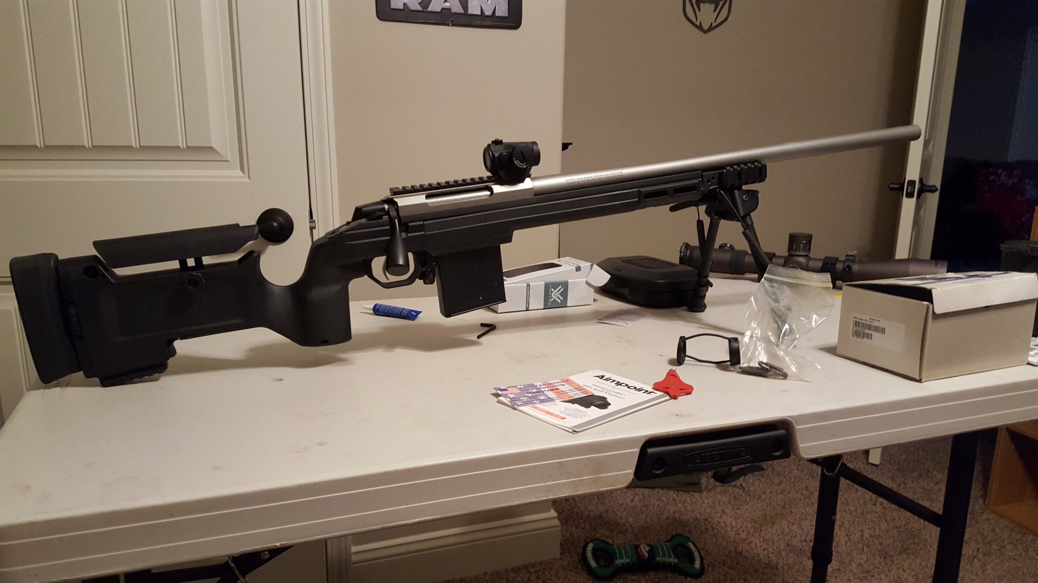

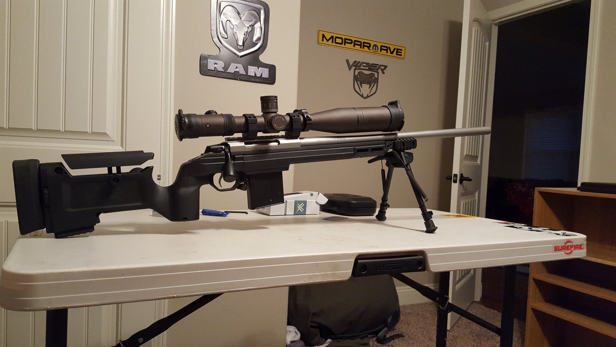

Are you going to stick the Vortex in between the red dot and the rifle, or are you leaving it like that?
LMAO it was a joke; I have a Micro H1 laying around and figured I'd see what it looked like. Not a bad setup for a pencil barrel rifle, but not for a heavy barrel gun in a chassis.
What I was actually doing was replacing the 1.00" rings with 1.26" rings so I could move the scope back slightly and maybe add a clip on mount (still on the fence on that one). The chassis has an adjustable cheekrest height so the height over bore doesn't matter anyway.
Here's before and after:

I am so impressed with my Tac A1. Went out for load development over the weekend. 150 rounds expended, 2 bullets (143 eld-x, 140 RDF) 2 powders and varying overall length, largest 5 shot group was one inch, average just under 1/2". Several best groups were bug holes. It was just so consistent.
Hate loading those magazines though. Saved a couple of hot loads for 300 yards. Just under 2" with swirling 4-8 mph winds from 3:30.

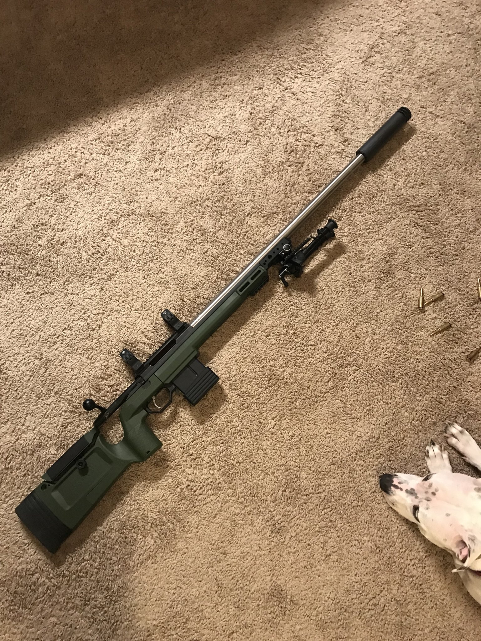

Just have to show off the newest member of the family. Bought off another Hide member...Specs are:
Tikka T3X action
26” PVA Prefit Rock Creek barrel (light palma contour) & Barrel Nut from PVA
Seekins Precision ATC brake
Elay Precision trigger spring (1.3 lb pull)
Sako green KRG Bravo with spigot mount
Atlas/ADM with HHC Talon feet
20 moa scope rail
ARC M10 scope rings
Vortex Razor HD Gen2 3-18 with ebr 2c mil reticle & SV-3 throw lever
Flatline Ops bubble level
So far it shoots awesome, but I’ll probably chop the barrel to 22” to make it a little less cumbersome for hunting. Next up is a titanium bolt shroud and bolt handle from Sterk.
