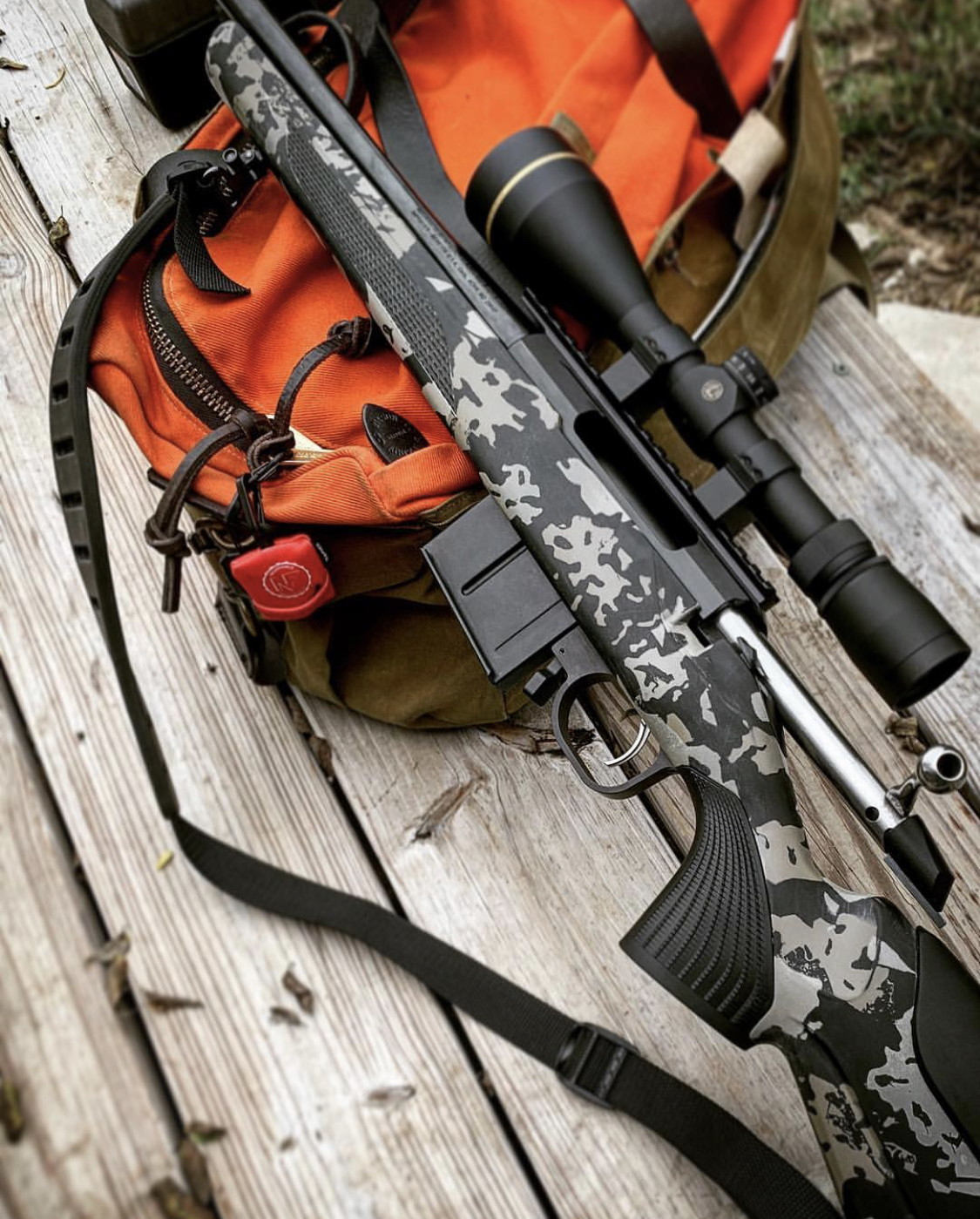

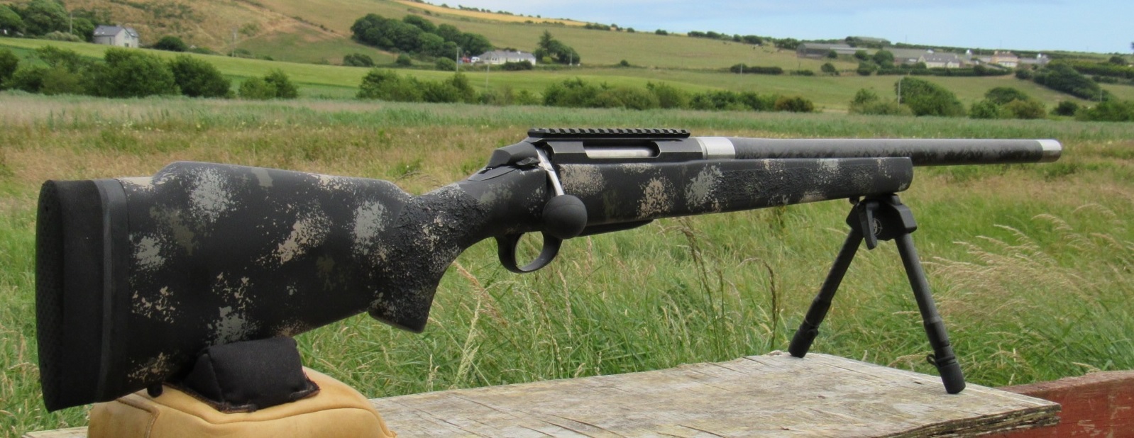

Meant to post this awhile back. Here is one of my custom Tikka T3’s. It’s a tack driver but going to be up for a new barrelsoon.
Yo, this is SICK!!!
Post more pics. Or if you don't mind, can you pm me some more pics of it? Those colors look real good and I want something like that for a paint job I have in mind! Sick build!!!

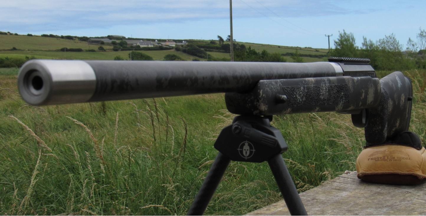

Earlier this year we had the first customer show up with a Proof barrel on his T3. When ordering he was thinking Remington Sendero size however what arrived seemed larger in diameter. Not sure if he received "Sendero Light" or "Sendero Contour" . The Stock he wanted needed to have the barrel channel altered as it could only take T3 Varmint as max. Awkward with these stocks as the barrel channel is also carbon fibre. Result was very good. I hope to meet the Proof lads when they are over at the IWA Nuernberg next year, seem to have a great product. Note also the Spartan carbon bipod....
I'd recommend, get the stock you want and re-work the barrel channel either yourself or let your rifle builder do it.

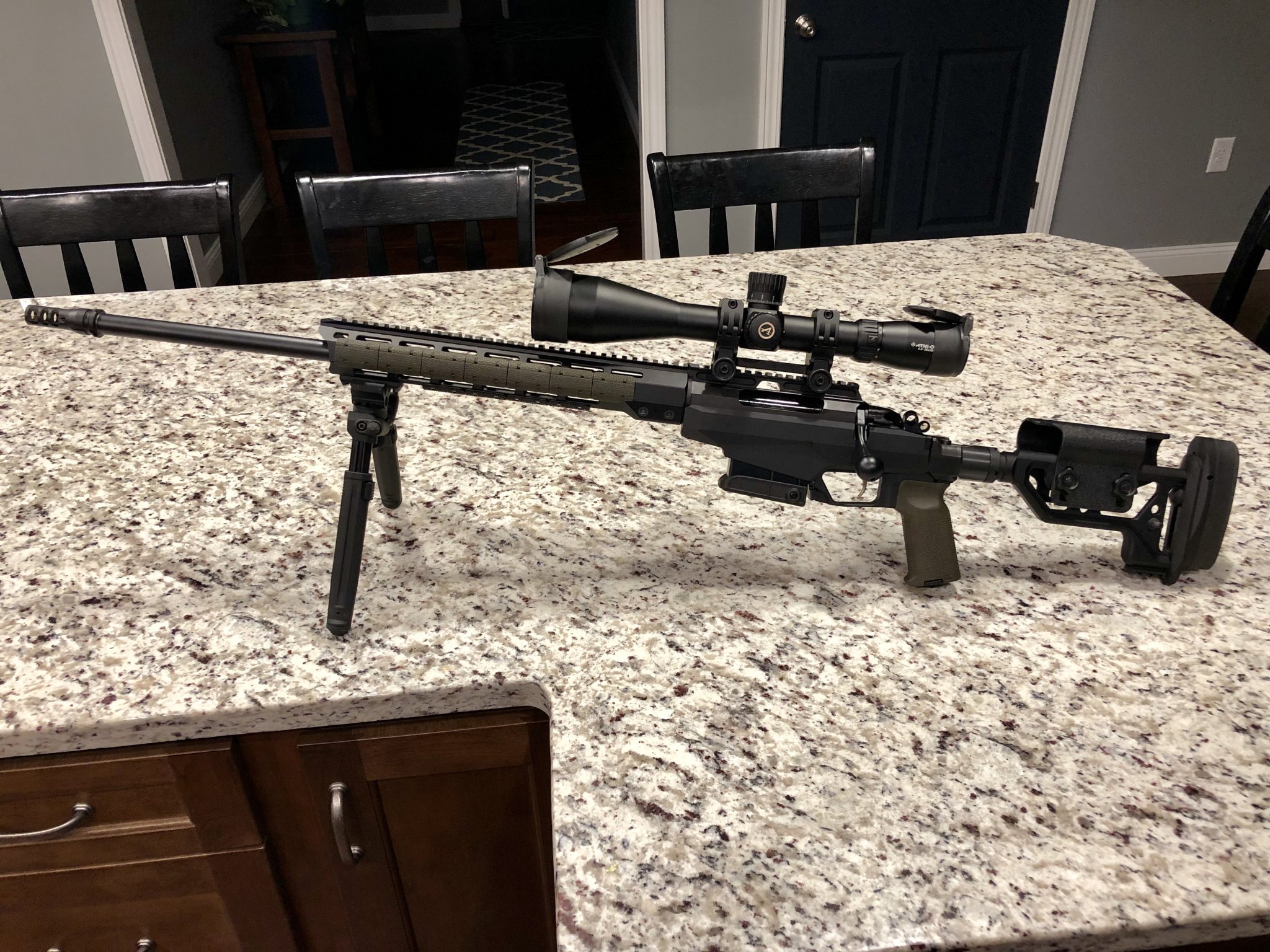

Here’s my new Left Hand Tikka T3x TAC A1 in 6.5CM. For $1700 (price I paid) I think it’s a hell of a rifle. Really looking forward to being able to shoot it when the weather and schedules cooperate.
The additions I’ve made to it as shown are: Athlon Ares ETR 4.5-30x56 in ARC M10-QD-L Mount (20 MOA and 1.57” height), Magpul bipod, Magpul K2 grip, Magpul rail covers, Mountain Tactical billet bolt shroud, Dead Air KeyMount Muzzle Brake for a Sandman-S.
